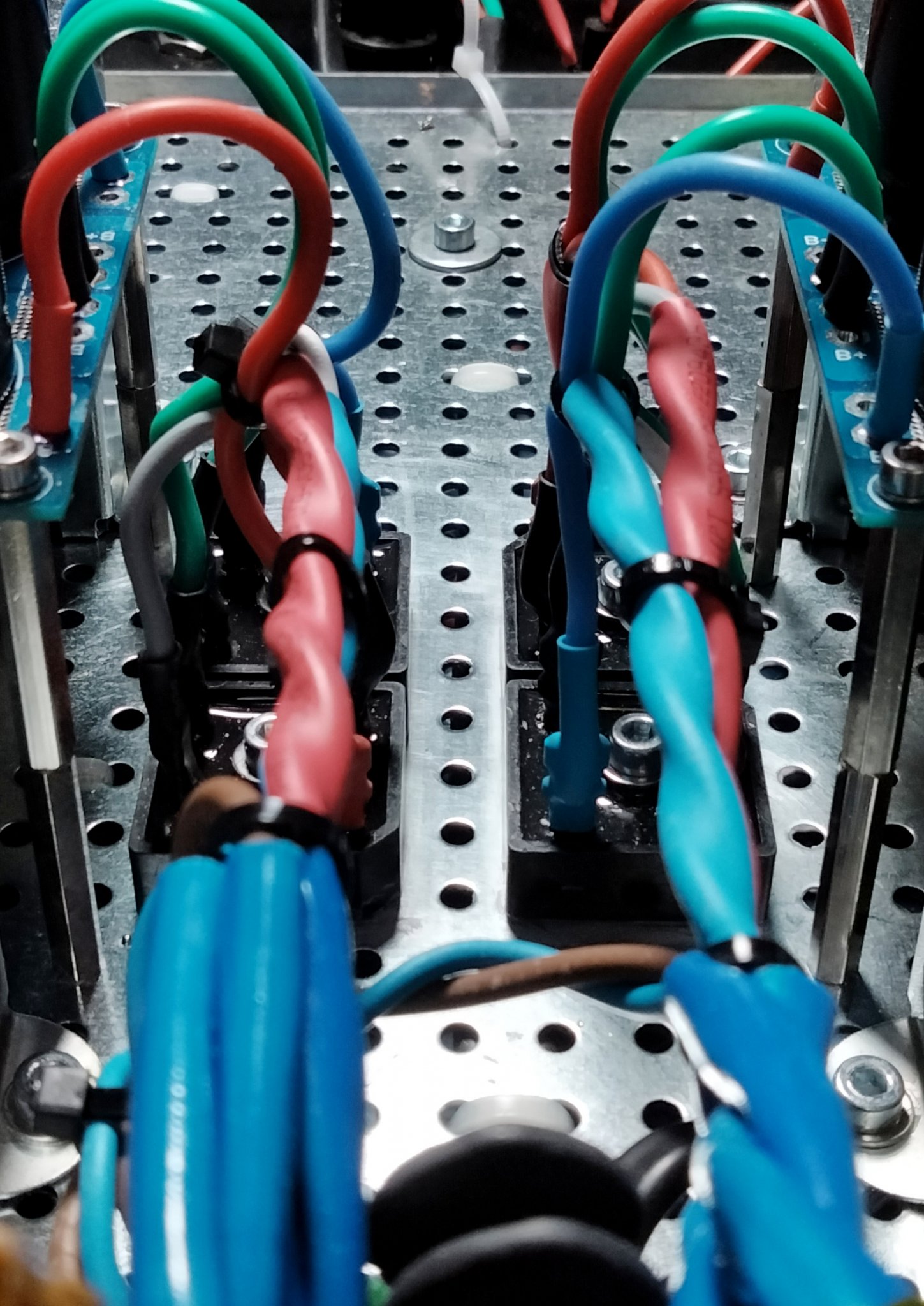

I would try it shortest path first, just ensuring that wires going to pcb are apart of rails wires
gnd plane is so big that I'm not expecting any significant pulsating field there
Thanks! I can save only a couple of centimeters going over the ground plane. Difficulty is that since neg and pos rails are lower than ground plane, tap wires will follow the last rail wires if I choose the shortest route. The suggested way (in pic) avoids that, keeping the wires off the inductors and ground plane, tapping from the back. Am I misunderstanding or can the way on the pic be a good place to start?

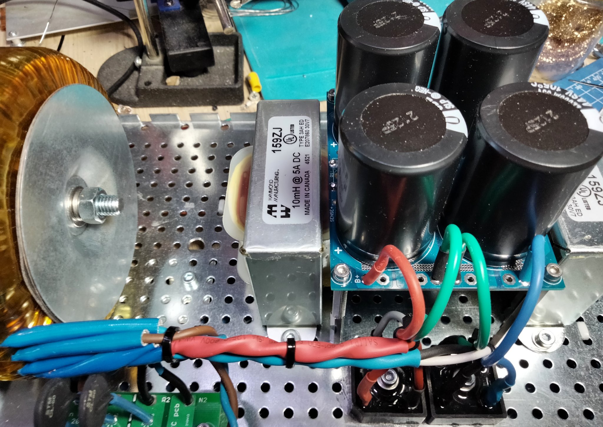

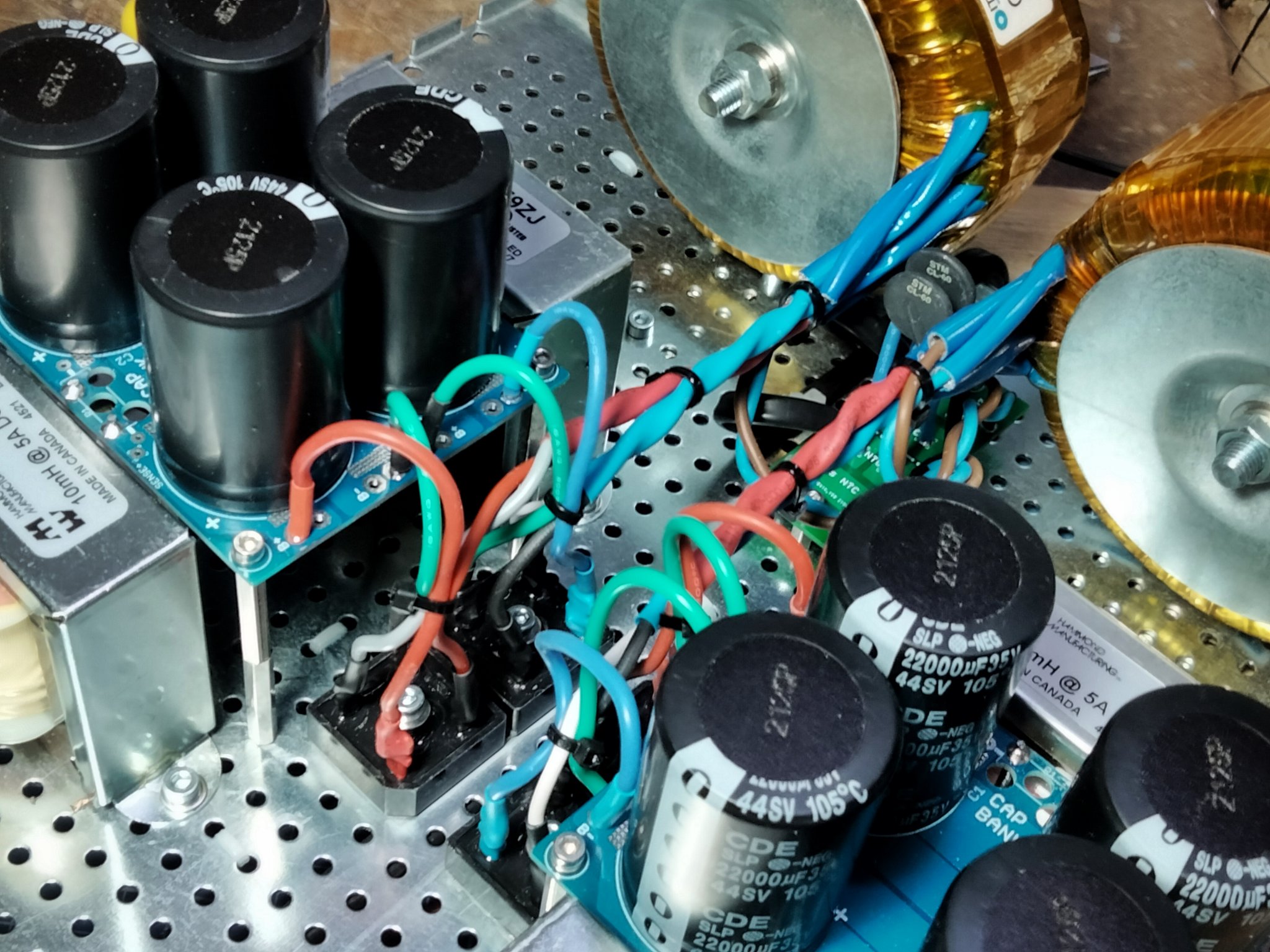

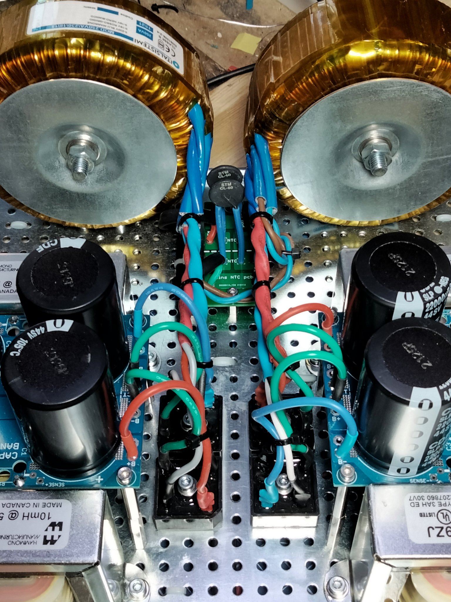

Hi all, PSU almost completed. Only waiting for NTCs...
IMG20211220151358-01.jpeg IMG20211220154613-01.jpeg IMG20211220154636-01.jpeg IMG20211220154644-01.jpeg
Yes, it's like Jim :rofl: said:
