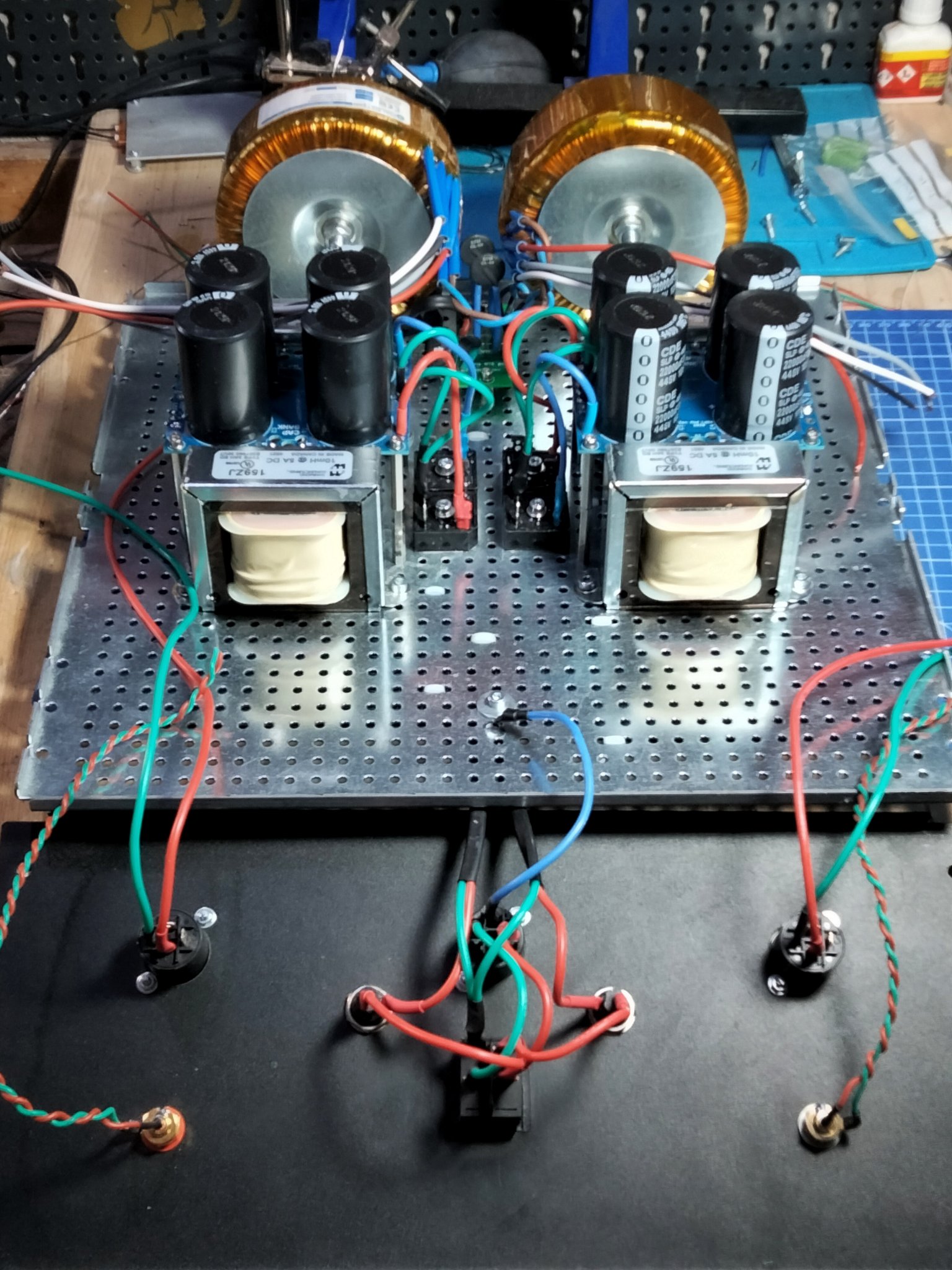

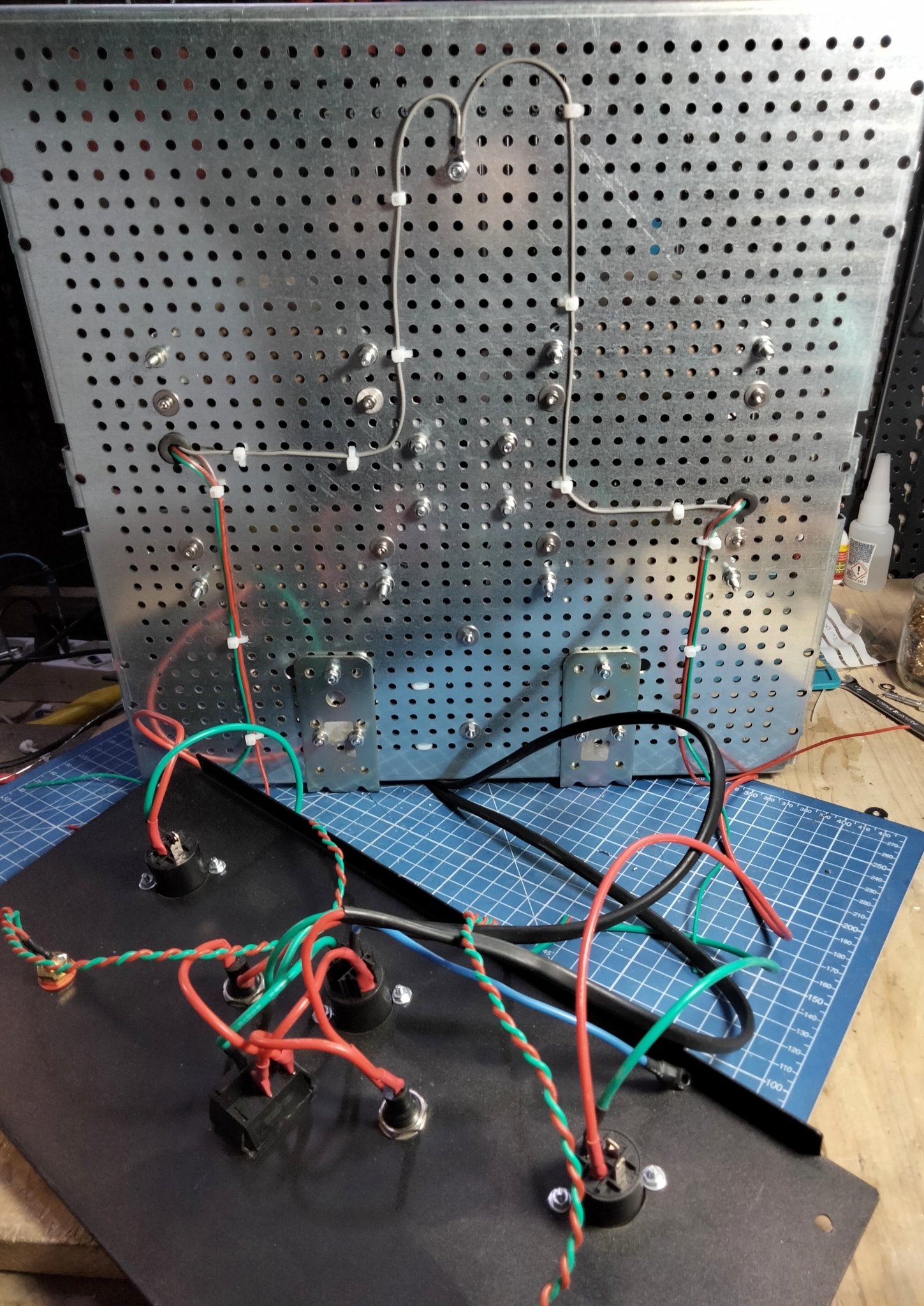

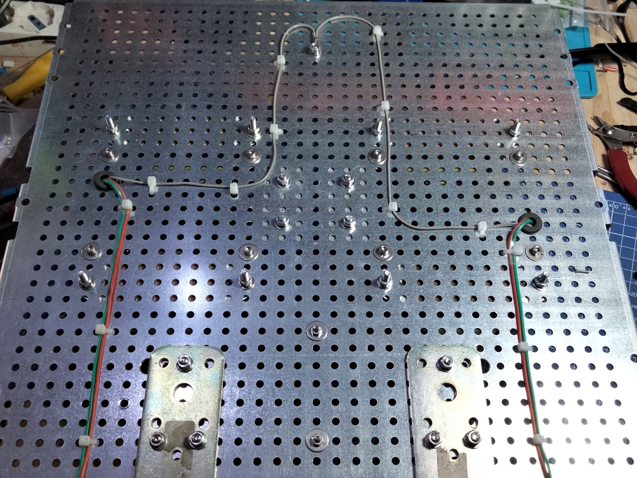

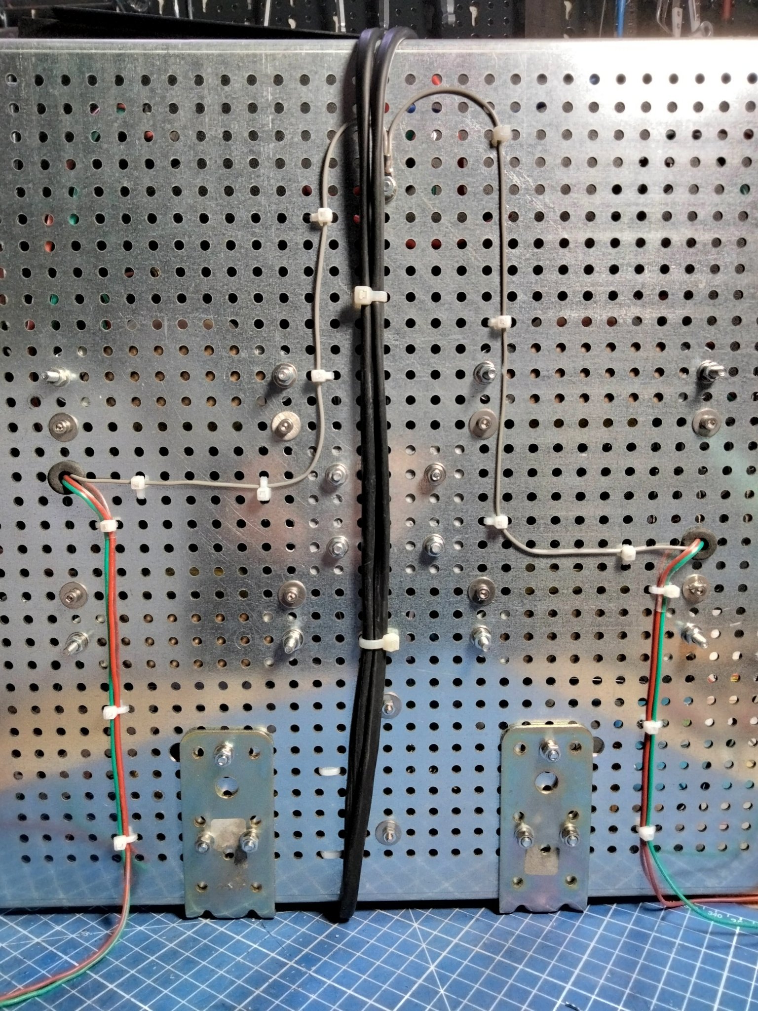

Route the power wires behind the board, and as close to the bottom chassis plate as possible.
Route the input wires as far away from the power wires as possible. I tucked them up against the top rail of the chassis. Twist them together tightly if using individual wires. I had a slight hum issue when using RCA inputs, by carefully rerouting the wires, I was able to minimize it to the point where it was only audible if you put your ear right up to the speaker.
I have since switched to XLR inputs and used shielded quad conductor wire. The amp is now completely silent.
Thanks!

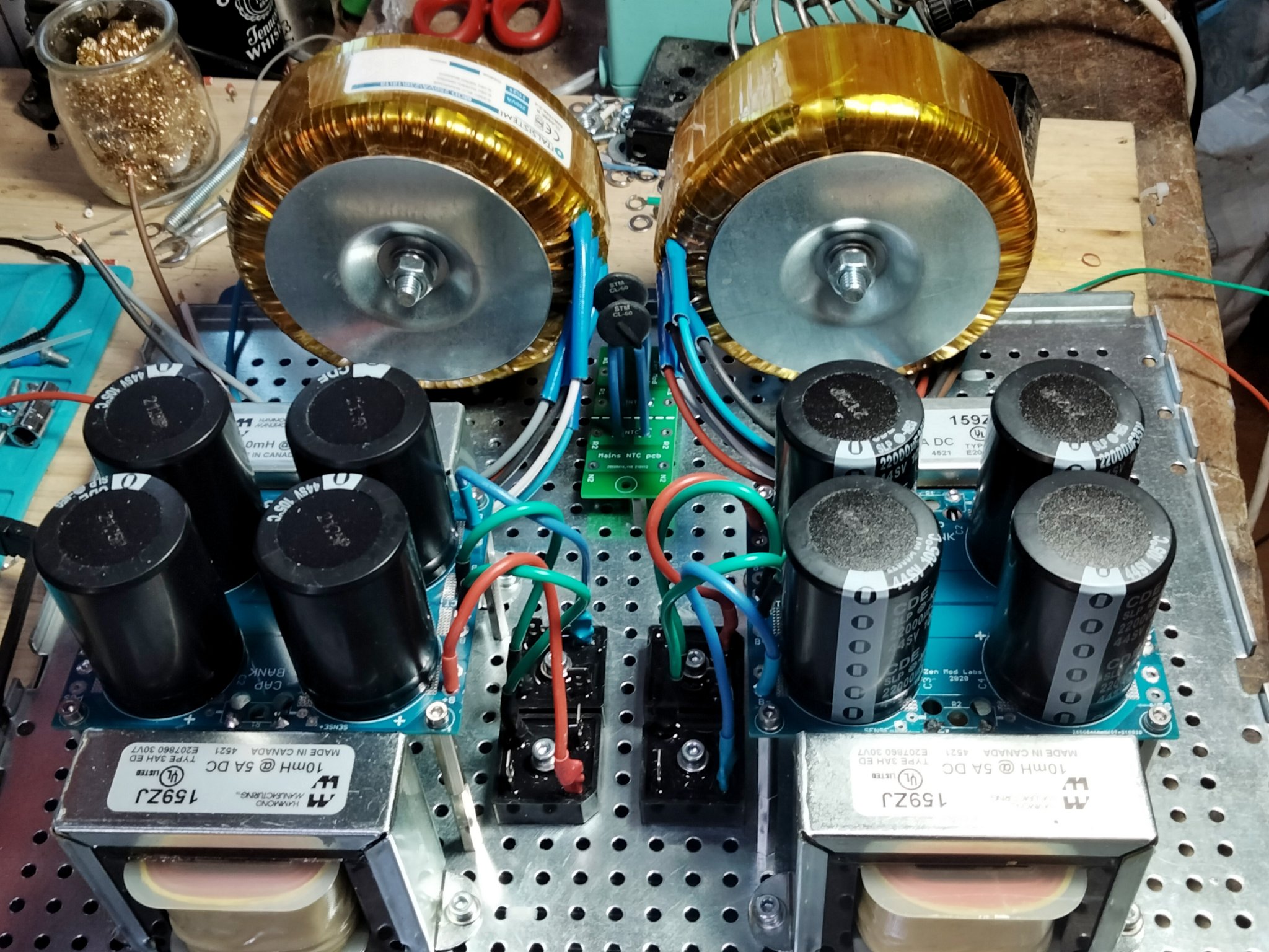

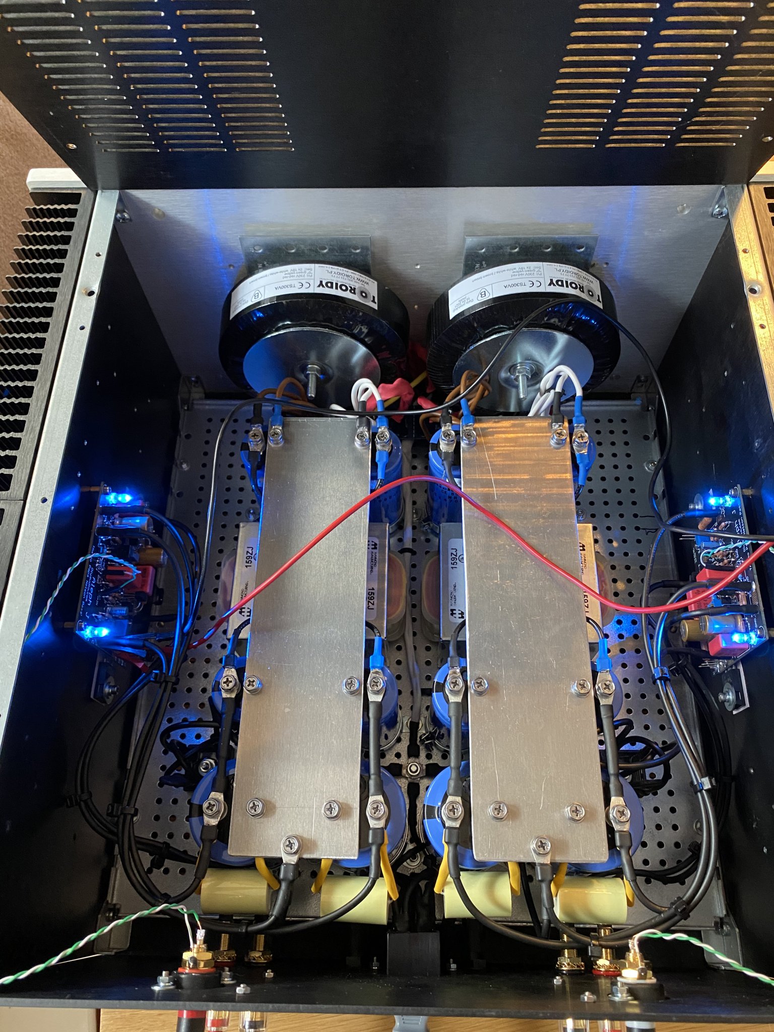

Due to the insane size of the PSU, routing power wires @ chassis floor provides issues of it’s own. So I have tried a mid point, keeping them as far away from both noisy PSU bits and AC wiring as possible, and still maintaining some distance to input wiring. For now, preliminary measurements show 0.0mV AC on the outputs. Also, my rails have 0mV ripple as far as I can measure, so I am not that concerned about hum getting into the input wiring from the DC power wires. But we will see. Normally I would twist the hell out of things. But having silent and pri/sec shielded transformers, and a ripple-«free» PSU hopefully provides some headroom

what - no sacrifice speakers connected, yet?
Noop. Only sacrifice DMM family duties now. Tonight
Btw who needs sacrifice speakers? Need to have a little faith
Pretty.
Hope it is quiet.
It should sound as good as it looks.

Thats a nice looking amp, Andy! I especially like your PSU.
Thanks a lot, Eric!
The PSU is the main project. Target was a universal FW PSU, pimped somewhat beyond the need. Tonight we will see if it was worth it. Will connect to Wayne’s linestage. B1K to come, H2 Nirvana. Hehe
excuse my ignorance, what are the chokes replacing?
http://www.r-type.org/articles/art-144.htmthanks for that. way over my head.
An old but good article not all directly related, since the example in our amps is CLC and choke input was never a discussed alternative, being the advanced kingpin of supplies.
