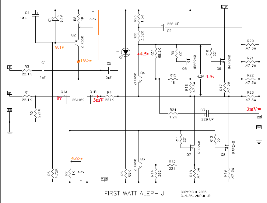

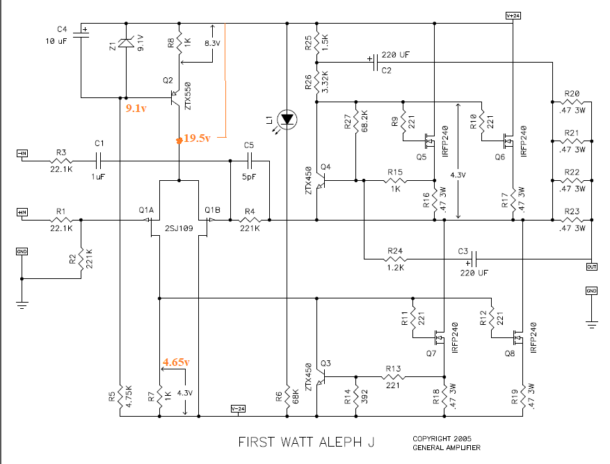

Thanks all. I’ve got one of those mega testers. Brilliant aren’t they! I’ve been calling it an LCR tester.. And yes, everything has been going into it before soldering onto the board. When I replaced Q4 last week the removed unit measured the same as the replacement. I’ll replace Q2and Q3 as suggested. I’ll need to order some ZTX550 transistors.
I’m onto a potential source of JFETs also. What Idss? Does Idss matter as long as they are in the B range and a matched pair?
Please help me find a malfunction.
One amplifier channel started working immediately; in the second, problems started. The sound is poorly audible with noise. The quiescent current of the output transistors is adjustable and set to 0.4v. Thanks
The bias voltage and the quiescent current on both channels are the same, but the gain on one channel is slightly less, the question is how to combine them to get the same signal level?
As far as I can tell from your video, the DVM was set to read DC voltage across the speaker terminals. How is this going to tell you anything about the gain (AC!) of your amp?
You'd need to hook up your amp such that both channels get the same input (I'd suggest a 100 mV sine at 100 Hz or so) and then read the AC voltages across the speaker terminals of both channels in order to learn something about the gain balance of the two channels.
The video shows the voltage offset at the output of the amplifier.
The difference in gain on each channel is audible even without measurements. The question was what is regulated, how can I level both channels, ok?
if you have genuine JFets in input ( BL range) , if all resistors are the same ,there is no reason that channels are having different gain
check all resistors , if there is no doubt in JFets

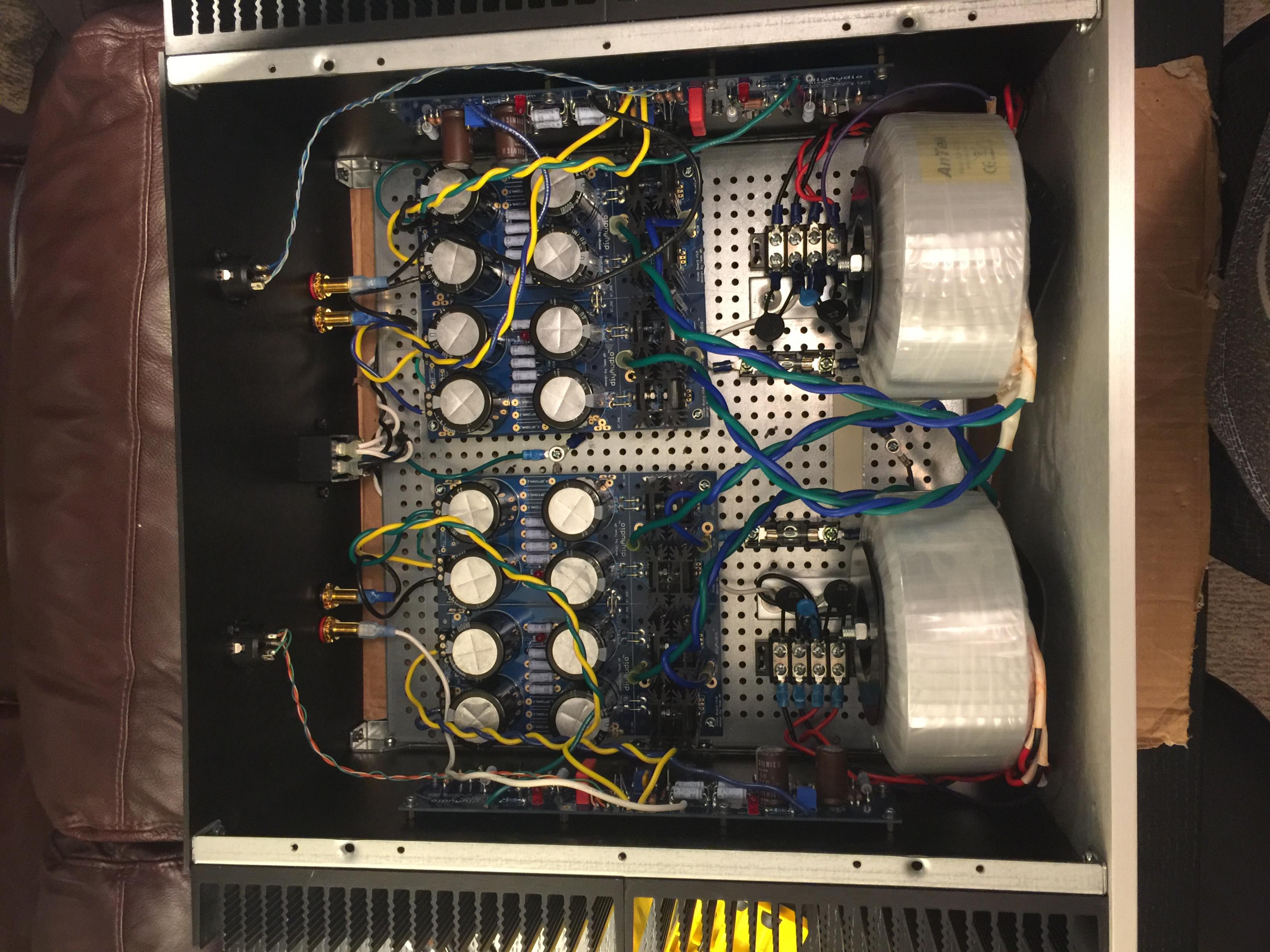

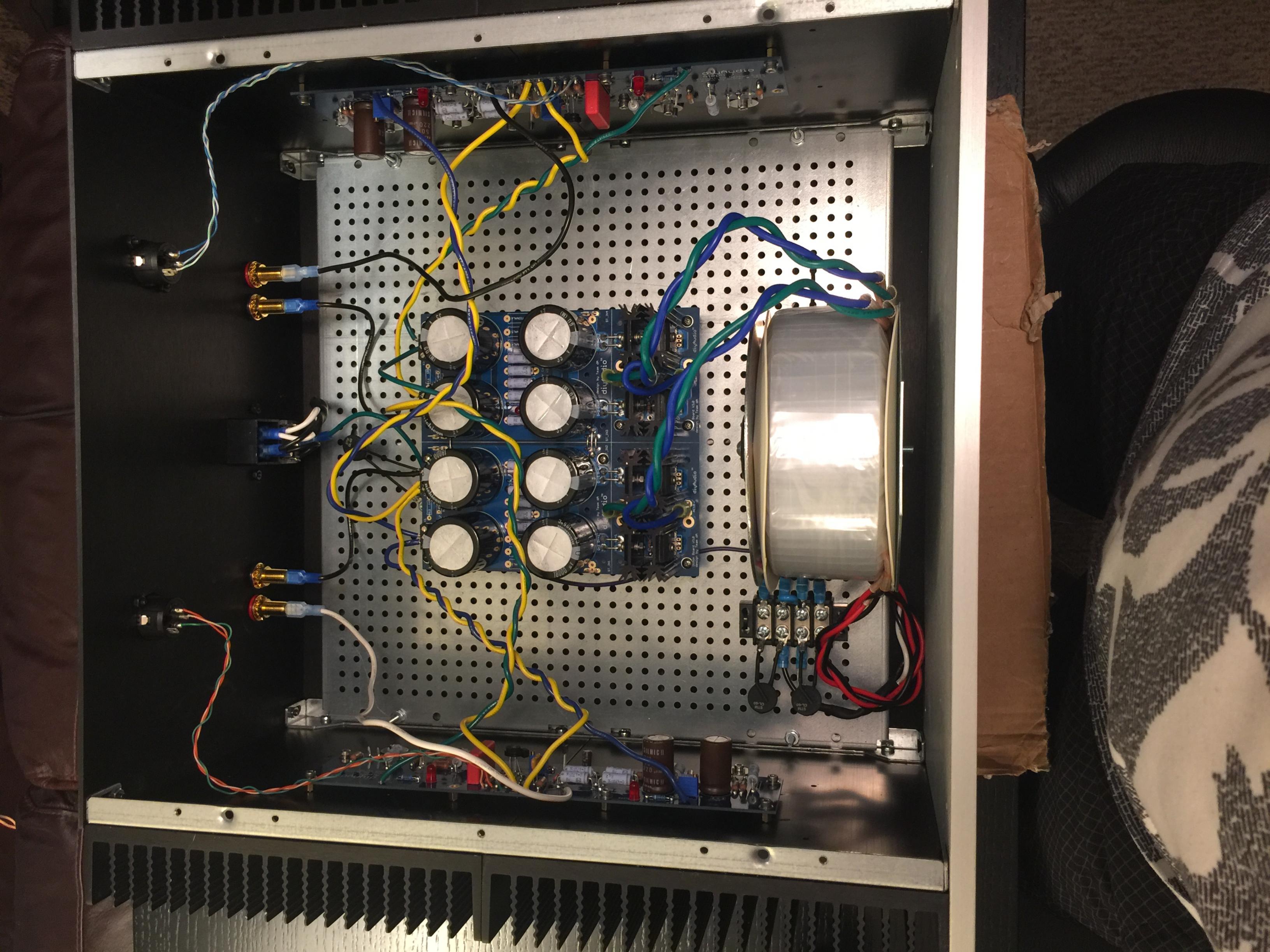

I got the Aleph J updated to dual-mono. 😀 Thanks to everyone for the advice, particularly ZM and @TungstenAudio. ZM, I'll get the fuses put into the SissySIT next.
It's getting back up to operating temp in the main system, but everything checked out wonderfully with the test rig.
Before and After...
