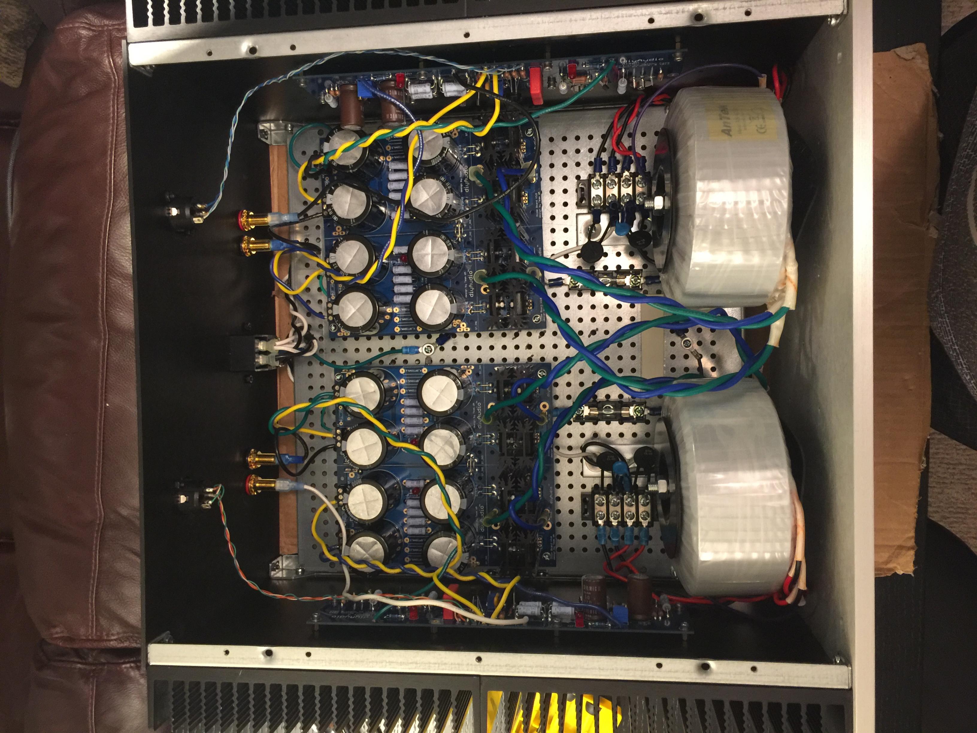

It was this picture that caught my attention:
https://www.diyaudio.com/forums/att...42-aleph-illustrated-build-guide-img_1531-jpg
On the right channel PS board it appears to me that at the PS board output (left side of board), the two sides of ground are not tied together. The three solder pads with wire holes are empty and not soldered, and there are individual positive and negative rail ground wires connecting to the amplifier boards.
Edit:
It looks like the capacitors are blocking the view of the wire connecting the two grounds at the PS board output. Looking extra hard I think I see a bit of solder. In that case you do have the two sides of ground connected at the board output - my mistake for not seeing that.😱
For a more robust connection of the two sides of ground the three unused pads can also be used to tie the two sides together.
Those unused pads are actually a better place to connect the ground to the amplifier board, speaker, and to the chassis. It is better for grounding if the ground connection to the capacitors of a dual rail supply is located equally between the positive and negative rail grounds.
Thank you very much for looking. You're correct, the jumper is there. I like the idea of beefing it up a bit. It can't hurt. Next time it's out of the case, I can add a jumper or two. I use the Euroblocks for the connection points b/c I take the amp boards in and out. I know they may not be as solid a connection as directly soldering to the board, but it makes my life a whole lot easier than desoldering / soldering each time I want to swap out amp boards.
Again, thanks for taking the time to explain and taking a good look at the boards! 😀

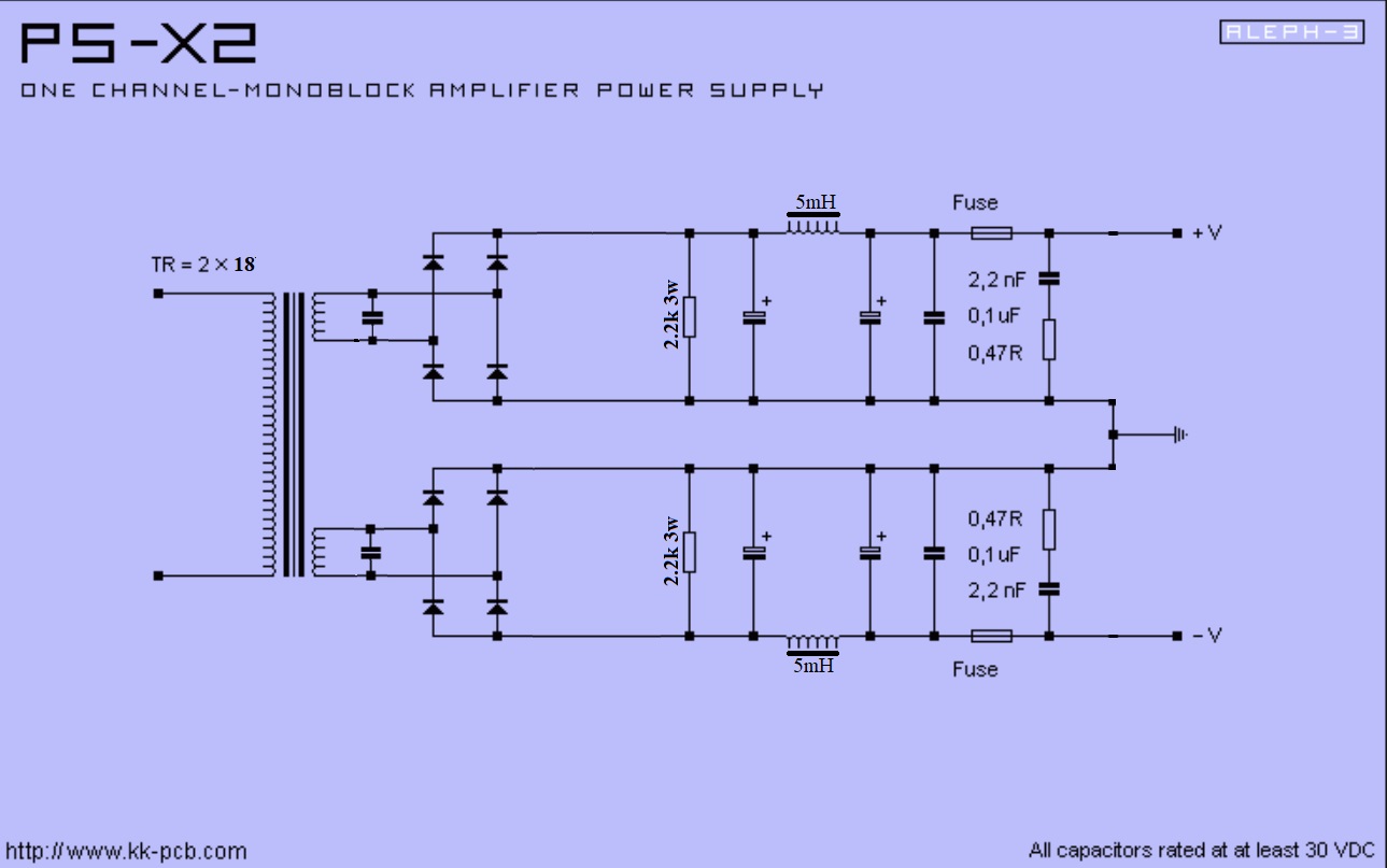

Just sorted out which components i need to order especialy for the PSU part.
It will be CRC with a bleeder in dual mono config.
C-C-R-C-C (each rail)
So i was thinking to use 16x 47mF low esr C's but i think it's overkill, what do you think? C-C-R-C or C-R-C ?
https://export.rsdelivers.com/produ...22000μf-25v-dc-aluminium-electrolytic/6832077Just sorted out which components i need to order especialy for the PSU part.
It will be CRC with a bleeder in dual mono config. C-C-R-C-C (each rail)
Factory versions had what, 8 x 15mF?
While one must leave the term "overkill" at the door when entering here, 16 x 47mF is nevertheless a lot.
If you already have the 47s then 8 x 47mF would go down nicely (C-R-C); otherwise 16 x 22mF would also give a big bump over factory spec.
Jeff.
PS: careful of the inrush and transformer loading with that much capacitance
Jeff.
Yeah, 47mF is a big enough capacitor that it is starting to go inductive at the upper frequencies of interest for an audio power supply. For bulk capacitance on each rail, a simple C-R-C configuration will be plenty. You could also try a C-R-C-R-C configuration with the first C at 33mF, and the next two at 27mF. That's what I have in my Aleph J.
