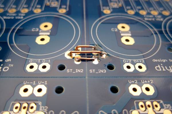

@Ben Mah - I appreciate the overview re: the grounding plan. I want to be sure I grasp your potential concern and address it if necessary. Please correct me if I am wrong. I think I am okay because the grounds associated with V+ and V- on the DIYAudio PSU boards in my build are joined by the jumpers that run between the two "halves". Also on the AC / rectification side, there is a jumper. See pic. (Credit for pics to Jim, I borrowed his from the build guide). Is this sufficient? From a measurement standpoint, there is 0R between the ground posts on the Euroblocks closest to V+ and the one closest to V-. I think for all intents and purposes they're the "same" ground. Or... am I mistaken and are you meaning that I should have a tie between the left and right channel PSU board grounds? At this time, the only commonality between the left and right PSU is that both thermistors run to the chassis ground.

@Ben Mah - I appreciate the overview re: the grounding plan. I want to be sure I grasp your potential concern and address it if necessary. Please correct me if I am wrong. I think I am okay because the grounds associated with V+ and V- on the DIYAudio PSU boards in my build are joined by the jumpers that run between the two "halves". Also on the AC / rectification side, there is a jumper. See pic. (Credit for pics to Jim, I borrowed his from the build guide). Is this sufficient? From a measurement standpoint, there is 0R between the ground posts on the Euroblocks closest to V+ and the one closest to V-. I think for all intents and purposes they're the "same" ground. Or... am I mistaken and are you meaning that I should have a tie between the left and right channel PSU board grounds? At this time, the only commonality between the leftno and right PSU is that both thermistors run to the chassis ground.

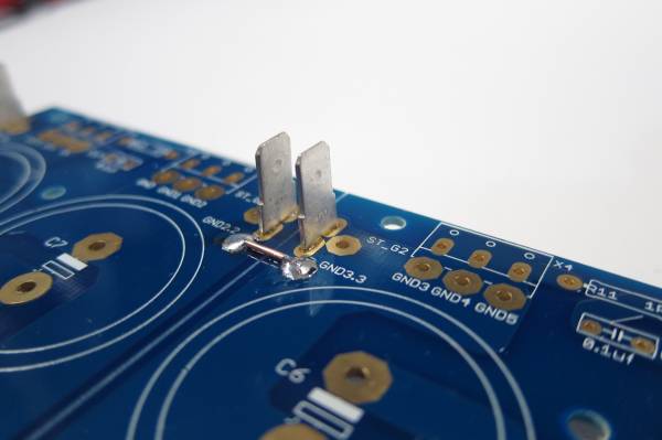

It was this picture that caught my attention:
https://www.diyaudio.com/forums/att...42-aleph-illustrated-build-guide-img_1531-jpg
On the right channel PS board it appears to me that at the PS board output (left side of board), the two sides of ground are not tied together. The three solder pads with wire holes are empty and not soldered, and there are individual positive and negative rail ground wires connecting to the amplifier boards.
Edit:
It looks like the capacitors are blocking the view of the wire connecting the two grounds at the PS board output. Looking extra hard I think I see a bit of solder. In that case you do have the two sides of ground connected at the board output - my mistake for not seeing that.😱
For a more robust connection of the two sides of ground the three unused pads can also be used to tie the two sides together.
Those unused pads are actually a better place to connect the ground to the amplifier board, speaker, and to the chassis. It is better for grounding if the ground connection to the capacitors of a dual rail supply is located equally between the positive and negative rail grounds.
