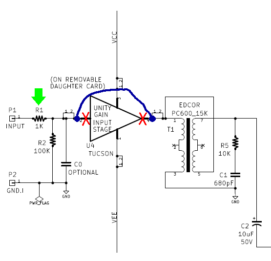

If anybody is thinking about bypassing the input buffer on an M2x power amp, pause for a minute and think very hard.
It seems so easy: just unbolt and remove the daughter card (red), then connect a shorting wire from input bolt to output bolt (blue). 10 wraps around the first bolt, 10 wraps around the second bolt, and Bob's yer uncle.
Don't forget resistor R1 (green). It's in series with your low-output-impedance preamp. Now you're driving the transformer from a source whose impedance is 1002 ohms. No es bueno.

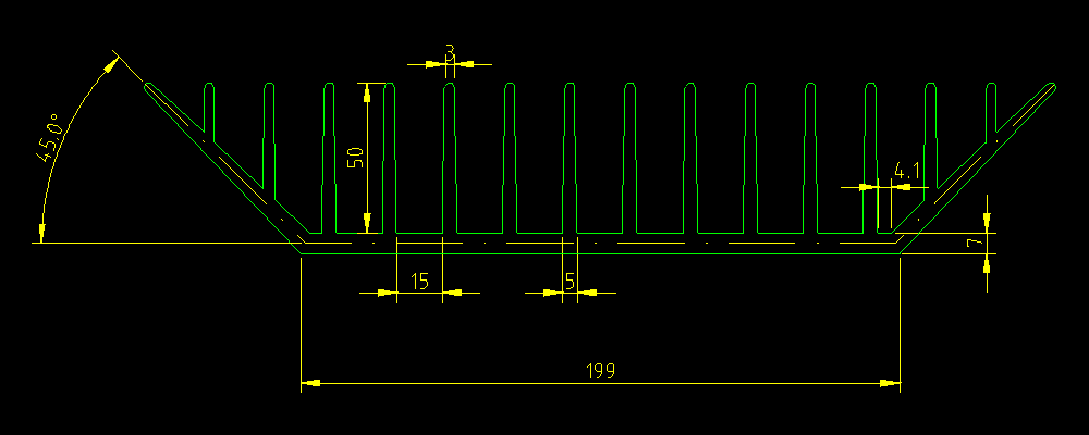

"Aleph style" heatsinks
Would anyone be interested in getting a bunch of "Aleph style" heatsinks as shown in the attachment?
I am considering to run a batch of these, and if there is enough interest, that might even be affordable. Just let me know either here or by PM. If there is enough interest, I might start a group buy thread for this.
Mark, as always, thank you! I don't want to take the AJ thread too far off topic, but your post is greatly appreciated. I had read a bit about people building (I can't remember the word that was used, so my apologies) gimped F4s without input buffers. I also remember the discussion in the M2x thread. This got me curious. Since I have no idea what the output impedance of my tube pre-amp is, and measuring it seems far over my head for now, I'm leaving all buffers alone. It keeps things more versatile.If anybody is thinking about bypassing the input buffer on an M2x power amp, pause for a minute and think very hard.
