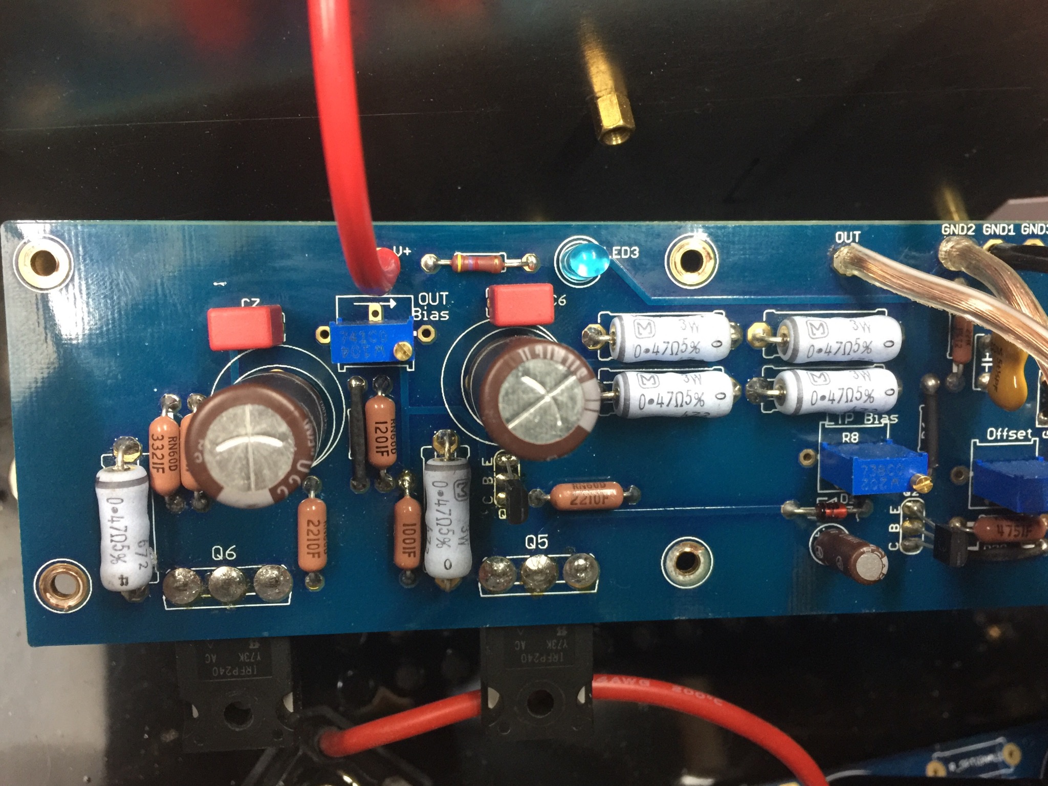

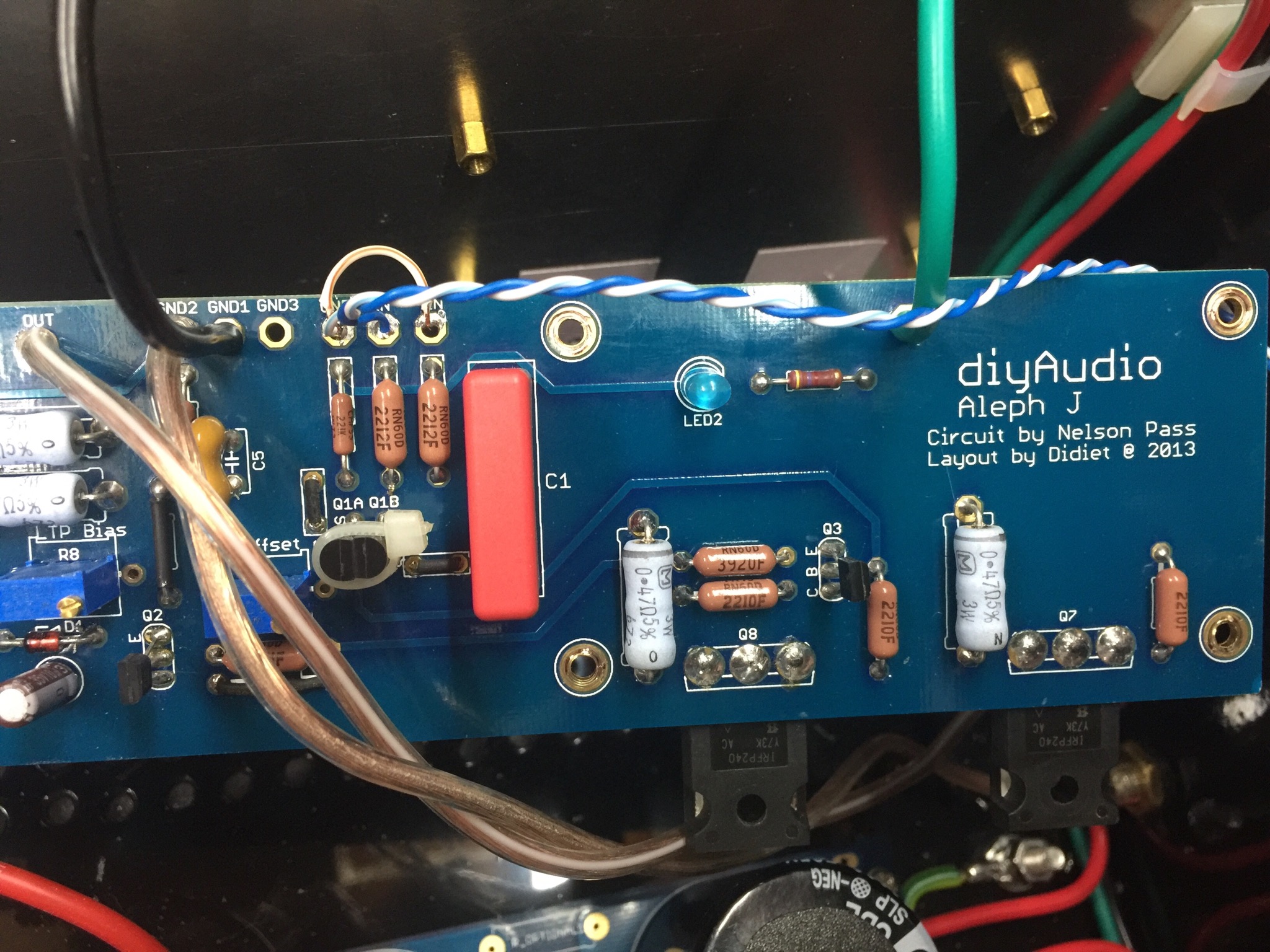

I’ve replaced Q4 with a new ZTX450, reflowed all the joints and not fixed unfortunately. Still -8.7v at the outputs..

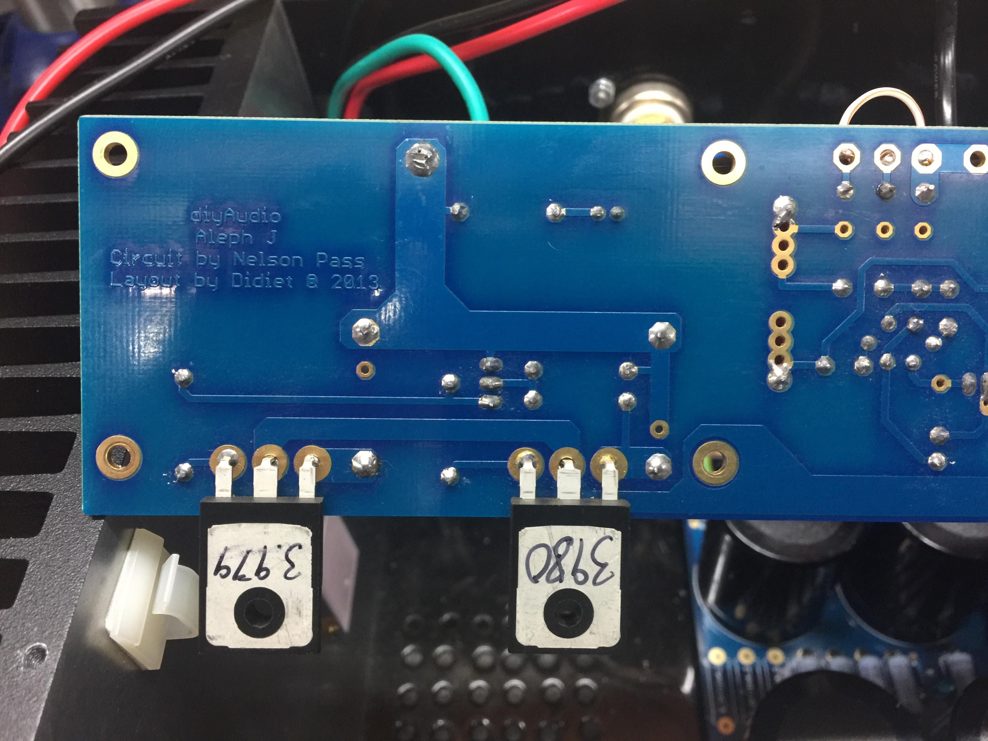

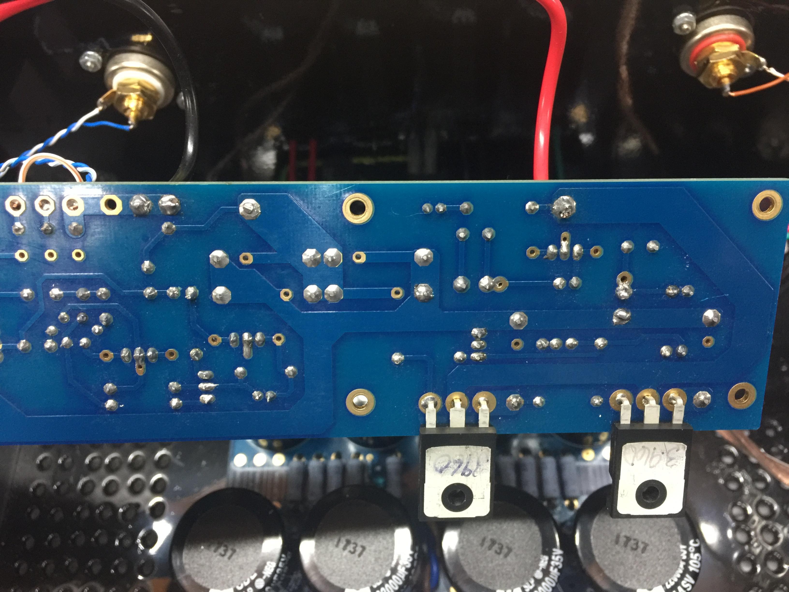

Here are a couple of photos of the bottom of the board. Can anyone see anything that appears wrong?

Might be a trick of the light but the middle leg of the FET marked 3980 looks a bit light on for solder to me. I can't see anything obviously dodge elsewhere. One for more experienced eyes? Let's see what other feedback you get.
Swap the JFET's between a good working board and a faulty board... and see if the fault follows the JFET's you removed from the faulty board
The middle pins of several of the MOSFETs appear a bit light, but I imagine they're well-flowed on the other side?
The power connection is also dodgy: note that many of the wire strands are not wetted.
I doubt either of those is your problem, though....
A fair observation on the mosfet soldering. Soldered the mosfets from the front side only. Any reason to do both sides?
Desoldering is my arch nemesis... I’m very concerned about desoldering and swapping the JFETs given that I’m unable to find any replacement LSJ74 B JFETs for sale.. The B’s appear to be unobtanium..
Does anyone know where I can buy a pair of matched LSJ74B JFETs or some equivalents that’ll do the same job?
No reason to do both sides, but it's good practice to get in the habit of applying enough heat to the one side until you see the solder pull through to the other side.

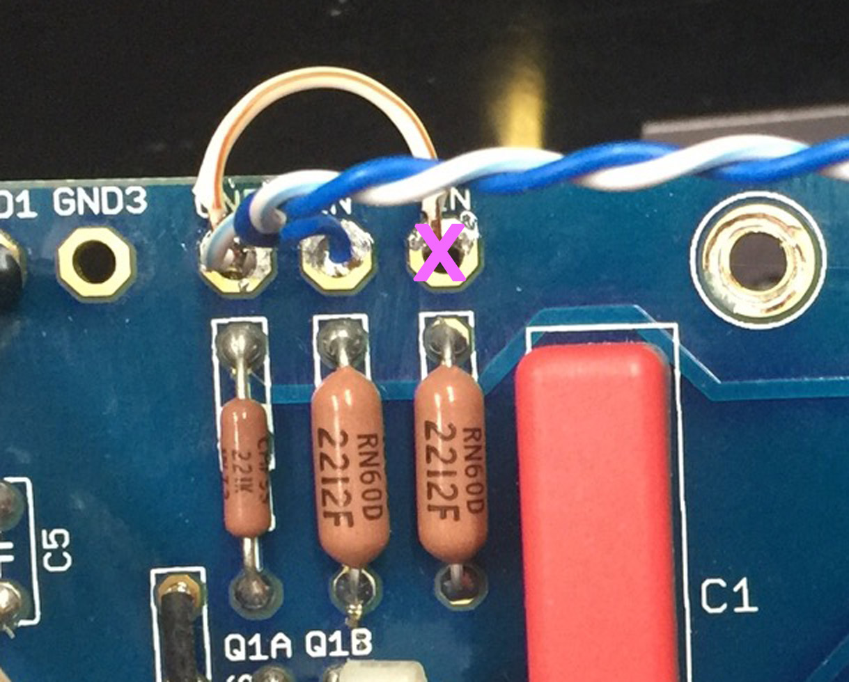

Check the soldering at the point "X" (attached)
