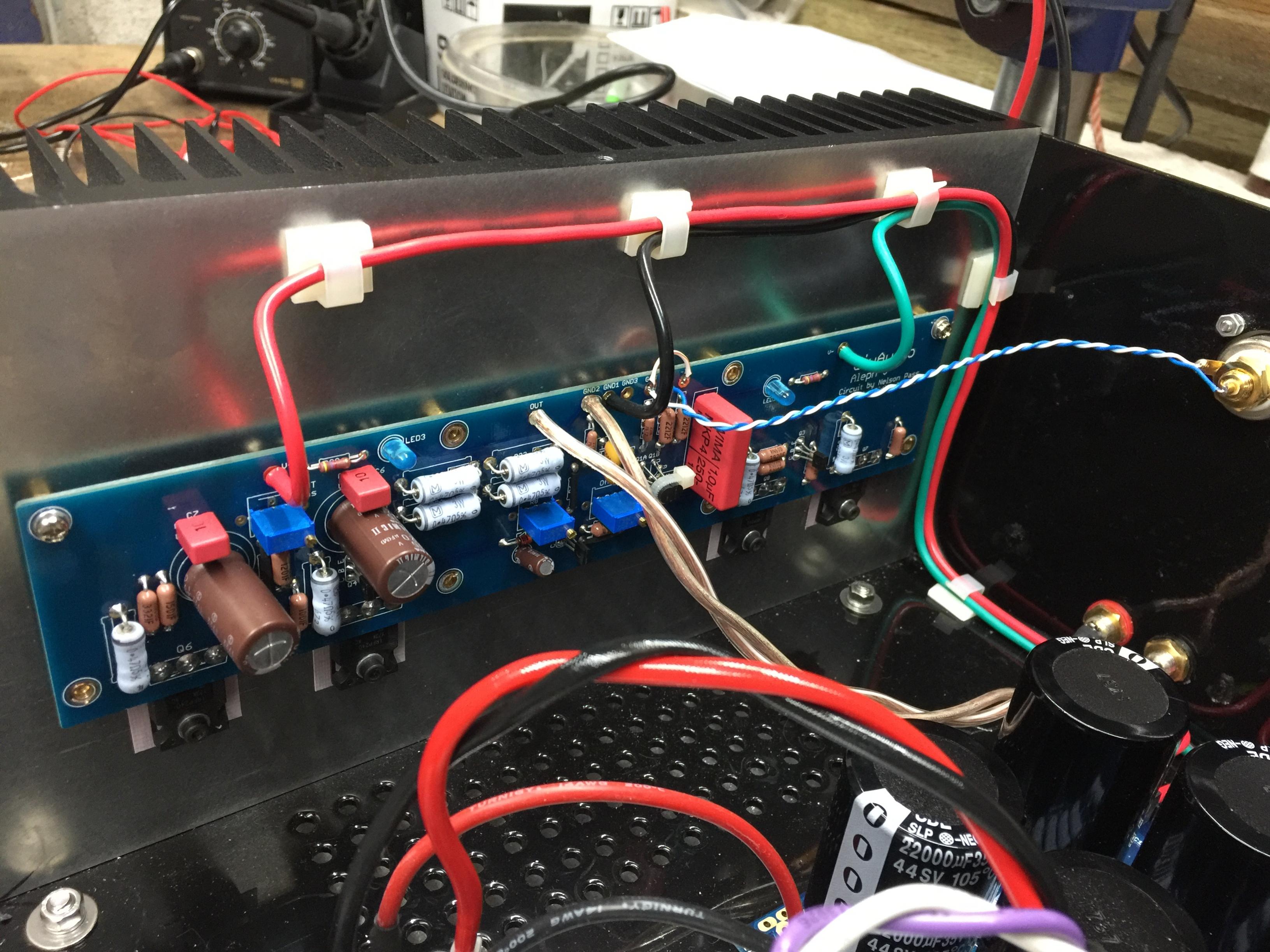

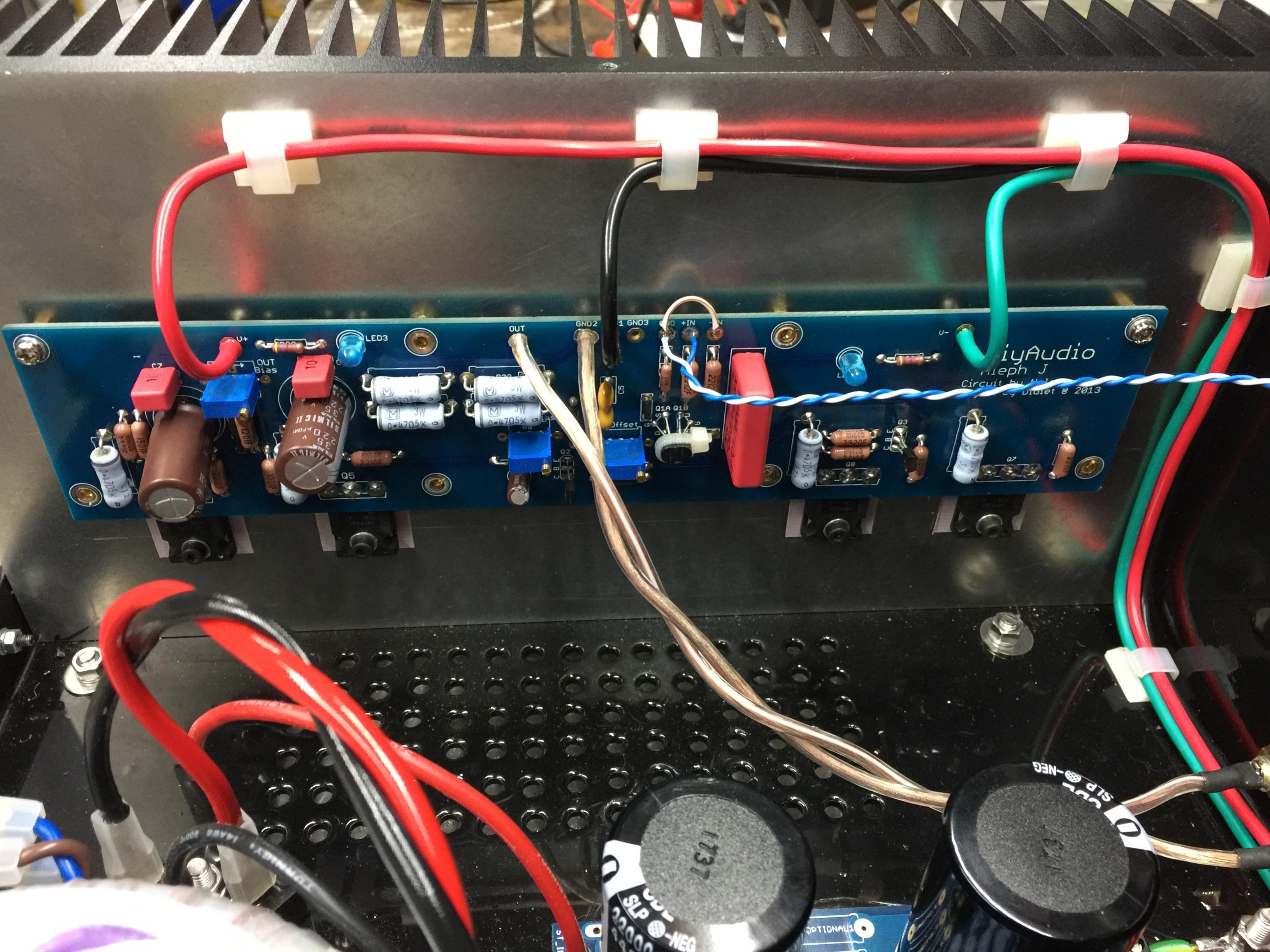

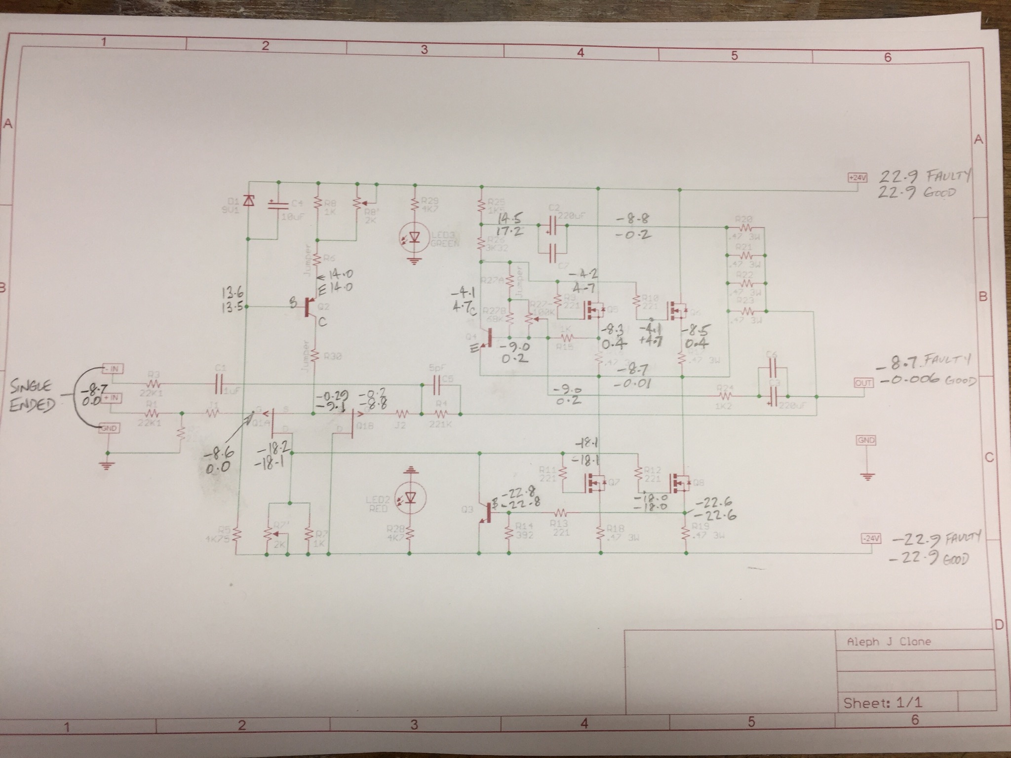

Hi, I have a problem with my left channel. Right channel working perfectly. All started well. First power up fine and adjusted both offsets to 0v across the terminals, both bias to 4v. Left for hours, tweaked, perfect and stable. Connected to DAC, speakers, blew 1.25A fuse. Changed to 1.5A fuse. All good except for big hum on left channel.. Plays music but bad hum left side. Can no longer set left offset to zero. Now about 8v! No visible issues I can see. Many voltage measurements on attached schematic. Bad channel measurements on top. Good channel measurements on bottom for reference. Seek your guidance. I don’t know where to go from here..

8V on input JFet gate ?
anyway , Aleph CCS is not conducting , while lower side is open , thus -8V on output terminals
supernice that you already attached schm with measurements ..... that also is confirming importance of precise explanations - you wrote that offset is 8V (positive) but schm is fully informative 🙂
besides checking upper mosfets for shorts , regular ( if not unnecessary) checking for conductivity of mosfets to heatsink , check or just replace Q4
also usual thing - visually etc. check for proper solder , no shorties etc.
be sure that DAC is output offset -free
Thanks Zen Mod. Yes, -8.7v at the output. I’ve spent an hour or so looking at everything with a magnifying glass and can’t see anything that looks cooked..
What’s the best method to check the mosfets for shorts or conductivity to heat sink? I had the whole board and mosfets off the heat sink completely to inspect the back side again. I powered up for 10-15 seconds and still got -8.7v at the output.
DMM buzzer will buzz with everything less than 30 (or so ) ohms
use it
with amp off , poke between mosfet pins to check for shorts ; if buzzes at first , wait to allow caps filling .....
same applies to mid pin ( drain ) of mosfets , vs. case/heatsink
also same applies to Q4 , but - with cheap parts , if in doubt - don't measure , just replace

Thanks guys. I’ll check the mosfets for shorts tomorrow. Late here now.
I’ve ordered some Q4 ZTX450 transistors. I’m sure the orientation is ok as it appeared to work nicely for a few hours before I tried to play music through it.. I hope it’s this..
JFETs... I’m not good with desoldering and those things are hard to buy, expensive.. I hope not these please..
Roo2
at least check them with diode/buzz meter in situ , compare with good channel
check torque of mosfets , beside everything else , and be sure to have some safety against de-torque of screws (thermal cycling is tricky thing)

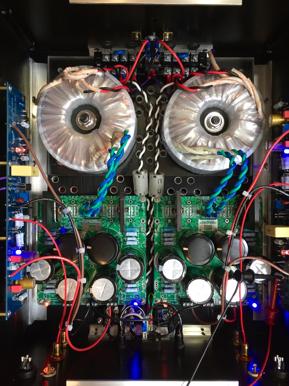

I used two different 400mm deep chassis for my M2x and Aleph J. I went with a smaller 2.5U tall chassis for the M2x, and kind of painted myself into a corner with that one. I was mostly concerned with keeping as much distance as possible between the Edcor transformers and the main power transformer, which was covered by its own steel case. I have used a couple tricks to minimize the channel interaction through the power supply rails, but it still sounds less expansive and transparent than the dual-mono Aleph J.
The chassis I used for the Aleph J is 3.5U tall, 400mm deep and 320mm wide on the inside. It's a bit smaller than the Modushop 4U, 400mm deep chassis sold on the diyAudio store. Getting two separate power supplies to fit was challenging, but manageable. Transformers are Antek 300VA w/ 20V secondaries, and the PSU boards are CRCRC from a group buy a while back.
I originally intended to use a a set of "ideal" rectifier boards, but started out with LVP 2560 bridges in GSIB-5S cases. I'm happy with the +/-24.2V rails so far, and haven't felt the need (yet) to experiment with alternate rectifiers.
