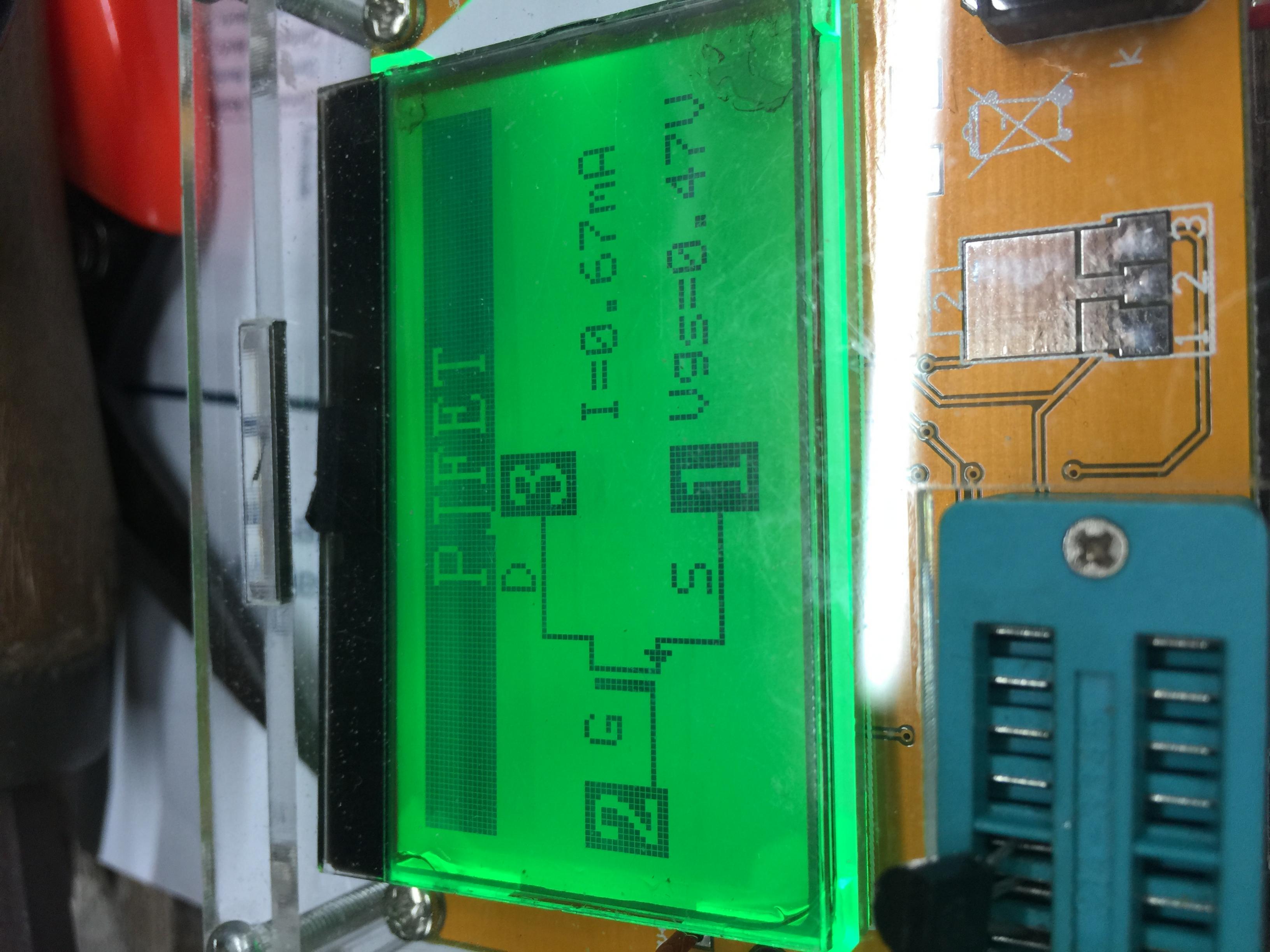

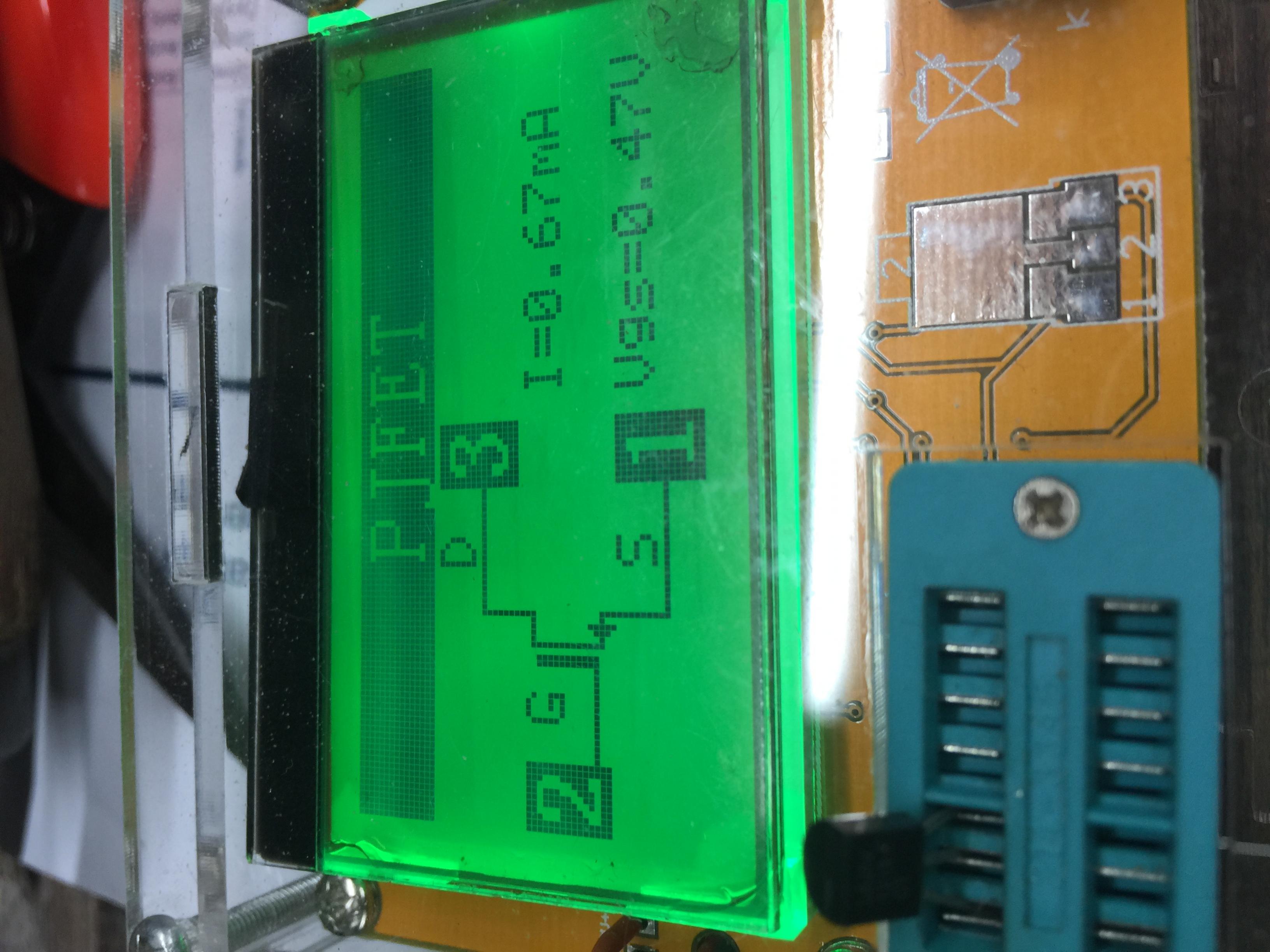

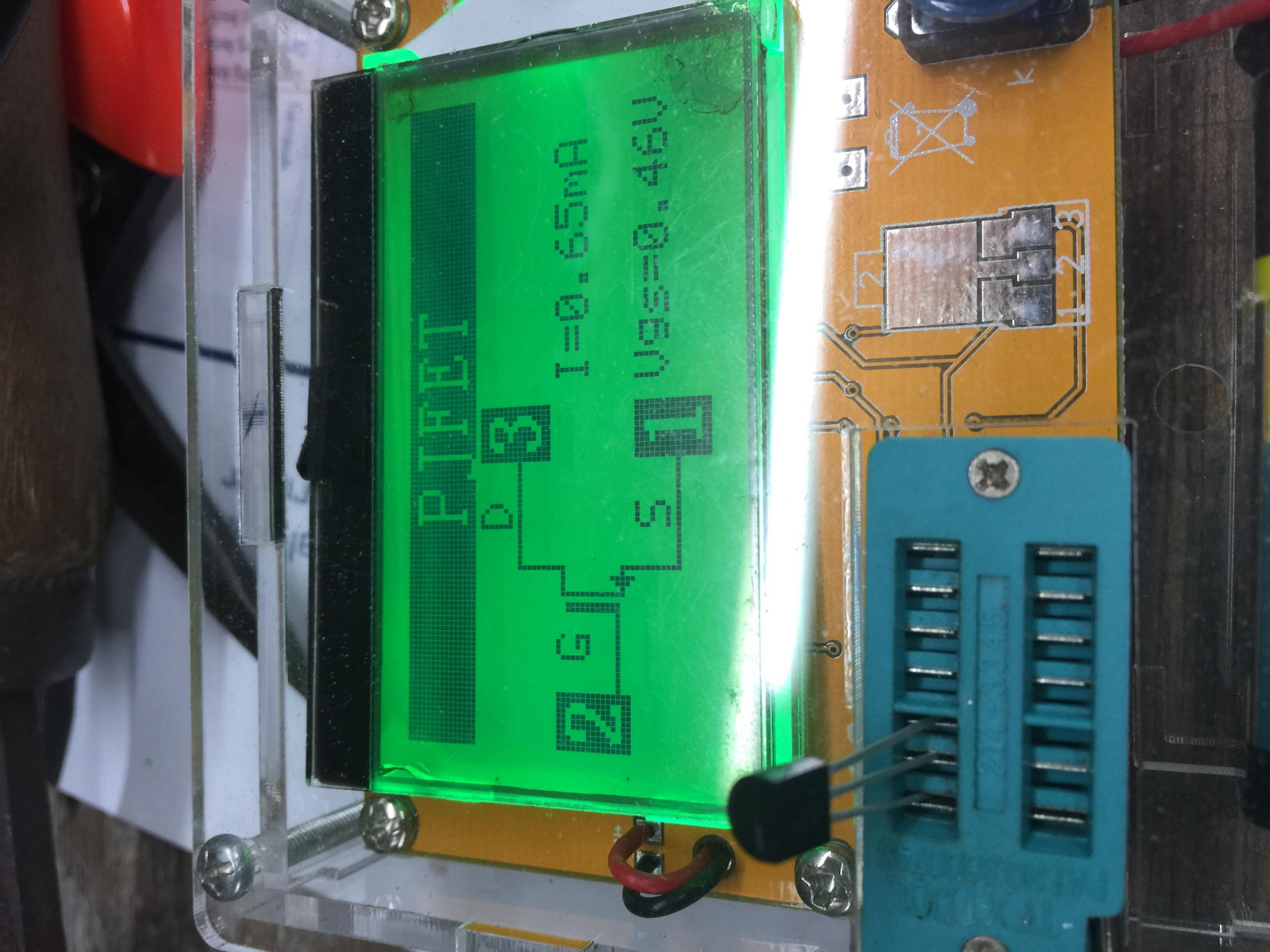

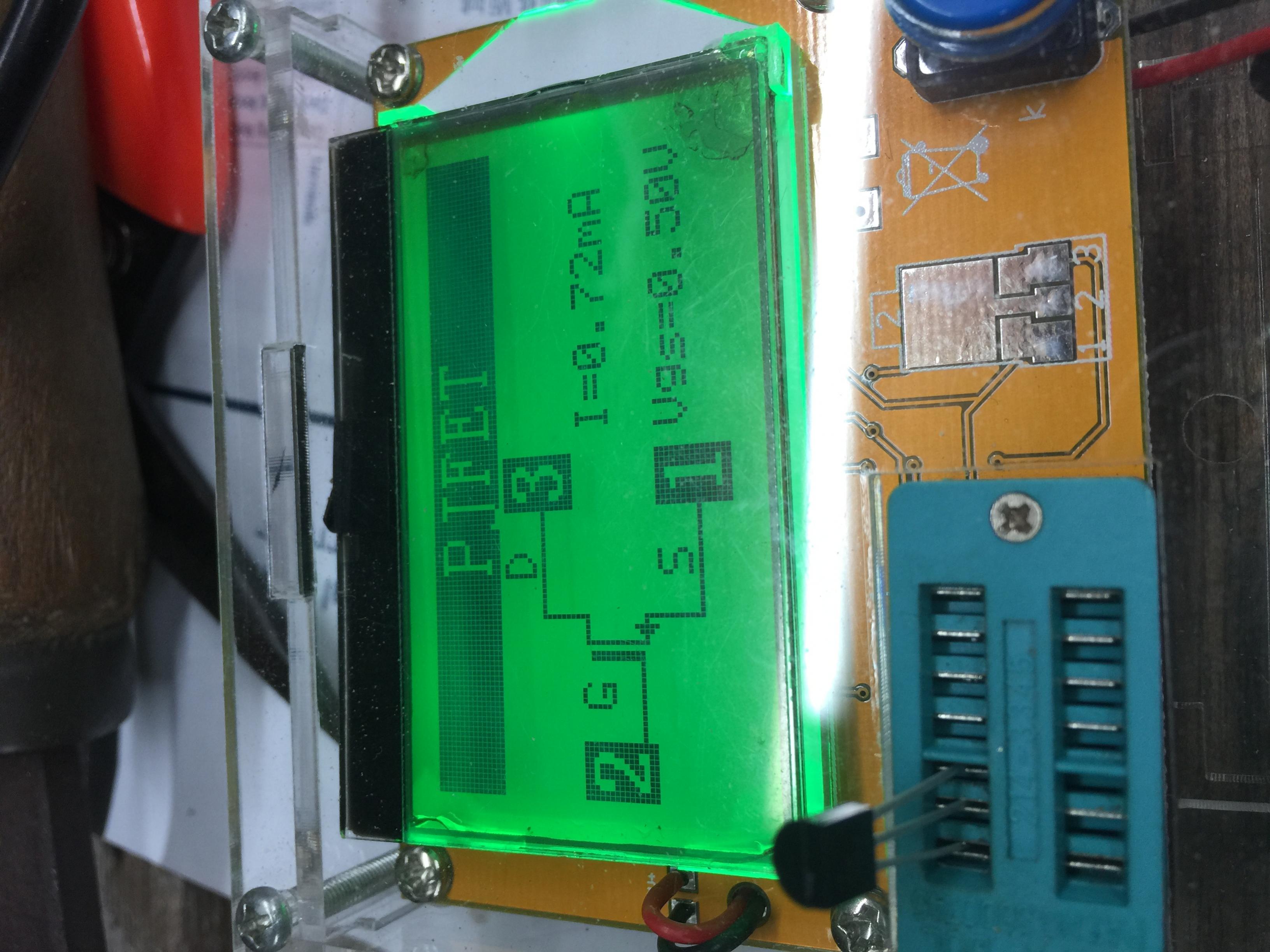

Hi there. I’ve just received a new pair of JFETs from the Diyaudio store and they don’t appear to be as well matched as the two I just removed.. See attached pics of the new and old jfets. First two with long legs are the new pair. The old pair are within 0.01 and also appear to check out ok in the meter. Should I install the new JFETs ?
Mega328 has a bit of an issue reading Jfets in my experience. Both of your sets are absolutely good enough to be used without hesitation in your project. One pair just happens to be matched so well as to be incredible.
You’ll never hear the difference...
Thanks 6L6. I might as well install the new ones. I suspect this won’t solve my -8v at the output terminal problem. I’ve eliminated every potentially suspect part suggested...

Woo hoo! I can now adjust my left channel offset to zero volts! Must have been a duff JFET. Even though the pair I removed looked perfect in the LCR meter...
Nice!
I think, from my memory, the JFETS have an area that works like a capacitor. When measuring the Idss, you bias that "capacitor" sufficient enough (pushes the capacitor into the conductive state), and it measures okay Idss-wise
The problem is related to very slight damage, that causes the JFET to misbehave at lower voltages. That damage is caused by electrostatic discharge.
Anyway, great that you got it going!!
