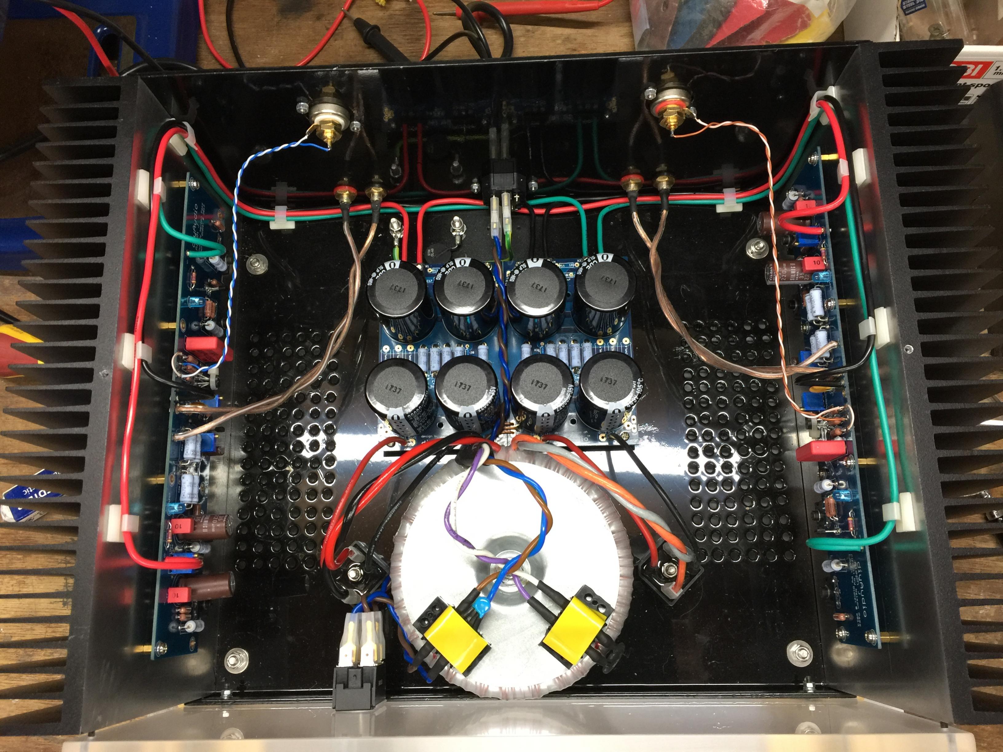

Hi all, I have a few questions about parts for the PSU:
1. If I'm using a 400VA 20V transformer and the universal PSU, will 18KuF / 35V capacitors work? I see those values in use in some of the builds on the thread, but with 18V transformers. Do I need to increase the uF to account for the extra voltage?
2. Are the Nichicons what people usually use for the PSU capacitors?
3. What are the pros/cons of using the diode section of the PSU board vs. the diode bridges that 6L6 uses in the build guide? The monolithic blocks 6L6 uses seem to simplify things, which is appealing to me...
4. I see on the BOM a range of possible values for the bleeder resistors. Any preferred value for this particular application?

1.with this load , you'll get around 1.25x more DC Volts than inputting AC Volts , so you're good with 35Vdc caps
in any case , don't go lower than 60mF as sum of all caps , per channel
2. these are good quality ones
3. personal preference ; I'm using metal diode bridges almost always
4. I=U/R ; 20mA to 30mA is enough ; calc dissipation as P=I^2 x R , go for 3-times declared power of resistor

always look at delta-I per part and effective Ug-s modulation ......... when having degeneration effect or NFB active , it can be much smaller than actual input signal
I agree with everything Zen Mod says.
1) You are fine with the caps you have.
2) Nichicon are great.
3) Simple is good. It's also less expensive. There may be an advantage to the fancy diodes and such, but I've built plenty both ways and can't tell much difference. I've been using discrete lately.
4) 2.2k 3W. 🙂. But anything 2K-20K 3W will work great, It just drains the capacitor bank when powered off.
