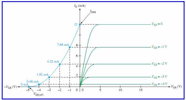

If you look at the transconductance curve of a JFET, it's flattest up near its Idss. I always assumed you wanted enough Idss to be over the top of what your CCS will deliver with a bit of error room, but not too much over so that you're operating in the less flat part of the curve.
However, I tried to model this in SPICE, and it didn't agree with my hunch, so I'm not sure.
Is this the curve you are referring to (attached)?
you're right with that , say 90% of Idss is sweet spot , at least what Big Boys said .......
though , you always need to take broader picture in perspective - what's delta-I for part and how much of transfer characteristic you're using
not same situation with one vs. two JFets in parallel , same Iq
not same situation part processing line level signal , or phono signal
not same situation having NFB or not
