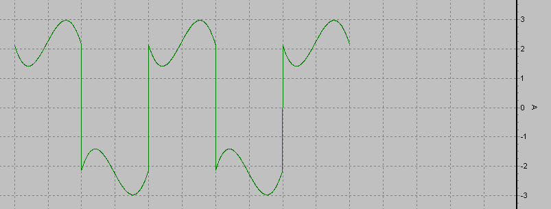

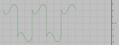

however - look at voltage and current in xformer and rectifier , not just on end of PSU
If I tell you that my next (proper ) amp will have current through xformer as attached , while needing 33Vac secs for 22Vdc@2A2 , without any sort of active regulation , what you'll think ?
![clown :clown: :clown:](https://files.diyaudio.com/forums/images/smilies/clown.gif)
that includes Mighty ZM too , who is pretty dumb regarding any software
![rolllaugh :rofl: :rofl:](https://files.diyaudio.com/forums/images/smilies/rolllaugh.gif)
every software is just smart as man using it
I hate tests, my head hurts, this is stretching my abilities which is good. Looks like if you were to invert the negative part, you'd end up with a slightly asymmetric sine wave that has a +2 DC offset. Am I on the right track? Why is the Vdc lower than the Vac - I thought it should be 1.4 higher before losses.

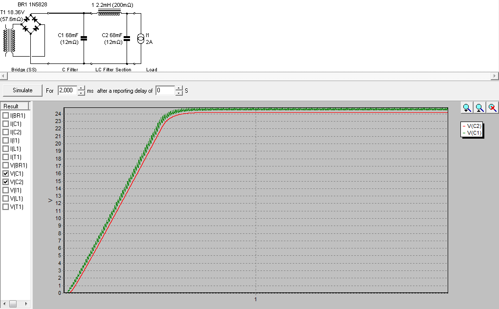

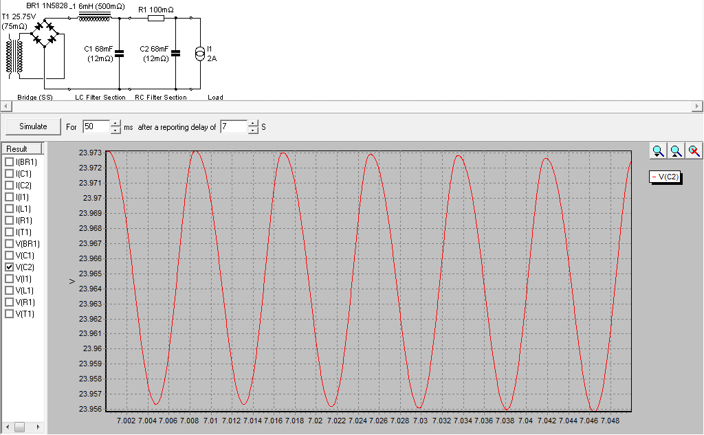

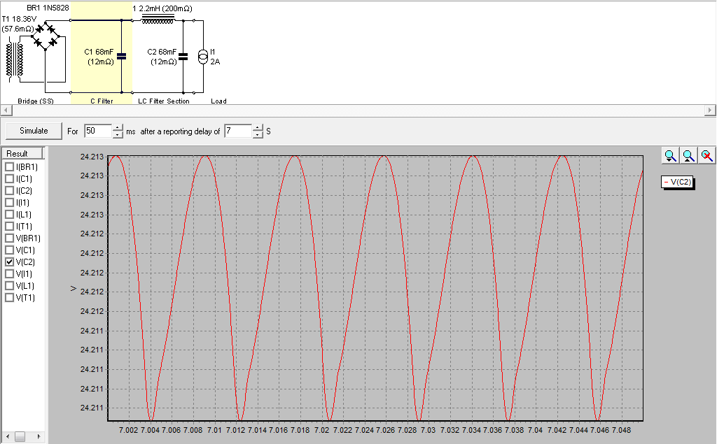

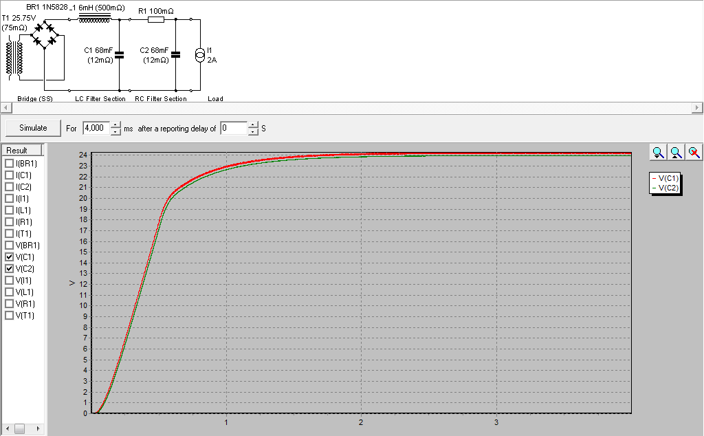

Tried to play with PSUD2, need your suggestion which one is favourable for dual mono configuration, pro & cons analysis will be much appreciated:
- CLC using 2x18V 225VA
- LCRC using 2x25V 500VA
for C6&C7, anyone try MKC type instead of MKP?

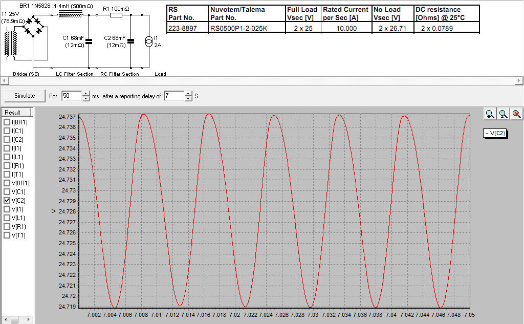

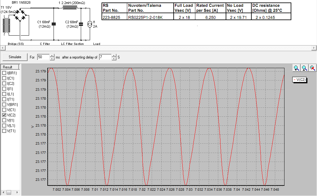

attached simulation results as ZM advise (previously i was confused with those 2 timing options). am I correct to put I meter @2A? I am using talema encapsulated datasheet information on this simulation. it seems that CLC gives better result as graph shows
right click on xformer - edit - click on button right of source res , fill in upper 4 fields
for effective internal resistance (impedance) of xformer , you need both voltages and Rdc of (both) primary and secondary
that's why I said that Ri of xformer looks too low
F1 is magic button in PSUD
