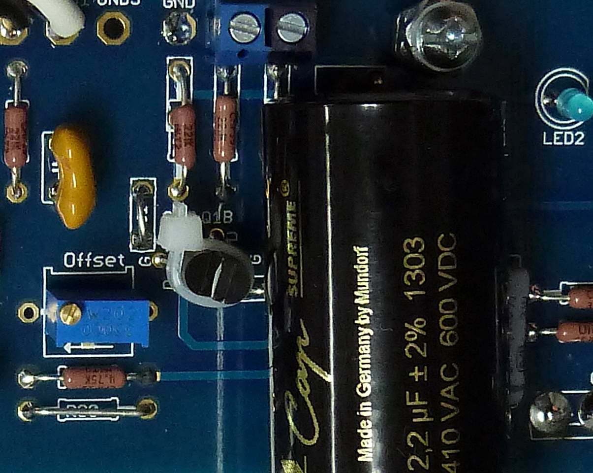

I can get R27a's to pre-set at 68K, but R7s read around 50 ohms and move +/- 10 ohms with multiple turnings. The Pot at R7 is "W202". Should I be able to pre-set to 1K? If so, am I more likely to have made a soldering mistake or a component misplacement or have a defective part?
It doesnt, mine measured 56 ohms! I set mine by measuring from the inside leg to each of the outside two, making sure I got 1K on each....that would center I think? (at least I hope!) I am starting up with a variac, so I think I will be fine if I just go slow and take plenty of time.

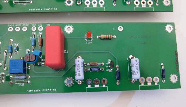

The bigger resistors are mounted soldier-style.
(I thought soldier style was the real term for that... maybe not...)
Just noticed this picture. I had always understood that "soldier style" mounting was straight up and down, usually with a u-bend and a parallel lead.
They guys are leaning just a bit. I call this style "drunken soldier".

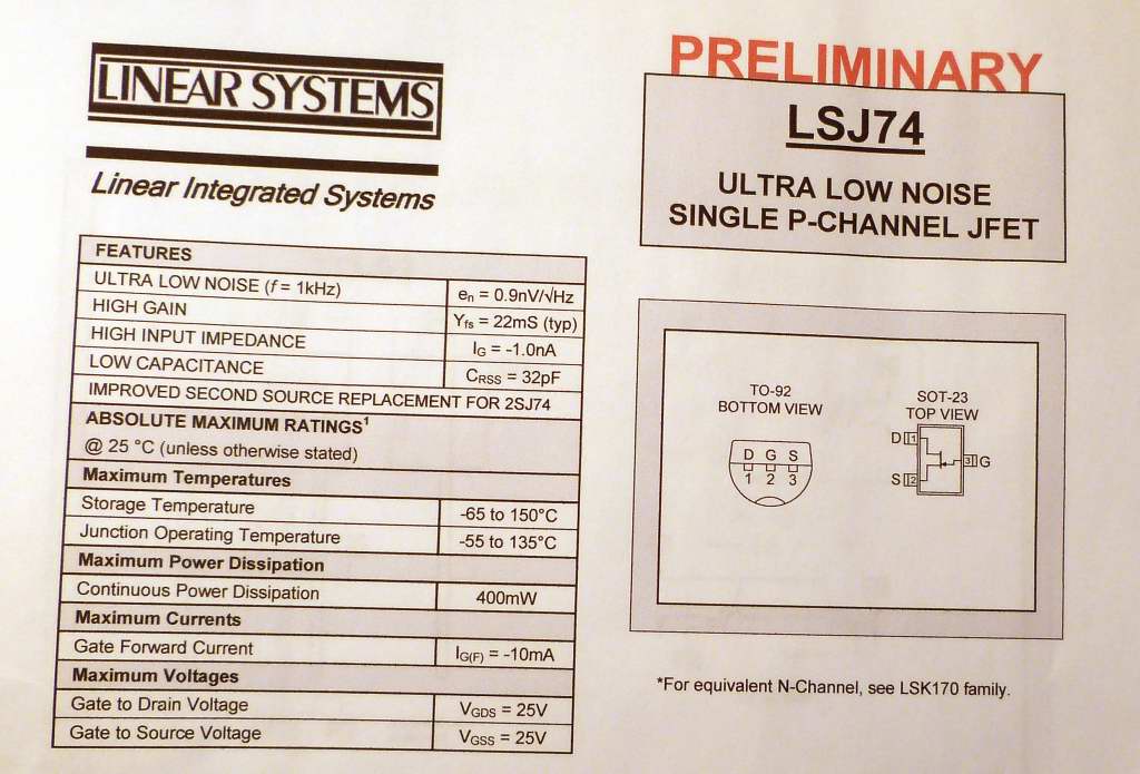

Hi Guys,
Completed my boards and tried powering them up using a light bulb tester (60W bulb). Things didn't go right, so I double checked everything, all resistors are correct, and everything matched build guide. Except that I used the Jfets from the DIY audio store. It appears that the pin outs are not the same as the Toshiba Jfets, and they cannot be oriented as shown in the build guide. So it looks like I need to pull them out and reverse the orientation. Am I reading things correctly ? Do you think that I damaged any thing else when powering up that I should check out ?
Thanks,
PJN
