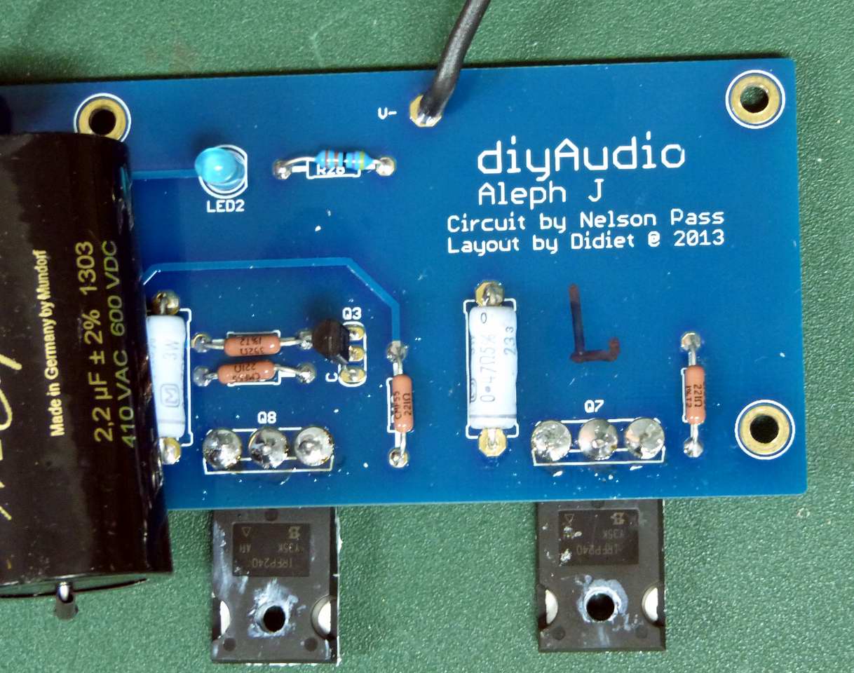

The way I interpret the data sheet I oriented them incorrectly(backwards). I do have a spare set of jets, but I'll try to gently remove the set that I have on the board and see if I can reuse them.
No. Your Jfets are in properly.
A normally functioning Aleph J will pull enough idle current to make a 60W bulb quite bright.
With the bulb in place, check your rail voltages, they should be even from + to GND and - to GNG, although low.
Check DC offset, it should be less than a volt.
If you have those two measurements, replace your bulb with a 100W and try again, the rails should be a bit higher, and the dc offset about the same.

Look at data sheet again. Those pins you see in the diagram are sticking up. Pins will of course be down when in place.
Now compare them.
Russellc
DOH, You guys are right, I misinterpreted the data sheet.

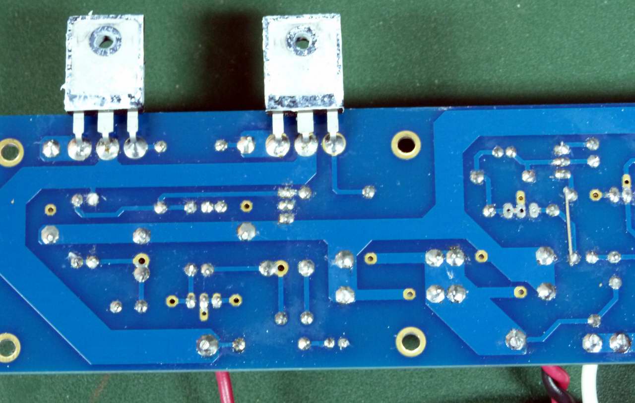

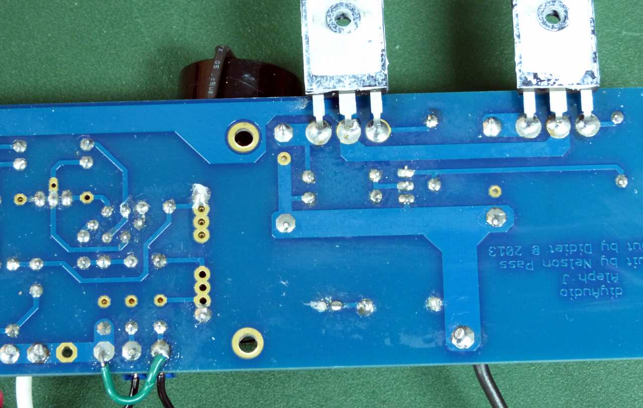

I did get one channel up and running successfully, but I'm having trouble with the other. It doesn't seem to be drawing any power. The rail leds light and I'm getting +/- 24v on the rails to the board with a light buld tester supplying the power, the bulb doesn't glow at all. On the good channel the bulb glowed brightly. I'm getting 24v DC offset at the output, with the inputs shorted. I've triple checked the resistors, all are as spec'd. I've replaced Q1A, Q1B, Q2, Q3, and Q4 with no change. I have a set of mosfets for Q5 - Q8 in reserve but I haven't changed them out yet. I've attached some closeups of the board as well as a schematic showing voltages. Please note that the voltages around R14 are really -24v, and R6 is jumpered with a wire underneath the board. I'd appreciate If you could take a look and see what I've missed.

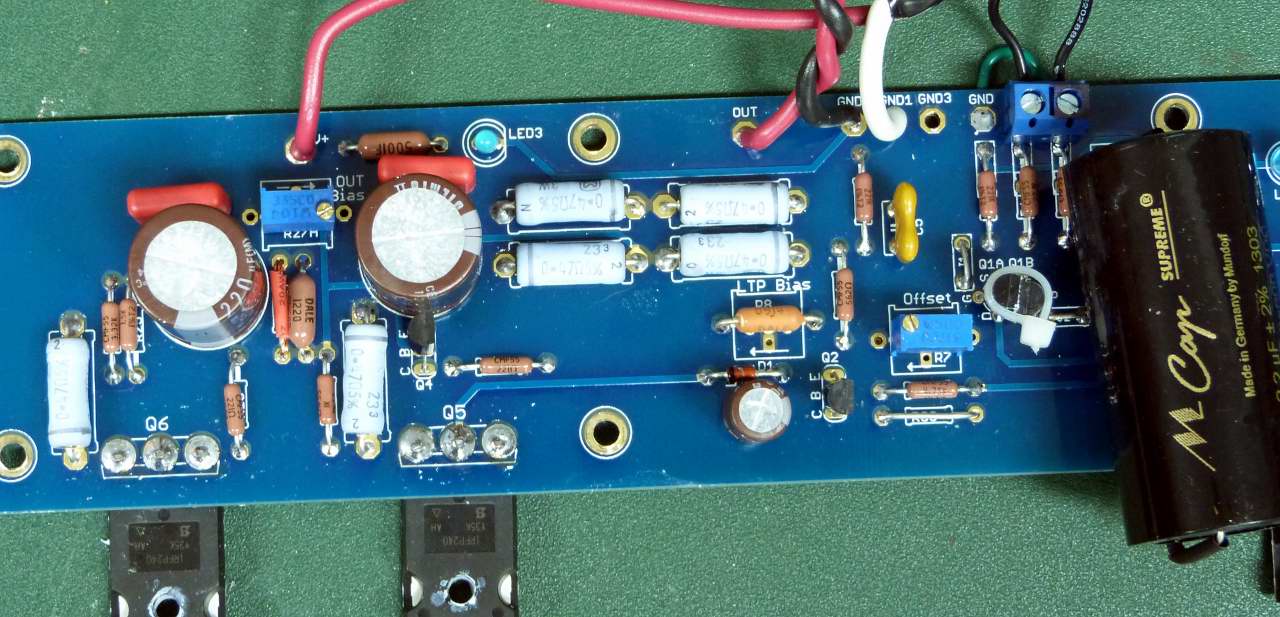

Hi Itsmee,
I'm reading 0.39v across R7. I've had it preset to 1K before startup, and moved it through it's full travel in both directions with no effect on DC offset. I've also had R27A set for 68K before startup and have moved it through it's full travel in both directions with no effect on bias.

yup , I saw this
but - I'm somewhat lost in that pcb , with several possibilities where shorts are going , where are not going
I believe guys with more personal insight in these pcbs will chime in
though - with continuity test - try all important ( aren't they all ) connections
re-flow (from both sides) all points having vias - maybe you have failed via connection ....... especially if you had trouble to push any part's leg through hole
Thanks Zen Mod,
I also wrote down the voltages around R 0 and R12 incorrectly Should be 23.9 around R12 and 24 around R10. I've been staring at the schematic for a long while and I can't understand it so far and I'm getting burned out. I'll put things aside to rest for a day, reflow all joints, and replace Q5 - Q8, that way all of the active parts have been replaced. I didn't check any of the caps and maybe I have a bad one that is shorting out so I'll check that out. And give it another whirl and compare the voltages to the good board.

Hi PJN,
First, always follow ZM's sage advice.
If R7 is set for 1K, then you have 0.039mA flowing through Q1A. Fit a resistor in the R30 position so you can measure the tail current.
A quick way to check if Q1A & B are working, make sure R7-//R7 is set to 1K, and set R27 to minimum bias; short Q1A & B source's to 0V - is there a change in the voltage across R7?
I agree you've got something wrong in that LTP. You do have 8.3 mA at the top (R8) so that's normal, but where is that current going... Your output FET's (Q7, Q8) need 4.5 volts or so from gate to source before they turn on (current flowing). I would check for shorts / open paths around Q1A and B. Do as Itsmee has instructed. If completely stuck I would pull Q1A and B out and measure the Idss of each. Basically you've got to get that ~4.5V across R7 or this puppy ain't working.
PJN - what kind of bipolar transistors are you using in your build? BC? ZTX? Something else?

Hi Guys,
I measured the IDSS of the JFETs just before I replaced them the other day, they both measured 12.51 mA each. The bipolars that I used are Fairchild BC550C and BC560C, they are the exact same types that I used in the good board. I do have some alternative ZTXs on hand though.
The Idss is fine - the circuit should have it's operating point determined by the CCS, instead of their self-bias current...
If you are using BC, then they are in correctly.
Hi Guys,
I am a dope, after reflowing all the joints, I noticed that "someone" put the wrong pot in for R7. I had a 500R pot in by mistake instead of the 2K pot. I pulled the pot and plugged a 1K1 that I had on hand and everything comes up fine. I'll need to order another pot because the offset is 200 mV. But on the bright side this has been a learning experience for me. Thank you all for your kind help.
PJN
