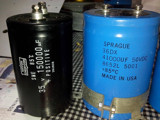

need advice
i have some caps for use in aleph J
which one will perform better sounding for the J ???
No idea. Got bunches of the sames but I have come to like multiple small caps, 6800-10000 over cans. Tey 85 degree, dont mount in burning ampz.which one will perform better sounding for the J ???

I'm planning to use 6x 150.000uf/35v per channel (monoblock)
Papa sugest a slow diode in class a amp, but he only using 8x 15.000uf for his stuff.
Not sure for the big can caps.
Is it better to use fast or slow diode for bridge? Thanks
I have some MUR3020WT for the fast bridge.
And IR GBPC3502 35A for the slow.
fast + soft recovery + reliable
The latter will be an issue with such overkill of capacitance. 😀
The MUR3020WT are fine, but I'd fit them on heatsinks though.
I don't need to mention you'll need a soft start, mate. 😉
