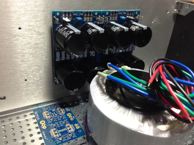

What are these called?
12B4A - I like the look of your build, and it is showing some of the same issues I will have with the Aleph J in the 5U chassis. A small question, what are the blade connectors soldered to the board called? I have tried searching for blade and snap on connectors, but cant seem to find one that will solder into the board like you have done here.
Thanks in advance.
NM - searched for "tab terminal" and they popped up.
