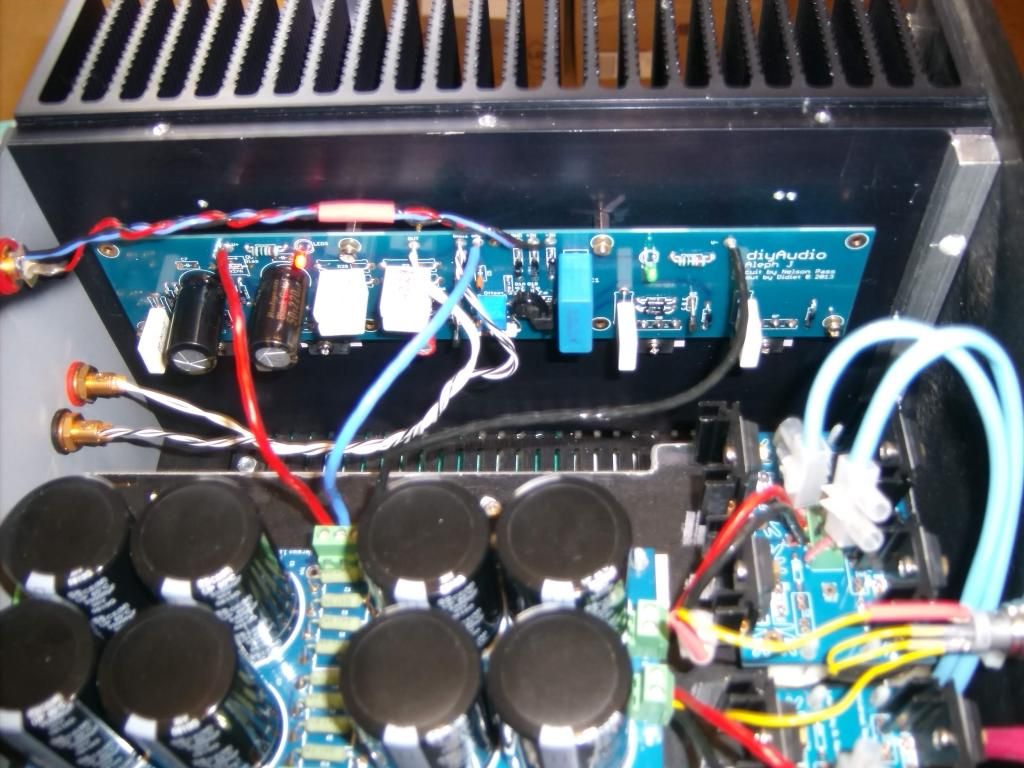

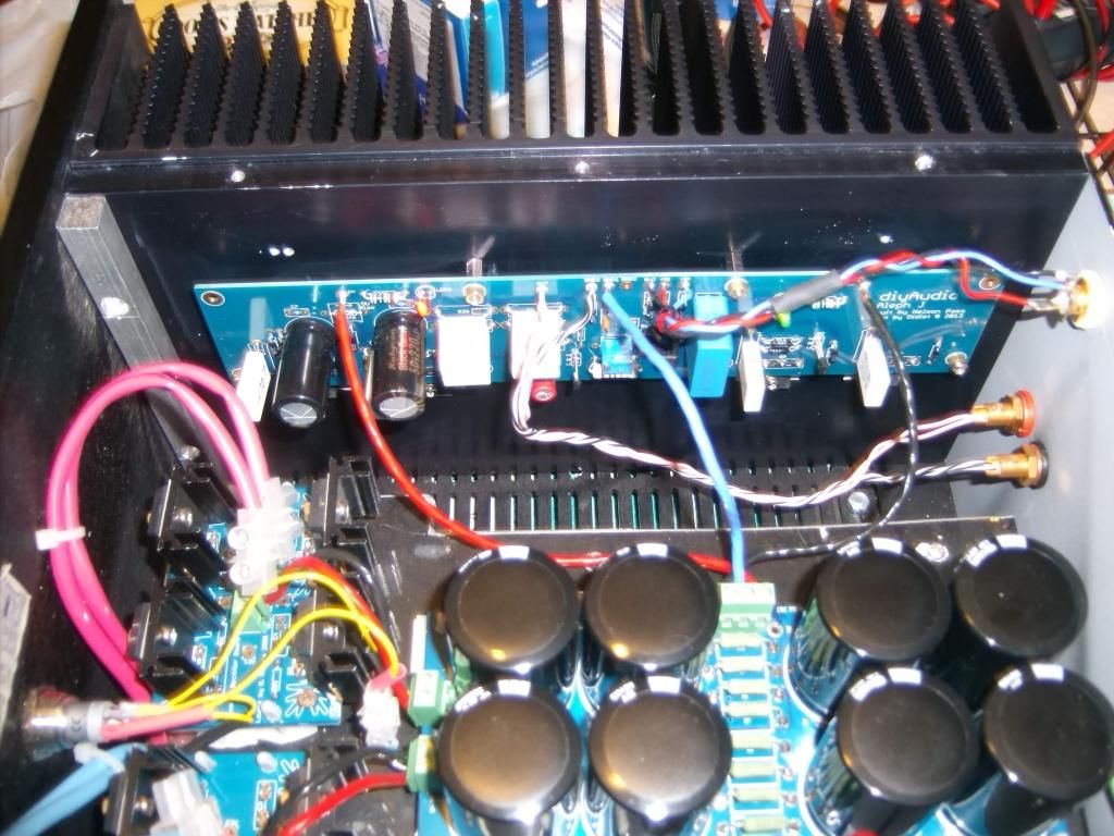

Jean - For heatsink size, the 4U chassis from the store should be considered the absolute minimum. These amps do get hot. 🙂
Wengtech - A 20+20V transformer will be fine. It's going to run a bit hotter, but you can always turn down the bias a bit if needed.

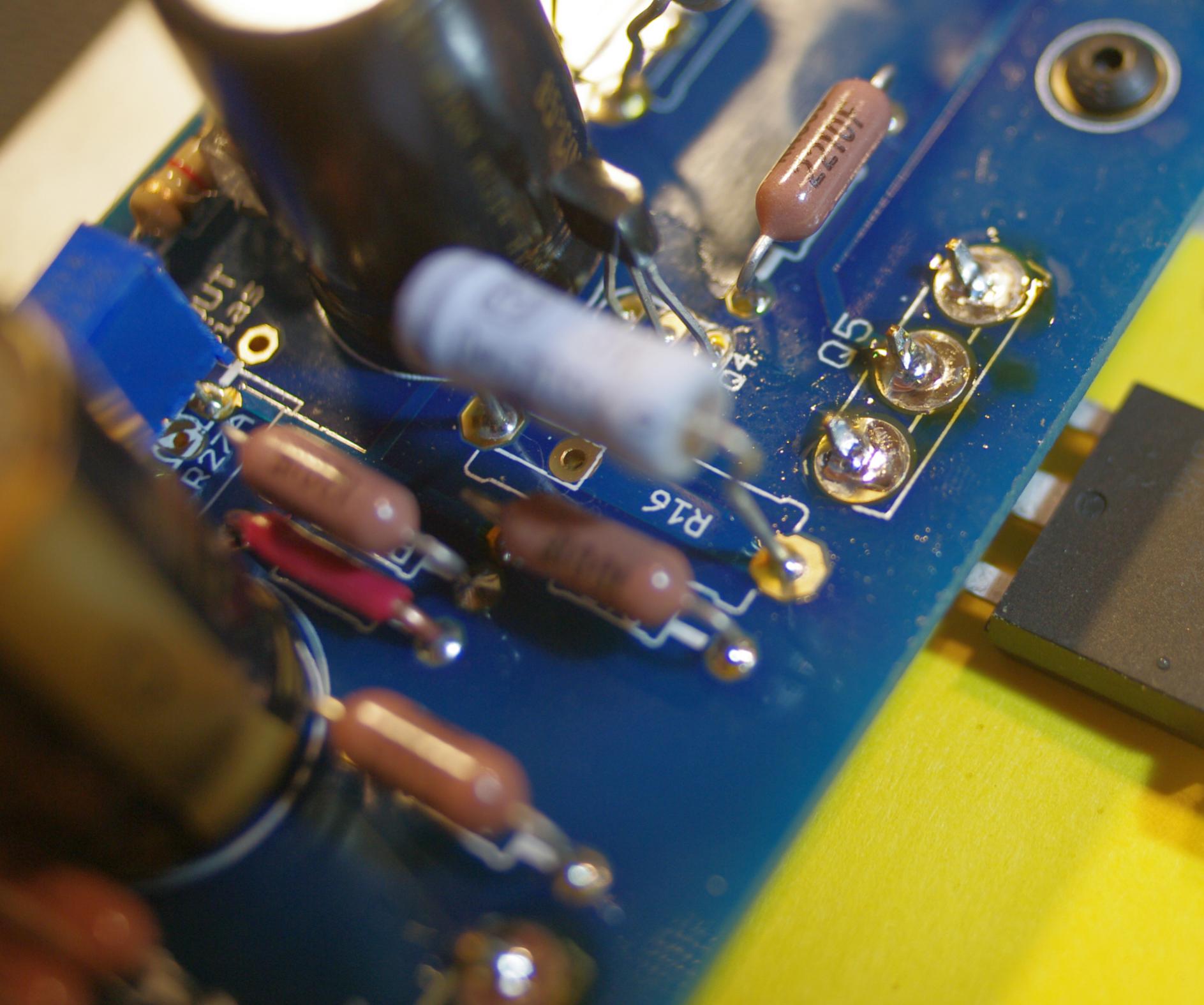

Your soldering looks fine... although you are missing some transistors... 🙂 🙂 🙂
Seems like a huge chassis for Aleph J, I am all for overkill but I am trying to understand why you say 4U is minimum?
According to Nelson, these dissipate about 60 watts per channel and should be happy with 25 deg C rise above ambient, or 0.4deg/watt or less per channel for heatsink.
What is the rating of the 4U case in terms of C rise?
