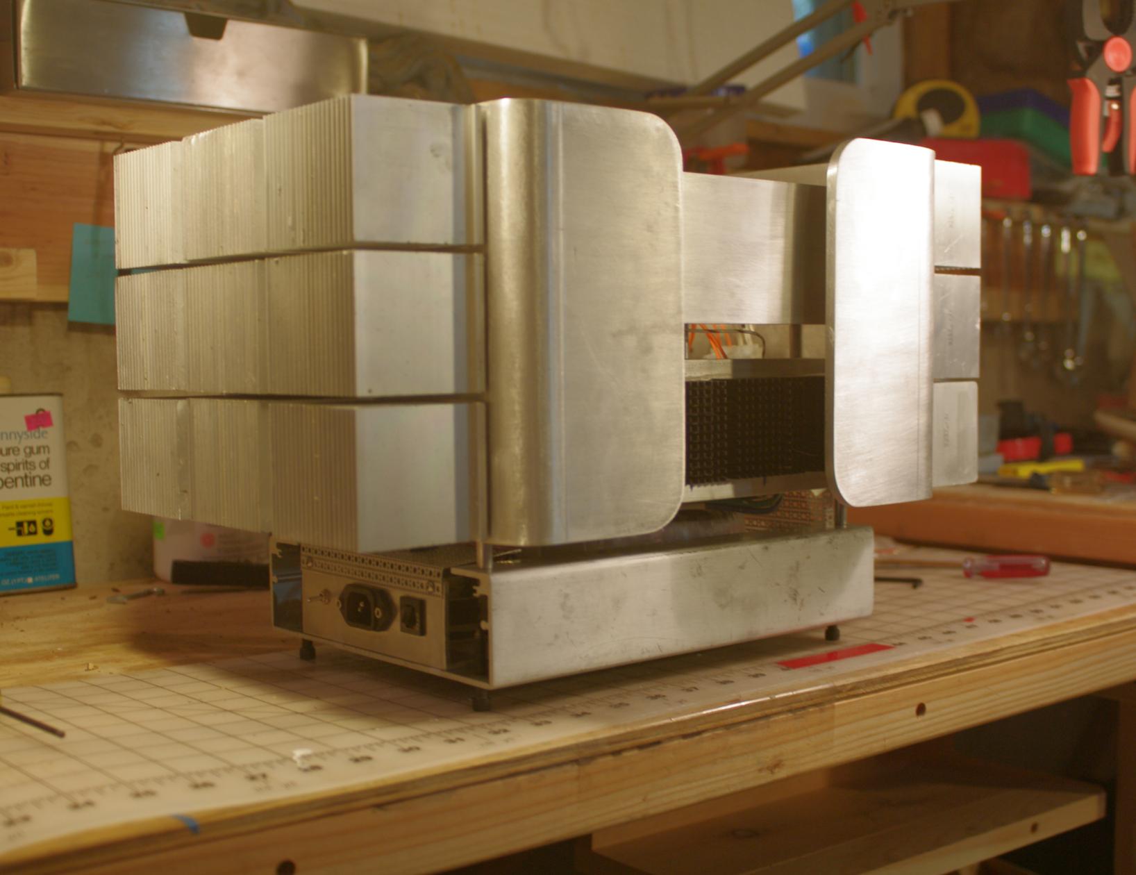

My "J" stands for Junkyard as my chassis came from the recycling outfit down the street. The heat sinks are assembled from 18 smaller computer heat sinks. The assembled heat sinks are about 14 pounds each and stand out, away and elevated from the base which itself is a tiered affair. It reminds me a bit of one of my old haunts, the Shapiro Hall of Wayne State University.

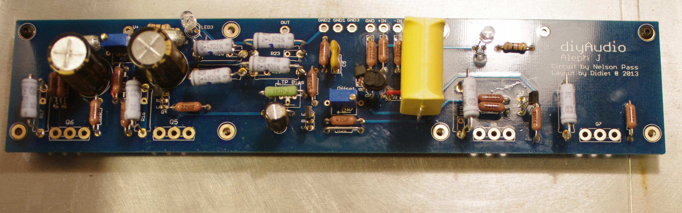

Take a well-lit, in-focus photo of the PCB and let us take a look.

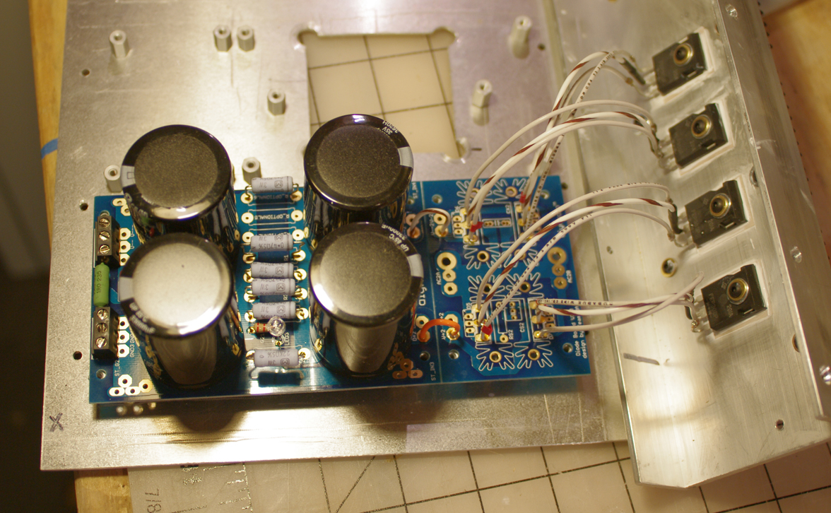

new pics

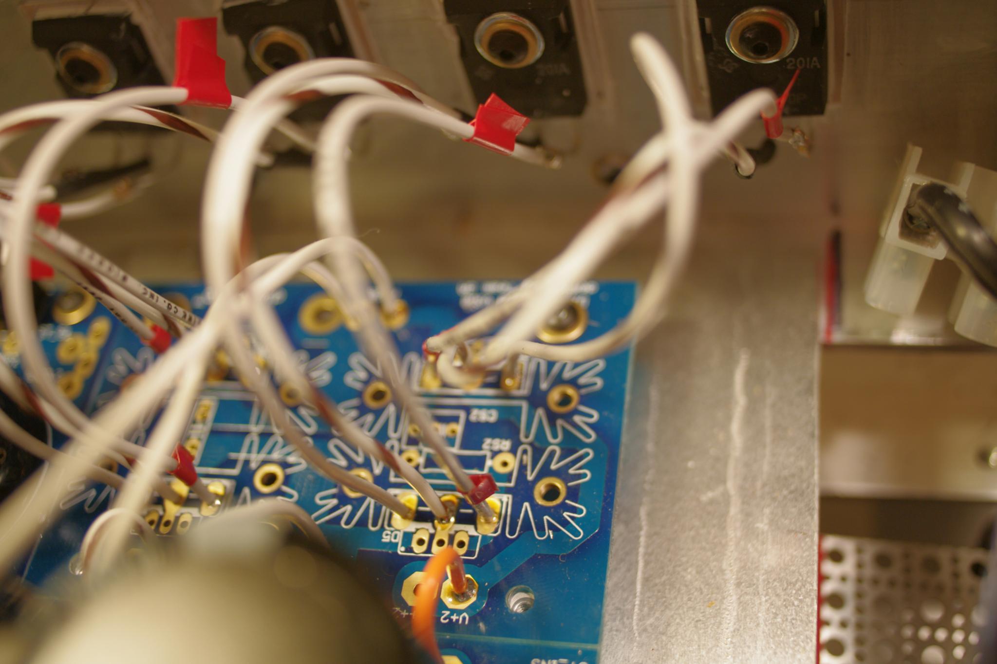

Got it torn down and tried some new pics but it is darn hard to get all the leads out of the way...
The flying leads to the rectifiers I have flagged and checked three times but that only means I did what I intended. Orientation seems appropriate to the board markings...same with the caps...the (+) mark was sometimes obscured by other markings and there is no other build of v3 I found to look at...
What do you think?
What do you think?

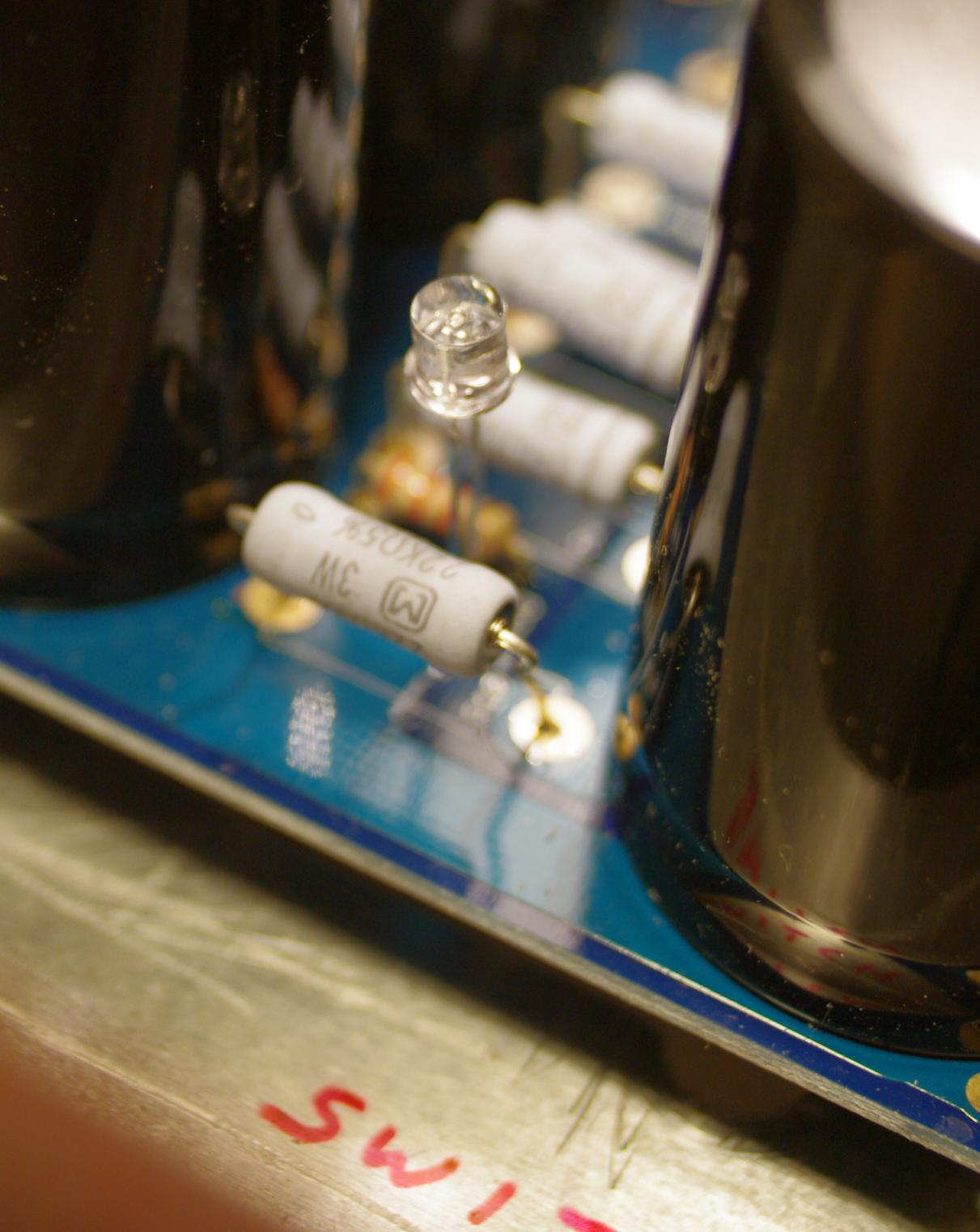

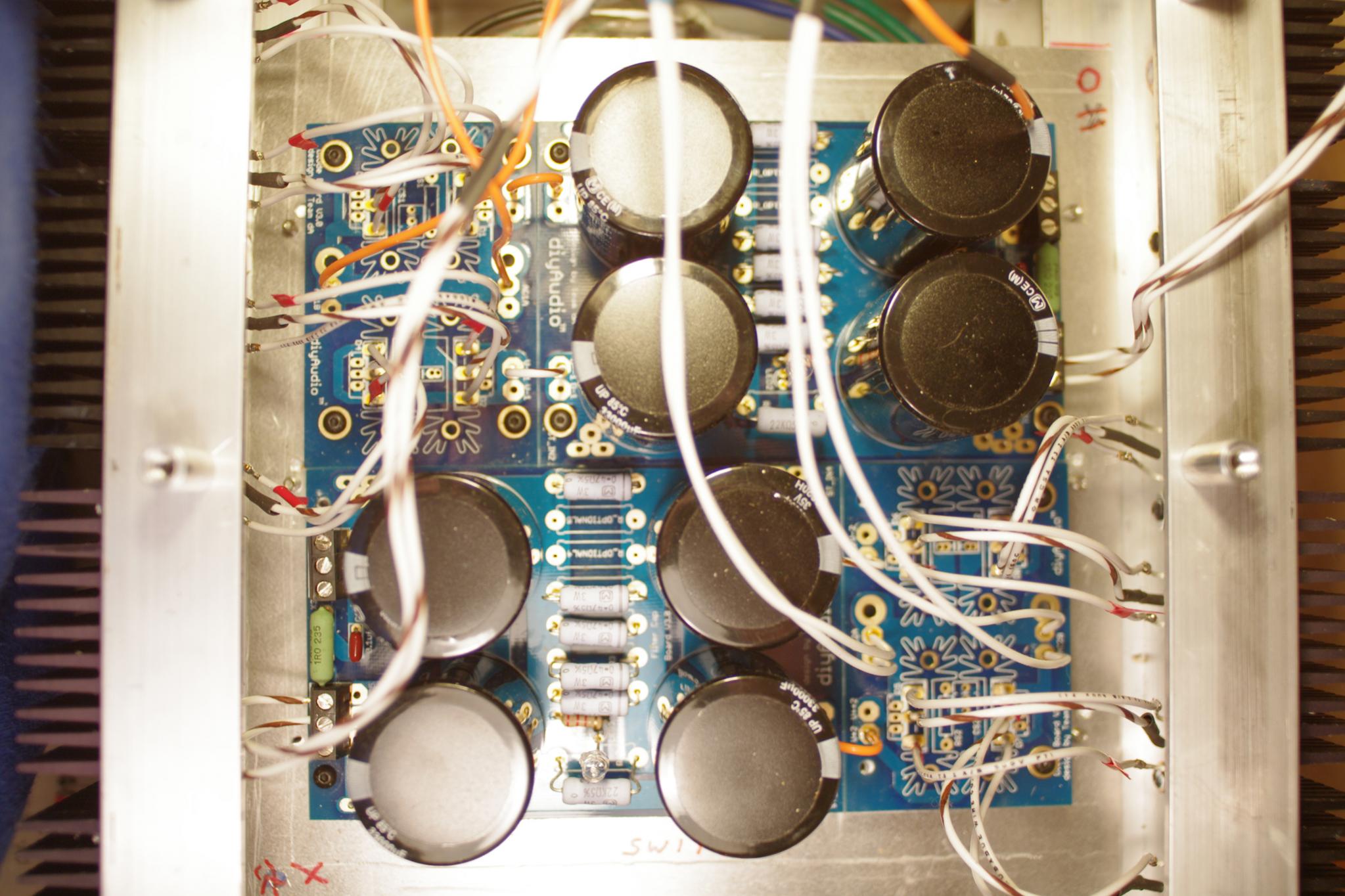

Aleph J PCBs
It occurred to me before I went to sleep you might want ALL PCB pics...

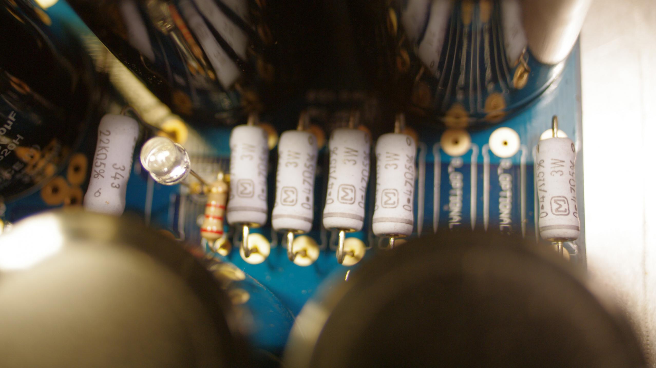

I include a close up of the orientation of the BJTs just for good measure. Besides those only the polarized caps could get screwed up. All the other LEDs light up save the one on the power board...I'll turn that one around this morning.

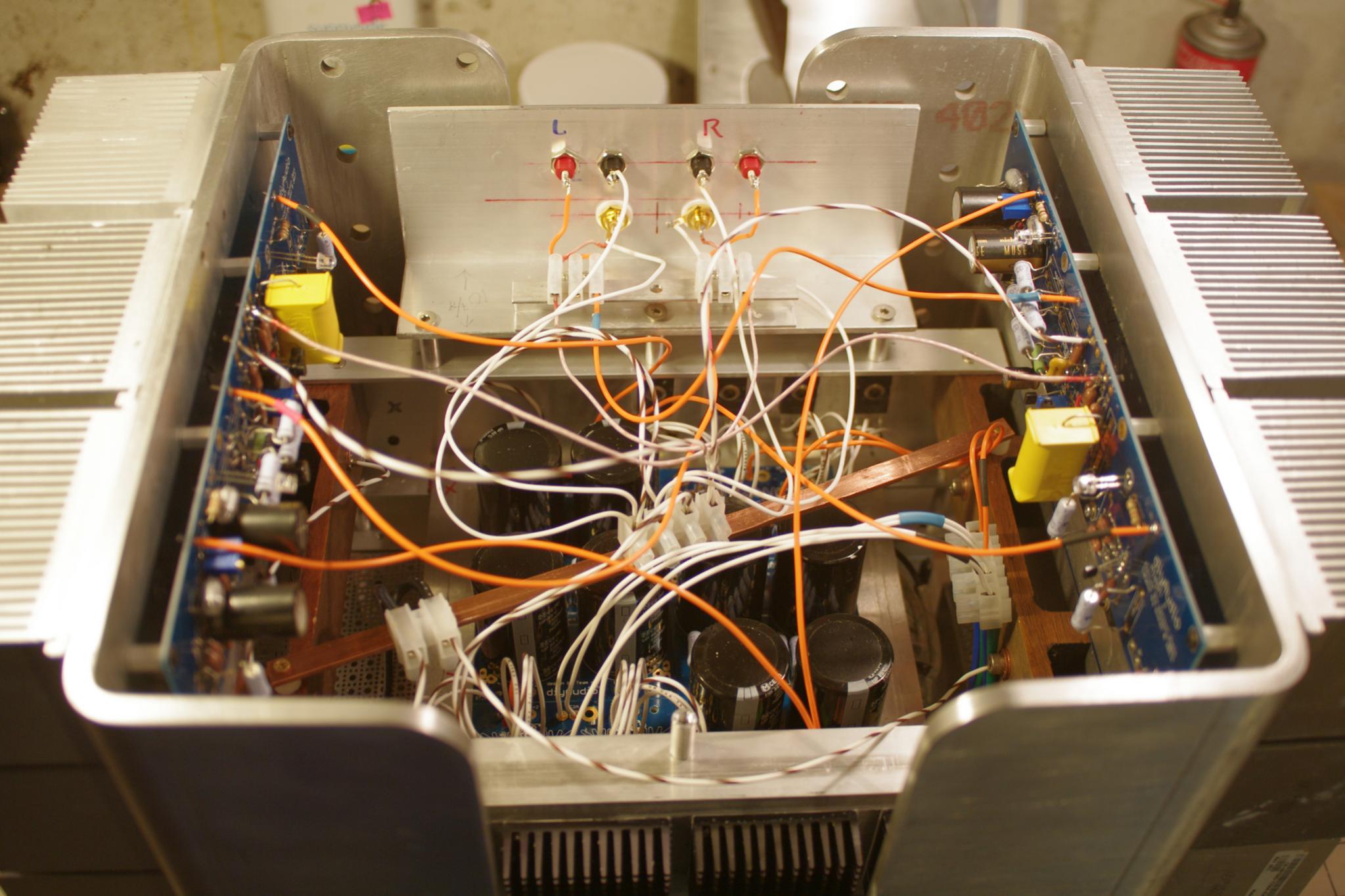

When something is screwy one should go over the basics (left off/caught between the v.3 power supply thread and the Aleph J build: both boards get a V+ and a V- from the PSU, all grounds go to the star ground, "out" goes to speaker terminal (red)-one board/speaker terminal, "in+" comes from the center pin of the RCA jack. Right?
The only thing I know I have done differently from the pictures I have found of other builds is that I took the ground wire from the RCA jack directly to the star ground. The only ground for each board is the GND1 to star ground.
I'm thinking the above is my issue...Oh, and the wires pictured to the one Aleph J board are not soldered or the ones I used, that was a practice/dry fit, Follow the last image if possible; that's how I tested the amp.

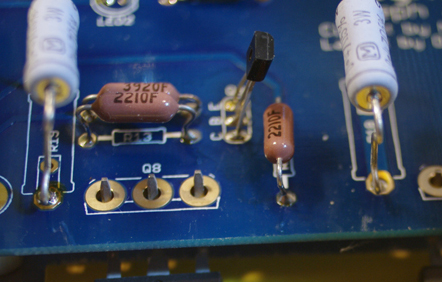

I can't see it well on the pictures, but is -IN grounded? Is there on R2 a 2213 or 2210 marking?

2213 is ok, you should ground -IN, though it wouldn't have much to do with bias and offset...
