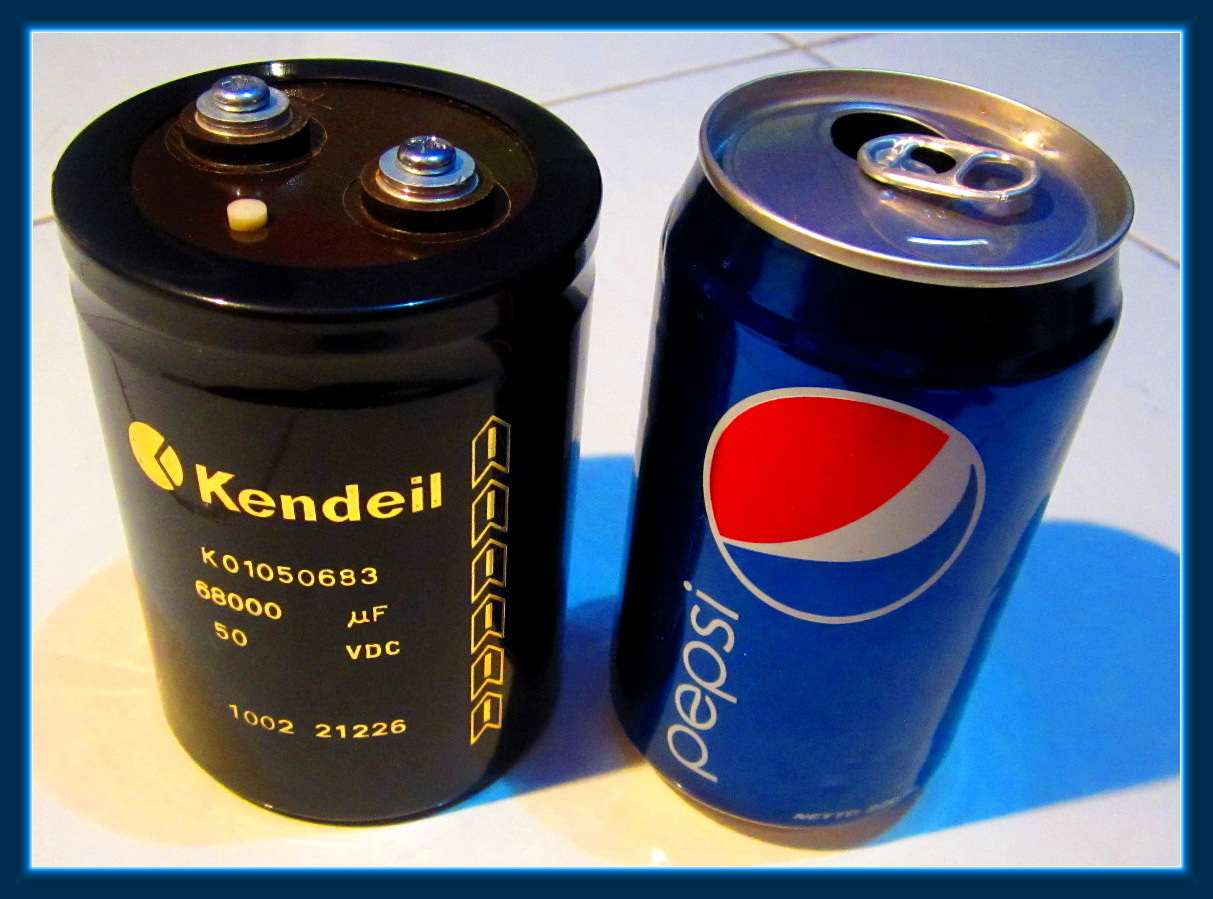

another small progress due to tight budget,collect parts slowly. I have watched umut1001 ebay kendeil item for long time, but never clicked "buy" button, mostly because of the price and shipping cost 🙁 but being patient lead me to local senior diyer who does not need his big caps anymore and I pickup his :treasure:
sure, dual mono will be the plan. 2 talema 225VA beneath those caps will be next things, but it will be the matter of $$$, got talema importers here 😀 and other parts on pcb are easily available.
Should I go CLC? I'm planning to ask my friend to hand wound it for me, 2.2mH using 12AWG
Wow, nice caps!! But the "Coca Cola ones" sounds even better 😀
