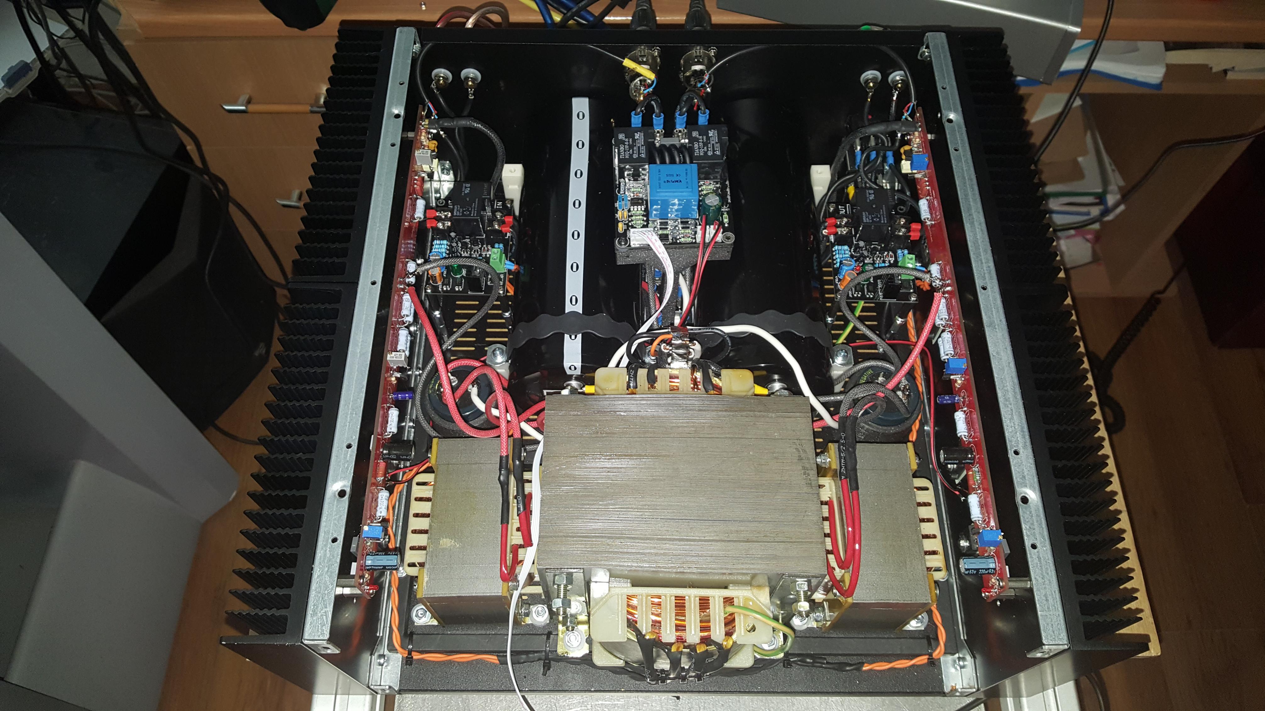

I just finished the amplifier. Everything works fine. I still have a dumb question: in the conditions where I have no hum or noise, the power is 30W without limiting, what can be the differences if I replace the two transistors 2SJ271 with two SJ74 matched and originals?
I have +-28V, 1,1A/ch Bias, 0.01V offset
I use with XLR IN, the only thing not good is when I put IN- to GND for using RCA cable, the ampli start to have hum…
Thank’s

Just wondering, are there distortion measurements available for the Aleph J under load?
This is what I get:
Load is a power resistor of 8 ohm.
R24 (dynamic CCS feedback) 950 ohm for 50% ratio.
DC bias is 450mV/0.47R approx. 1A/fet
2 1nF caps installed (helped THD a bit, but circuit was not oscillating)
Clipping at 15.5V RMS (30W)
Measurements at 14V RMS (24W)
100Hz 0.056 THD
500Hz 0.25 THD
1KHz 0.38 THD
10KHz 4% THD !
20KHz 8% THD !
The pcb area around base Q4/R27/R15/R24 is quite sensitive. So moving the extra 1nF cap to a physical other place might help?
Do I have to hunt after a problem or are these figures normal?
Thanks!

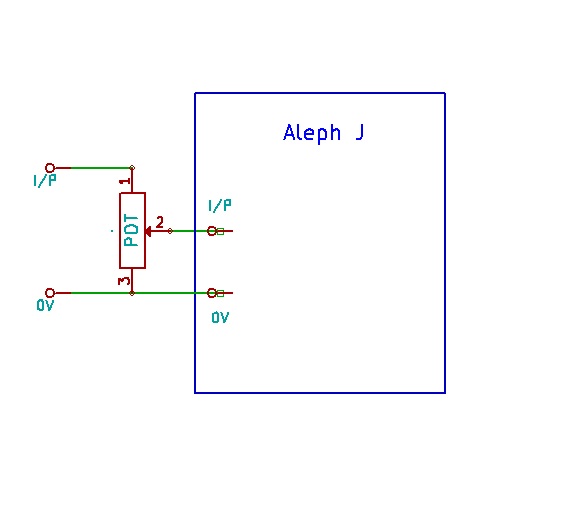

Nice answer...but seriously? Where? after the first resistors r1, r3 with a T circuit?
I don't think its that easy, is it? That's why there are Buffers and Preamps that do this but keeping impedances in the 'correct' realm.
A power amp just does it's thing, no volume control. Perhaps for testing purposes, but not for a final solution.
I know nothing about this though. Maybe it is as easy.

Big question...how and where insert a potentiometer for volume control. Thanks for the answers
In front. After dealing with the surprise unstated detail that the amp has balanced inputs, you can deal with the surprise unstated detail that the potentiometer has 4 gangs. Two for the left channel (+ side and - side), two more for the right channel (+ side and - side).
Here is one example
9mm ALPS A50K 50K Audio Taper Potentiometer 15mm Knurled Shaft 4 Gang-in Potentiometers from Electronic Components & Supplies on Aliexpress.com | Alibaba Group
