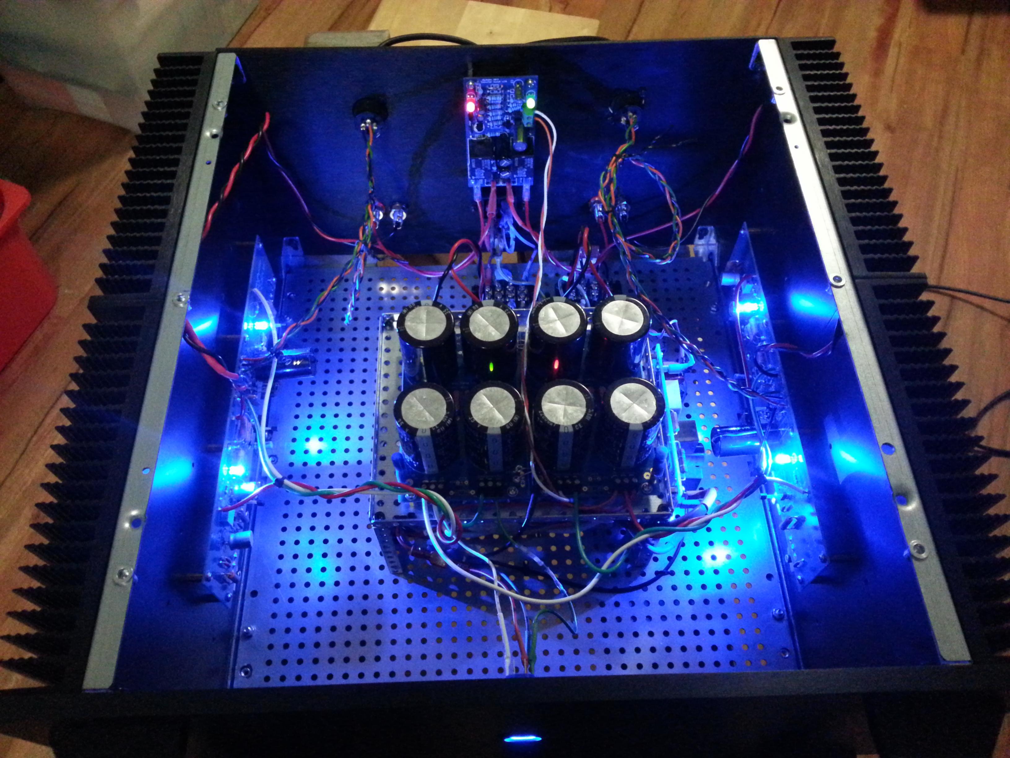

I typically hook my turntable into the phono stage then into the aux in on the emotiva which until today was hooked up to an adcom gfa 5500.
I tried hooking the Aleph J in place of the adcom(using the rca jacks). Very loud buzzing I didn't try playing music.
After I tried running the phonostage directly into the aleph J. loud humm. i did play some music but the volume was very loud.
just now I tried hooking into the headphone jack of the emotiva with the same bad buzzing/hum results...
maybe I have a ground issue?
What a difference two little jumpers make! Somehow I missed that the input - has to be shorted to ground when the input is single ended (RCA jaack input). But some long looks at 6L6's COMPREHENSIVE build guide and I saw some thing that looked different.
Thanks for all your help Jim!!
I am now enjoying the sweet sounds of vinyl and suddenly my collection sounds new🙂

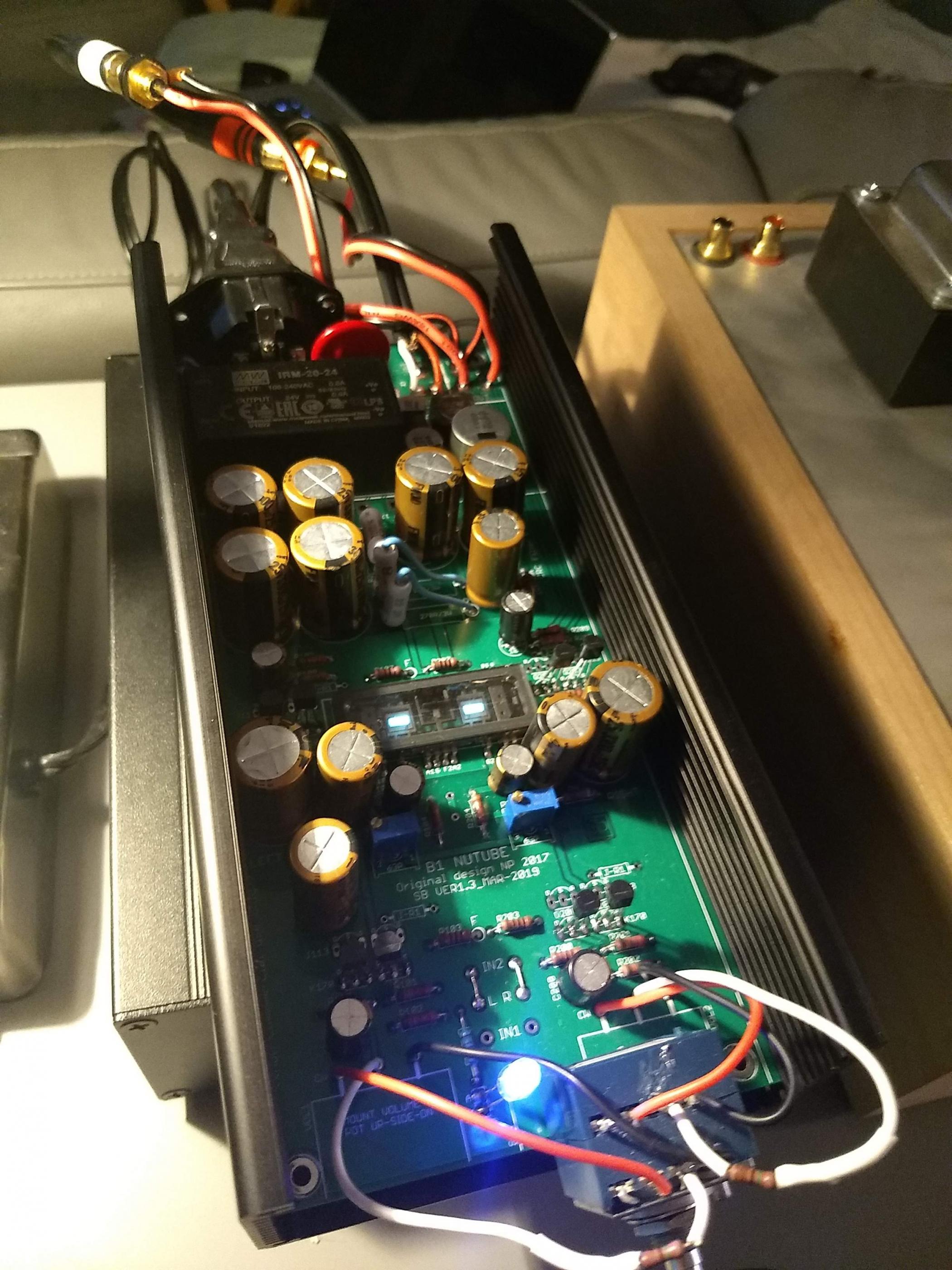

Couldn't help myself... Just had tp hook the new beast up to the, mostly finished, NuTube preamps I'm side by side building.
The result is pretty amazing! I didn't think the sound would change so dramatically. After moving the bias on the NuTubes down to 10.0volts (formerly set at 10.5volts) the sound is surpriingly both more clear and warmer. A very pleasing combination. Vocals have a realistic presence that's almost hard to believe i find myself looking around the room grinning in disbelief.
The NuTube is not without it's drawbacks. The microphonic ring is at a particularly cruel fequency and not easy to get rid of. And the circuit could benefit from some cleaner power, maybe it's destin for batteries?
So far, however, I can find no flaws in the Aleph J's sound. the resolution at the high and low end is just stunning. The sound is relaxed and natural when playing Johnny Cash American recordings you'd swear he's in the room. afterwards I put on Nine inch Nails the Fragile and I was surprisethat there was still paint on wall when it finished playing. The guitar was as forceful as a live show without sacrificing the other layers of complicated sounds.
I think it's gonna be a long night...

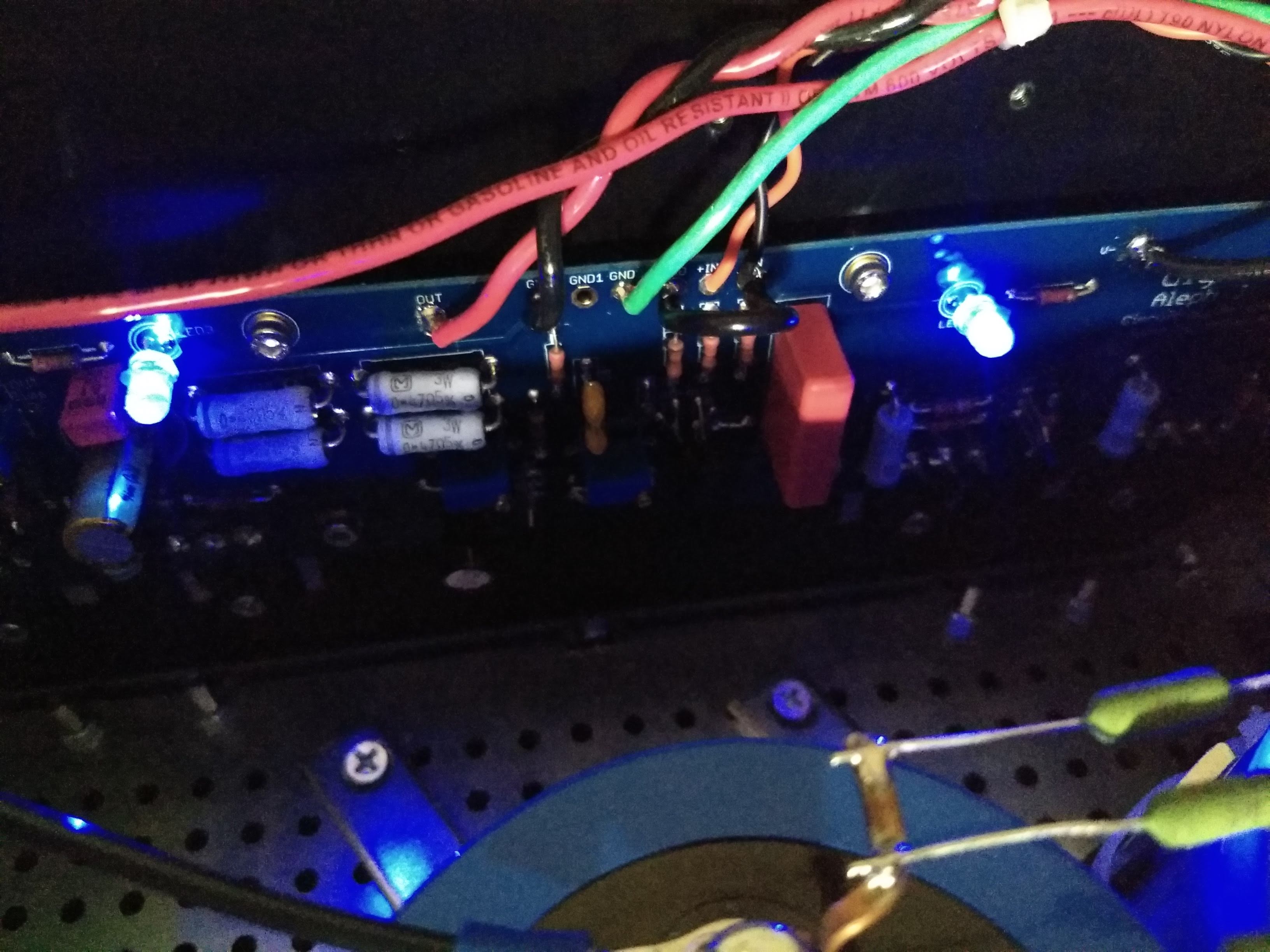

Hi guys! Stupid question...I've mounted two PCBs and for one no problem in the setting of bias and offset. For the other now way of setting it. I move all pots but just little variations can be seen (i.e. I have 22 V on that output jack and moving both offset and bias pots I cannot modulate this value. DC volts between source resistor is always 0). Do not know where I can start checking....
Assuming you have properly stuffed the PCB and have all the smaller transistors in the proper spot and aligned correctly, you have a bad solder joint somewhere.
Poke and move and flex the PCB a little with the meters hooked up and see if you can see a change, and if you do resolder there. If no change, reflow everything.

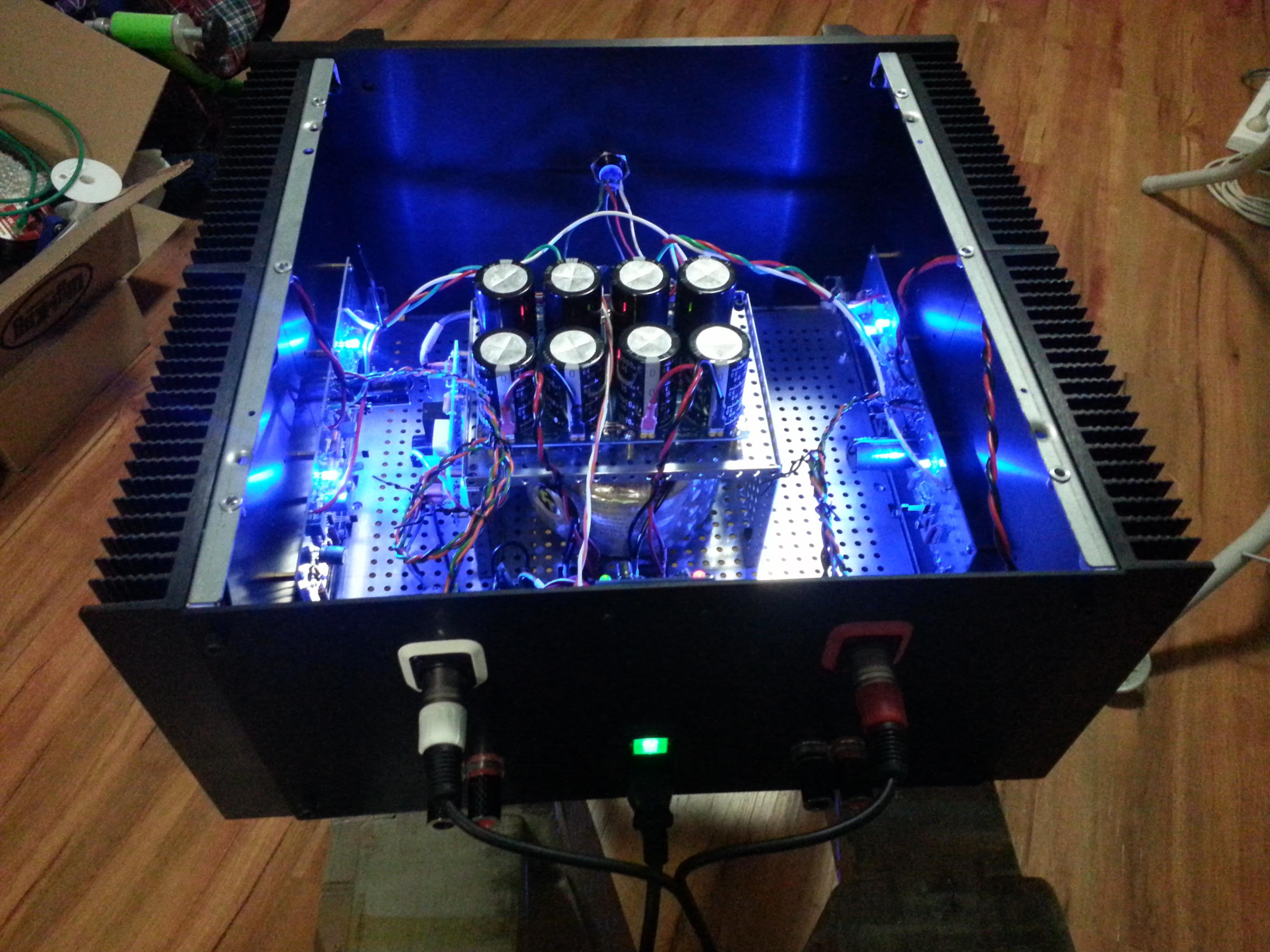

Not the tidiest wiring job ever but it's finally finished and most importantly it works. I'll do a tidy up in due course (maybe never?).
Thanks to Nelson, 6L6, didiet, diyAS and everyone else for their help along the way.
Got the big fella biased at 450 mV and the heat sinks are registering 43 - 45 °C. That's the advantage of the modushop 5U chassis.. 😉
Set the emissivity of my IR thermo-gun unit to a more sensible 0.85, so those temps are more 45 - 47 °C down the bottom of the heat sink. Just getting a quick audition (a bit hard with a 4yo - not me - in the house ) of the Aleph J with my main system (includes floor standing speakers with 92 dB/W/m) ... noice mate, noice ! 😉
