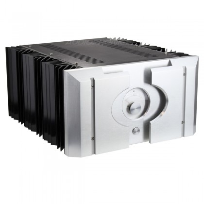

Are you serious about that chassis? Looks like a full on Pass unit. Care to share the source? I used the modushop/DIYAS 5U UMS unit and it's turned out fine. I opted for the front panel handles. I'd suggest that that is a worthwhile addition - the big fella certainly has some heft.

Assuming that the chassis is yet another Ebay special from China, one needs to be very careful about reading the dimensions. So far, all of the chassis of this look-alike design are considerably smaller in both heat sink area and internal volume compared to the Modushop Dissipante 4U, 400mm deep chassis available through the diyAudio store.
There are good, suitable chassis available, but these copycat N. Pass designs are overpriced for what they actually are.

The case actualy is a little version of the Pass: 396x360x195mm, internal: 240x360x188mm
Hope everything will fit ...

It's from Audiophonics
100% Aluminium DIY Box / Case with Vu-meter for Audio Amplifier 396x360x195mm - Audiophonics
Don't know where from, but Audiophonics is a good supplier.
That is a taller chassis than the ones I have seen. The heatsink area is close to the one from Modushop, but the internal area is still a little smaller. If you want to use a dual-mono power supply (highly recommended), then some creativity will be needed to make everything fit inside.

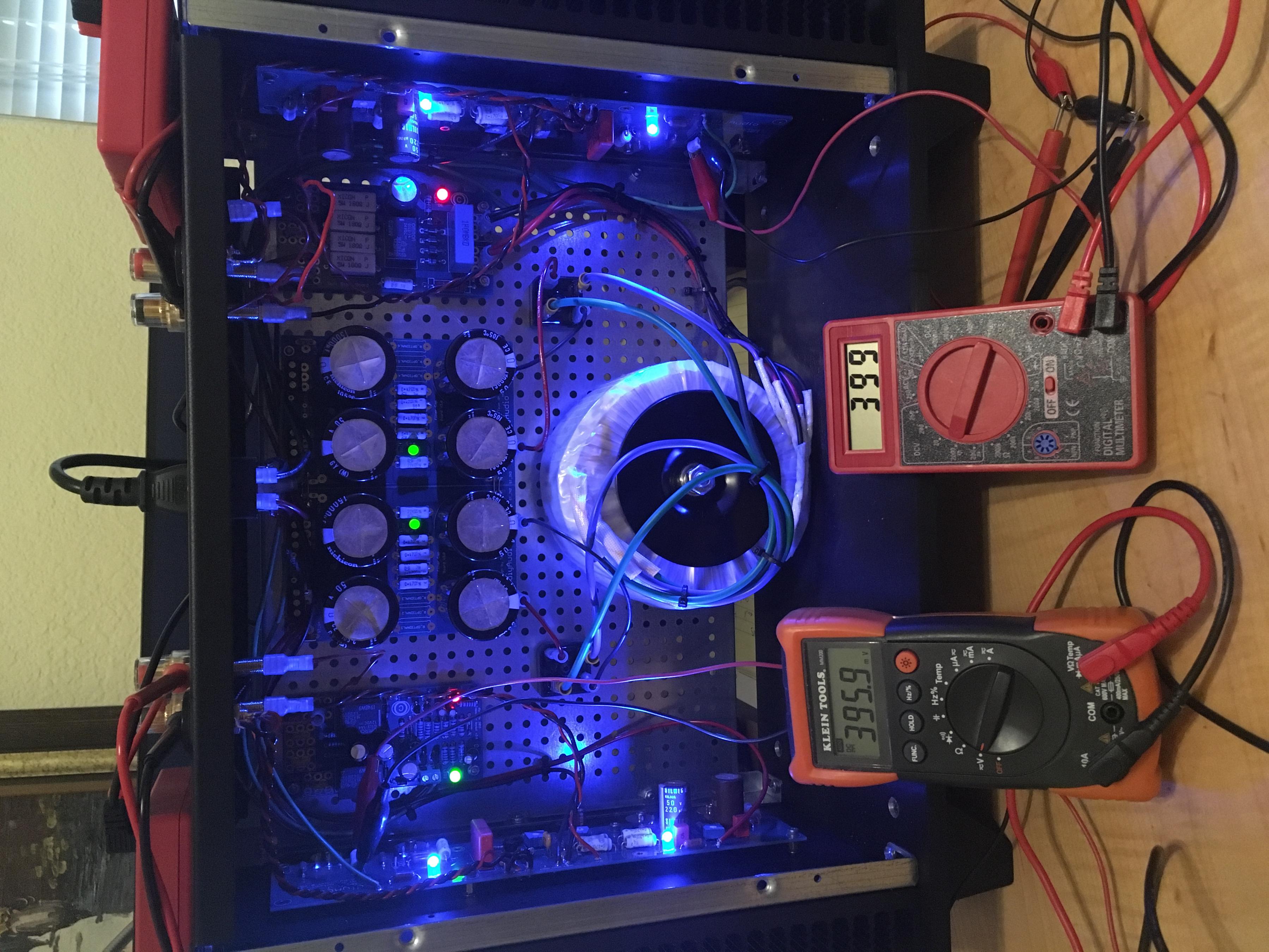

So, I have an odd question.
I've gotten to nearly the end in my build and am on the last step of measuring the voltage drop accross R7.
Interestingly enough, changing R27 doesn't appear to have any effect on the voltage drop which is about .6V on both channels.
One mistake I did notice that I made was, I did not jumper R6, R30, J1, J2, instead I ordered the resistors for these locations from the BOM and stuffed them in there. I know, foolish mistake for not reading first.
I have tested voltages at each step throughout the build up to this point, so I know that my power supply is correct.
Does anyone have any ideas?

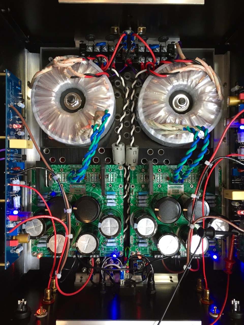

Most amplifier builds shown here use a single power transformer because it is easier and less expensive than building a full dual-mono power supply. Not because a single transformer will perform or sound better. A properly built dual-mono amp is like having two completely separate amps inside a single chassis. Ideally, they should only share the input power cord and on/off switch. This way, there is no interaction between the two channels.
I built my M2x with a shared power supply, using a single 400VA transformer and four 22000 uF caps on each rail. It needed a little more work, including adding a set of motor run film capacitors which were wired directly to each channel's main board, before it sounded the way I wanted it to. When I built my Aleph J, I used a pair of 300VA transformers with 20V secondaries and a pair of CRCRC power supply boards from a group buy a while back. The Aleph J has sounded wonderful from the first day I played it in my system, and I haven't felt a need to change anything. That amp is shown in the picture below. In my opinion the Aleph J can easily be the last amp you will need to build, so it makes sense to take a little extra time with it.
I do not recommend adding a speaker protection module. This is an unnecessary complication and expense. The Aleph J has built-in current limiting which will help protect your speakers. Following a proper bias adjustment and burn-in procedure on your test bench of a couple hours, there is no need to worry about reliability.

Great looking !
Did the calculation this morning for a dual power rail, but compared to the 800VA vs 2x300VA makes no difference.
I was planning to use 8x33mF, so they can be used as 4 caps each rail needed only some extra R's and an bridgerectifier ... that won't make a huge difference of costs so i make a dual power supply for the Aleph.
But you say the only connection between the rails are the mains inlet, but what about the ground (0)?
Do you put secundairy ground (0) to earth or is it better to make secundairy float?
