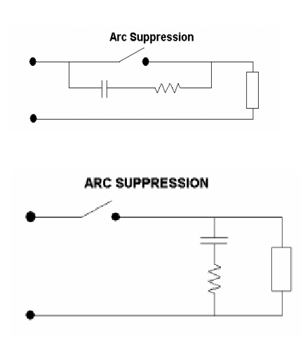

You could consider installing a Quencharc or a PMR210 (both sold by Mouser) to lengthen the lifetime of your power switch. Me personally, I favor the second circuit topology (across-the-load) rather than the first (across-the-contacts). Why? Displacement current.
