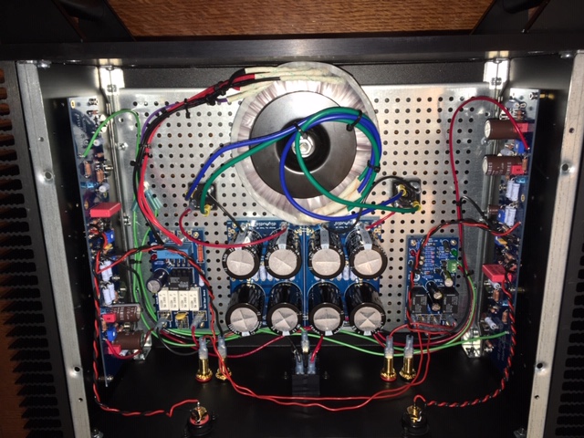

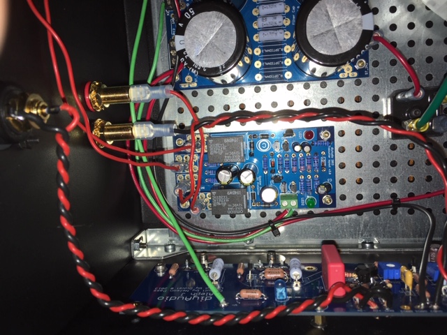

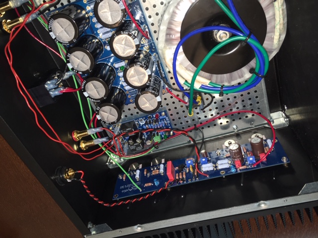

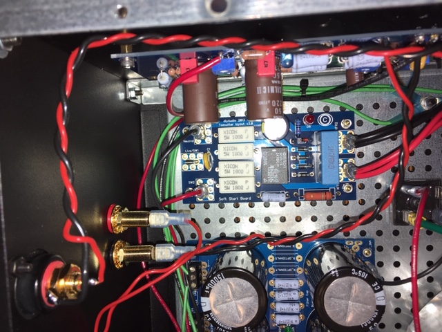

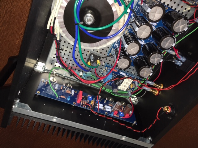

Here are some pictures. Hopefully I did something really obvious and easy to correct. 🙂

Looking at the pictures, I don't see a ground lift in the power supply ground to chassis ground. Use either a thermistor as in the FW supplies or bridge/diodes.
Another thing to do is always twist wires together with their returns. For instance I see that your positive and negative supply wires are twisted together but the ground return wire is free. The ground wire should be twisted together with the positive and negative wires from power supply to boards.
Likewise I see that the speaker ground wire is not twisted with the signal wire for its entirety. Twist the two wires together all the way to the speaker protection board and then twist together to the speaker jacks.
Another item is the location of the ground connection to the PS board. It is best to join the positive and negative supply grounds and take the ground wire from the board at exactly the midway point between the negative and positive grounds.
Once all that is done, try rotating the power transformer. Usually there is one position where the noise caused by radiation from the transformer is minimized.

Ok, just did this and with the inputs shorted there is no hum. So, what does this mean?
Just to verify, even if I am using the soft start board, I will still want to install a thermistor inline between the PSU board ground and the STR ground?
Are you referring to the V+, V- and GRND from each amp board to the PSU board? I don't have any of those twisted together.
Ok. There is maybe an inch on one end and a half an inch on the other just before these wires meet either the board or the jacks. I can certainly add a few more twists at each end if you think it will make a difference.
This I don't follow. There are two banks where you can connect ground to the PSU. One is on the V+ board and one is on the V- board. With that said, I did install several jumpers to connect the two boards.
This is something I haven't tried. Is there a certain orientation that tends to work best?
You have a ground loop.
Does anything in the photos I posted jump out as an obvious cause for a ground loop?

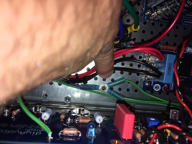

BTW, the STR ground junction in the last picture is linked to the purple transformer wire, the IEC inlet ground and finally to one of the ground terminals on the PSU board.
Or hum is from your preamp (or source equipment). Check your preamp's line output AC voltage (hum voltage) with your voltmeter without connecting AJ, while no music playing. If you see considerable amount of hum, transformer or cutting a ground loop would not help.
