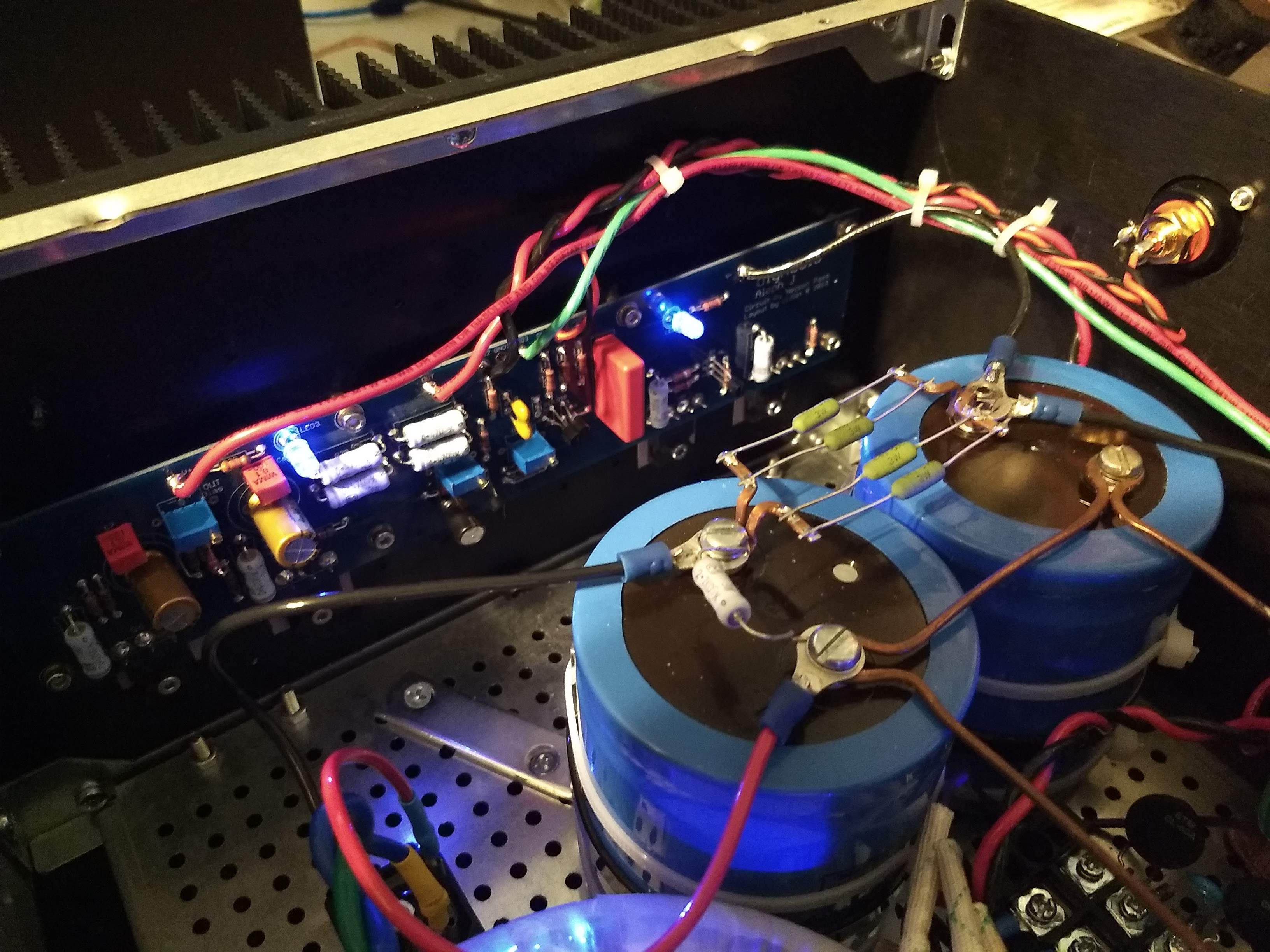

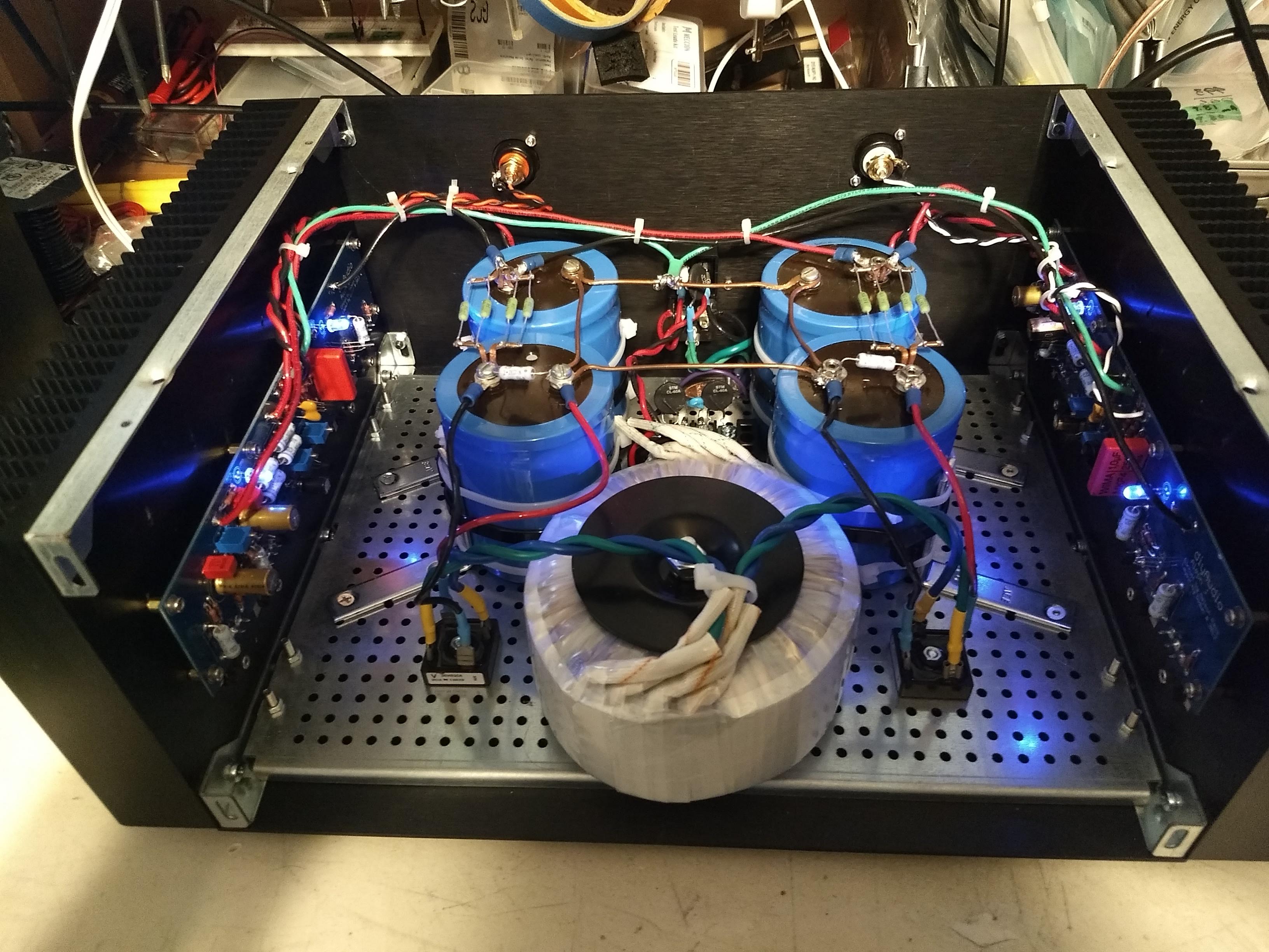

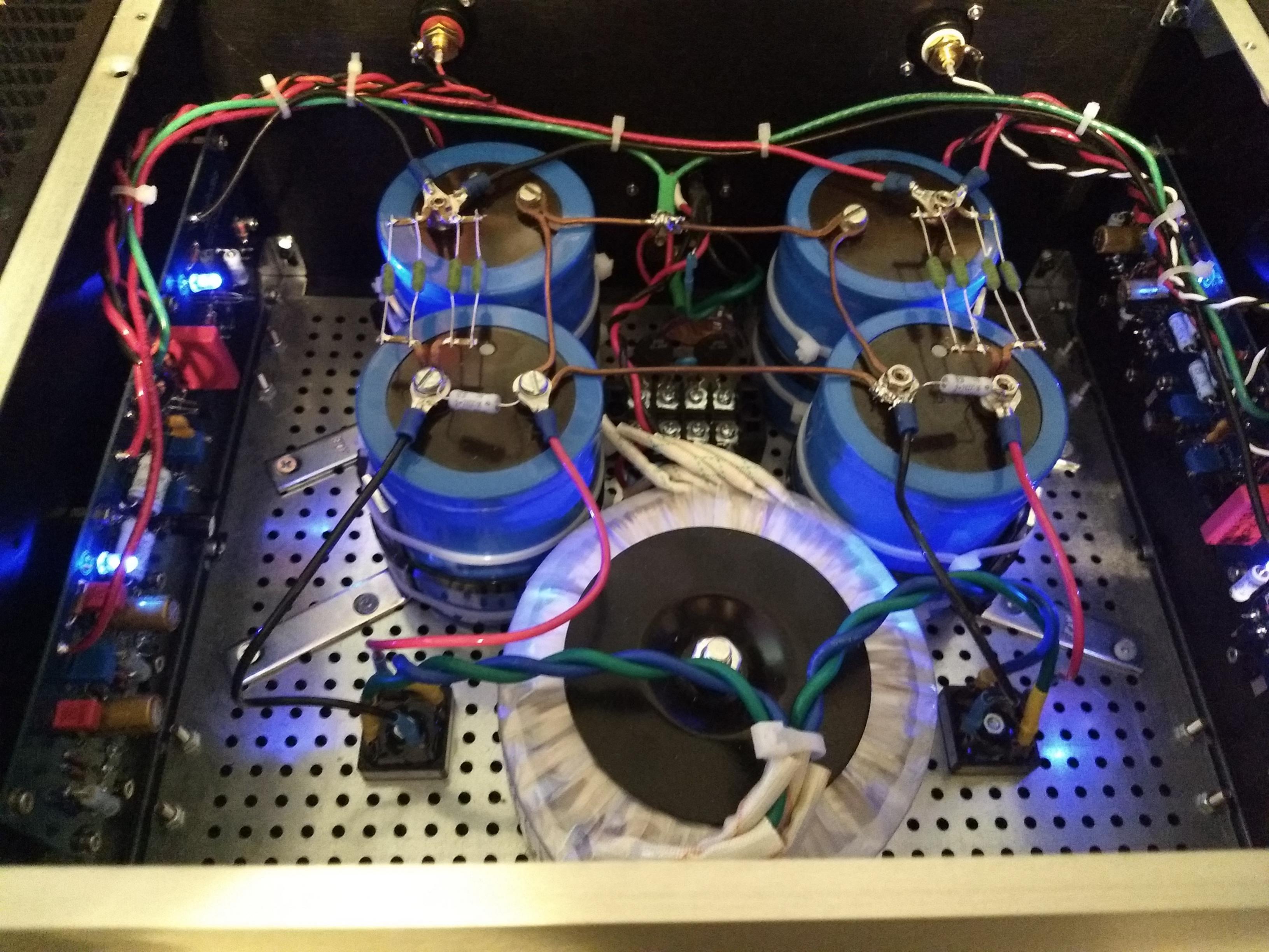

A new Aleph J was born into the DIY world today! I set the bias and dc offset as described by 6L6 at the begining of this thread and it sounds great when i drive it with my laptop. Currently Nina Simone is filling our Saturday morning with lots of smiles.
The preamp, or even my phono stage is overdiving the amp. Lots of hum/buzzing. I'm guessing i need to adjust the input bias. Looks like the 2k trimmer R8 is for this purpose but where and how much voltage am I looking for when adjusting it?
Odd. I've driven mine with Pearl 2 phono, (tons of gain) into BA3 FE (tons more gain) with no sort of over loading problem....
Russellc
when I drive the amp with the headphone output from my laptop it sounds great. when i plug into my peamp, Emotiva bassx100 the sound at powerup is a loud buzzing. I then tried directly connecting the amp to the phono stage, a boozehound labs mm stage there is a distinct hum and the volume is very loud.
