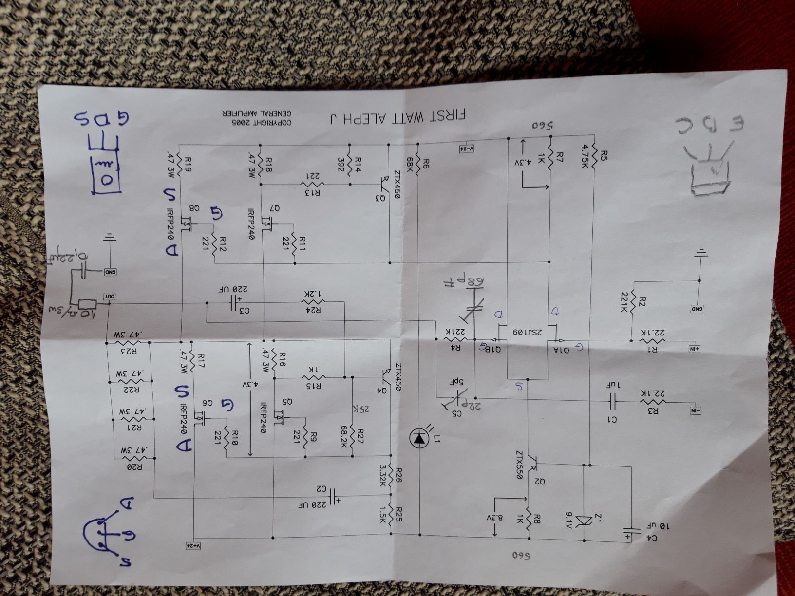

I have made a few changes and the auto oscillation disappeared. (see diagram). However, it does not seem normal, something is wrong, it has to work perfectly according to the original scheme without any "improvements".
I eliminated the effect but not the cause. Maybe we can find the reason together. Merci!
we can't find reason without all proper info - which includes pictures of your build
however , find enclosed more or less reference Aleph amp file , where you can see notes for most interesting positions and also few cap positions ( look for 1nF) , exactly for taming possible oscillations
I would first try adding the 1 nF capacitors Zen Mod mentioned, as per the schematic compiled by Algar_emi.
Then, before modifying anything more, please try your Aleph J with "the standard First Watt PSU" instead of your lab supplies.
I had some pretty funky effects when I was building my Aleph Mini / J and was trying it with my regulated lab supplies. I didn't understand what was going on and was beginning to tear my hair out about the lack of stability ... until I tried it with the "real" PSU. Now the amp behaved as expected and was completely stable.
Still don't know what it was with the lab supplies, maybe something to do with the regulation interfering with the amp ...
So, when you have connected your boards to a "proper" PSU, and it is stable, try reversing your mods, while leaving the 1 nF caps in that are shown in Algar_emi's schematic.

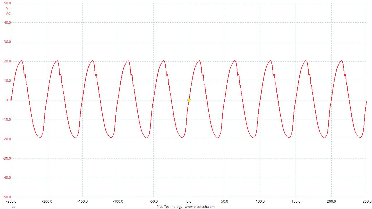

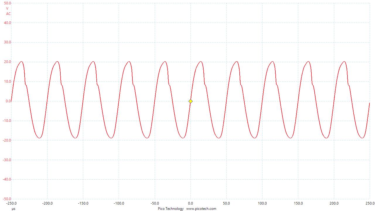

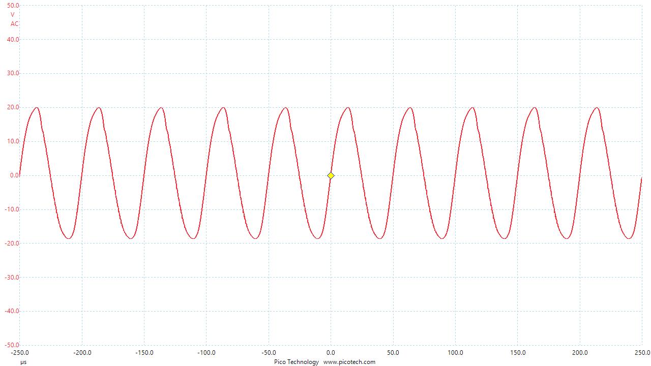

Well I think I am going to give up. Mine is also unstable, there are oscillations/distortion especially when driving 10-15W and lower freq are better than the higher frequencies, output is in 8R resistor.
Added the 2 1nF caps, but not much of a difference. pics: 20KHz 15W into 8R dummyload, with 2 1 and no 1nF.
