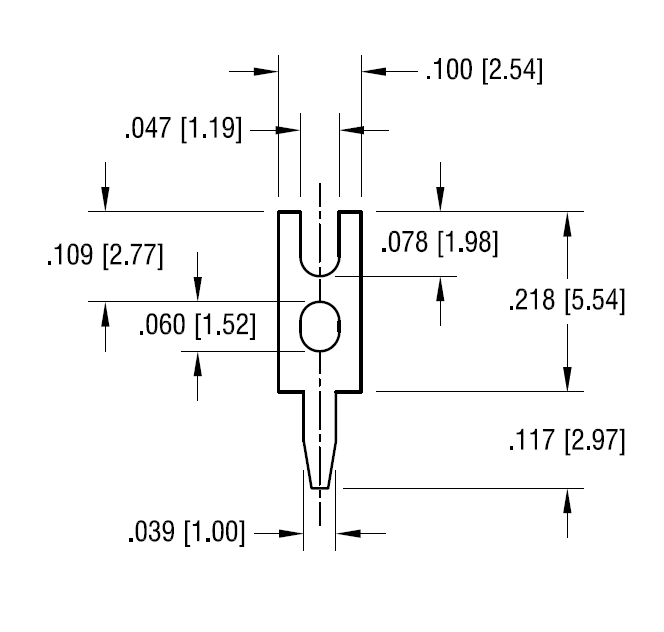

Thank you very much albertNL! That Bürklin component looks like a perfect match to Mouser part number 534-1035 which is on the shelf today, and costs $16.90 for a package of 100 terminals. Mechanical drawing below. The online catalog at Keystone Electronics's website shows about a dozen variants in different sizes etc.

That is funny. I wanted to order some from Mouser because I did not have any left. I could not find them and even emailed Mouser support a photo but they could not help without a part number (which I did not have). [Now I do haha.]
Buerklin is cheaper than Mouser but has the disadvantage of freight costs. Luckily I have family visiting from Germany next month, so low shipping costs 🙂
Most of the people who are Black Belt users of Mouser's website, are Mouser customers rather than Mouser employees. I'm not shocked that Mouser was unable to find a part on their own site ... searching for parts, after all, is not their primary job.
This particular one is made by Keystone, who tends to charge more than other manufacturers. I wish we could find the same thing made by Harwin, who tends to be noticeably cheaper than Keystone. But I haven't found anything yet.

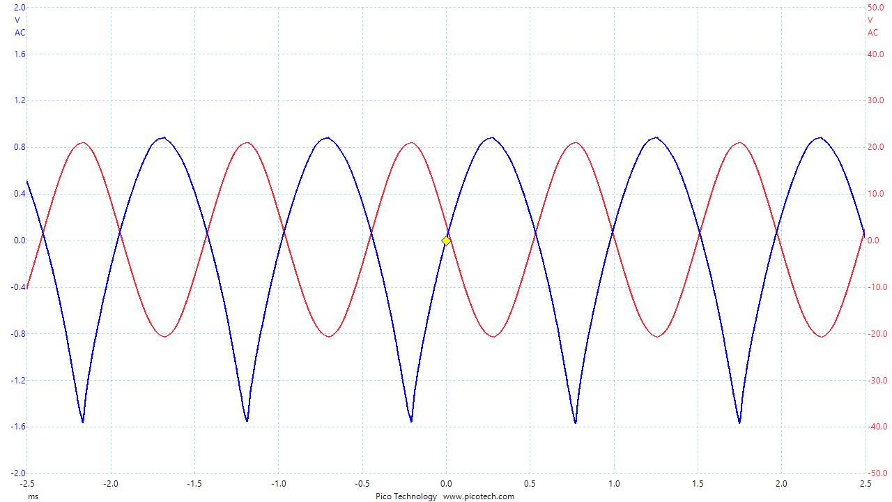

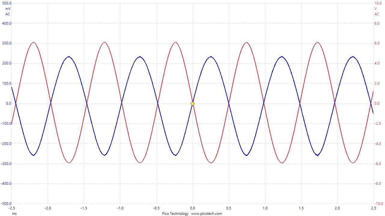

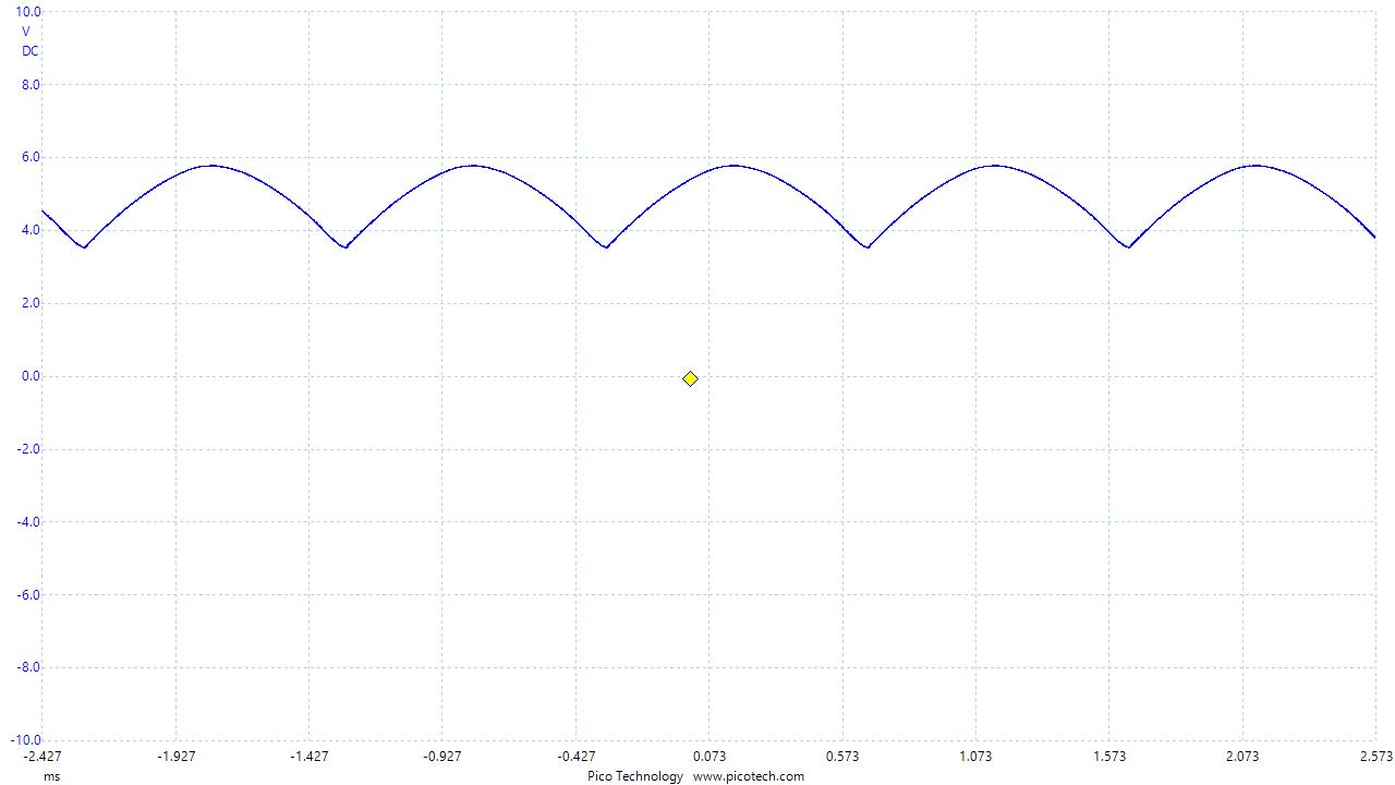

Some measurements I took that looks strange to me. Attached waveforms of output of the LTP, i.e. across drain resistor R7 (to the 2 mosfet gates). Input signal is 1 KHz sinus between +in & gnd, -in to gnd, set to give approx. 2W and 24W output power into 8 ohm resistor. Blue is signal over LTP drain resistor, red is LS output. Output THD is normal, at max 1% just before clipping. DC Bias is the standard 2 x 0.85A. Strange with such distorted signal at the mosfet gate it gives a clean output signal. Is it normal, and if it is, is it the dynamic current source who is in play?
