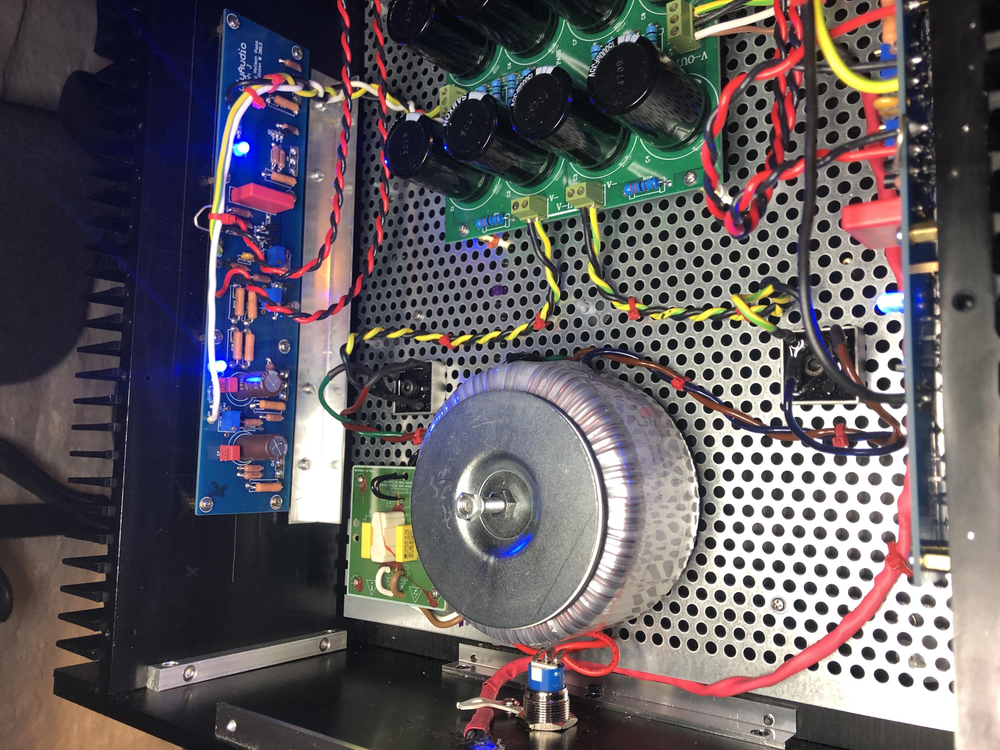

So what you are saying is. My transformer is a bit on the smal side maybee.
But i dont think i have room for two of them.

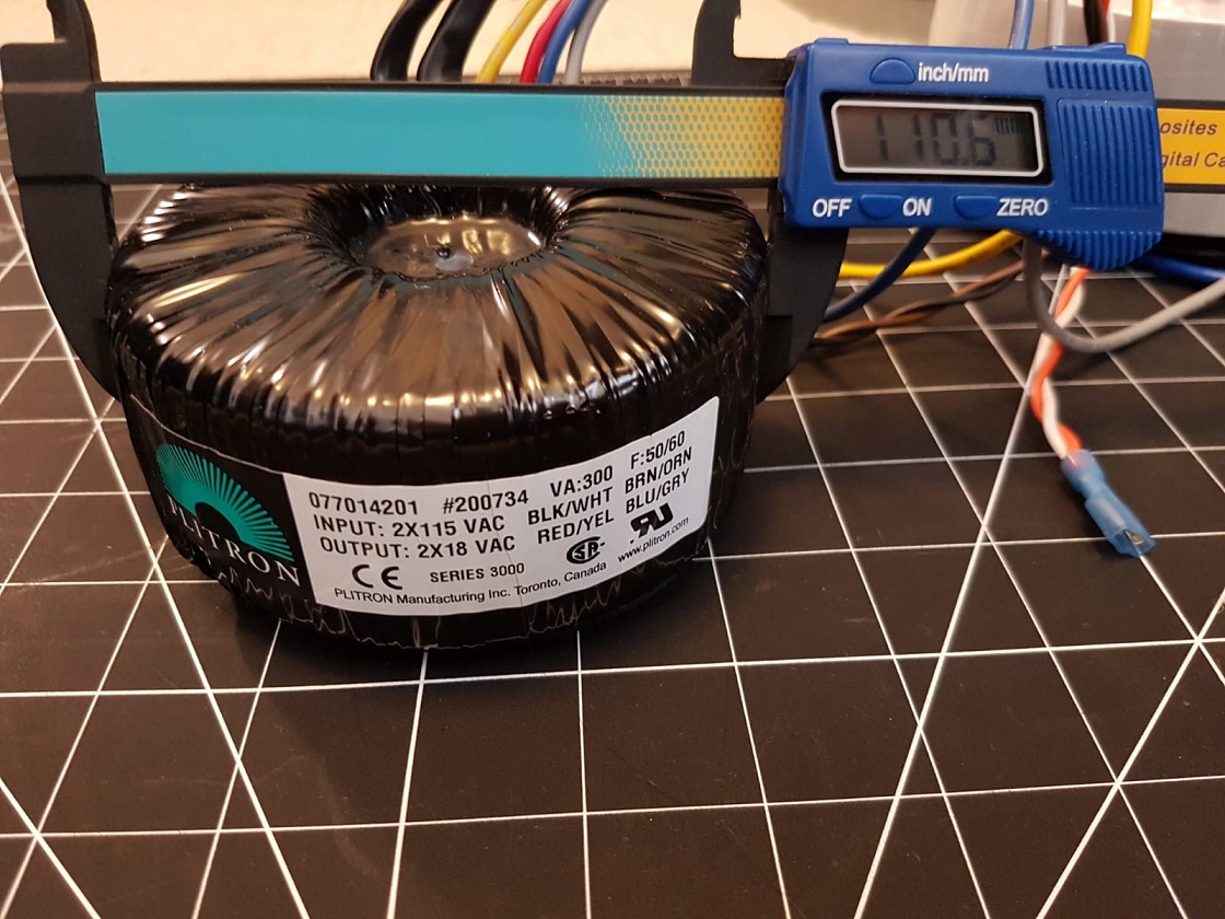

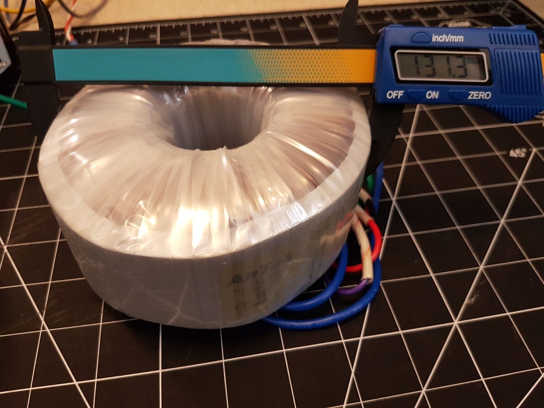

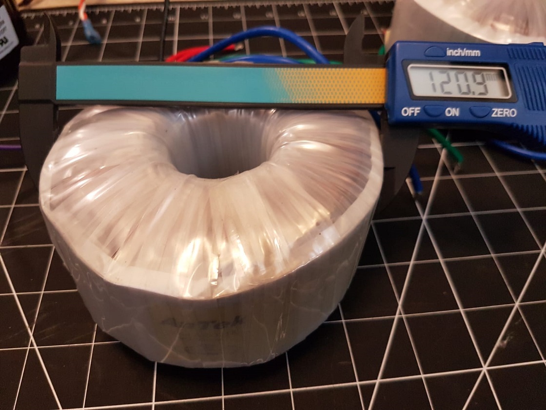

@nikko03 I can't tell how big your transformer is but if it's truly 300VA it should be enough.
For comparison, here are 300VA potted Plitron, shielded Antek 3218, shielded Antek 4218 (300va and 400va).
Caliper reading in mm, but board underneath squares should be 1 inch
I measured my transformer yesterday. And it it 110mm rougly the same size as the one on the first picture.
