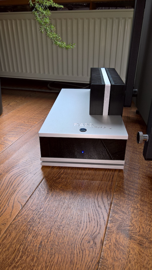

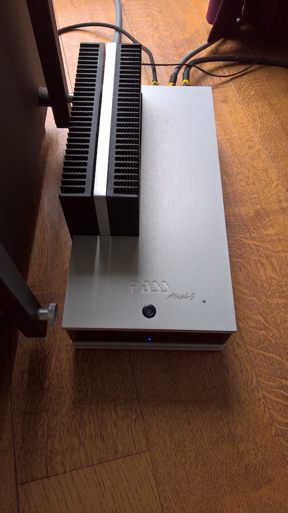

Hi all,
Just finished my Aleph J's: revised with some extra heat sinking (double...) and capacitance (now 220.000uF/channel).
It's alive... and they sound nice.
The bias is raised to 470mV (this is the highest I can get it with the pot... anyone know how to get it to, let's say 500mV?; the heatsinks seem to allow for a higher bias).
