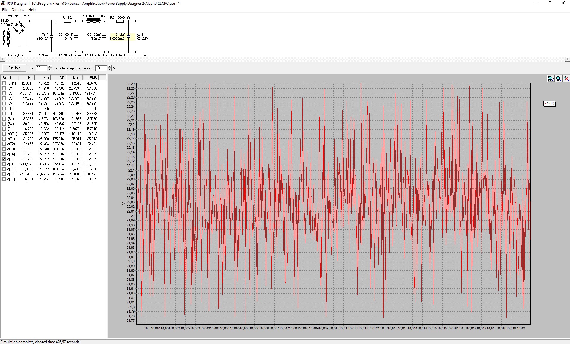

As a matter of fact it is to be an CRCLC circuit like this:
47000uF + 1R +100000uF +10mH + 100000uF
According to PSUD the DC voltage pulsing (is it a good word?) is about 18uV, which seems to be an overkill. But... as they say... bigger (lower) is better 😉

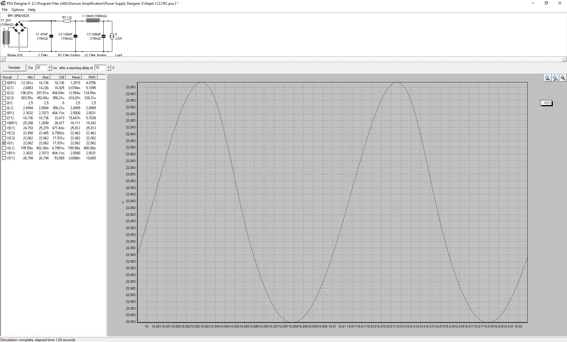

I tried to simulate bypass capacitor in PSUD but the effect is a little bit strange. Pictures in attachment.
Can someone tell me if it's caused by limitations of PSUD software, as I can't put less than 1mR resistance for by-pass capacitor? Or the bypass cap adds some distortion?
Andrea Ciuffoli in one of his projects wrote that amplifier with bypass caps in PSU sounded worse than without them.
Best regards.
Maciek

Hi Maciek,
I've had PSUD2 freak out on me at times too; I always assumed it was just limitations in the software algorithms.
That being said, that's a LOT of capacitance you're planning. It's going to put a lot of stress on your transformer and rectifiers. I generally target < 100uV of ripple, and I'd be willing to bet even that is overkill.
I don't think bypass capacitors at the PSU do much. You're going to have a couple of mR of resistance in the wires between them and your transistors. A bypass on the actual amplifier channel boards will do much more good.
Jeff. (A relative noob, so take my advice with a grain of salt....)

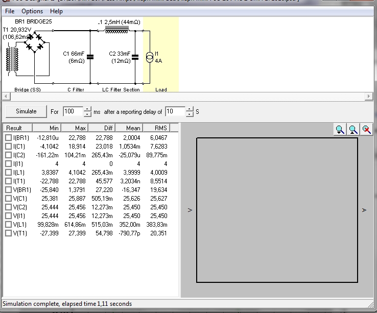

Hi Maciek,
here is the PSUD simulation of the PSU that I currently use in my Aleph J (with just one upper and one lower IRFP140, and at 2 A per side):
attachment.php
As I said, silent into 100 dB/W speakers. Not the slightest trace of hum, and only the faintest bit of hiss with my ear "in the speaker driver". The hiss doesn't come from the PSU.
The 66,000 µF as the first cap is paralleled 33,000 µF caps. This I had done mainly to help the first cap deal with the ripple current, which can get quite high - look at the RMS value of I(C1) in the simulation.
I have actually a 2.2 µF WIMA MKP cap as a bypass cap for C2, but haven't tried to simulate it. As I haven't tried the PSU without it, I can't speak to it's effect on sonics 😛.
Best regards, Claas

My first cap in PSU is rated for 16.2A and PSUD simulation shows about 14.2A so it's too close.
I think that I'll put 100mF 63V as a first cap. It's rated for 31.5A.
So it will be: 100mF + 1R + 100mF + 10mH + 47mF
The question is what is the proper value for I1 (constant current sink) when I simulate AJ biased to 400mV = 0.85A with PSU common for both channels?
Best regards, Maciek
