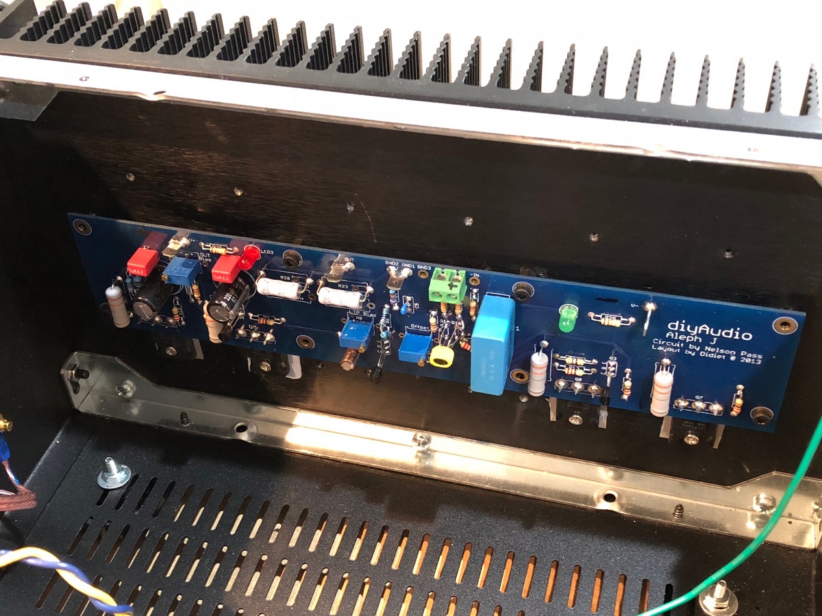

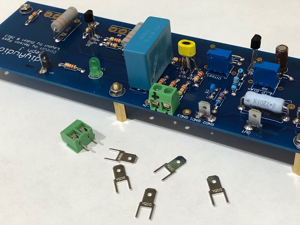

So my Class A case (Dissipante UMS) has a nice F6 +/-24v PSU and speaker connections all ready to go, but they are all spade connectors. Audio signal input is currently two wires (RG172) going to a Phoenix style two position screw terminal blocks (-ve input tied to GND). So here is my solution:
Nothing a Dremel drill press and 1.2mm drill bit can't solve... The drilled hole required scraping away the solder mask, but there is strong solder joint on bottom side of second pin of spade. Quite sturdy. 🙂

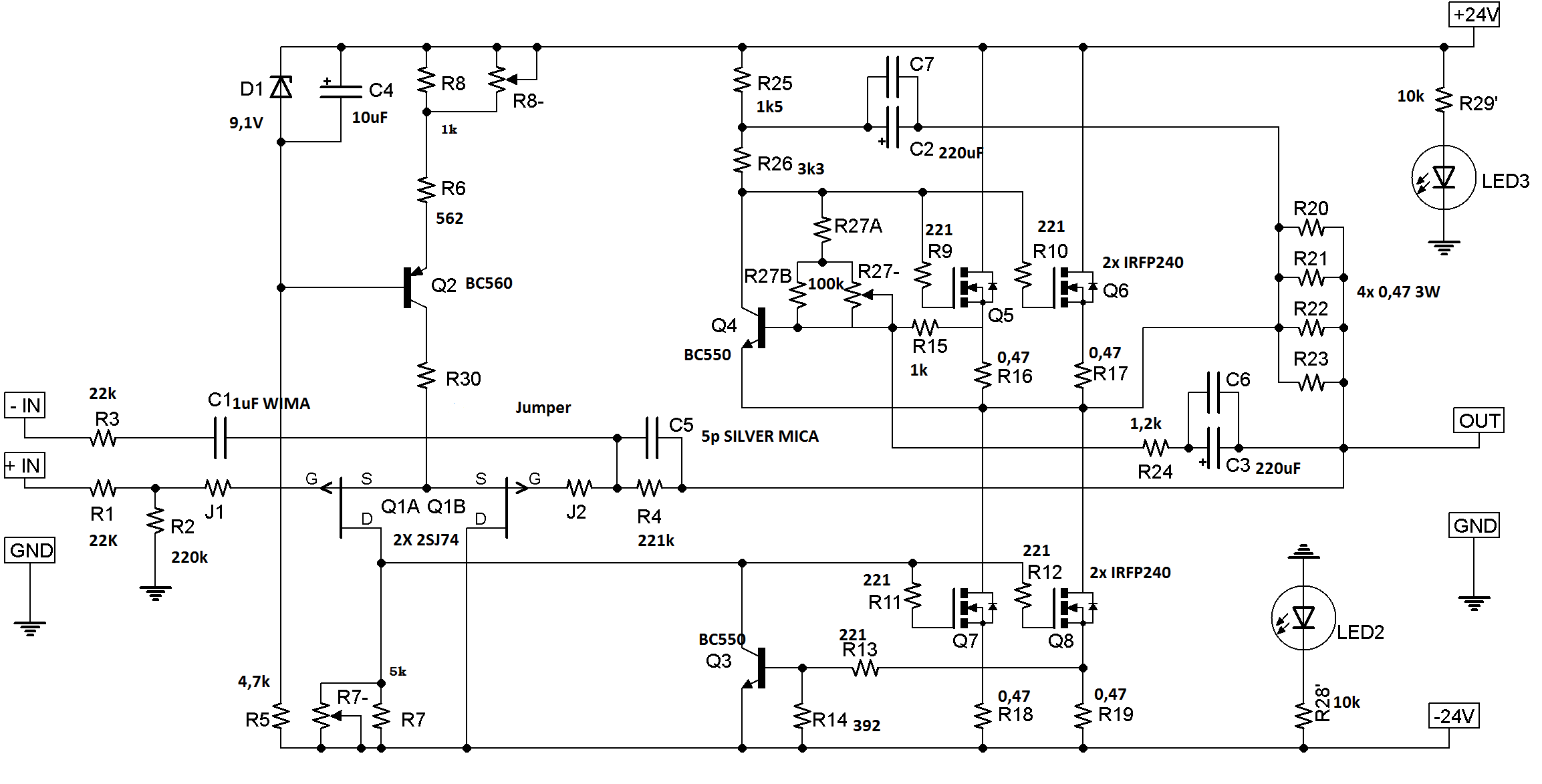

Curious thing happened when drilling the PCB... as I drilled the hole for the negative rail, location on schematic is between -24V pin and R28' (12kohm) for the green LED, the LED started glowing when the bit broke through the FRP and was touching the bottom trace. It could be sustained by leaving the drill bit there. Intermittent glow but quite visible.
Is this triboelectric generation or static electricity generation? Good thing IRFP's were not mounted yet.

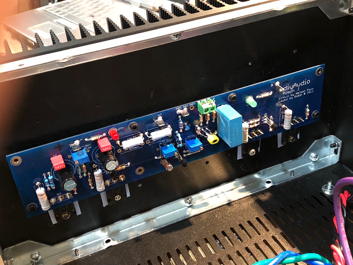

Finding qnty 8 M3 screws that are 10mm long was the biggest problem for me. Finding 8 silicone insulator pads was the next problem. The DIYA store UMS heatsink however, was superb for ease of mounting. Everything lined up perfectly. I soldered the IRFP's in with just one leg and bolted it and the PCB in place before soldering the rest in-place. I had the DVM across R18/R19 and adjusted bias current to 0.75amps per device for 1.5amps total. The bias currents in each leg matched within 1.5% (I matched the device Vgs values from a transistor tester). DC offset is about 10 to 15mV and pretty stable. Bias current is very stable. Despite my hand made P2P F6 PSU, and a semi-rats's nest of PSU wiring inside the case, the output noise measured between 0.1mV and 0.2mV on my Fluke 101 - which is very good for a speaker amp. I am listening to a few favorite test tracks right now and enjoying the sound. Overall, a very nice amp to build and easy to setup. Will let burn in for a day and then take some measurements.
Right channel installed onto heatsink:
Left channel:

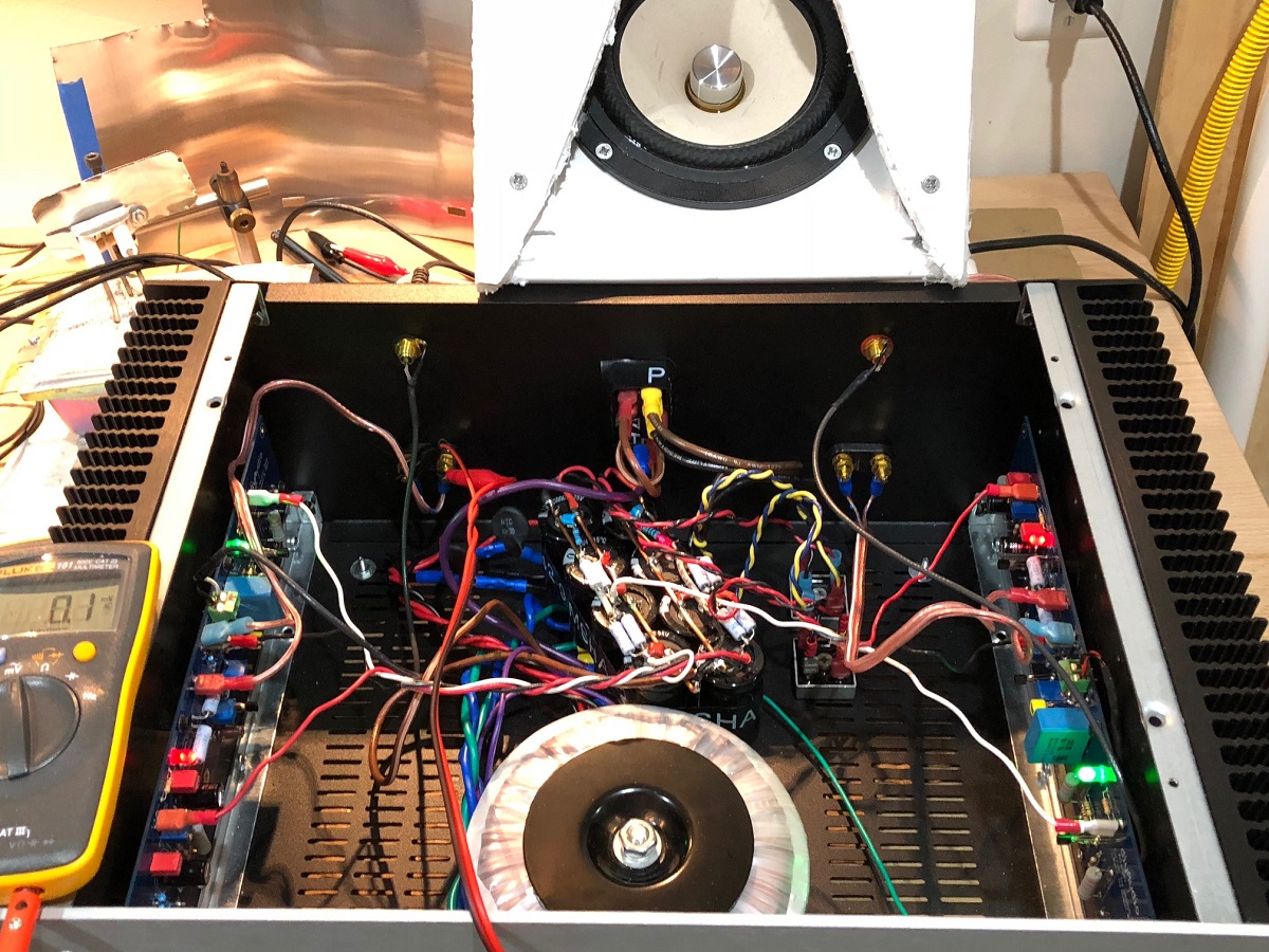

Noise on output measurement with Fluke:
You can see the XKi with W5-2143 test speaker in the background (8ohm 90dB sensitive full range) - sounds very nice. I am driving with a Focusrite 2i4 single ended output (I soldered the -ve input to GND under the PCB). I have balanced output capability but that would require some Neutrik XLR connectors on the back panel. Maybe for another day...
Btw, my spade connectors installed on the PCB's and the 2-pin screw terminals for audio input worked like a charm.

Nice build! With those good noise numbers don’t fret about PSU wiring.

I am feeding the amp with a single-ended input to the +ve input only. C1 is the -ve input and tied to GND. Will it still make a big difference?
...I suppose it does because the audio signal still has to close the circuit by flowing to GND so passes through C1 - like a shunt capacitor. I know that disconnecting the -ve from GND, you get almost no sound out.

The signal is AC, so there has to be a connection to ground. Flow and return. All of the signal is there, so yes, it will make a big difference. Think about if it wasn't there! 🙂
The neg side of the diff amp as the bulk of the offset, which is why the input coupling cap is located there.
