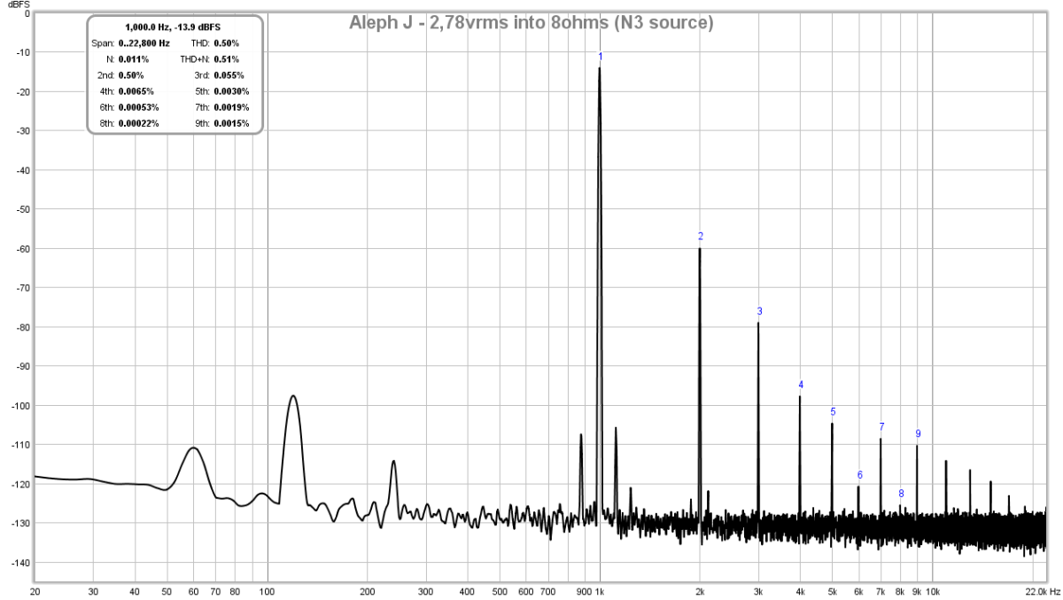

Aleph J Measurements
Having let the amp burn in overnight at 2amp bias, I am pretty confident all the caps etc would have sufficient time to stabilize by now. I connected my usual 8ohm 25w load resistor (mounted to heatsink) and proceeded to connect my Focusrite 2i4 audio interface for the measurements. The moment I connect the load resistor voltage outputs to the ADC input, some sort of oscillation appears. This happens whether or not a SINE tone is playing. I took a second computer and had a separate Focusrite Solo produce the test tone and had the 2i4 read the signal then there was no oscillation. I have never observed this in any other amp I have tested. So I am wondering if maybe an input RFI filter network is needed. It is indeed absent on this amp.

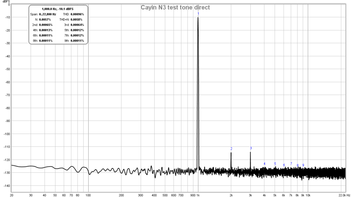

Anyhow, I did not like the idea of using two Focusrites just to make a measurement. I created a high resolution, low distortion 1kHz test tone using Audacity. Put that FLAC file on my Cayin N3 DAP which has an AK4490 DAC reportedly, a very nice one. Thus, I will use the N3 as the tone generator DAC and the Focusrite 2i4 as the measurement ADC. And being separate devices, I do not have that strange feedback oscillation.
Here is the FFT of the N3 put directly into 2i4, you can see the distortion is very low (0.0009% THD) and all 2nd and 3rd harmonic:
attachment.php

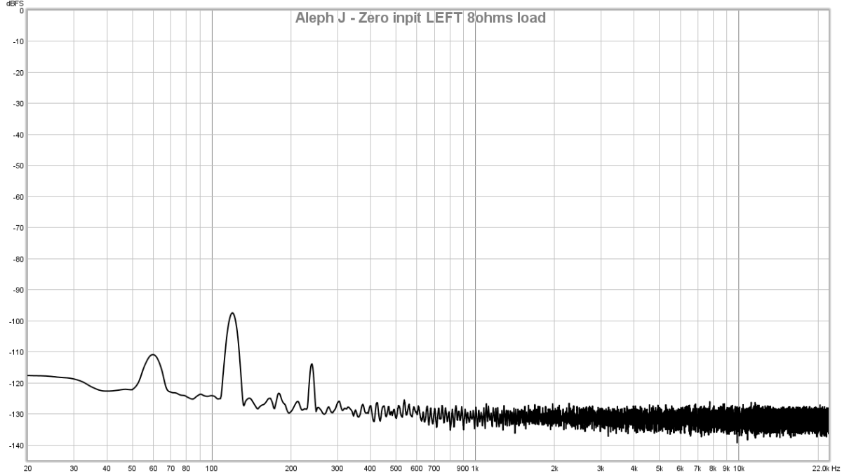

Here is the FFT of the Aleph J LEFT measured at the 8ohm load with zero input, the noise floor is nice and quiet except for the 120Hz and 180Hz bumps from the linear trafo F6 PSU:
attachment.php

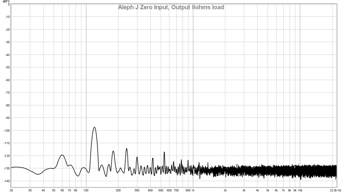

Here is the FFT of the Aleph J RIGHT with zero input:
attachment.php
Here is the LEFT Channel FFT of the Aleph J with about 2.7vrms into 8ohms (I could not get 2.83vrms exactly due to the discrete volume adjustment on the N3):
attachment.php

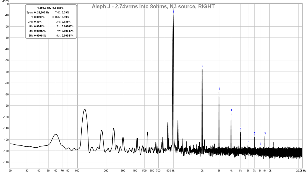

Here is the Right Channel FFT of the Aleph J with about 2.7vrms into 8ohms:
attachment.php
The THD is quite high for 1 Watt into 8ohms. The profile is nice with descending higher orders and 3rd is -20dB down from 2nd and so forth. And all this sounds very sweet to the ears, and probably very close to a SET tube amp, but maybe 10x less THD as those are in the 2% range. However, this is quite a bit more than what I was expecting, about 0.05% or thereabouts. So, I am wondering, is this normal? Has anyone else measured the FFT at 1W into 8ohms? As I recall, the Babelfish J was about in the same territory for THD so maybe this is really just a fact of the topology?
Don't get me wrong, I am not complaining, it sounds great and the noise is very low as you can see. Just wondering if I am missing something here.

Ok, two things;
First, please set the 'bias' to 0.4v across the output device source resistor. (Either R18 or R19), reset offset, and re-measure your amp, and please post results here.
Once you've done that, then;
Read Zen 2, specifically the bit about the Aleph current source on page 3
http://www.firstwatt.com/pdf/art_zv2.pdf
Set R27 pot to get the 50% figure between the Mosfet source resistors (R16,17) and the sense resistors (R20-23)
Yes, this will adjust the bias. The pot marked 'bias' really isn't, although it does have that overall effect. That pot sets the AC current gain of the CCS.

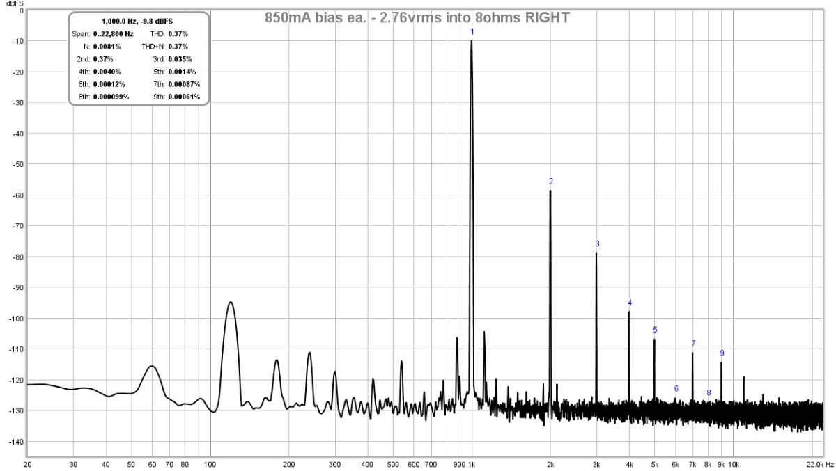

Ok, with 0.33 ohm resistors a similar bias value to suggested is 0.28v. (850mA) Set that to begin with a re-measure your distortion plot.
In the Zen 2 article read the paragraph that starts with "In any case, to achieve this 50%..."

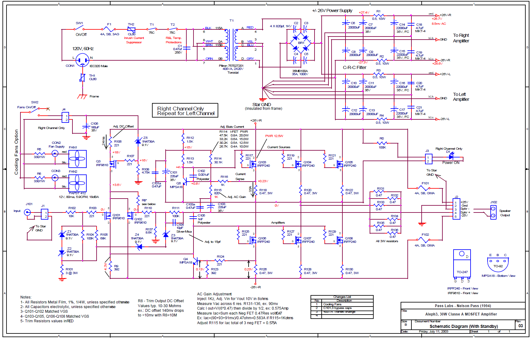

... <AC current gain> adjusting ... R24 in the above schematic. That’s fixed at 1k2, should we make that a pot and adjust?
That's what I did in my Aleph. I actually did not build it as an Aleph J originally, but as an Aleph Mini, which I later converted to "J".
So, change R24 to a pot to adjust Aleph Current Source gain.
Also, in my Aleph the upper connection of R27 pot actually goes to the connection between R25 and R26, not below R26.
In my amp, the setting of bias via R27 and AC Gain via R24 is independent of each other - no influence on the other when setting one of them.
For understanding the Aleph 3 / 30 / Mini / J, I think the great schematic of Algar_emi is still very helpful. (see attached).

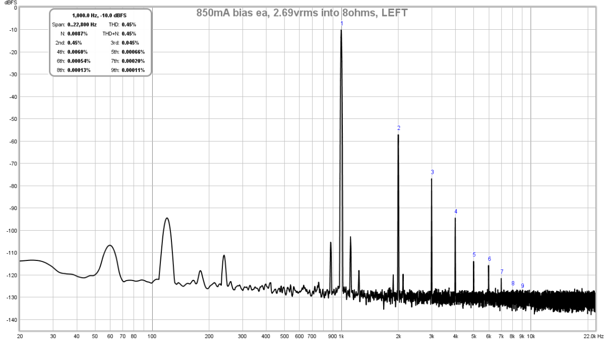

Here are the FFT's for the above case of 850mA bias current on each MOSFET or 1.7amps total bias.
LEFT:
attachment.php
RIGHT:
attachment.php
As you can see, the THD and profile looks about the same as before.
@Claas,
Thanks for the schematic by Algar_Emi. It loks substantially different with IRFP9610 as input stage and uses a lot of caps here and there to stop oscillation. Gives me ideas to try because I think my amp is prone to oscillation when I connect the output load to the input of my Focusrite. First thing to add is RFI filter on inputs. With a 22k input resistor, a 22pF cap to GND should work. Perhaps even a 33pF silver mica might do the trick, I have lots of those.
I will have to think about if it is worth removing everything to install the pot for AC gain setting.
Here is schematic extracted from above pdf for easy viewing directly:
attachment.php
