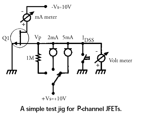

Using the Borbely tester circuit modified for p Junction JFET:
I got -10mA for Idss and -2.13V for Vp.
Using the formula from Borbely Transconductance is approximately = -2 Idss/Vp I get about 9.4 mSiemens.
The Toshiba 2SJ74 datasheet says forward transfer admittance per the graph at -10mA should be 40mSiemens.
Did I do the calculation right, and does this show that the part is fake?

The 2Sj74 Vp should be around 0.4 to 0.5 Vgs for 10mA IDSS. You can double check your work by taking readings at two different points then its the change in Id/change in Vgs. At higher drain currents the gm increases.

Calculation ok, part behavior similar to J270/271, not 2SJ74 any grade. No wonder your build has anomalous distortion, I was rather astonished by your spade connector comment. I can imagine a dark and flat presentation compared to correctly populated build.I got -10mA for Idss and -2.13V for Vp. ...
Transconductance ... -2 Idss/Vp ... about 9.4 mSiemens.
