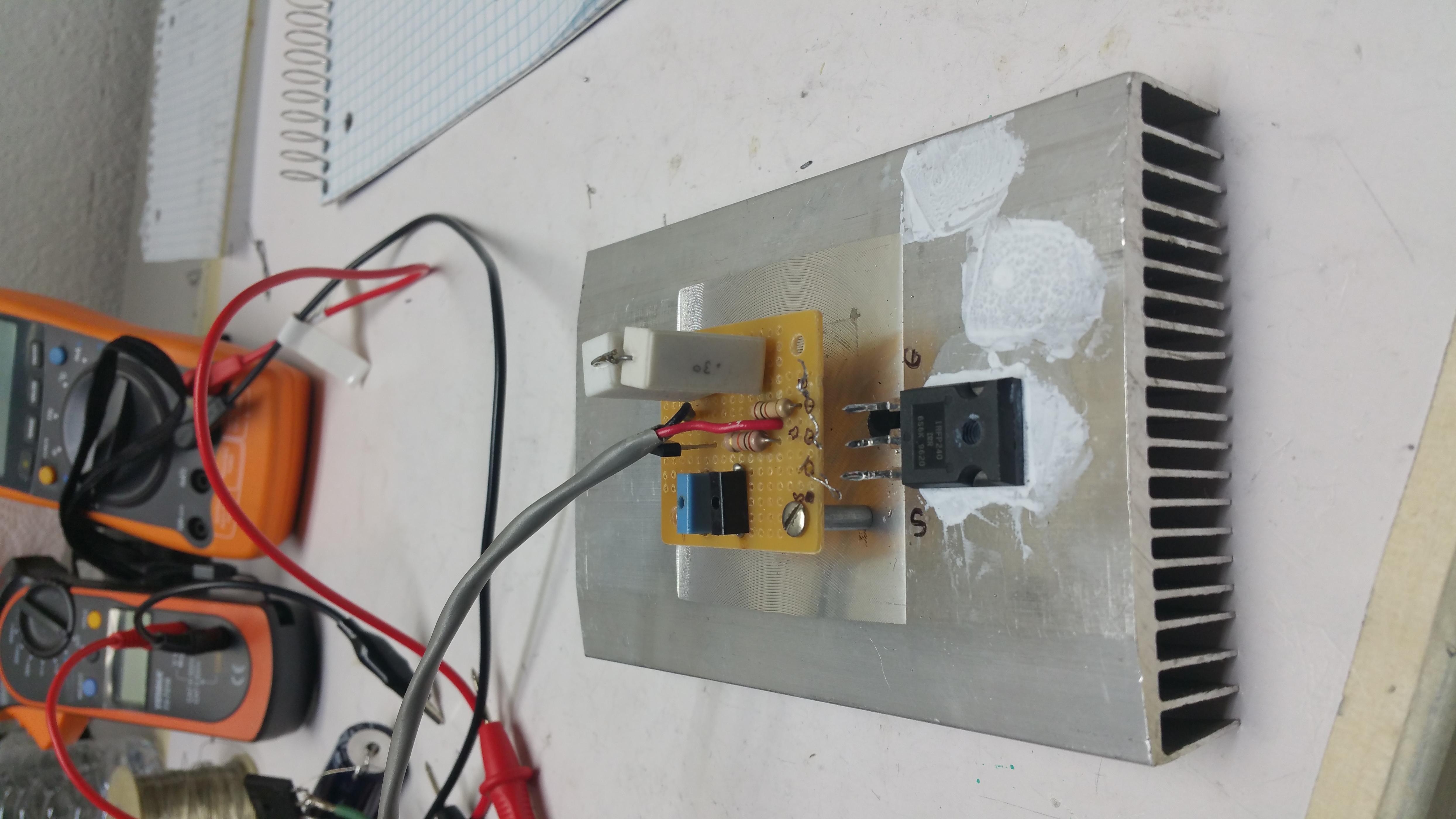

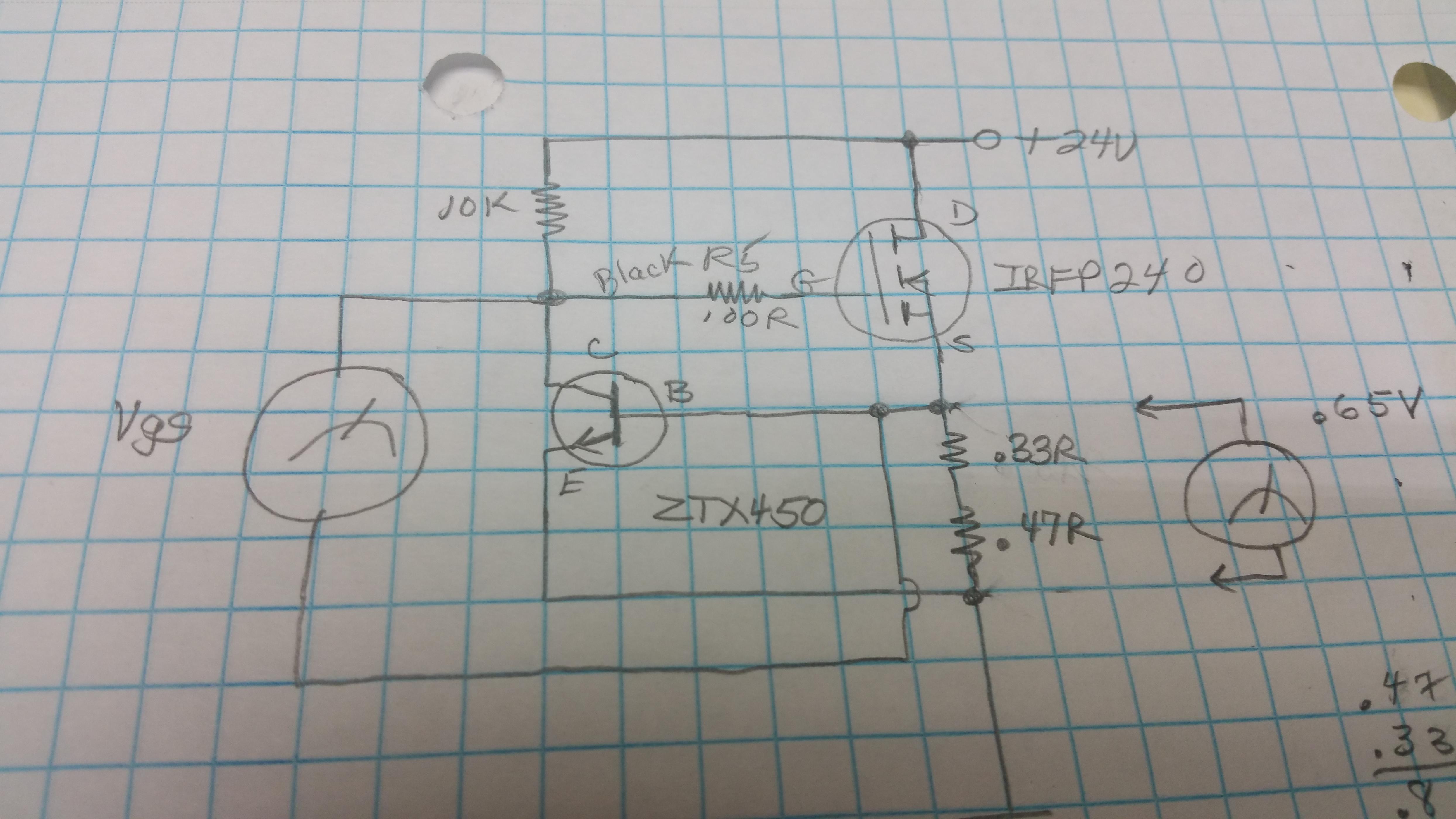

I built a jig for matching the IRFP240 MOSFETS. I simply used the constant current source circuit from the amplifier and measured the voltage across the Gate and Source. I ran the power supply on a Variac and monitored the VGS for about 5 minutes and wrote the VGS on the FET. Out of 24 FETs I came up with 8 pairs all matched within 2 or 3 mv of each other. It may be time consuming but it works well. I am thinking that a larger heatsink with a large power supply could do multiple fets as all the drain leads could be common. No insulators would be needed.

If you order in multiples of 25 (a full tube), you're very likely to get lots of matched pairs/quads/etc. I matched mine with a similar jig, but without the heatsink - they were just in free air. I used 20v, 0.75A for about 45 seconds - any more and they get too hot to handle. This was enough time to obtain closely matched pairs for my big Aleph-X amps. For these mosfets, most people want to match them at the specific voltage and bias that they'll see in the completed amp, but it seems that simply matching them at any realistic voltage and bias level will provide good results for other voltages and bias levels as well.
I did notice a change in VGS as the FET heated up on the jig. The goal was to take all the FETS to be matched safely to the same temperature they would see in the amplifier. As I was in no hurry I found 5 minutes worked just fine. I did have two different batches so my yeild was lower than if they had been from the same lot. After mounting the FETS to the Heatsink, I checked the resistance between all the Drain leads of the Fets to chassis ground.

Yep, they do change as they heat up for sure!
But, once you find ones that track one another at the same rate for some fixed voltage level, they also seem to follow one another for other voltages and currents as well. Thus, matching at ANY reasonable voltage and current is sufficient. I've matched over a hundred mosfets for various amps and haven't found any that don't follow this rule.

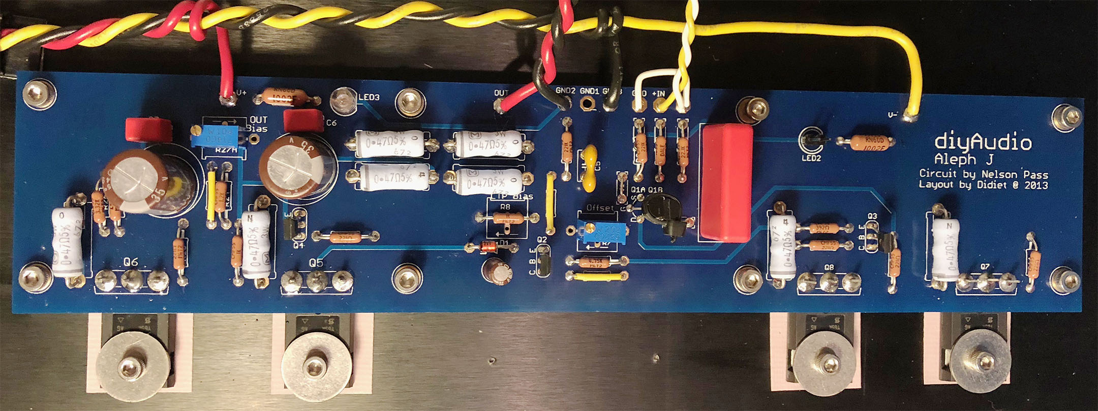

After building the Amp Camp monoblocks, an F5, a Sony VFET DIY, I have just finished the right channel for an Aleph J. Everything seemed go smoothly and it sounds great. I have the bias at 400mVdc and DC offset adjusted to zero. Temp on my heatsink after one hour hovers at about 42-43°C.

I am attaching a photos of the PSU and the Aleph J PCB . I took the PSU photo after I had disconnected the rails from the Aleph J board. In the meantime I'm building the left channel board so it might be interesting to see if the same thing happens or not.
I would be very appreciative for any advice. And, as always, thanks to Mr Pass, Diyaudio.com, 6L6 and all you guys for making this all possible.

1) Bias is not just a function of the pot, it’s the pot and the Vgs of the particular mosfets you have. It’s going to vary, hence why its a pot.
2) see No.1
2 a ) Alephs pull a lot of current. They get hot. Hence the bulb staying a bit lit after the inrush.
3) The circuit discharges the positive rail a lot faster than the negative. That’s normal for this amp
4) See no.3
2) see No.1
4) See no.3

Thanks for the info. I actually have a speaker protection board I’ll add once I get both channels done. The turn off thump really isn’t very loud at all; I’d just never run into things like the rails discharging like that before. I was relieved to find out that’s normal.
