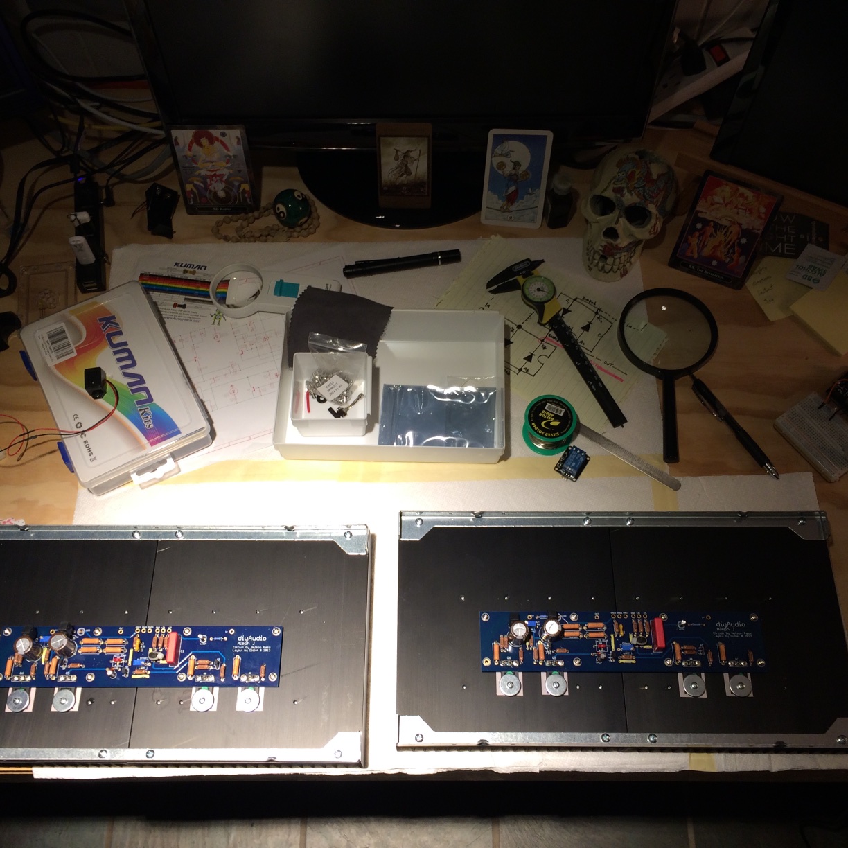

Hello
I build the Aleph j pcb , and i have same Problem like other , after some evenings searching the mistake , i find out that ztx 450 and ztx 560 has not the right Direktion ,so I search for some photos ,but i cant find a 100 prozent good phote to be shure ,and see the right position , because the corner of the ztx are so small ,
I have at the loudspeaker output 27 V dc ,very wrong.
some parts get hot , irf`s stay cold , and I turn of the power,
so i test the ztx 560 and turn it, hold it with my fingers ,and put it to the solder points on the pcb .
And a wunder 27 DC dissepeard and the irf`s get hot on the heatsink.
So the problem hasn`t endet. After soldering and turning the ztx I have the same problem 27 Volt dc . I also turn the ztx 450 ,but my be it is wrong . my by th ztx broken, because to hot soldering.
I order some ztx also bc 550 and 560 and 9.1 diode , around this parts i hope is the solution.
so befor I solder the new parts i need 99 prozent good photo ore something else of the 3 ztx
my be sombody here of the aleph-genius can help me .
best regards Andreas

Andreas,
The PCB has markings for each of the pins: (E)mitter, (B)ase, (C)ollector. Look at the datasheets linked below to identify the pins on each device and correctly place them on the board.

Hello Grimberg and other Folk`s
The First pcb is running .
I take care to solder the ztx in the right position , check all resistor`s.
I have DC Offset around 0,0 but its not all finish , I worm up only a little moment 5 minutes ore so , and i am waiting of a 100 k poti ,they send 1 k , bad .
I will tell you when the the music is playing.

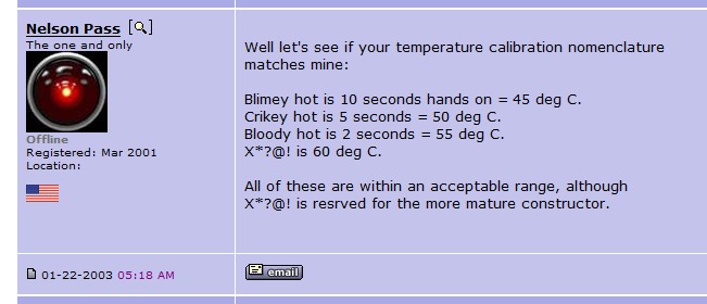

Aleph J heatsink temperatures

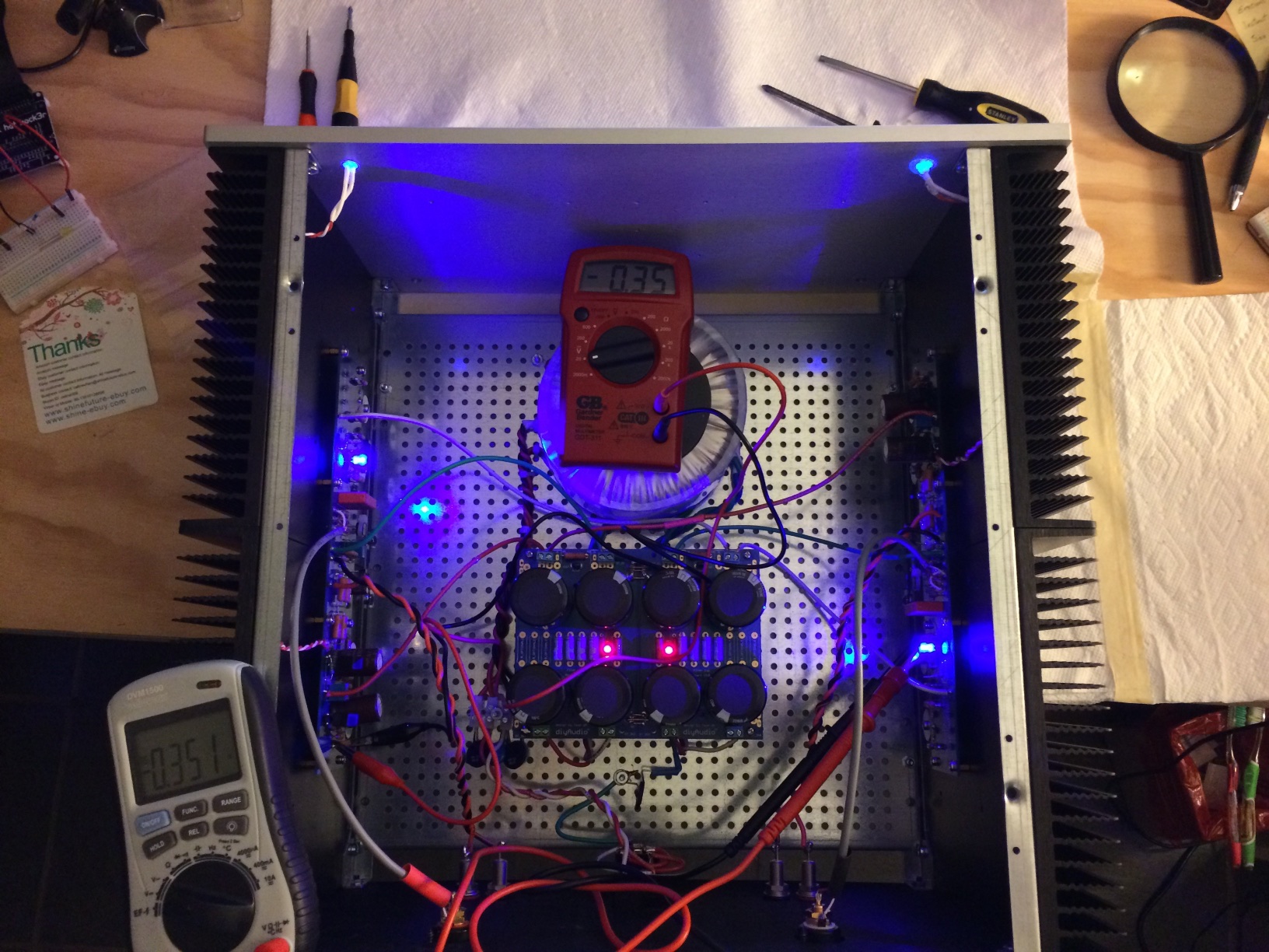

Hello All,
I’ve had my Aleph built for a while and decided to check my bias and offsets to see if anything had drifted, all was on spec of 400 mv bias and 0-.4 mv offset, its in a 4U chassis. I also bought an infrared heat gun to check the heat sink temperatures. My ambient room temperature is around 22 degrees Celsius, and from a distance of 12” & 24” the heat sink temp was 48.9 degrees Celsius from mid way up the heat sink all the way to the top. I thought that this was a little low based on the build guide that said it could be as high as 55 degrees. I also checked the temperature on all of the output transistors pins and they also read less than 50 degrees, the build guide suggests that the middle pin should be no more than 65 degrees but it’s the same temperature as pins 1 & 3. I’m not sure if this all jives. I’ve measured other things with the gun and it seems to be reading temperature correctly.
I’ve now raised the bias to 440 mv and the temperatures have increased by about 2 degrees. At this point I can’t leave my hands on the heat sinks for more than 5-6 seconds before it becomes uncomfortable. Can I leave it like this or should I turn the bias back down to 400mv?
Any advice or insite on the temp readings I’m getting would be greatly appreciated.
Hello All,
