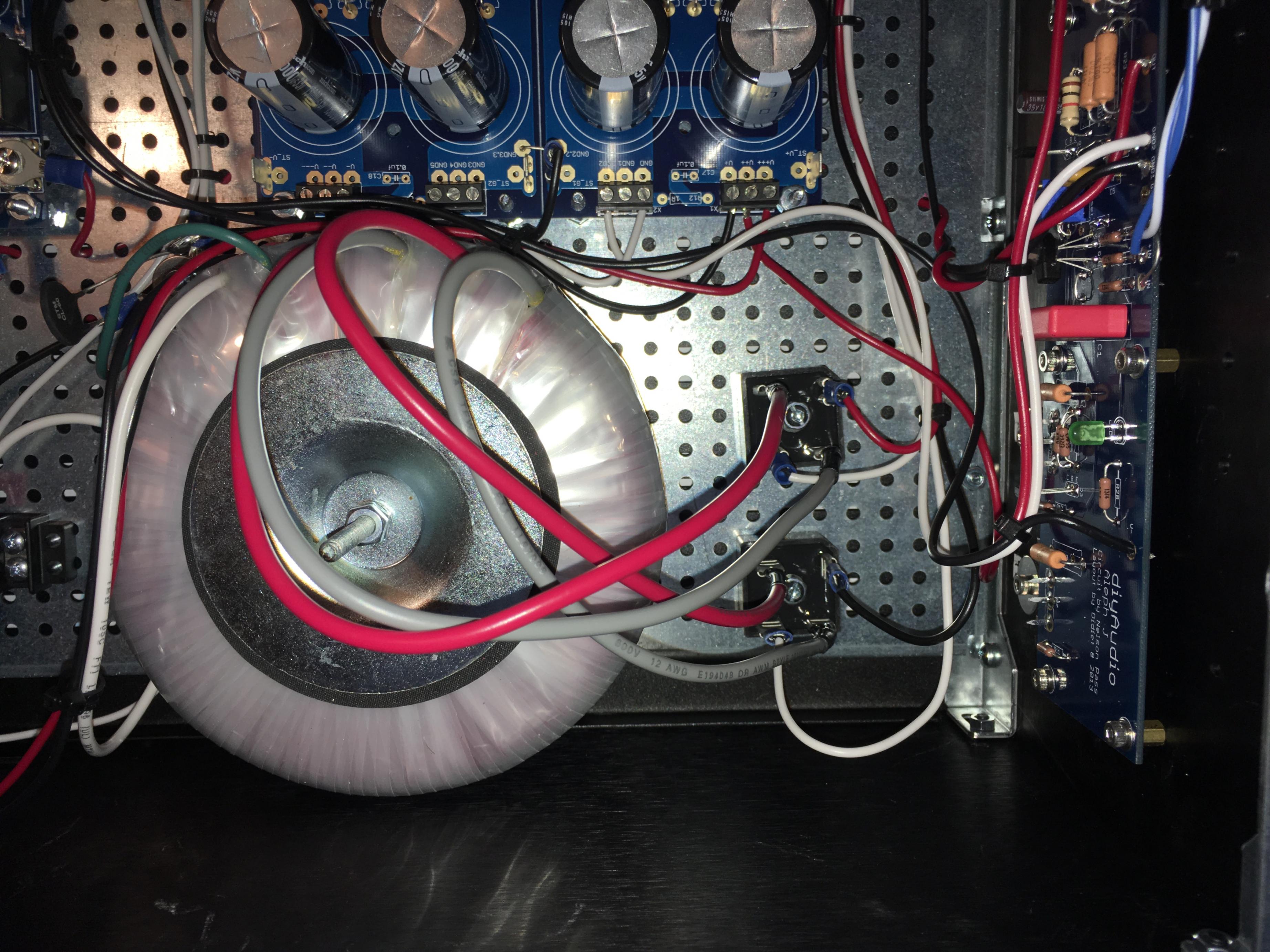

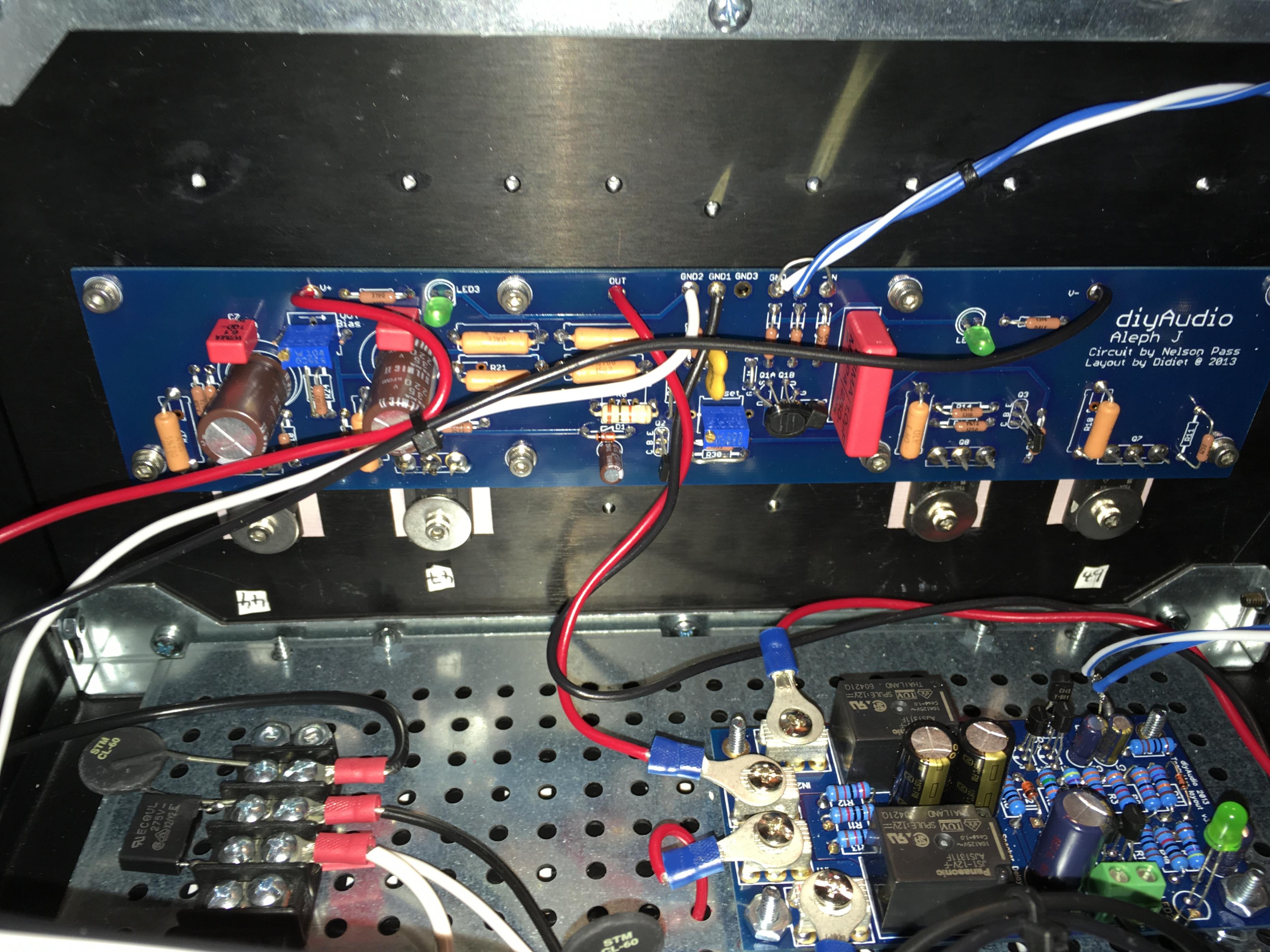

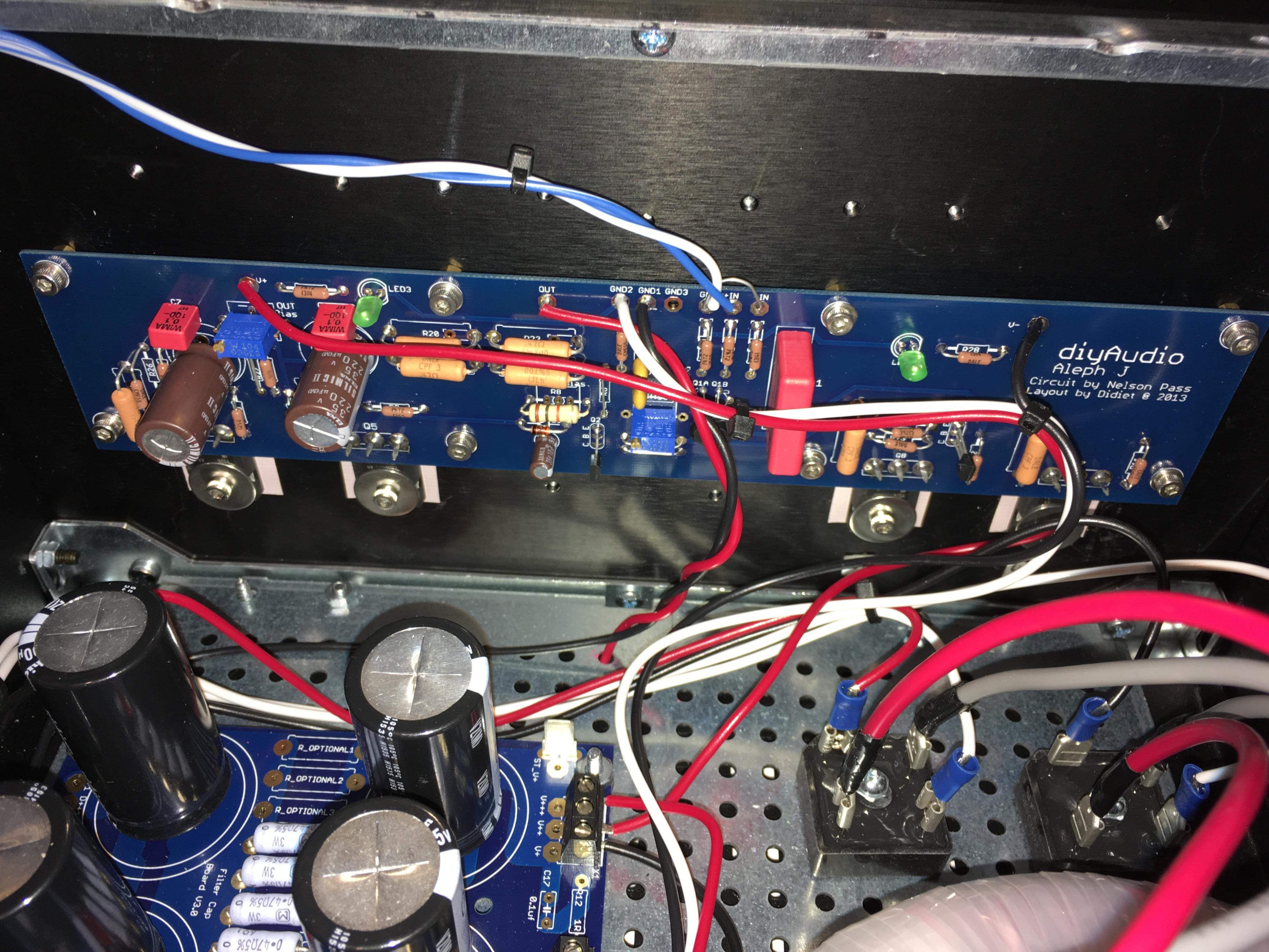

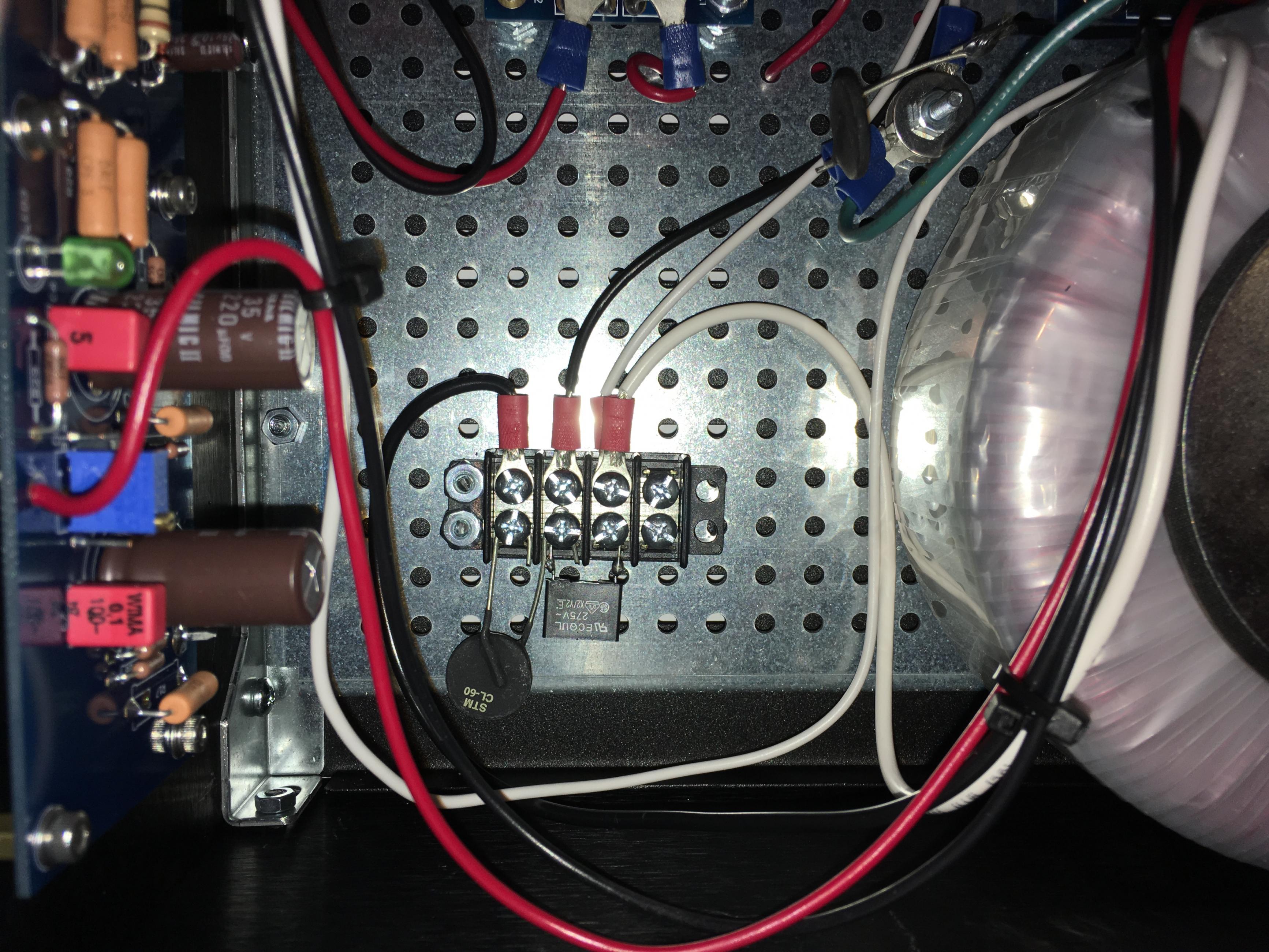

few pictures could help
also - you told nothing about xformer itself - size and origin (at least fast glance upwards didn't reveal that to my old eyes)

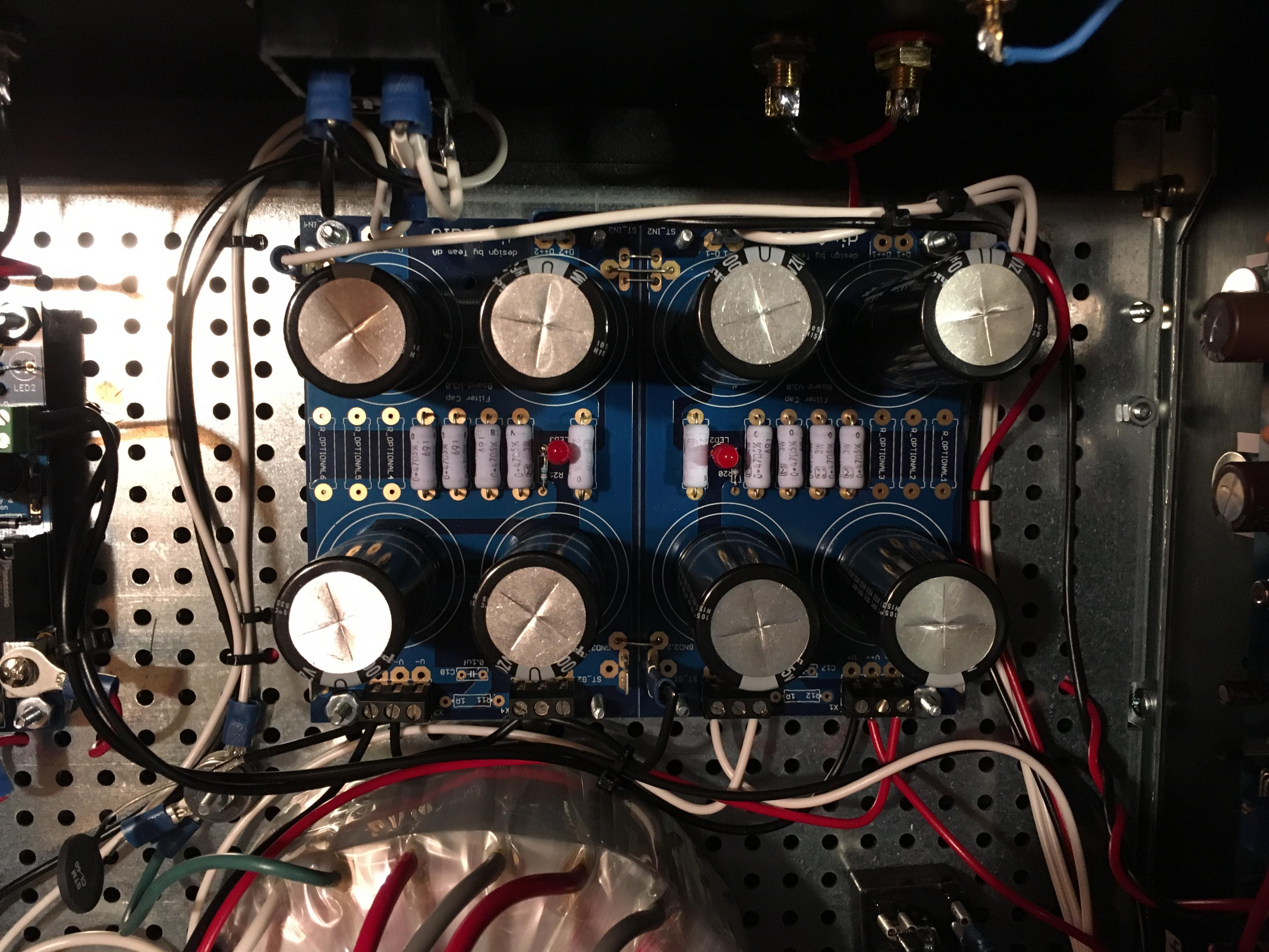

Hi Zen Mod,
The xformer was a custom order from Primrose here in Canada. It's a 400VA toroidal with 120v primary, and dual 18v secondaries. The manufacturer provided the following specs for the transformer:
Secondary:
1. 18v full load, 19v off load, Iac 11.20, output VA 202
2. 18v full load, 19v off load, Iac 11.20, output VA 202
Here are a few pics from different angles and zoomed in on different areas. The chassis is a little cramped, in retrospect I should've gone for the deeper 4U chassis.
Secondary:
Sorry, the pics will come asap. The site is not currently allowing me to upload pics, says there's an error.
You have a black wire connected to the positive (+) out from one of the rectifier bridges.
Ok if connected correctly on the PSU board, but confusing to me.
Hi NicMac,
I started running out of wire colours so for the rectifier outputs I made the (+) black, and the (-) white. So yes, By "standard" colour codes I can see why you would be confused.

JSA1971 - looks like one of Richards SumR/Primrose transformers. He might have a solution for you if you let him know about the buzzing and the application.
BK
