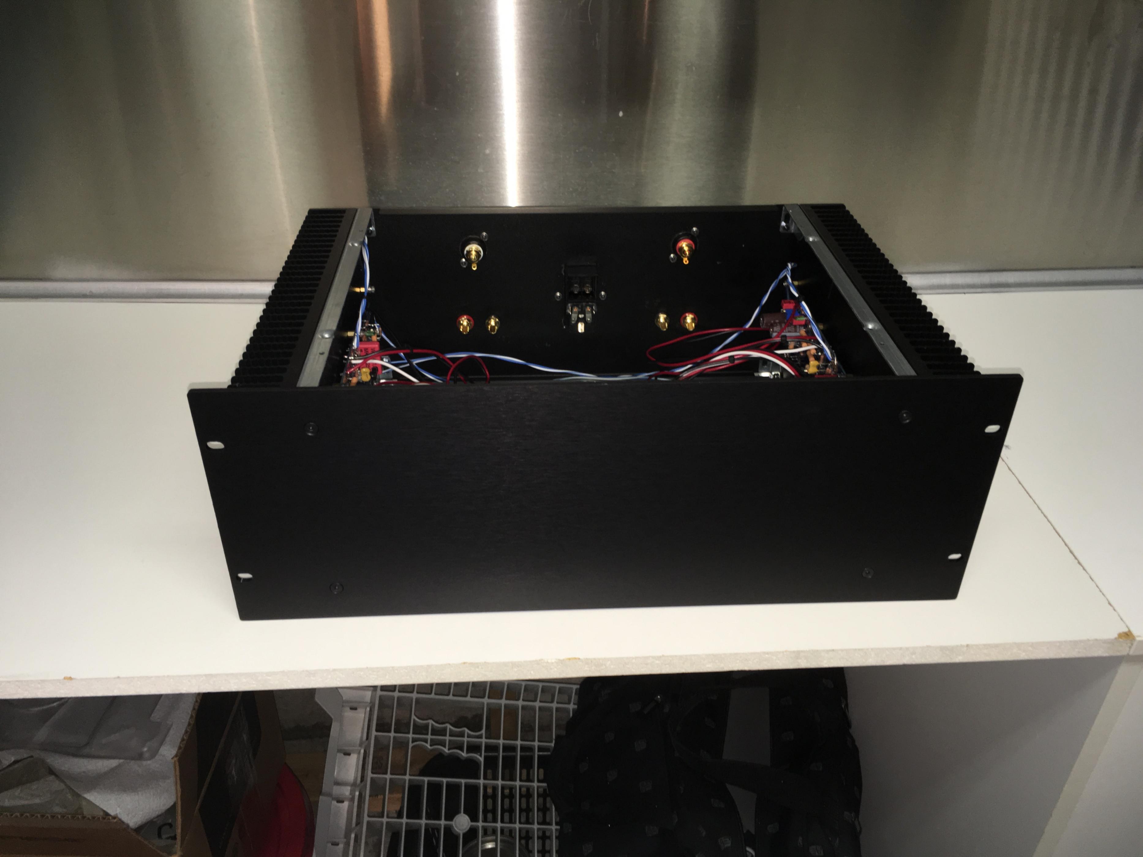

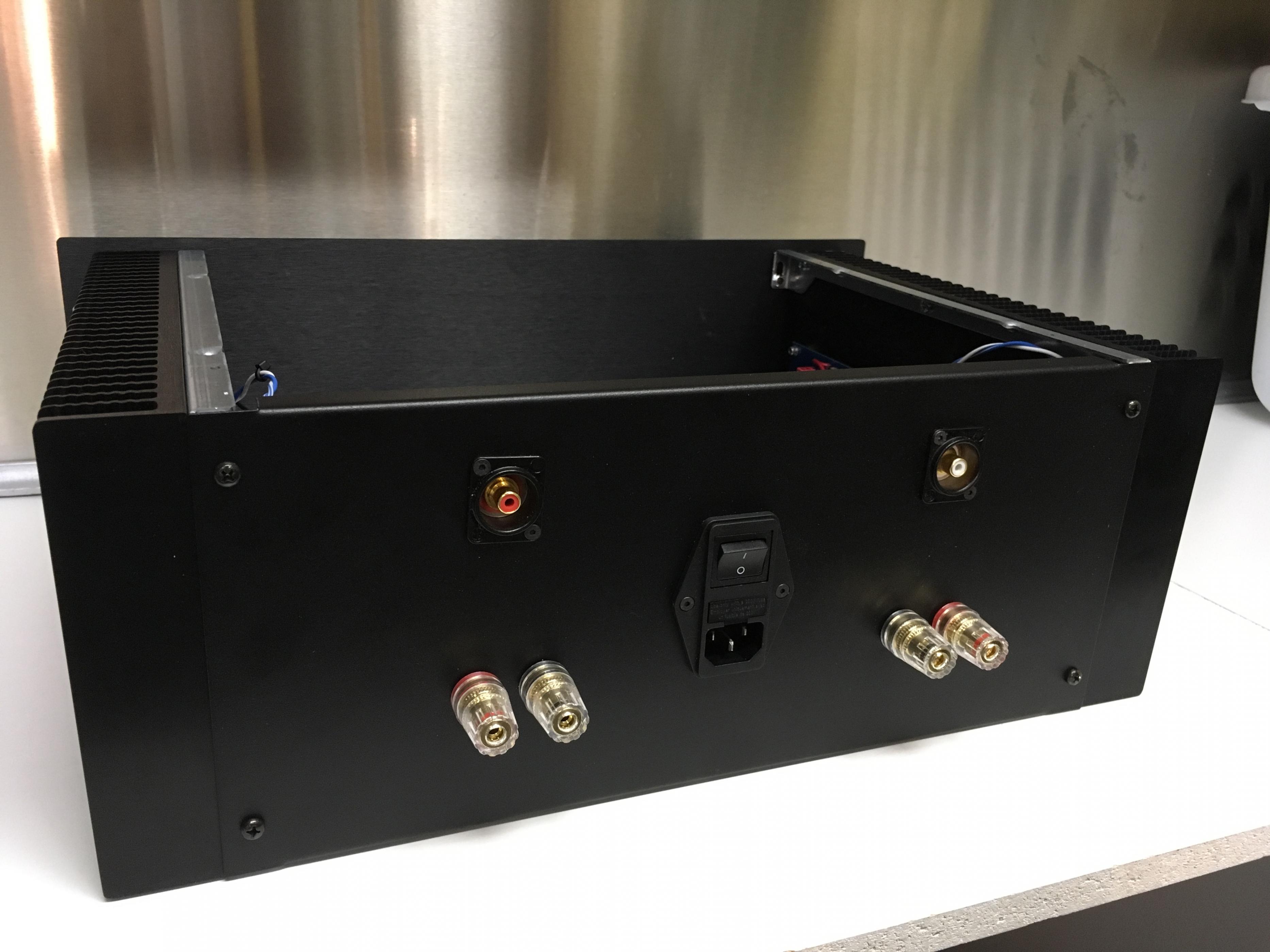

Hello All,
So I've finally found enough time to finish my Aleph J project! I'd like to thank all of the members of this great site for all of their help, especially 6L6 for putting together an amazingly easy and well written build guide, and answering my pm's with all of my concerns. I'd also like to thank member Dennis Hui for providing me with the matched Mosfets for the project, and also for his help along the way.
I've powered up the unit with the recommended light bulb test one board at a time and all went well. I've made all of the adjustments for bias and dc offset for the initial warm up and all seems ok so far. The one stand out issue is that the toroidal transformer I ordered is buzzing quite a bit, it can be heard from 4 feet away with the cover on. As I'm still in the warm up and adjustment period I can't tell if the buzzing will come through the speakers since I haven't hooked up any speakers no source to the amp yet. Any thoughts as to what might be causing the buzz, besides the possibility of a defective transformer? All of the voltages at the power supply feeding the boards seem fine at around 25v unloaded.
Pics to come.
Thanks in Advance
Pics to come.
Thanks in Advance
Some toroidal's buzz worse than others. The only cure I know of is replacement. Unless it is not fastened to the chassis tightly. You can check AC at the speaker terminals and tell if you will have any noise now before hooking up speakers. Checking for AC and DC at the speaker and input terminals is something I do on every build before plugging up anything. I have had good results with Antek transformers. The last build an F3 used an Antek 400VA 18V one and it has a tiny bit of buzz, nothing that is annoying or can be heard from a foot or two away. Most Antek's I have used are perfectly quiet. A lot depends of current draw of the circuit. You may want to get a higher rated one.
Hello All,
So I've played around a little with the amp this morning to see if I could isolate or lessen the buzz from the transformer. I disconnected one of the secondary leads to one of the bridge rectifiers "A", then powered up the amp only with block "B" and the buzz was gone. I then switched the secondaries with the rectifier blocks they were originally on and the buzz came back. Then finally connected only block "A" and the transformer buzz came back. Could the problem be with the rectifier block? Has anyone had or heard of this problem before?

possible to have Dodo or semi-Dodo Graetz ;
however , I hope you're not starting any of channels with just one PSU polarity present
