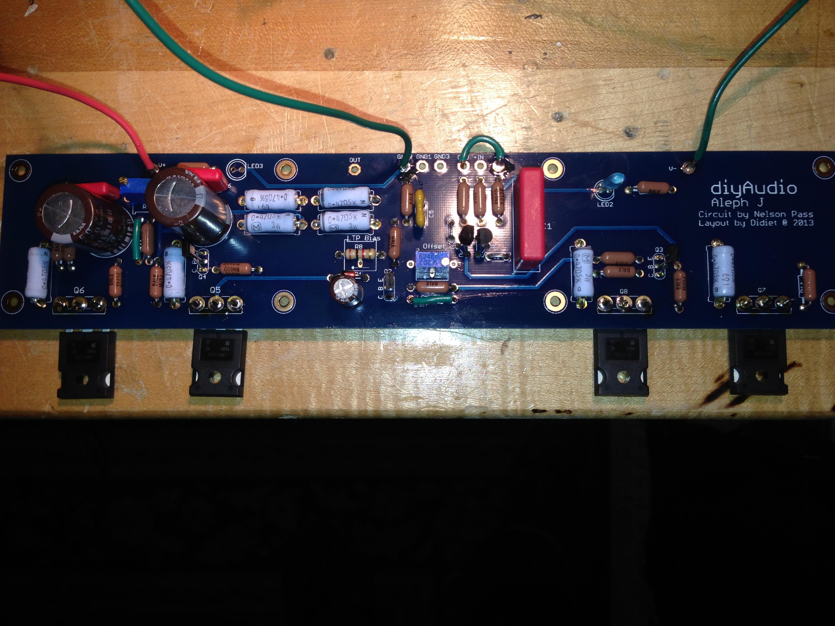

New Aleph J - Failed Bulb Test
Greetings, I’m a first time poster and a novice. I’m working on my second build. My first was an F5 in 2014 (tuned out well). The Aleph J is my second. I finished populating the boards and on power up, both boards (individually) are failing the bulb test, and have very similar measurements. AlephJ and PSU Boards, Jfets, chassis, purchased from the DIYAudio store, everything else is new from Mouser.
Prior to power up
· Bulb Tested PSU alone in chassis. Transformer is an Antek 400 VA with dual 18V secondarys. Without Alephj boards connected, 26.2 V+ and -26.2 V- and bulb glows for a second and then goes out as expected.
· I measured each resistor before adding to boards using BOM ver D schematic
· Set R27 to 68k and placed jumper where needed
· Set R7 to 1k, and used 1k resistor for R8
Tests / Checks - one board
· Replace Q2, Q3, Q4 with BC556/546, no change, other than some slight changes in voltages above, Zetex passed diode test after removed as well
· Replaced Q1A and Q1B with another matched set of Lsj74B from DIY store, no change (new pair - 8.1 and 8.2 idss)
· I verified placement and re-tested resistors (in place) each values match schematic, r13/r14 shows correct parallel value as those two did not measure individually, and verified orientation of transistors and capacitors
· Checked for any shorts or bad solder, reflowed each part
· Tested mosfets to be sure not shorted to heatsinks, and powered up without boards attached to heatsink
Current Measurements (both channels near identical) - With both boards or single board connected – 60w blub glows steady, just a bit less than bright
· V+ (+7.9) and V- (-7.9)
· 4.2v across R27
· 4.4v across R7
· 5.0v across R8
· 2.9v across R6
· 7.0v across R5
· 0v on R1, R2, R3, R4, R9, R10, R11, R12 R20, R21, R22, R23
· 8.7v across D1 (R7 adjustments will cause value to change)
· .2v on R16, R17, R18, R19, R26
· .1v R25
· Q5 & Q6 – G to S = 4.3v, G to D = .3v, D to S = 4.6v
· Q7 & Q8 – G to S = 4.3v, G to D = 6.2v, D to S = 10.5v
· DC offset 2.4v
Observations for one board
· Adjusting R7 to lower DC offset - blub glows brighter as dc offset decreases. Lowest DC offset I can reach at pot limit is .3v with very bright bulb
· Adjusting R7 to increase DC offset, blub eventually go out right at limit of pot, but DC offset is now extremely high at 19+ v
· Mosfets are basically cold, Q7& Q8, maybe a just a little warm
The picture is before I switched Fairchild BJT. I ordered some spare mosfets and Zeners, but do not have them yet. I am thinking POTS, Mosfets, and Zener would be next in line to pull check, all seem like a long shot, something is just not adding up that I am missing.
Thanks in advance for any suggestions and insight offered.
-Donn
I have been there, done that!
You cannot set the bias with the bulb tester in place.
I have been there, done that!!
The bulb tester is only to be connected when you first start up the amplifier (or any other device that you want to test and suspect can be faulty). If you have faulty conections or there is a major error in one of your components it will show that something is fishy by lighting up abnormally and you have a chance to switch it off before something is burning, but after that..... disconnect it!😎
Since the filament is affected by the amount of current that you send through the bulb and therefore also change the resistance of the bulb (the quantity of light emitted) you have no use for it after the first check.
You will even have problem measuring anything in the amp with the bulb tester connected cause you will not get correct readings. Instead, if you start adjusting the current used by the amp, the bulb will counterwork that by higher resistance and burning brighter but you will end up with less in your amp so......
ONLY ON THE FIRST START UP!
You better connect a dummy load on the output, that will help you more.
The good thing about trying to set bias with the bulb tester is that you very likely will not do any damage to anything!
Let it warm up and check the offset again.
(And "warm up" in Aleph land really means "get darn near hot")
Start by posting some in-focus, well-lit photos. 🙂
