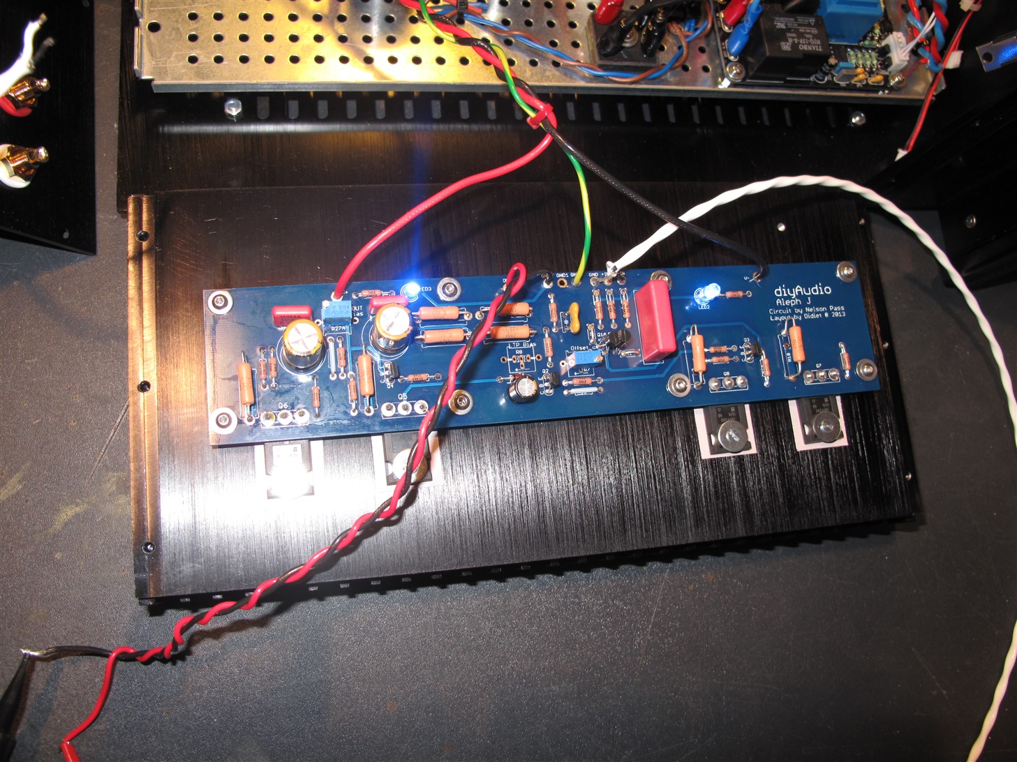

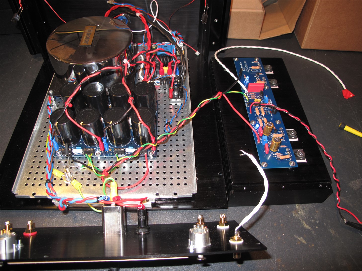

Well, i'am going to try to be clear.
- Amplifier and PSU PCBs come from DIYaudio Store. J74 JFETs too;
- The 400 VA trans come from TOROIDY;
- Other parts from Mouser.
Some pictures are attached.
Problems :
- I soldered ZTX450, 550 and Led 2 in the wrong way --> I changed it. And now it work a little bit better;
- But, Q5 and Q6 are hot (normal), Q7 and Q8 remain cold. Input DC from PSU is -24 V / +24 V. The two leds are shinning. Output DC value is -20 V. The problem is the same for the two amplifier modules.
Do have any idea why Q7 and Q8 remain cold ?
Regards
biasing procedure - did you read beginning of the thread ?
negative DC offset on output means that lower mosfet is wide open , so you need to decrease resistance of R7' (trimpot)
if everything else is OK
OK. Initially did biasing procedure but i didn't turn the pot enough.
Yesterday i tryed again and now all the mosfet are hot. But the DC output is very unstable +-1.5 V around 0. Is it normal ?
Thanks for your help

that's too much +/-1V5
however , without any cables on input and without temp equilibrium (for that , case must be finished and lid on) it's hard to expect total stability
again - Iq and DC offset setting is iterative process , top lid on , as condition that amp gut is on steady tempreature
