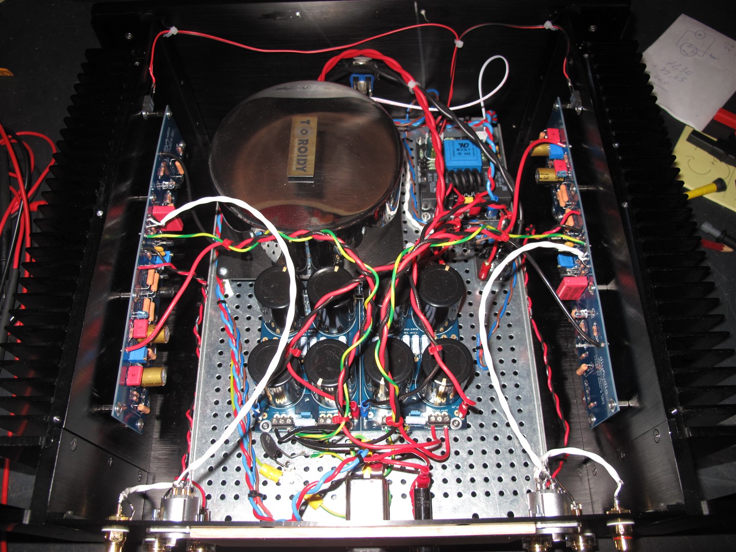

It's alive!
I let it play for a few hours yesterday. I think I can turn up the bias on it. The heat sinks were at 110F - 113F after a few hours. It sounds real good and is quiet. I put my ear up to the speakers and did not hear any hum or buzz. Thank you everyone for help and guidance. Here are some pics.
URL]
URL]
URL]
URL]
Thanks guys!
For those wondering about the clear brace on the caps. I think it was my fault for not pushing the caps down enough but once soldered they seemed a little flimsy sitting on those two little pins. So to take the stress off the pins I made a 8 pack brace out of Plexiglas to hold them together to stiffen them up a little.
I also figured out why the other channel is not playing music. After an extensive debug and trace back all the way from the input signal with the oscope, I figured out R2 and R4 was wrong. It was 221 ohm instead of 221k as in schematic and the other working channel.
I only play music through my cheap test speakers for now. The music is very clean no buzz or hum from soft to the loudest volume. There is no thump on start but there's a slight/soft thump on switch off. Other than that, I consider this is a success for my first DIY monster amp project. I currently let the amp warms up and will post some pictures of the finished product later.
Thank you Jim again for helping and pointing out some of the things I did not do right for my first DIY monster amp.

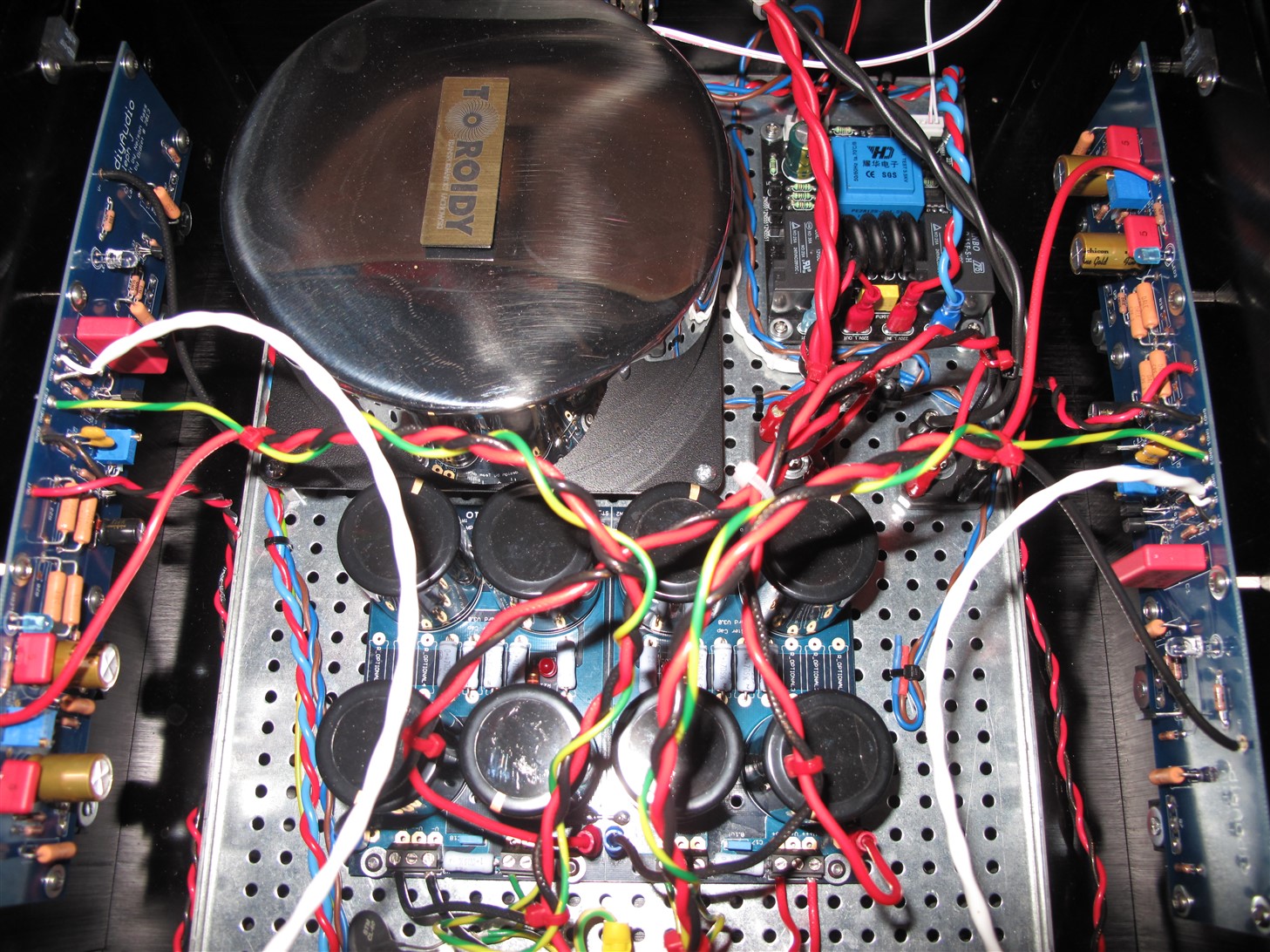

Well, after a weekend of tests. No progress.
I finished the assembly and i tryed to tune R7 and R27. Bias was OK but offset drived me crazy. No stability, even after a hour of heating. I measured a 1.2 Khz signal across output jacks with +-0.5V DC range and peaks to 1 or 2 V.
First measurement at cold start was -20 V ! and it slowly increased to nearly 0.
Some pictures attached
