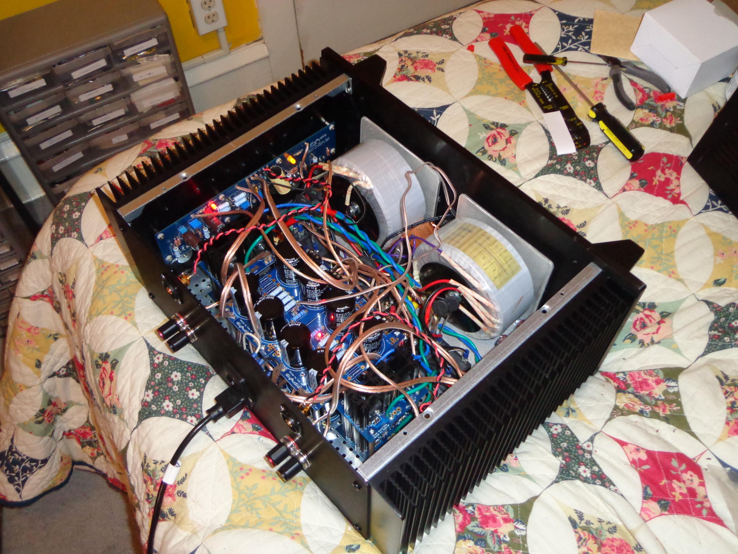

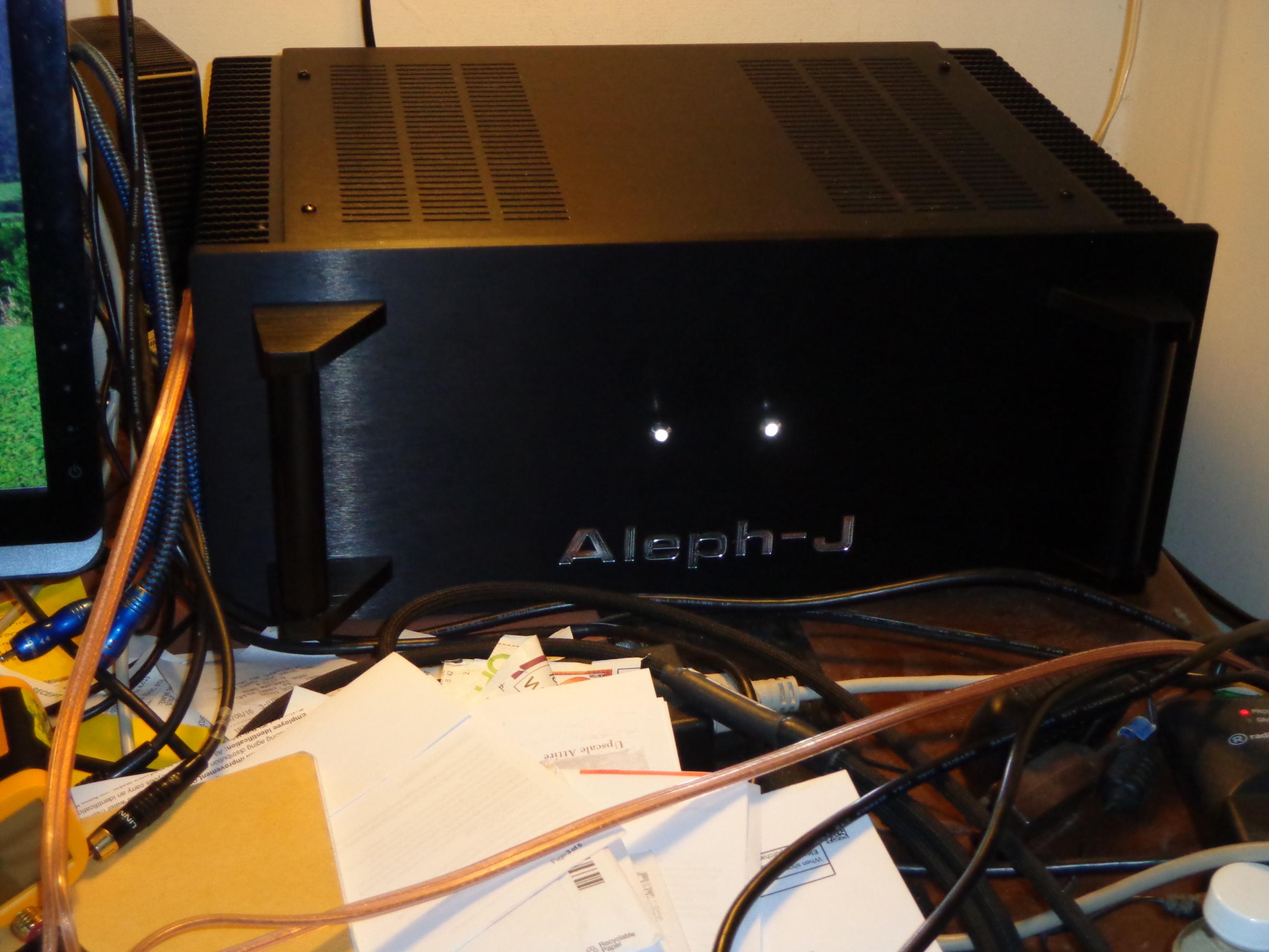

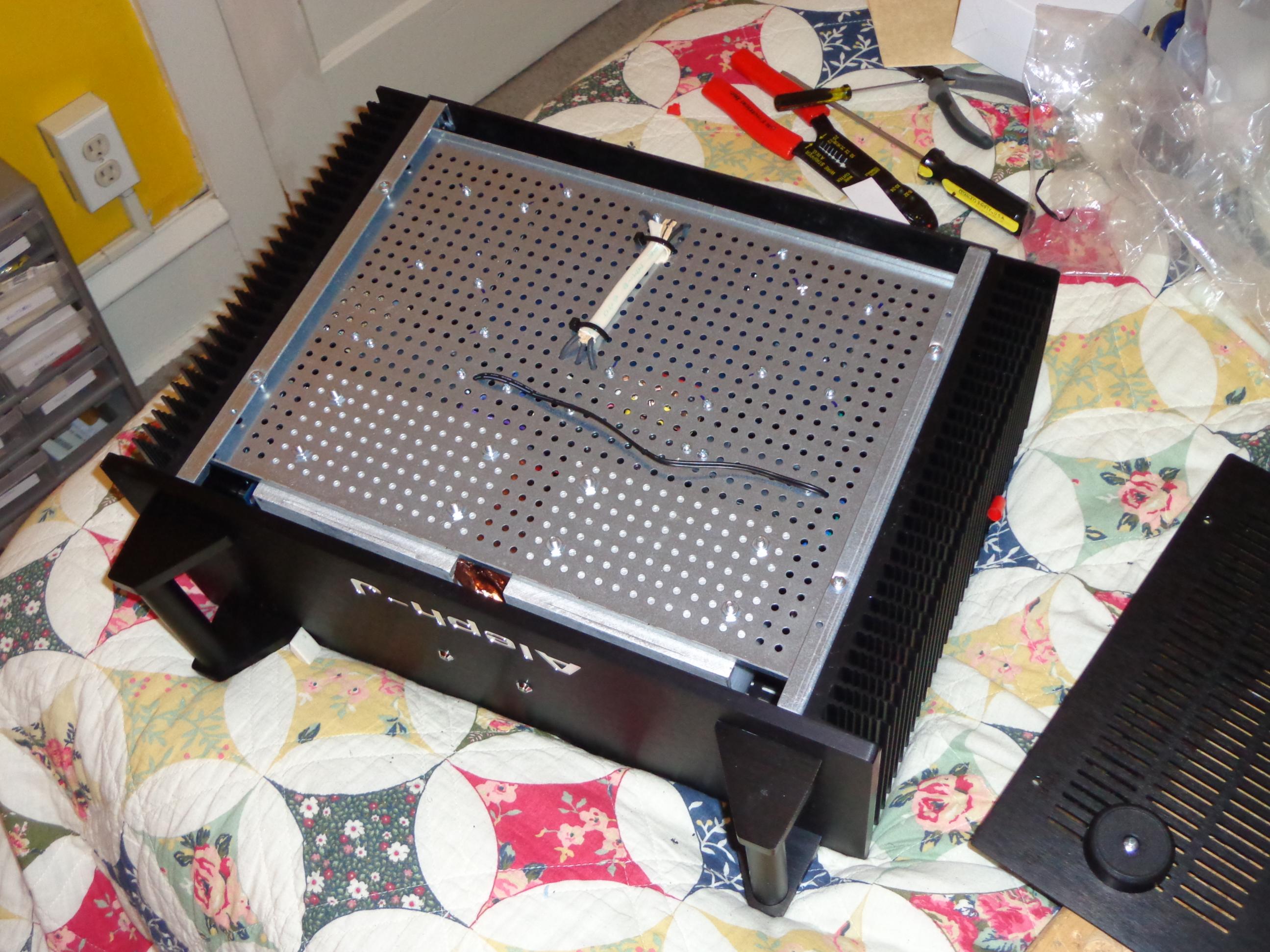

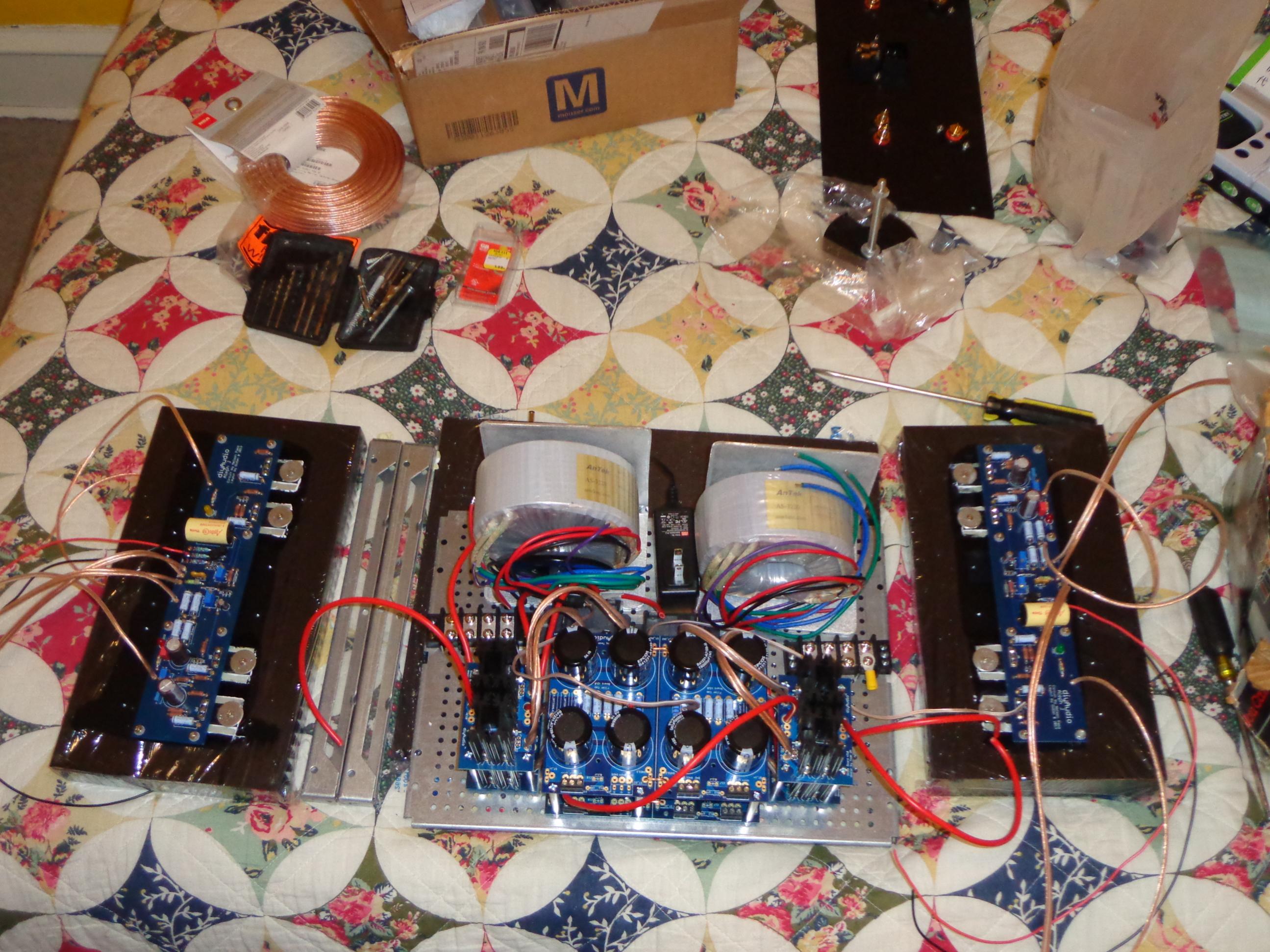

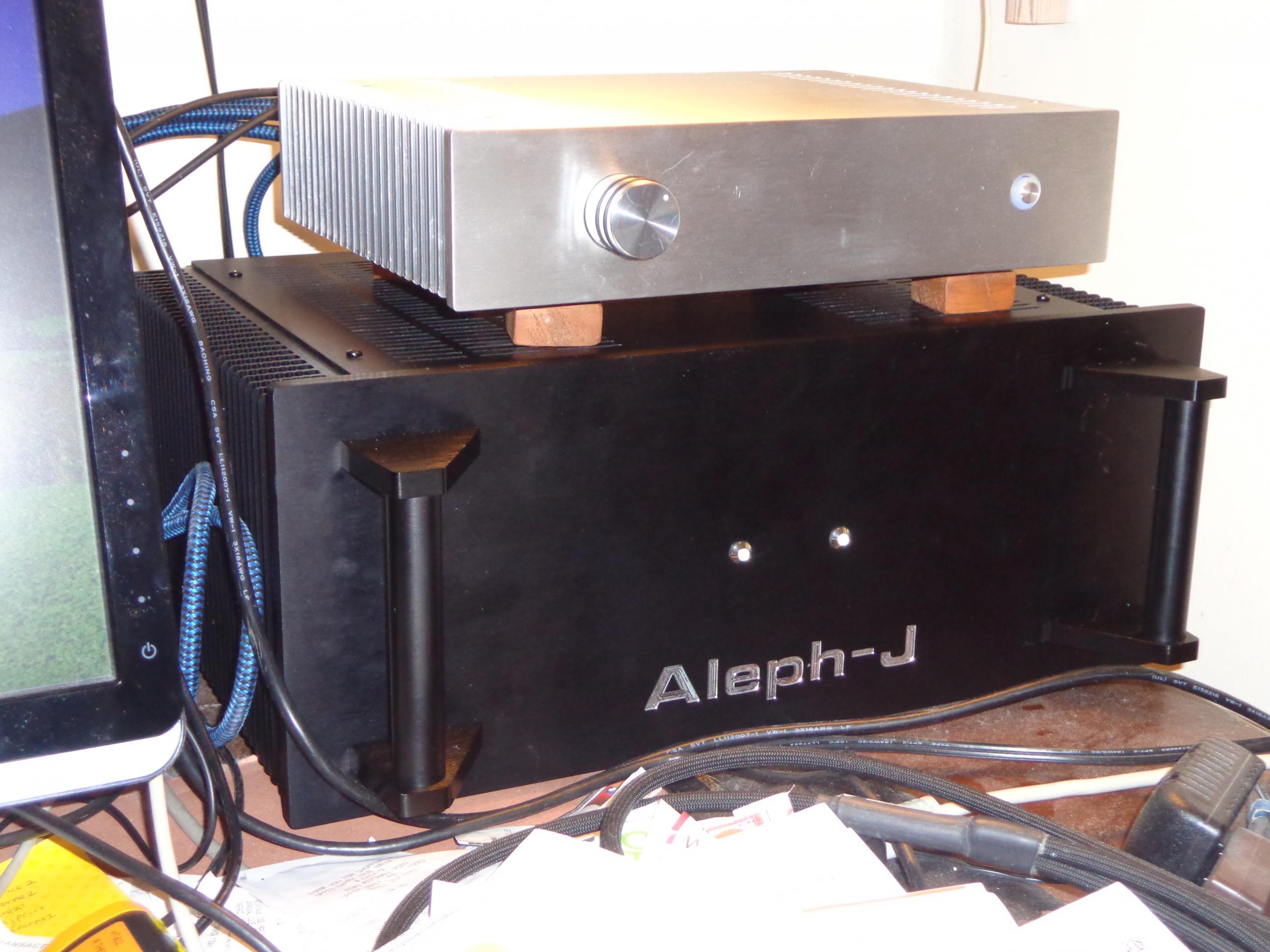

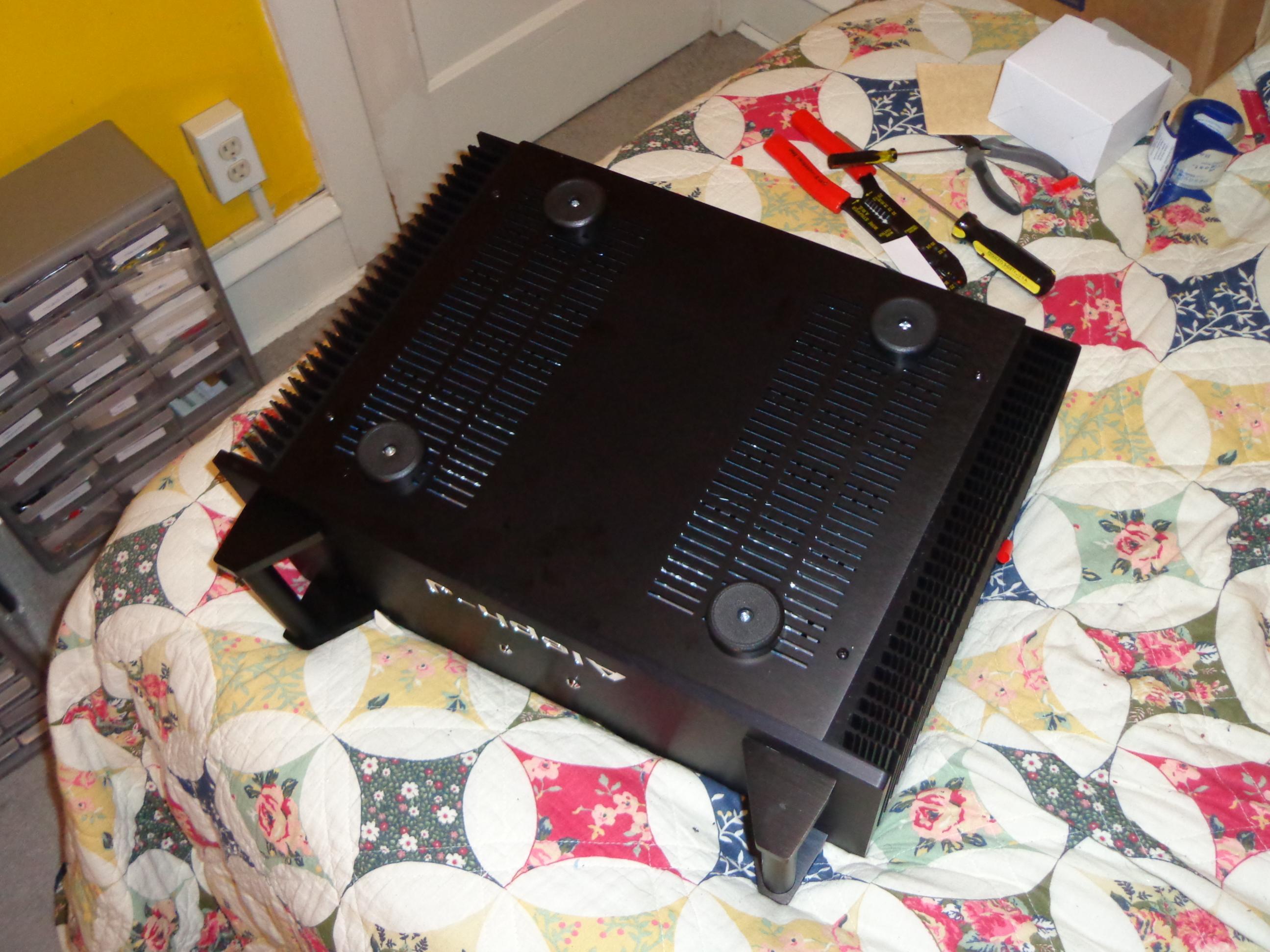

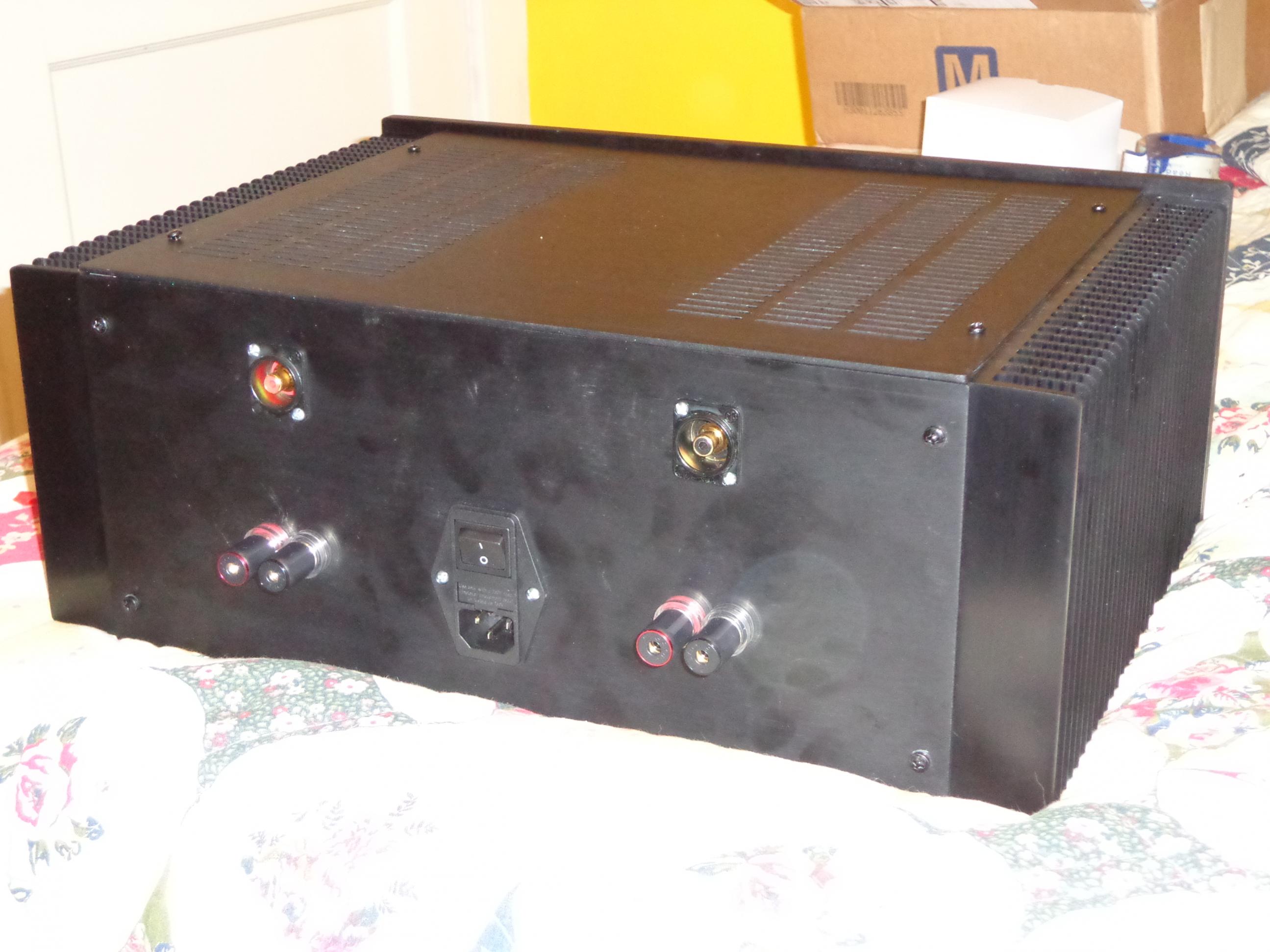

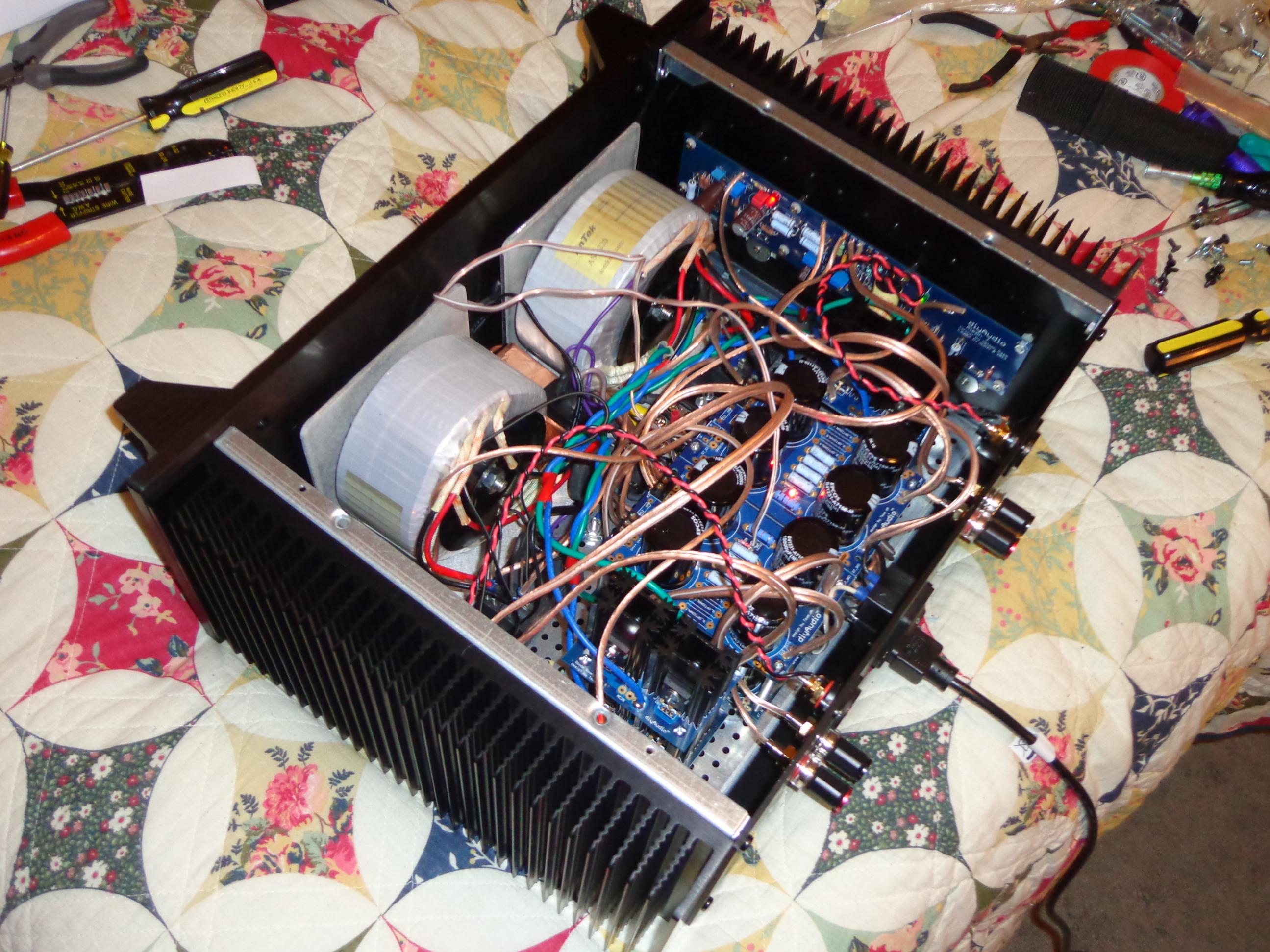

New Aleph J build
My Aleph J is finally done. I used the DIY store 4U aluminum chassis, and a dual power supply, also from the DIY Audio store. Bias was set at 420mV (~0.89A), and I probably could go higher - the heat sinks reached 55º when separate but only get to 45º or so with the case assembled. Very pleasing sound - softer edges than the F6, not as "big" a sound as the M2, but very easy to listen to.

And I would be remiss if I didn't thank 6L6 for his nifty build guide - it proved invaluable.

Congratulations Schulbert on your Aleph-J. That is one serious power supply.
Did you make those transformer mounting brackets?
Dennis
