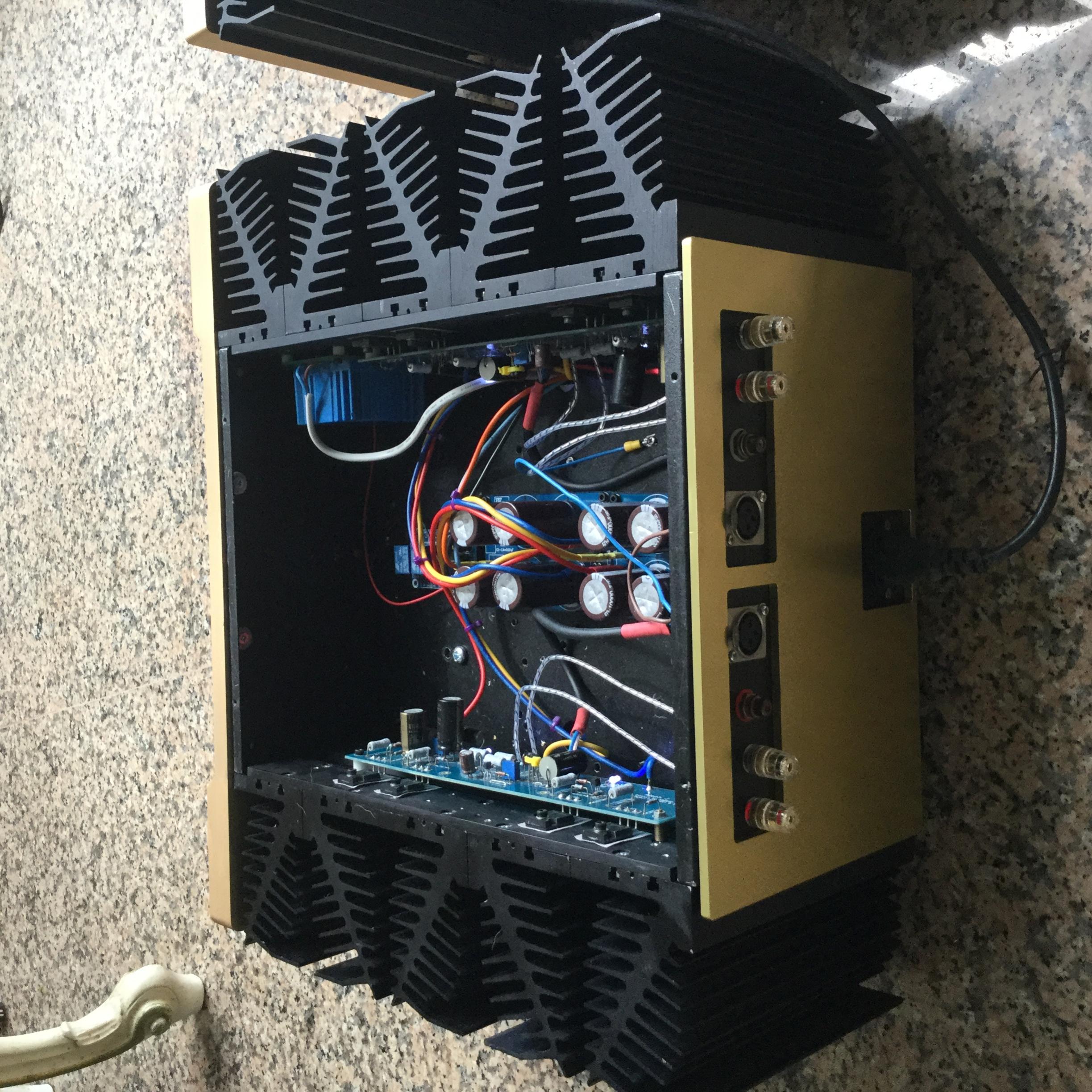

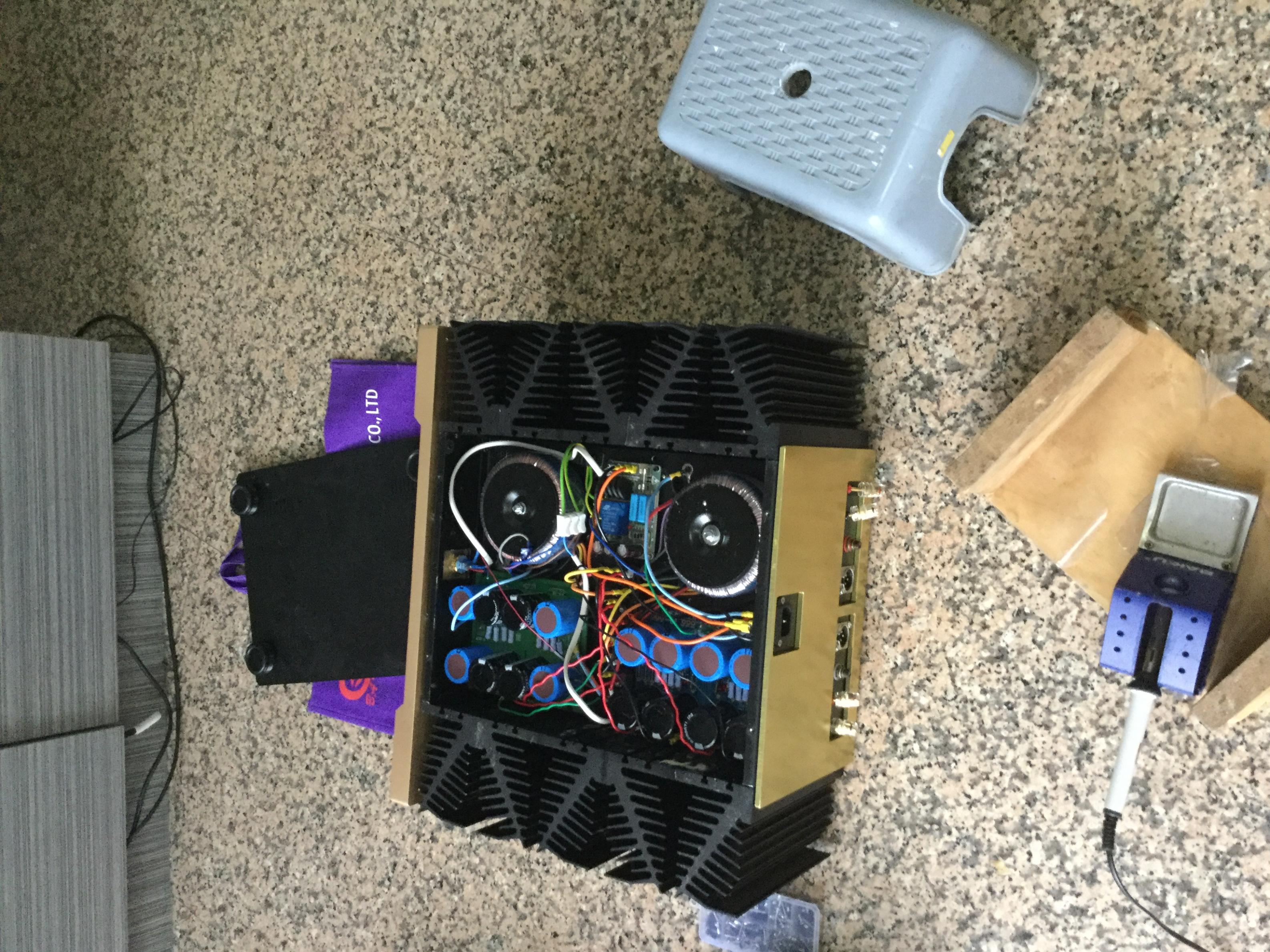

Aleph J
Just finish aleph J
Use 2x 250 Va Sec 2x18v
CCRCC
Basic 1.6 A
Thanks a lot mr nelson pass
Best
