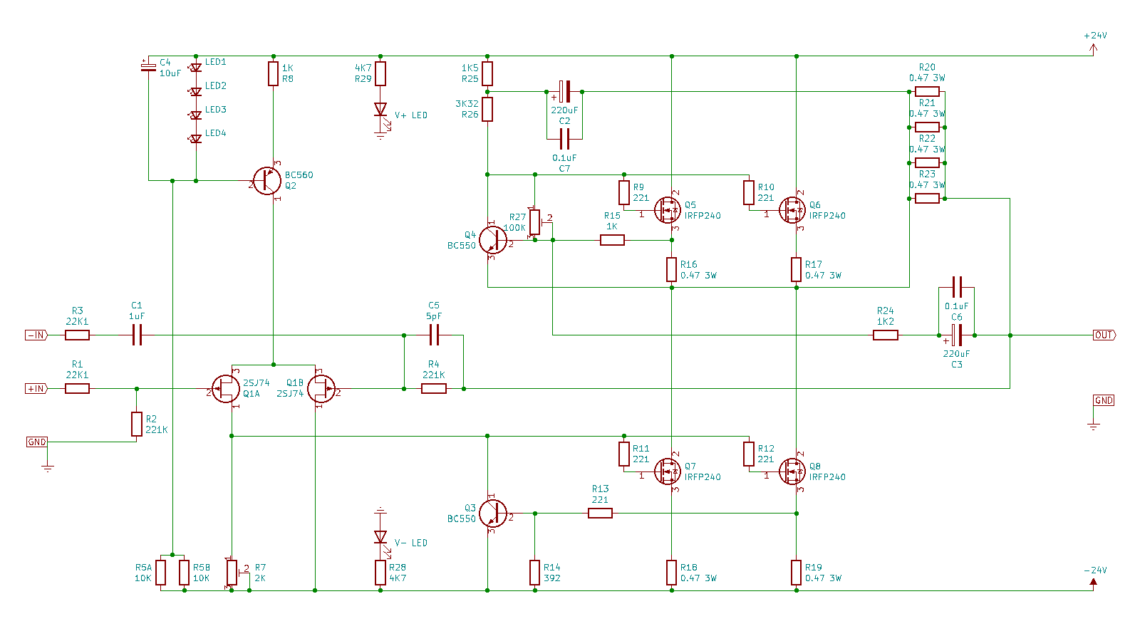

Zen Mod, can you please help.
What does it need to change Zener to series LED's in Aleph scheme?
Is it as simple as change Zener diode with series LED's but in opposite direction?
Should I change any other scheme parts and their values?
I drew this cheme with only Zener changed.
Plan was 4 LEDs in series with about 2.25Vf
Maybe Kingbright WP3A10HD (Red) or WP710A10PGD (Green).

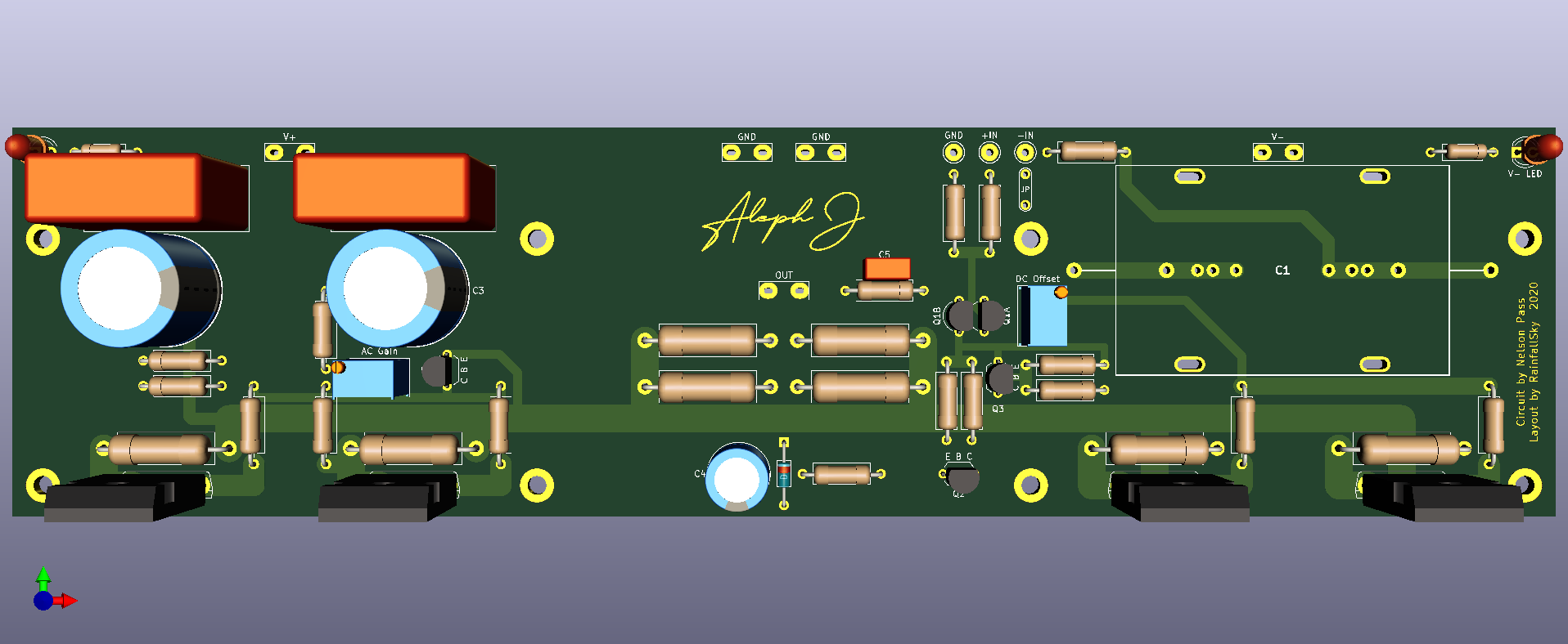

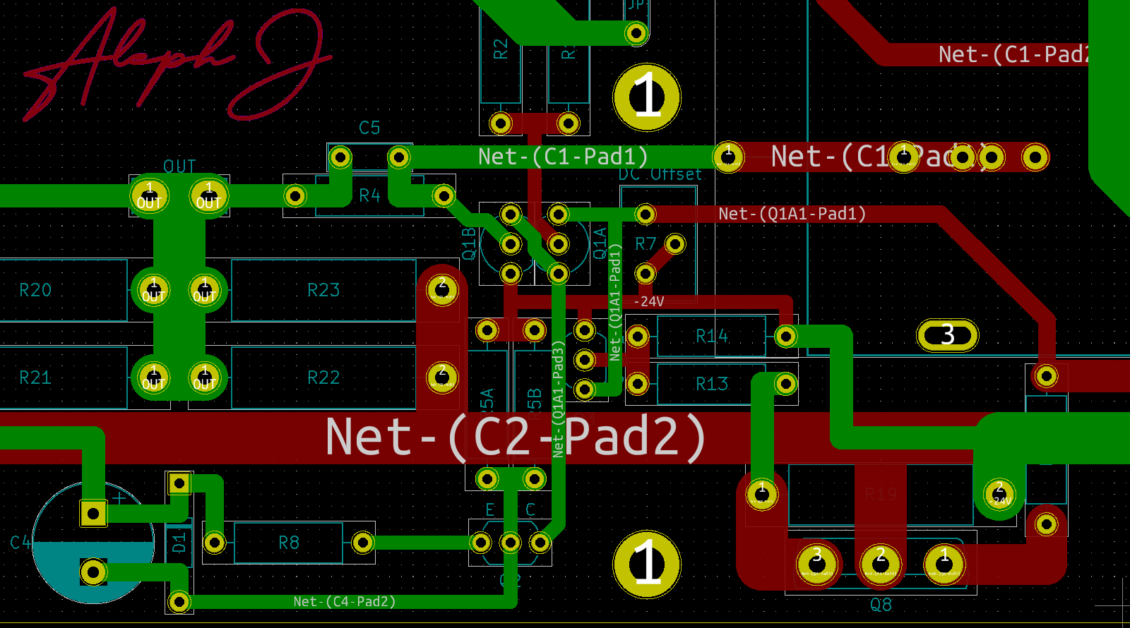

Yes I try to make my own UMS heatsink compatile board in KiCad.
My first try in Cad software and my first board.
sleepy now, will sketch tomorrow for you
single BC up is overburden (think heat)
for CCS - use ring of two, then you don't need LEDs
see my Babelfishes
BC+ BD
see my Babelfishes
BC+ BD
But can LED's stay?.. 🙂
This is DIY Audio store Aleph J scheme with changes to R5 split in two and changed Zener to a string of LED's.
I only have doubts change Zener diode is as simple as that.
- Aleph J for Universal Mounting Spec
