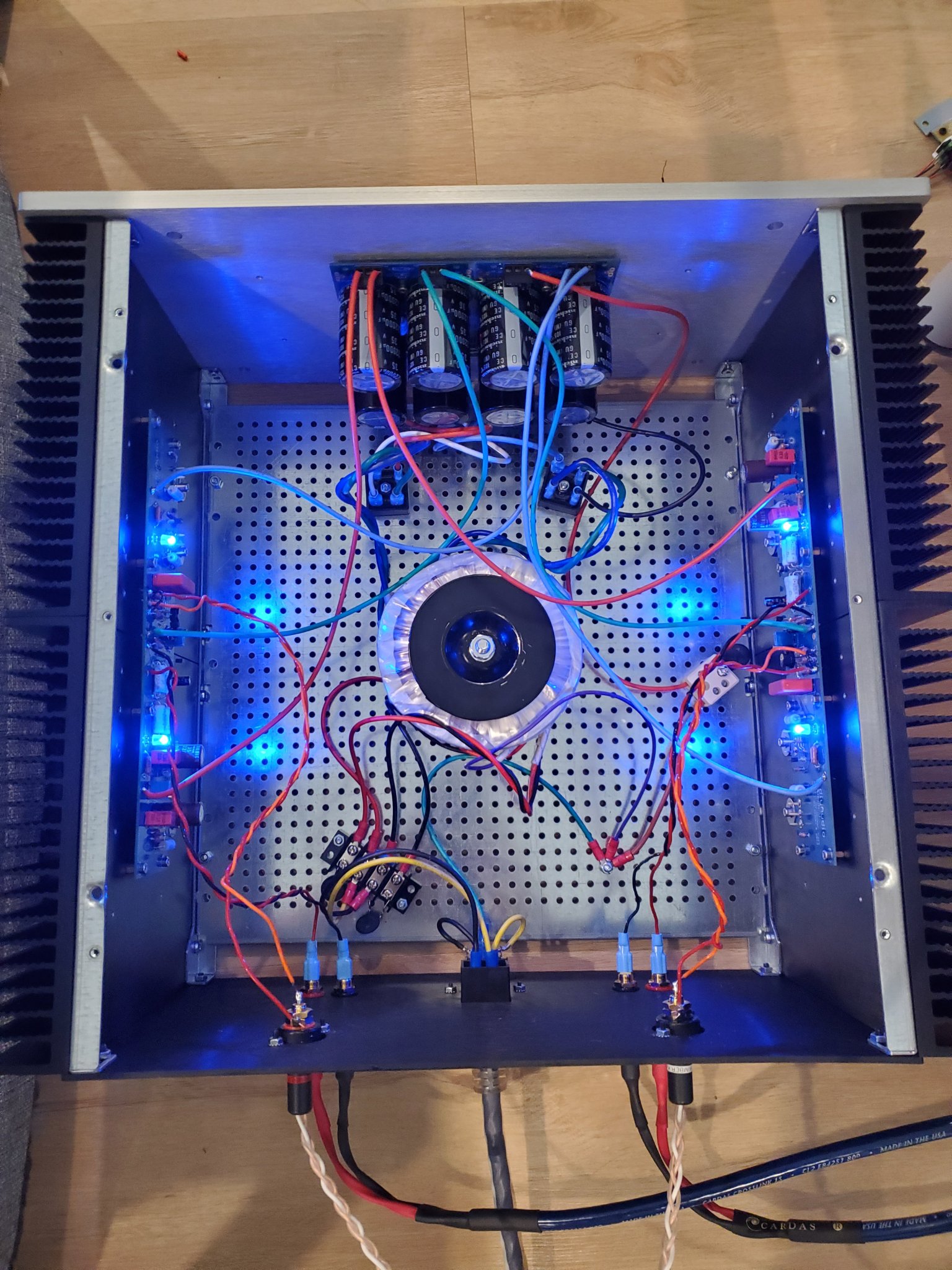

Wow. Thank you everyone. Point taken on the 5U chassis. I'll get that one. I think I'm going to go ahead with the Aleph for now, and either scrounge for parts, or wait for the store to restock. I think given my speakers and tastes, I'd probably like the F6 more, but that's what makes this all so much fun, is getting to try lots of things. I will spend some time researching different options for the power supply. Also thanks very much for the reminder on the mains voltage!

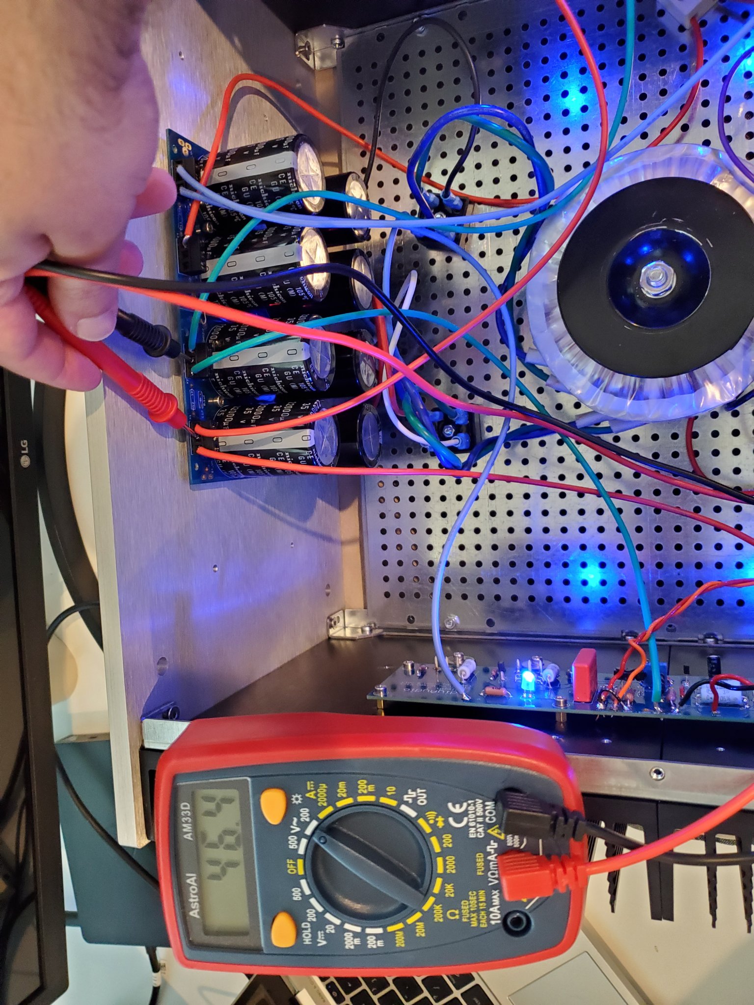

Well, here's a pic, reading 46.4v ac, far as I can tell. It sounds incredible, I have the bias right at 400 on each channel with close to 0 offset. When I switch to DC on the multimeter, it reads like 22 to 23 v. Temperatures read just fine too.
Yeah good call. I dug around on this and it seems that cheaper multimeters can only measure ac voltage when there's actually a sine wave present. If there's only DC current present, there's an algorithm it uses that gets confused and just reads double the DC voltage as AC. My AA battery read 3v.
That's terrible for a multimeter. It can't be trusted. Even my cheapest meter which cost me less than $20 a few years ago measures VAC correctly.
Look for a meter that measures "true rms".
