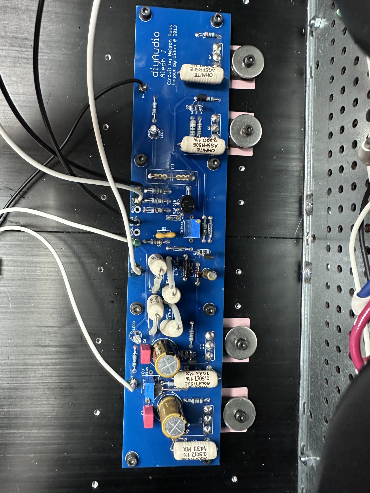

Yeah I still don't know what I'm doing to want to push things, even if it does decrease distortion. I noticed a difference in the sound, much cleaner, sharper presentation, I noticed highs much more, which I don't love. It kind of changed the character away from what I love about this amp. So it's back to 400mV and the Nutube B1 Preamp. Overall this thing is just amazing. I know it's probably a ridiculous statement, but I actually like it more than the XA25. It has more of its own distinct character. And by the way, it drives my 86db efficiency Proacs just fine in a 500 sq ft room (with a sub, so sue me).

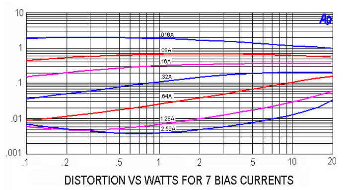

This is an interesting graph from the "Leaving Class A" article. A wise man will heed the warnings from ZM, otherwise things are gonna suffer a horrible death if pushed too hard..
Ahh, I just revisited the article from Nelson's website. Then, I noticed a few more articles there, like "Audio Distortion and Feedback", which is also a timeless piece. Beautifully written and explained. Both articles go hand-in-hand quite nicely.

The bias in my Aleph J was around 460mV for a very long time. Then I spent a few days playing with bias settings and settled at around 400mV... However, once I invested (even) more time and money in the quality of my source (mostly its power supply...), I easily adopted higher bias as being much better sounding. So now I have my bias sitting at around 440-450mV... and this is after the amp is fully settled (warmed up).
I'd go higher... the only limiting factor at the moment is my toroid transformer rating. Power dissipation per each MOSFET is okay, and heat dissipation is as well (5U deluxe chassis).
You should consider bypassing the C1 capacitor in Aleph J. That was a huge improvement in sound quality when I tried this mod in my setup (I pretty much removed it a few days after I built the amp). I also removed the short-circuit protection transistor. Of course, make sure that you understand what these mods could do if you are not careful with the source components. In your case, B1 pre-amp might provide an additional level of safety because (I think...) it may have a sound coupling/DC blocking capacitor at the output.
Edit: Aleph J is a differential input amp. As such, using the B1 preamp would also limit its (Aleph's) potential. Get a balanced source, ditch B1 pre-amp, ditch C1 capacitor... and see what happens 🙂

I used 5W Ohmite Audio Gold, they fit but it takes a little finagling to get things to fit. I wanted 3W but couldn't locate any.
