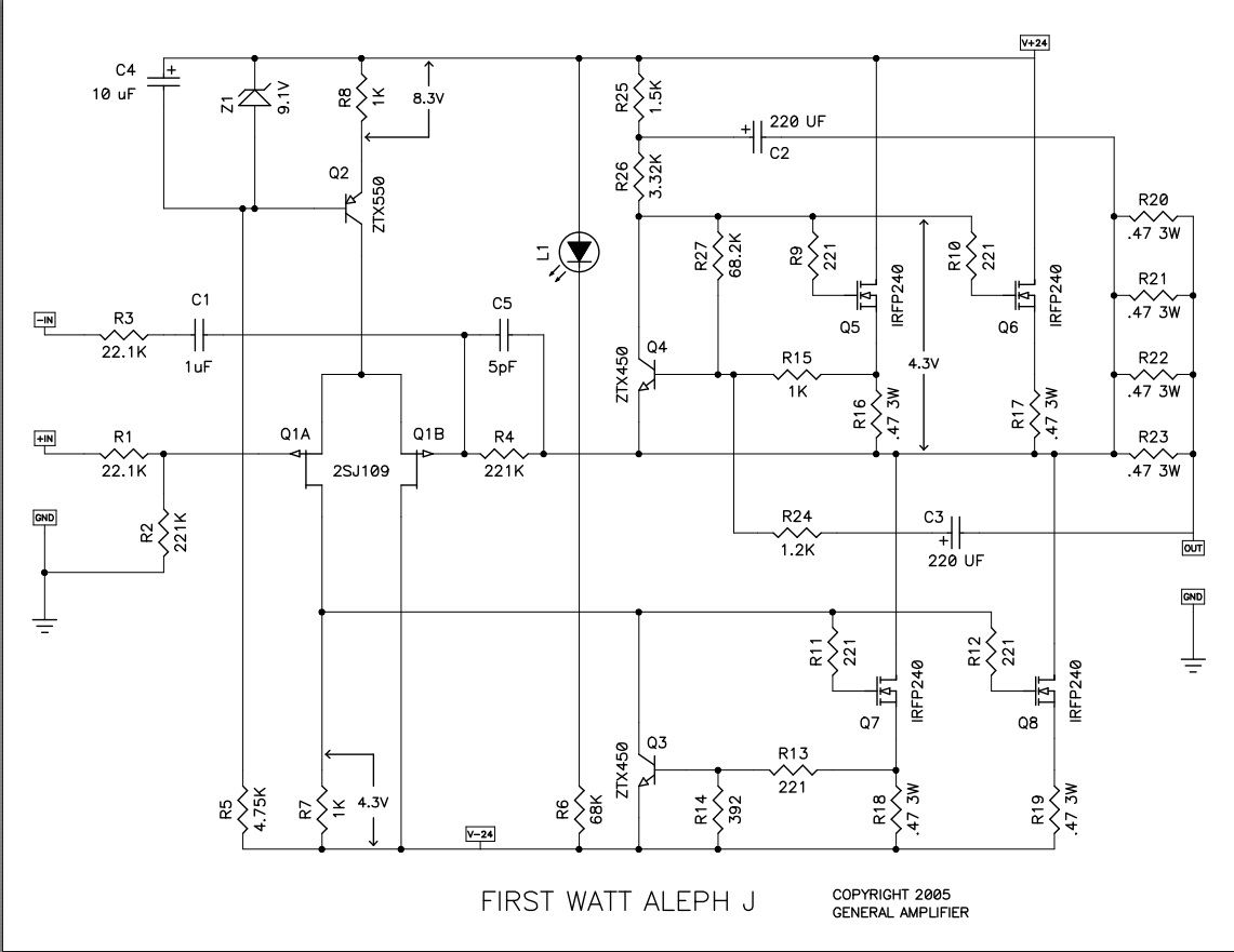

.... however, accidents do happen, so I think it is really wise to keep that C1 as an idiot-proof, safety precautionary measure.
The non-inverting input does not have a capacitor, so there is sill a way for DC to get in there. If one were to avoid accidents, wouldn't it make sense to fully block any DC by adding a capacitor to the non-inverting input, too (i.e., set gain = 0 instead of gain = 1 at DC)?
entire amp is acting as operational amplifier , and since negative feedback is connected from output to one ( that one with series cap) input , it'll behave as any other operational amp - it'll do with own output everything to level both inputs to have same potential ( DC voltage level)
if one input is coupled to outer world with cap , it'll see only own output in DC sense , while other input will see outer world
if you move DC coupled input by one volt DC (lousy DIY-ed preamp ) , all what amp needs to do is to move own output for one volt , so other input is seeing (being at) 1Volt and - voila! - both inputs are on same level
so , 1V on input causing 1V of change at output - that's unity gain ........... 1V/V , written differently
while for all other ziggyzaggy signals amp is still having gain of , say , 10 times , or 10V/V
edit: pretty much all Papamps , having symmetrical rails , and having cap or two at inputs are fully operational when idiotproof caps are shorted , for greatest purity and puritanism

Why would you feed DC into Alep J?
I have no intentions to do that. I am just trying to figure out the reasoning behind the way the the capacitor(s) are (not) implemented in the diyAudio schematic.
entire amp is acting as operational amplifier ... feedback is connected ... to level both inputs to have same potential ... if one input is coupled to outer world with cap , it'll see only own output in DC sense , while other input will see outer world ... if you move DC coupled input by one volt DC ... 1V on input causing 1V of change at output - that's unity gain...
Yup. That's exactly my point. If the goal is to avoid accidents with DC at the input, you'd want to avoid DC at the output. So you'd want gain = 0 at DC, not unity gain. The "avoid DC accidents" motivation would therefore lead to a capacitor in both inputs. That seems not to be the case here. Why?

Because that’s the way Nelson designed it.
https://www.diyaudio.com/forums/att...97d1194037871-aleph-schematic-aleph_j_sch-pdf

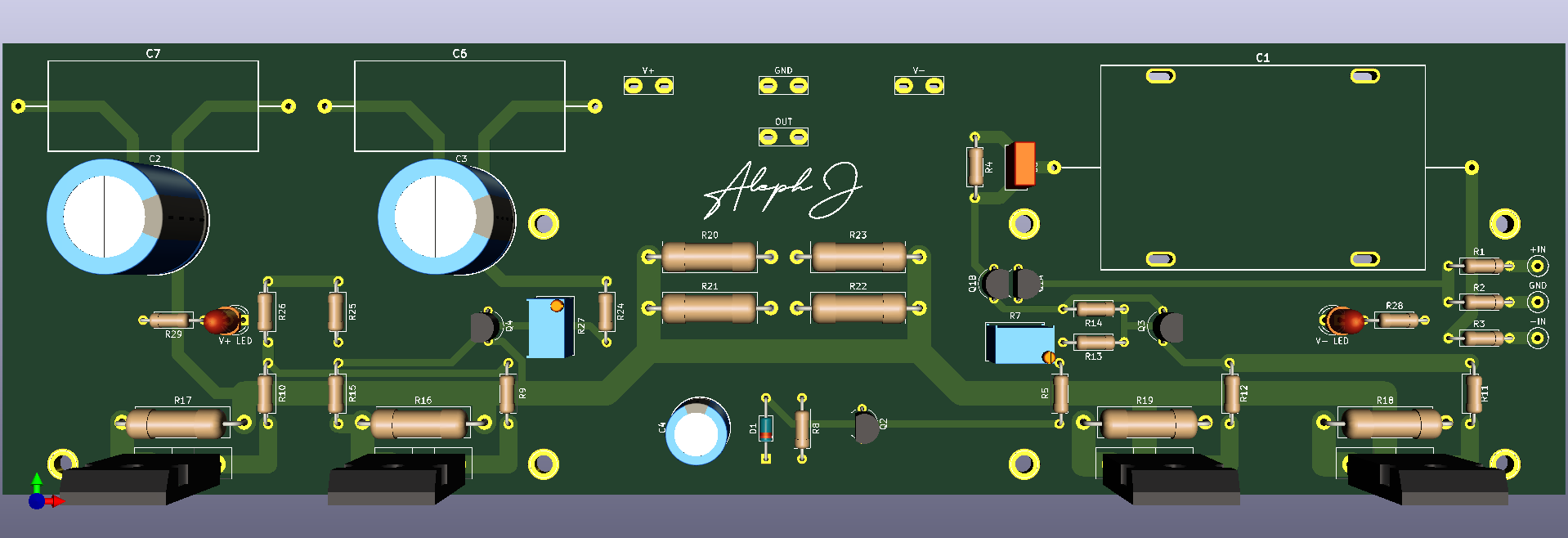

I decided for myself that I want to build Alep J sometime in 2021-2022.
looking at Aleph J DIYAudio boards and parts I thought I want C1, C6, C7 to be big fancy axial foil capacitors. (Why not? This is DIY)
But fit them to DIYAudio boards would be kind of hard.
Looking at DIYAudio Aleph J scheme I was thinking maybe I could build boards for my needs myself and also want it to be UMS (Universal Mounting Specification) friendly.
Reading a bit in Software Tools threads and found my software to try and learn would be KiCad.
It's not newbie friendly and took 1-3 days of youtube learning lessons to start doing something.
So it started as hard and I stuck on every two steps then It become easy and.. hard again but fun.

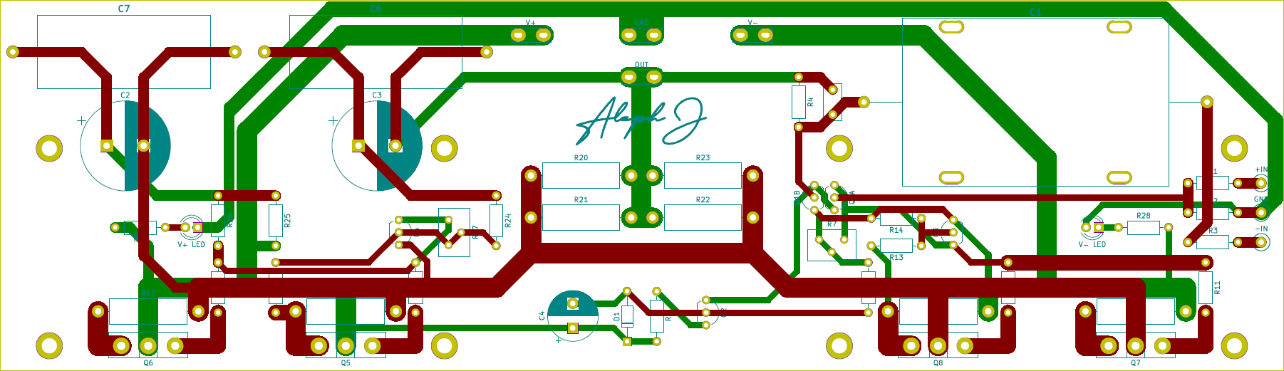

Drawing layout is a maze puzzle. Just when I thout I have nice layout on some parts I stuck in a dead end trap on other parts so I move them countinously and redraw layout lines.. 😀

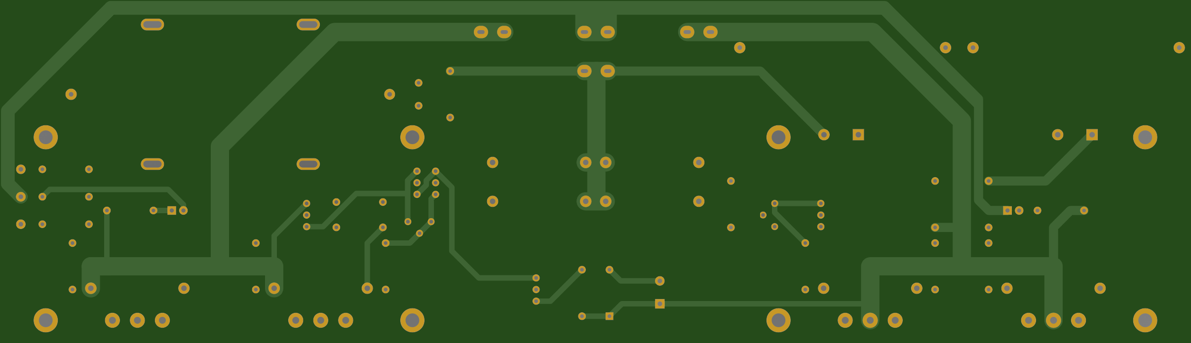

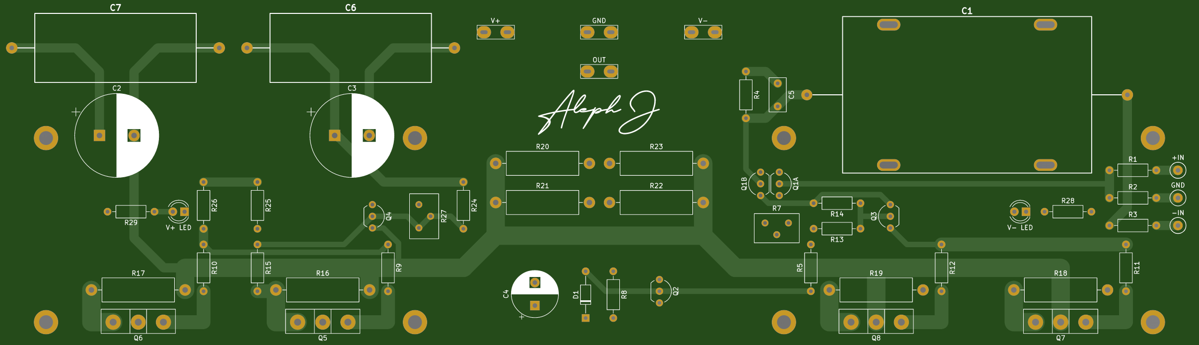

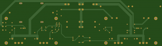

So.. I drawing Aleph J boards for left and right chanels (only left chanel right now) compatible with UMS heatsinks and with some specific axial capacitors.
I am not EE just hobbyist with basic knowledge so there could be errors and I also need a cricical view.
Thats what I have right now.
It took me 2 weaks drom installing KiCad to this but I am not in haste and have a lot of time to slowly make it better.
Board size is 75x260mm (2.95x10.24 inches).
P.S.: A little invention is tht pads on C1 for nylon zip ties. 😀
Big axial cap is heave and it will stress pins with his weight.
The bigger the more they will act as an antenna that picks up noise. I'd recommend to stay away for physically big caps if/where possible.
