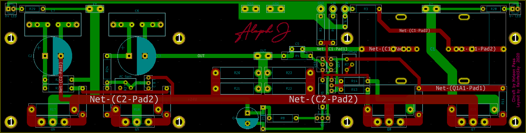

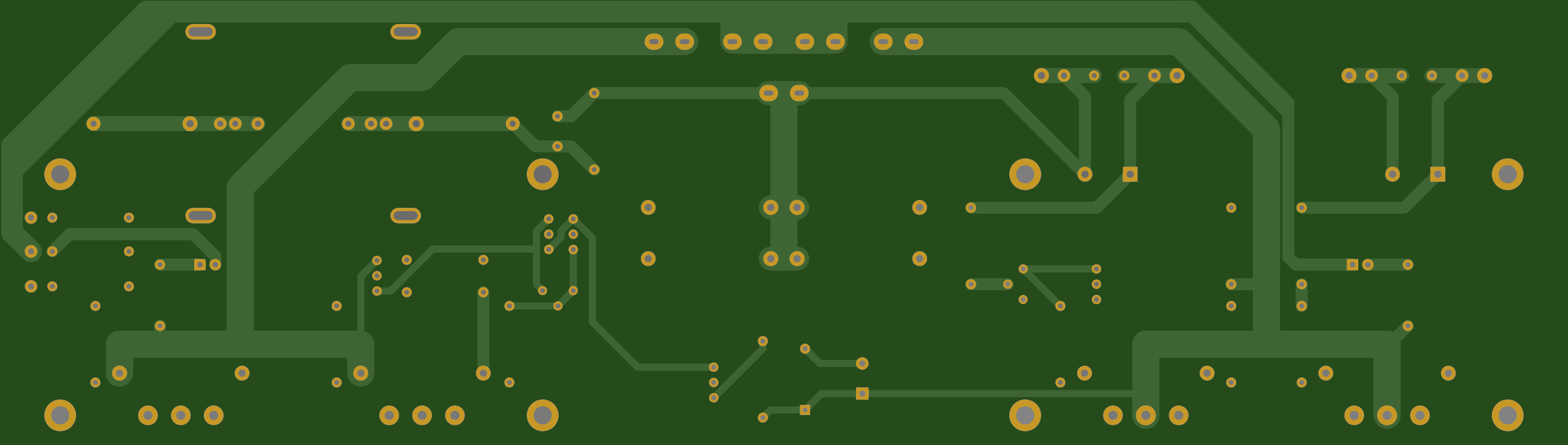

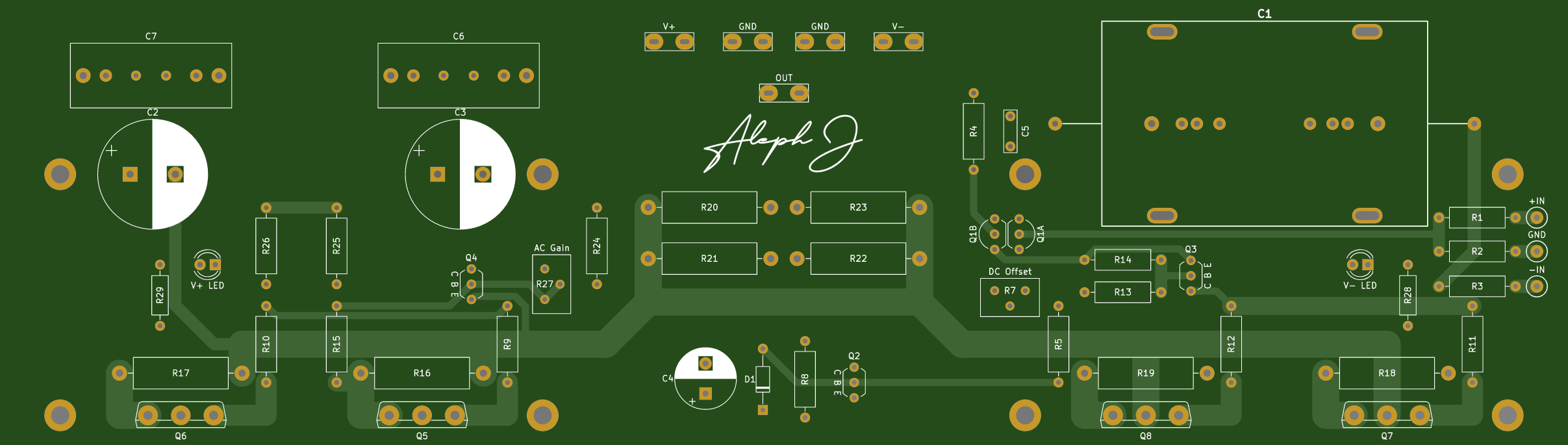

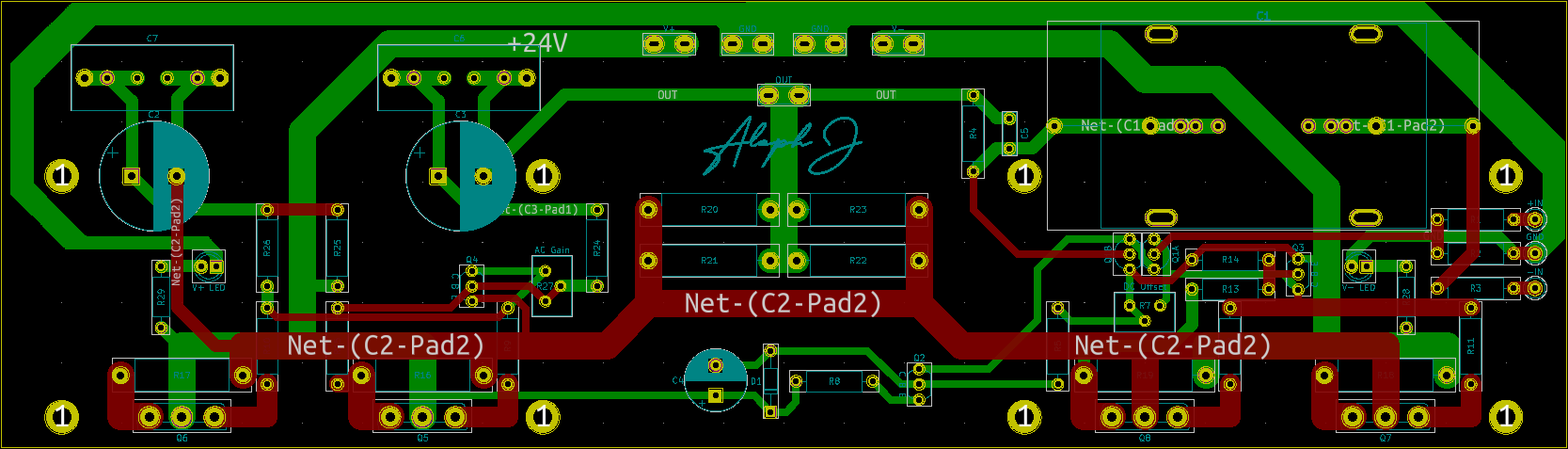

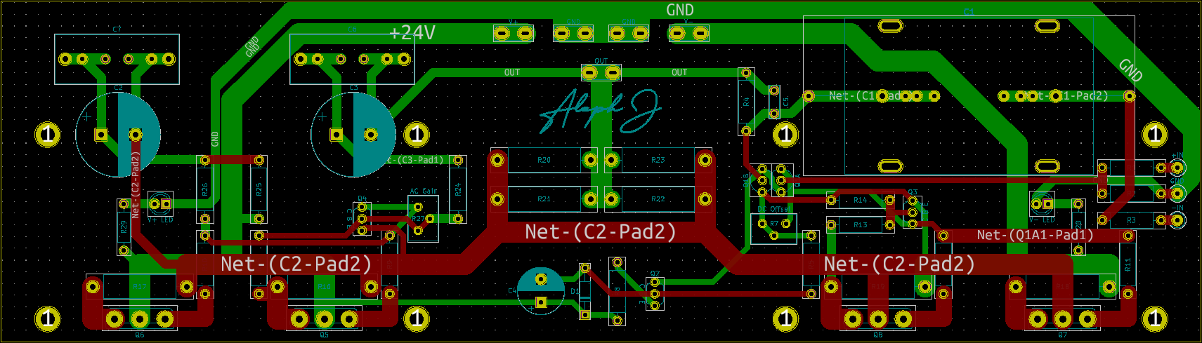

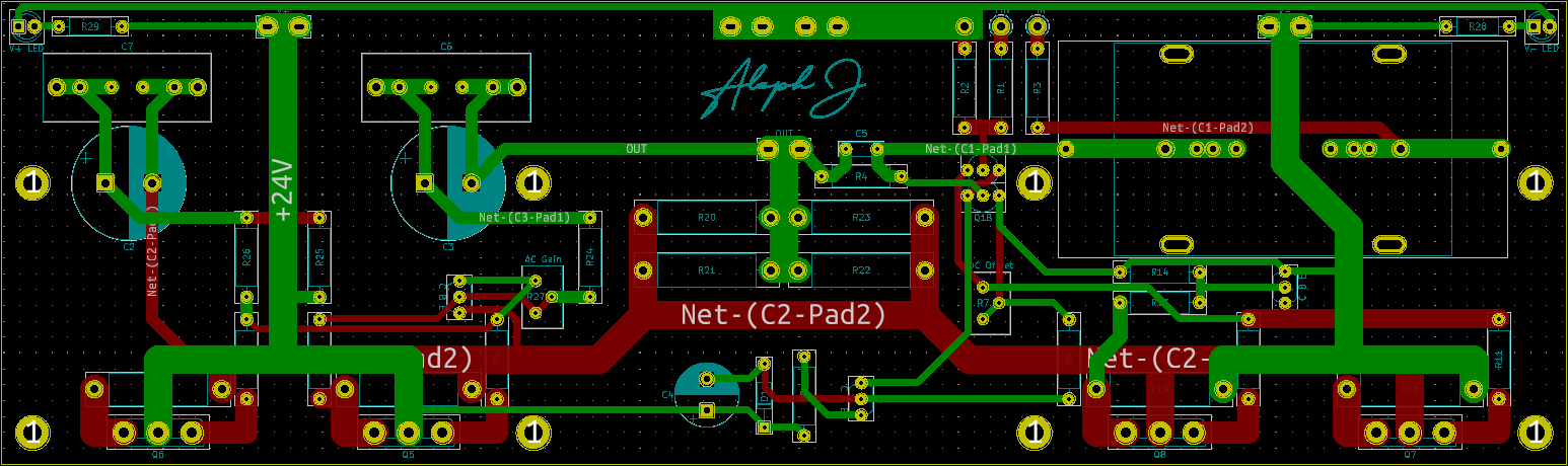

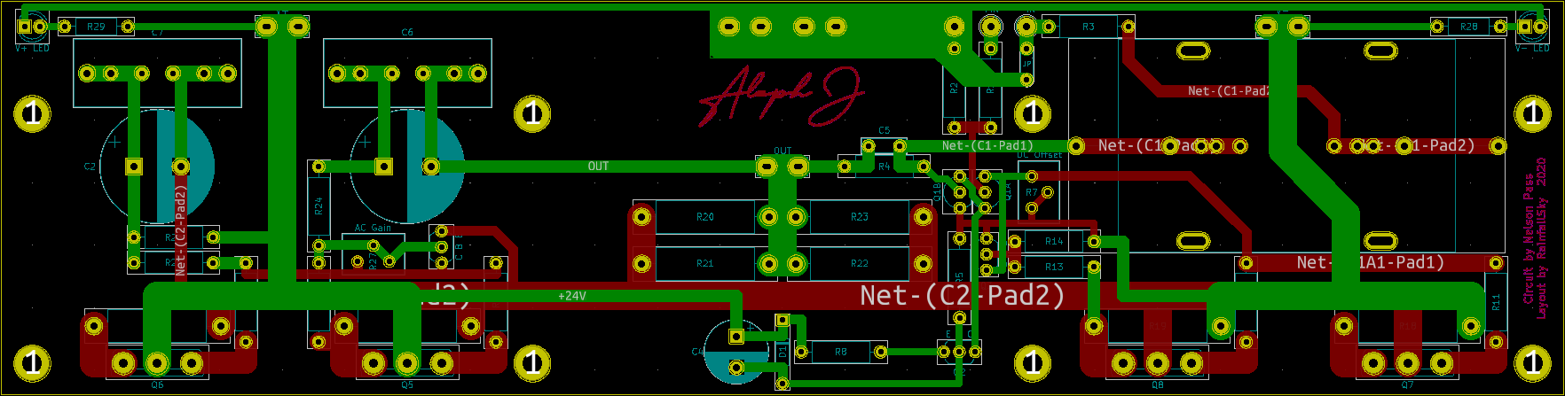

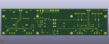

Some changes.
Small resistors up to RN60 size except LED risistors RN55 size.
C1 have 69.5mm lead space for big axial capacitor or 37.5mm 27.5mm 22.5mm 15mm for capacitors like FKP4 or regular MKP.
(Hole size for axial capacitor is 1mm because it was meant for specific cap with 0.8mm lead but can make it biger for versality)
C6,C7 stay. Lead space 22.5mm 15mm 5mm from FKP4 to small film caps.
Redraw silkscreen for some parts.
Q2, Q3, Q4 now ZTX/BC friendly with BCE marking.
Still only left channel board (74x260mm).
Will start to draw right channel when layout for left channel settle.
Already made change for Q2 E layout line after this scheenshots.. 😱
Still could be errors I can't see right now.
Like would LED's light connected that way.

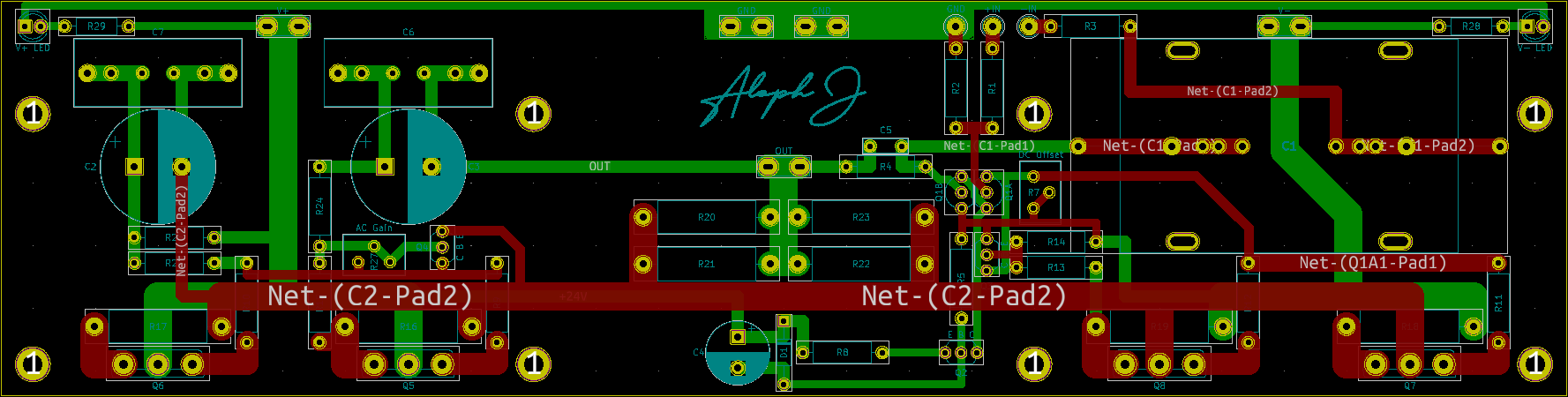

Not sure. But could be done about 2cm closer.
Silk screen for Aleph J is not KiCad font.
I convert it to silk screen symbol in KiCad from screenshot I made of what I type in MS Word using a real font.. 😀
Font name is "The Doctor".
I also plan to make it as a copper pad without mask later.
Should look cool with ENIG and kind of meh with HASL.

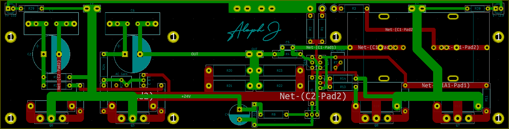

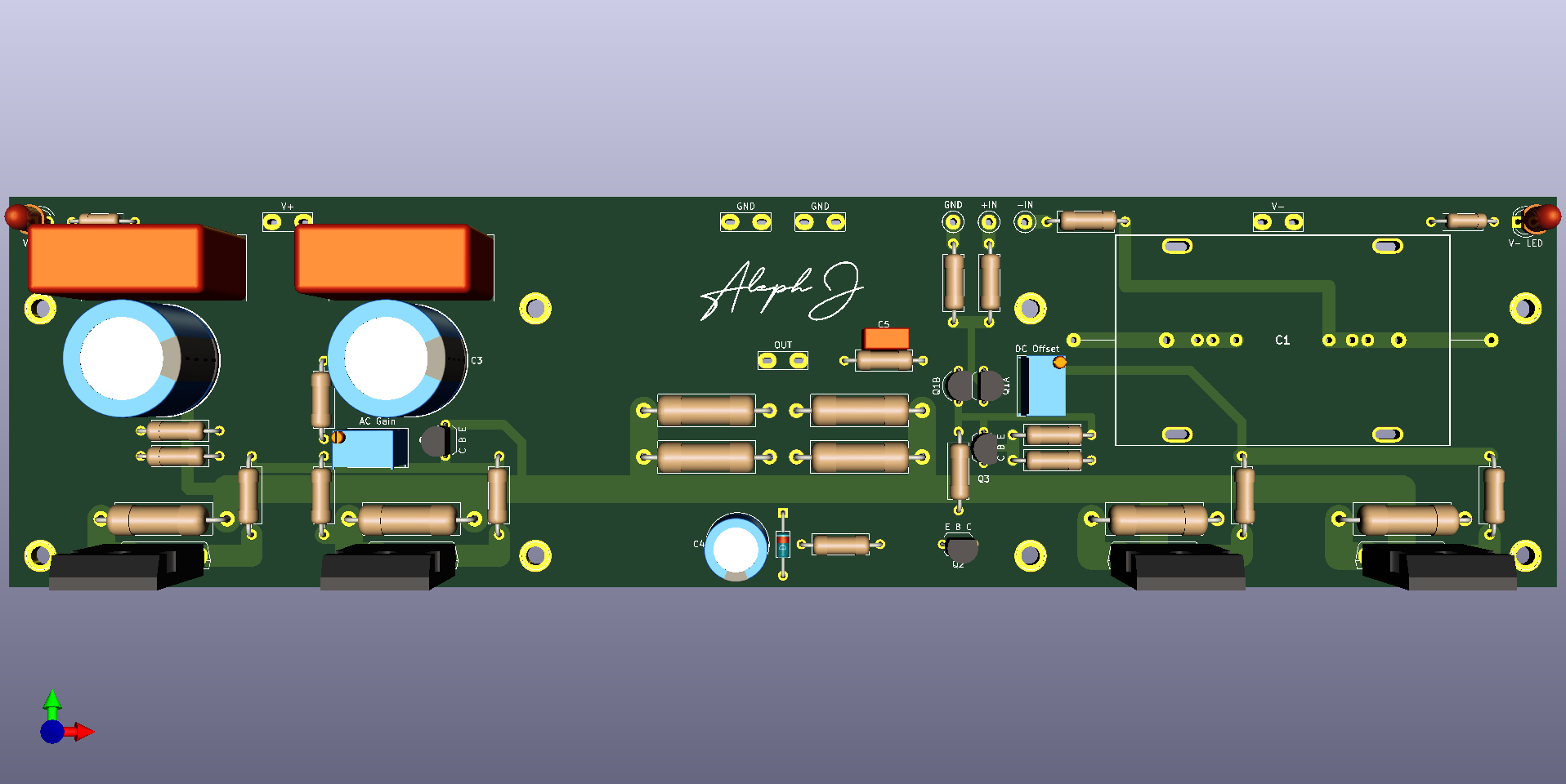

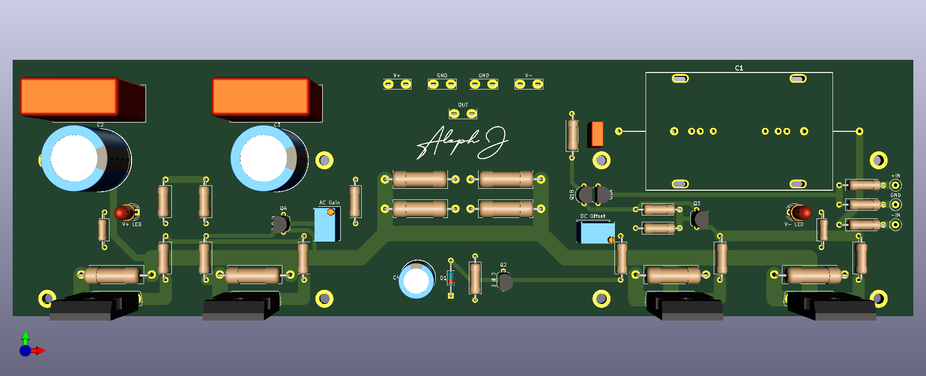

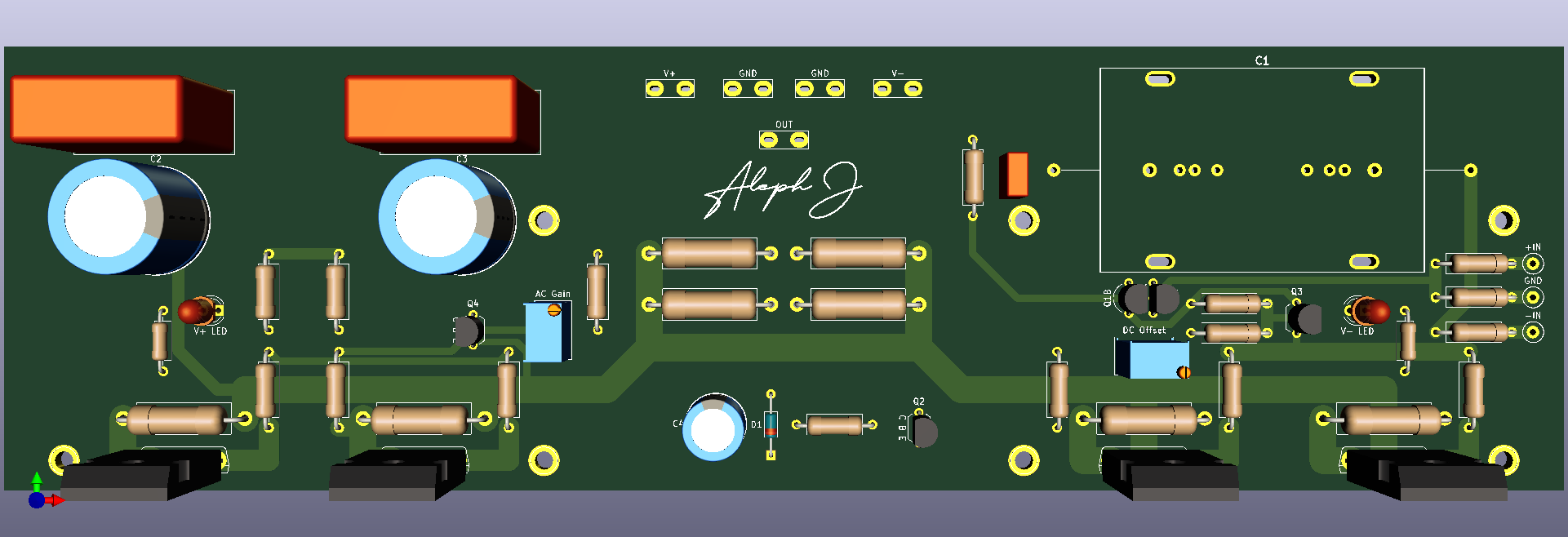

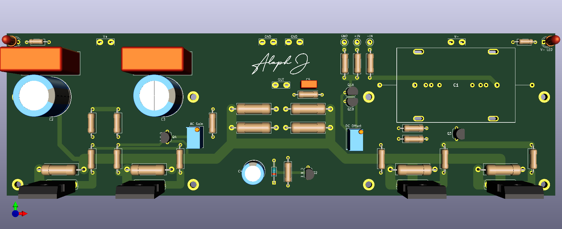

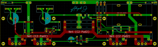

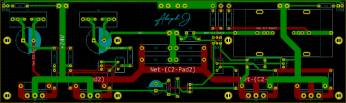

I gave up to make it as left and right pcb's and copycat inputs location from Didiet layout.
It went much beter and could be used as one board for both channels.
Board also decreased in size to 250mm x 74mm.

Try to optimize the part placement for shorter tracks. e.g.
Rotate 180 R25, put above r26
C2 asks to be next/rotated to r26
move r24 r27 and trans to the left, maybe rotate
move trans next to r14 r15?, and move them left
resistor? connected to r7 move left
the big cap is difficult, it asks to be in the top middle of the pcb, but it's big..
where possible copy high current tracks to other layer
Maybe add the "Algar" mods c102 c105, a few small caps, search the forum for info. I've made a smd aleph pcb version with these mods, because I could not get the original stable at full power and high freq.

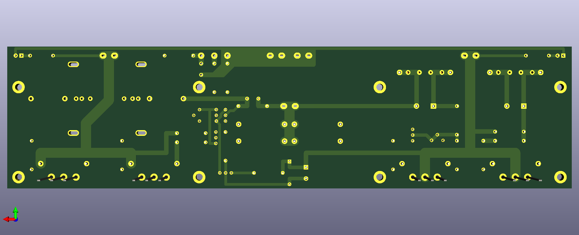

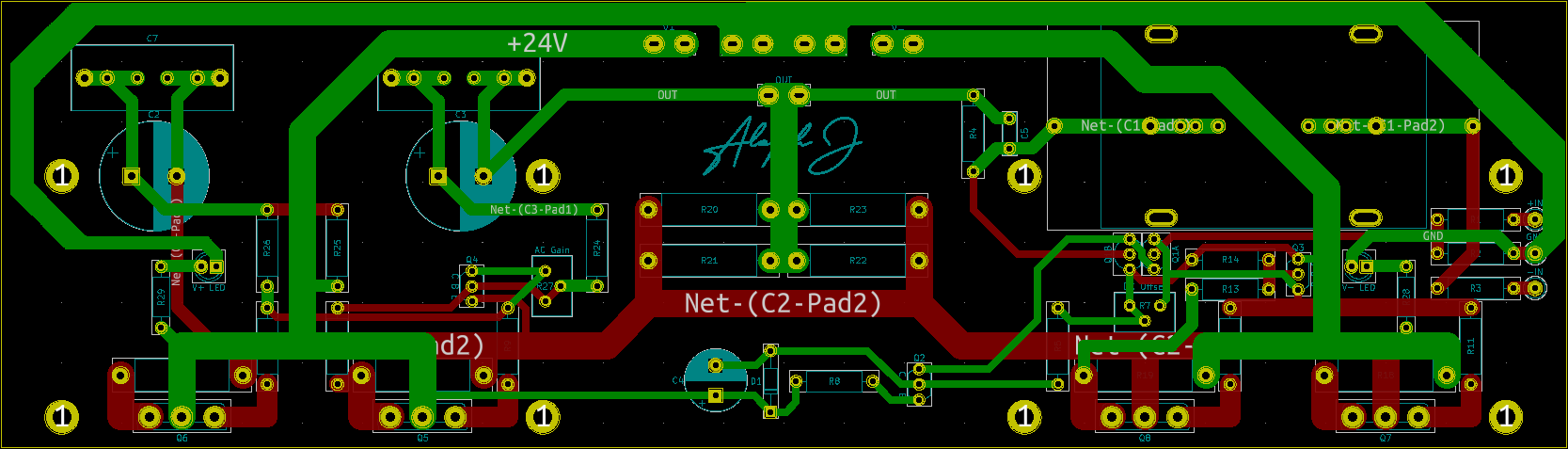

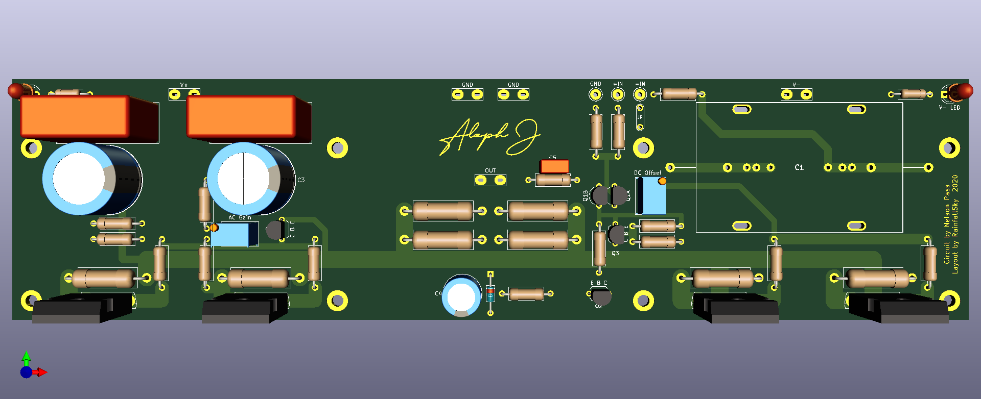

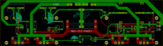

A new atemp was made. 🙂
Board size now 250mm x 63mm.
That took longer than I expect.
Need to rest for now and do something else.

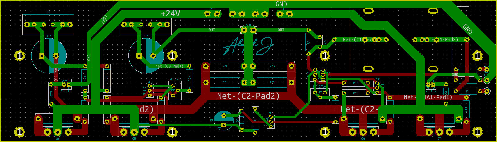

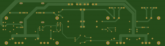

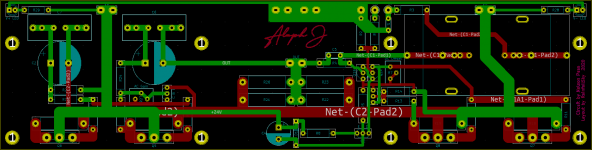

Yet another revision.
Small changes in traces, pads, a bit of footprints edit, some parts moved etc.
A place for wire jumper added in case only ubalanced (RCA) output will be used.
Lead space for jumper is 5mm
Inputs holes size is 1.2mm
I don't think someone would want to use thicker wire.
But some use coaxial cable and outer braid shield will go to.. hmmm.. GND?
Anyway all input pads have 1.2mm hole size.
"Aleph J" symbol as a copper pad now which I expect to be pretty with ENIG finish.
Also added text "Circuit by Nelson Pass. Layout by bla bla bla".. 😀
