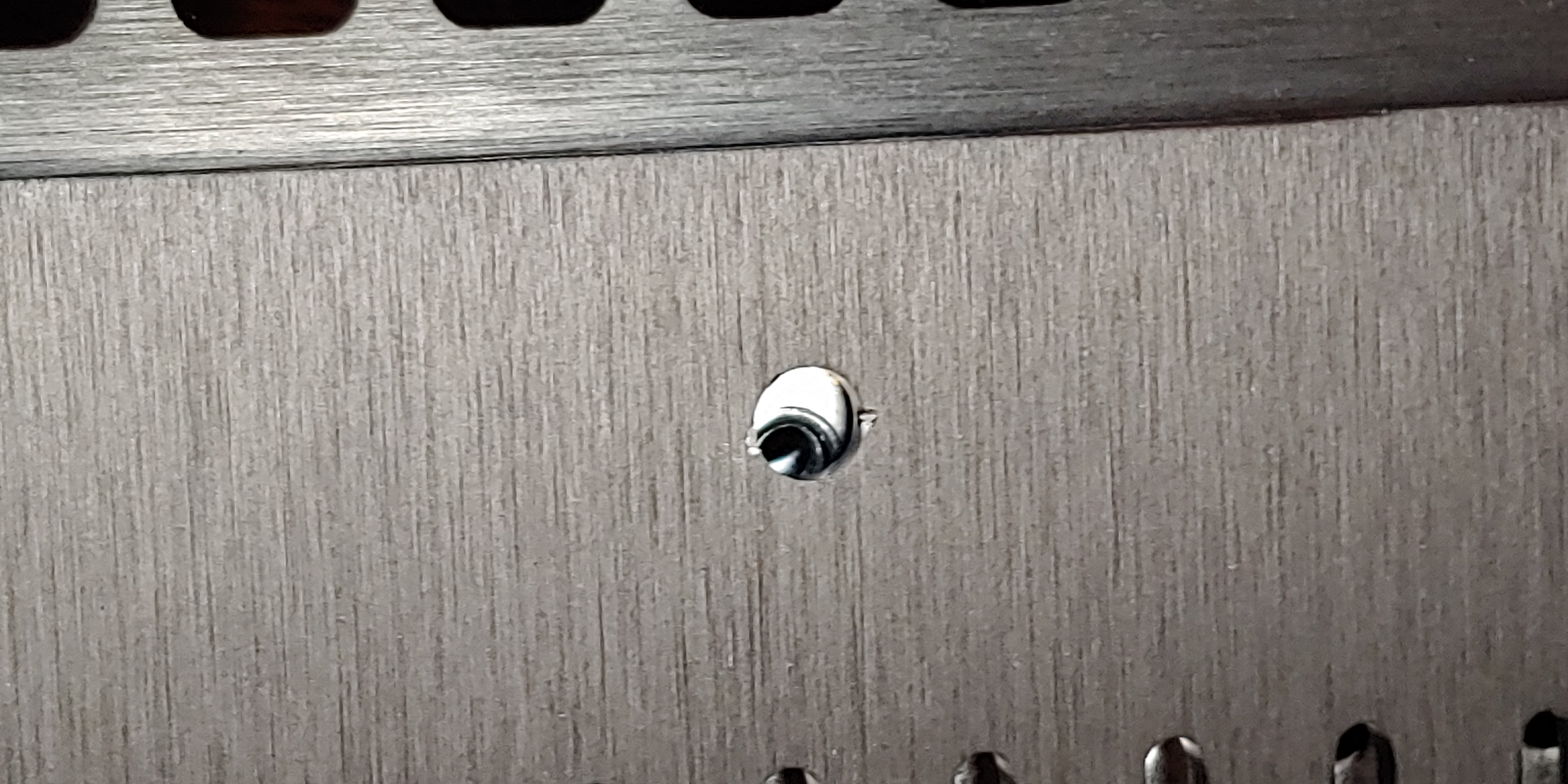

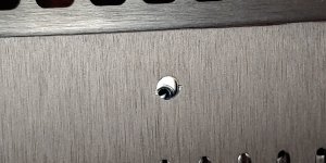

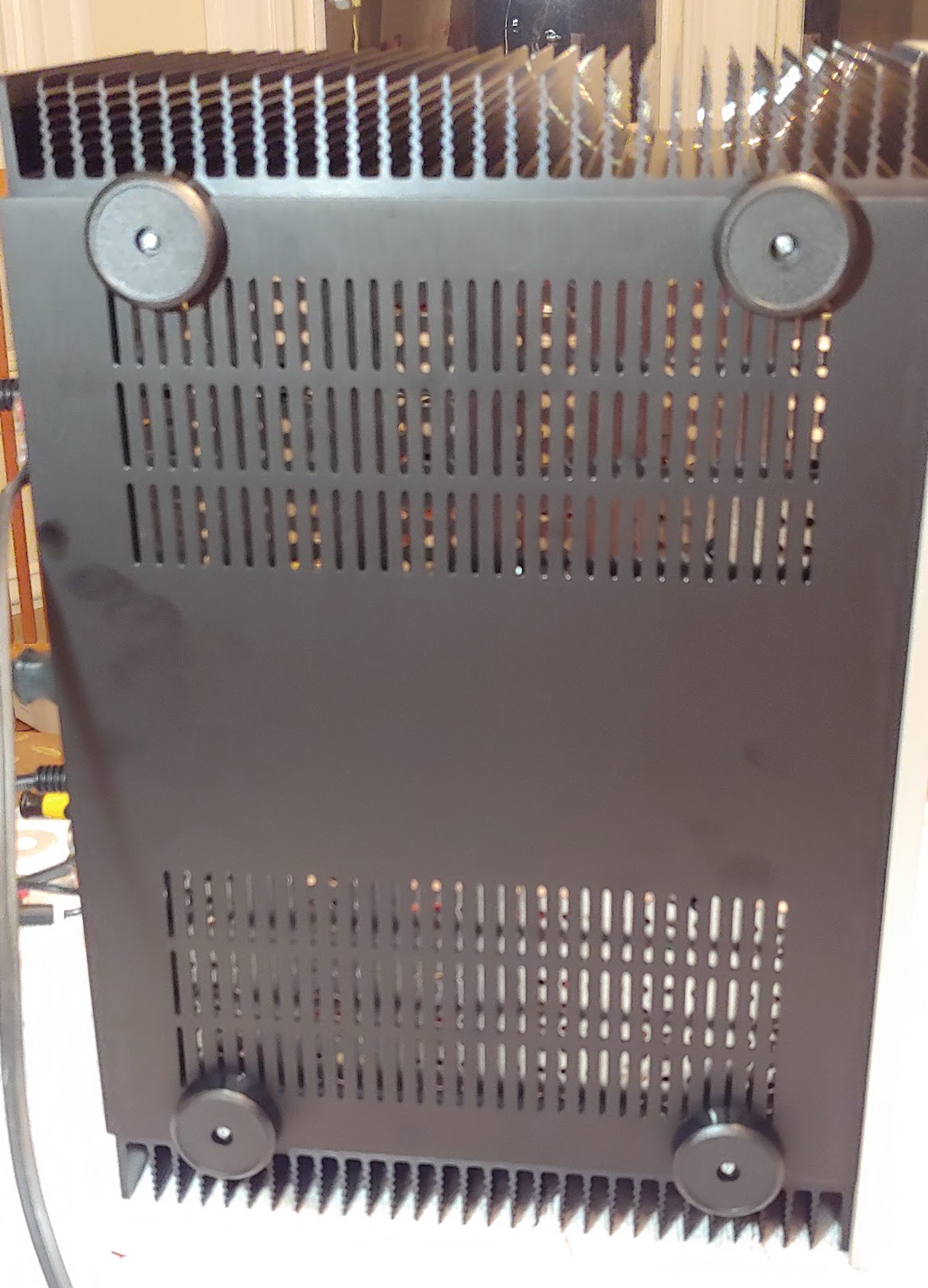

Get out your shorty Phillips head screwdriver and loosen (just a little!) the bolts that hold the brackets to the heatsinks.
With them loose, now line up the bottom cover and attach it.
Do your best to square up the top, when the holes all line up, snug the brackets bolts and put the top plate on.
The entire chassis bolts into the brackets. They are the spine that holds it all together. It's not immediately obvious that's how it works, but the good thing is that it's easy enough to align.
Great advice, and I used this technique a few times to get all the other bits to align, but it was to no avail for the bottom cover. The chassis base plate is just a little too wide, and no amount of fiddling with the rails was going to make it narrower. The fact that the chassis base plate to rails connection is countersunk makes it impossible to nudge that narrower.
Fortunately, drilling out all four holes in the bottom cover to be just a little bigger was enough to do it, and the plastic feet cover any sloppy drill work. 🙂

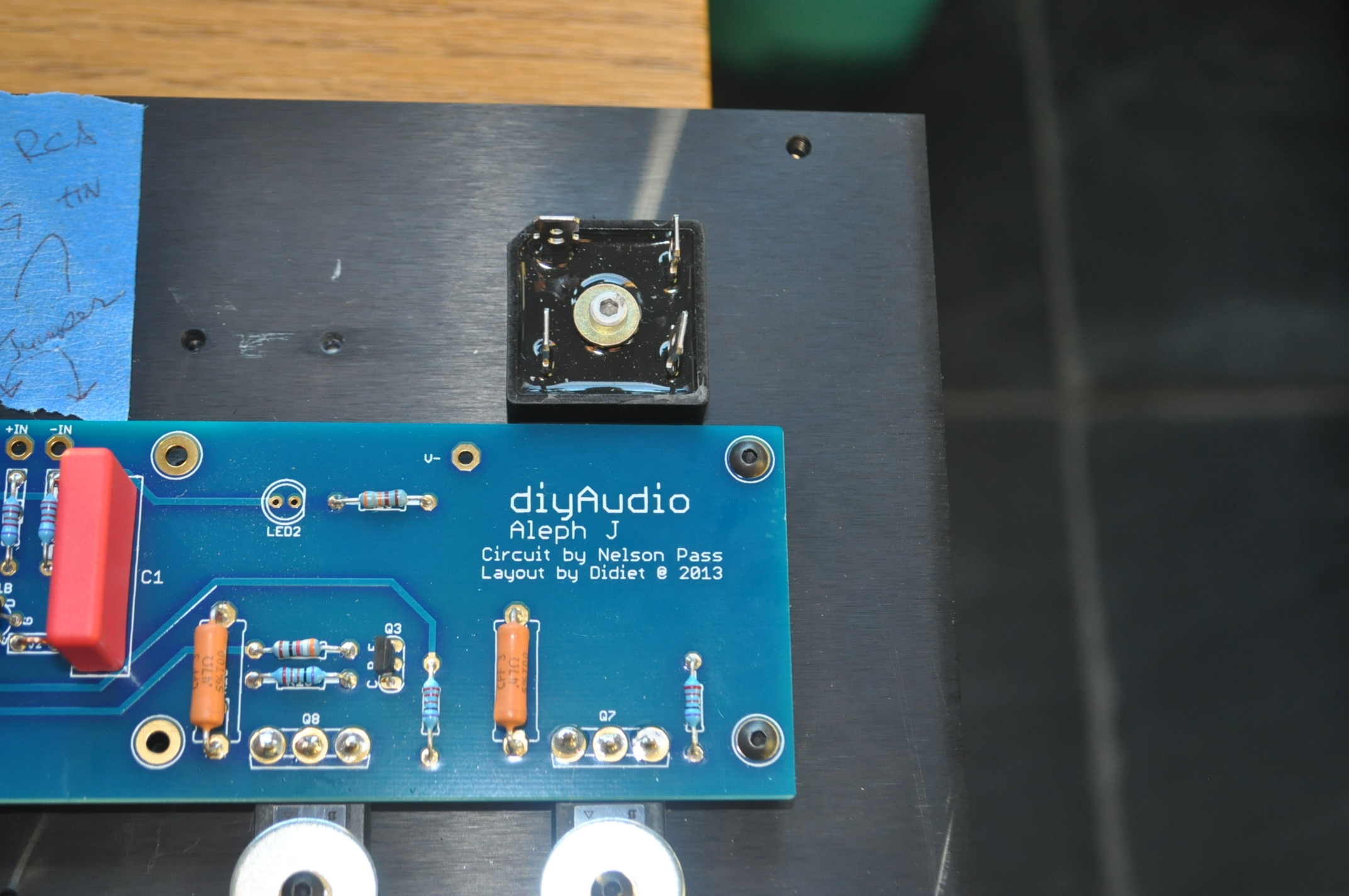

Is there a reason some use the rectifier bridges vs using the transistors with heatsinks? Is it just a space issue.
Would it be ok if I mounted those bridge rectifiers to the large heatsinks?

Yes, you could mount the bridges to the main heatsinks.
The bridges on the PSU are better diodes, already heatsinked, and most importantly, working properly... why change it?

Increased space, increased cost, added build complexity are some potential negatives for discreet. Potential for better PSU performance is a positive. Some people have their favorite diodes.Is there a reason some use the rectifier bridges vs using the transistors with heatsinks? Is it just a space issue.
Some (or maybe all) of the commercial First Watt amps use monolithic bridges if that matters to you 😀
For your purposes, I'd recommend saving the discreet sections you've already removed for another build. You have it working.
Yes, but you'll be adding to the heat load on the main sinks right next to one of your output parts. Plus the wiring distance may be something that could bite you re: noise. People have mentioned to me and others that keeping AC runs as short as possible and away from I/O is a plus.
The chassis floor is likely a good option. Since you are now closer to the build guide configuration, I'd give it a look if you have not. It is excellent, and that's what this thread is for. Give it a glance, see where you have questions, and let the OP know what is crystal clear, and maybe what could be clarified.

Edited to add - Clearly I need to be more concise. 6L6 already answered while I was typing. I thought you removed the diode section from your boards and were now using the monolithic, so you were asking re: where to mount them. If that's not the case, use what you have working.
I did remove the diode section and why I asked about mounting bridge rectifiers to the heatsinks. I'm thinking I'm going to use the diode section.

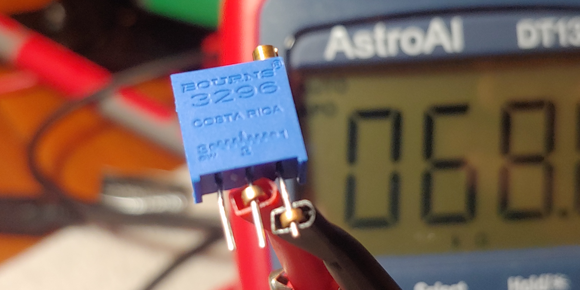

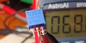

And now looking at the multi turn pot's, is there a way to test without power to be sure there in the ballpark? I've looked at the build notes and can't find anything.
6L6 gave the straight, short answer.
If you want to make sure the trimpots are what they're supposed to be (for example 200K), look at their mark on the body and/or measure them).
If you already played around with them, and want to be sure they're not at a bad position, turn them to the end (until they block) and turn them back 12 full rounds (assuming they're 25-turns)...
https://www.bourns.com/docs/product-datasheets/pv36.pdf?sfvrsn=87259ff1_14
Edit: I just went to see if the marking returned a useful information—it's not that easy... Best is probably to measure them...
How to measure the pots, from my n00bs guide:
"When you get to the potentiometers (R7 and R27), make sure to set them to the correct value before soldering them in. For R7, it should be 1k ohms; for R27, it should be 68k ohms. To measure and adjust their resistance, you'll want to put the negative lead of your multimeter on the lead marked #1 (one of the "ends") and the positive on the middle lead, marked #2 (the "wiper"). Then turn the potentiometer screw until you get the desired reading."
