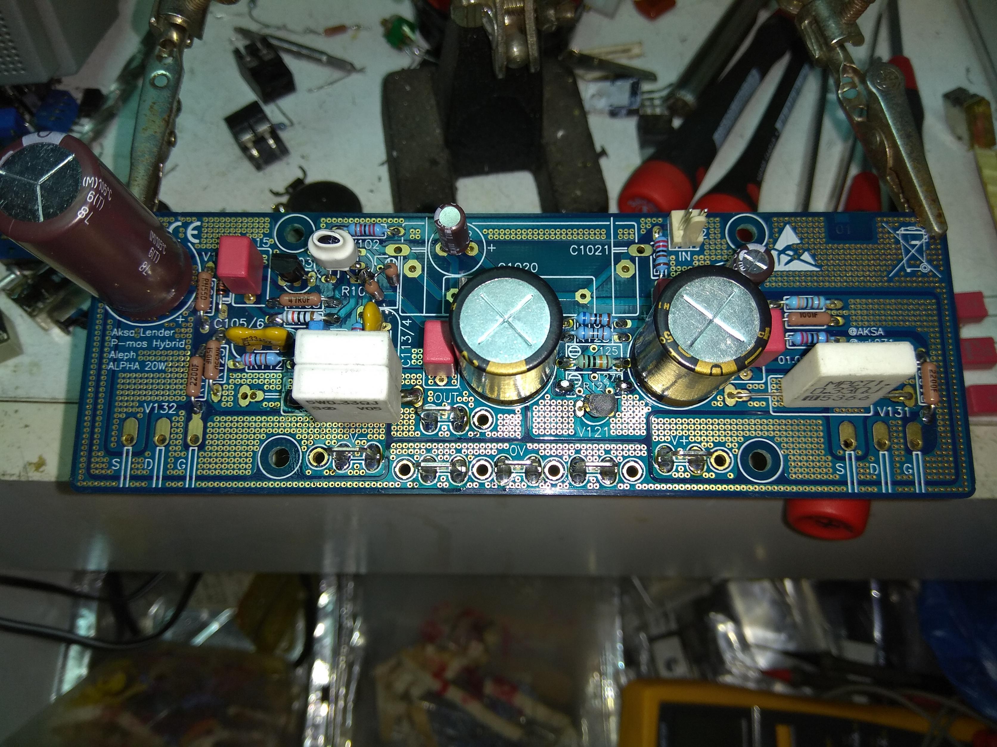

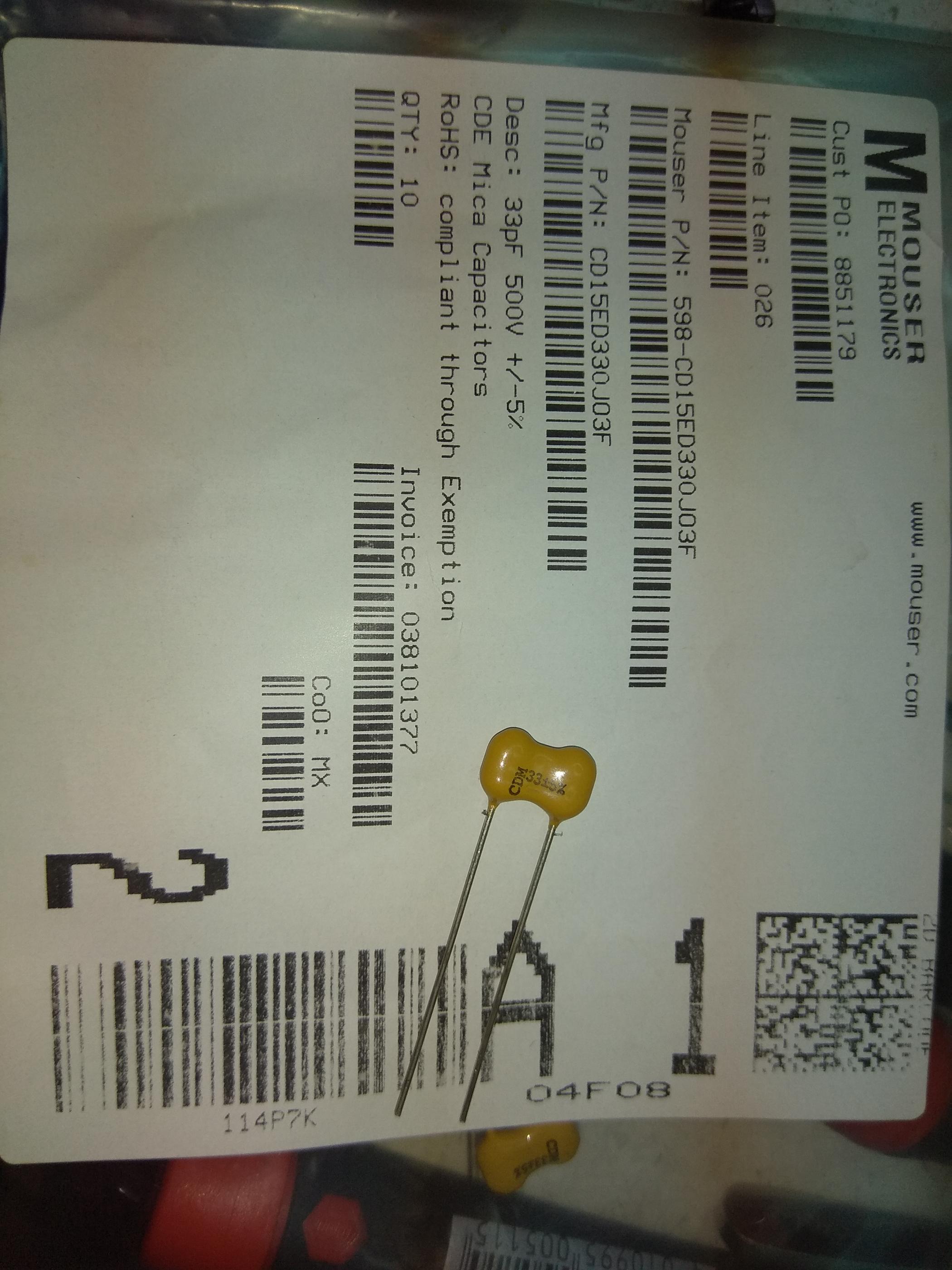

I see also 33pf smd for compensation,different values according to schematic,are these ok ?
You can try 33pF or 36pF, smaller if you can do it and not get oscillation. I have 36pF in silver mica but only 33pF in NP0 SMT. Both can work. You might even try smaller 28pF and get away with it. Hugh says best to use silver mica for sound quality. NP0 may measure lower distortion but silver mica probably best for SQ.

I have 2 pieces only 33pf Mica.You can try 33pF or 36pF, smaller if you can do it and not get oscillation. I have 36pF in silver mica but only 33pF in NP0 SMT. Both can work. You might even try smaller 28pF and get away with it. Hugh says best to use silver mica for sound quality. NP0 may measure lower distortion but silver mica probably best for SQ.

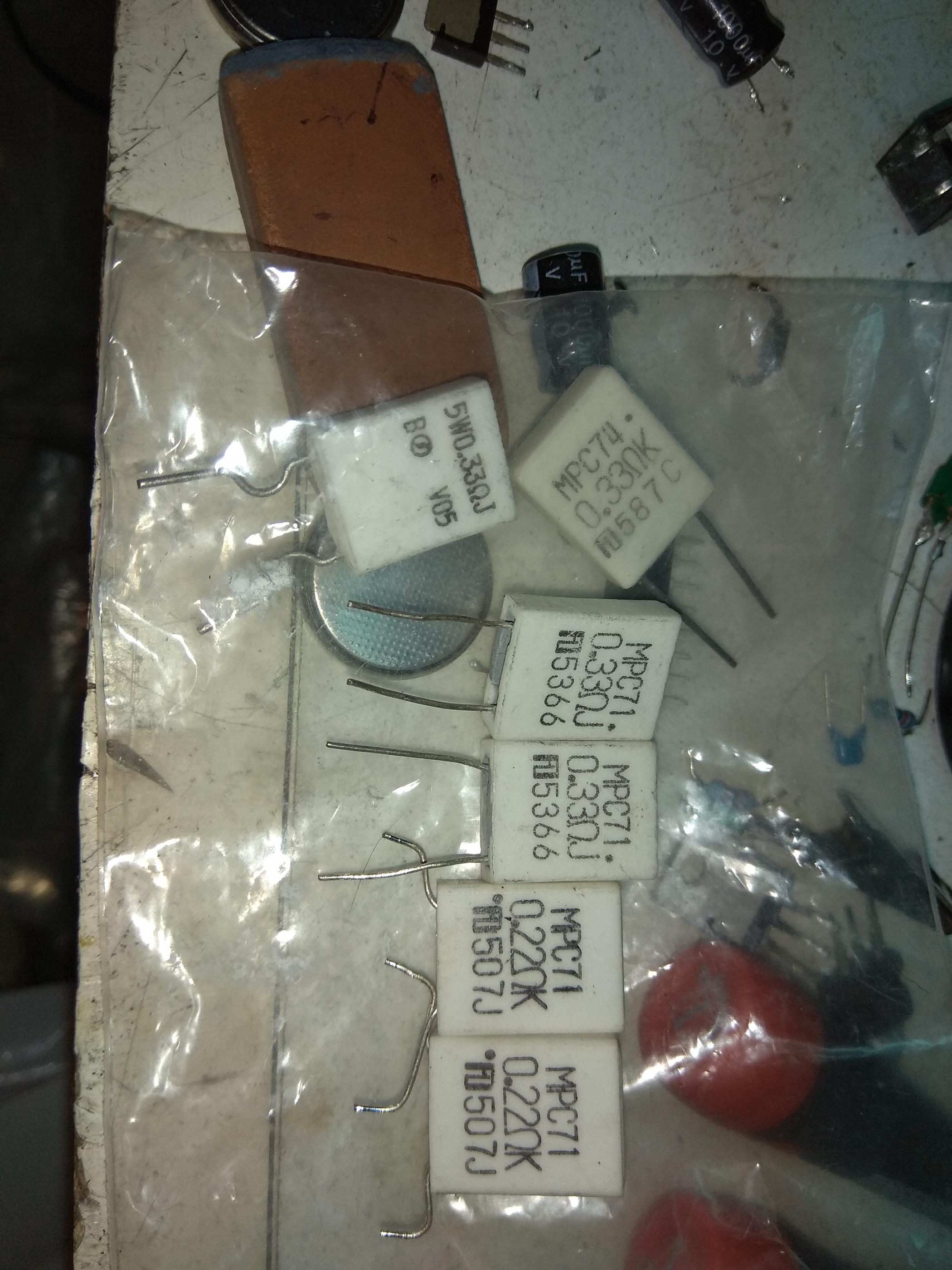

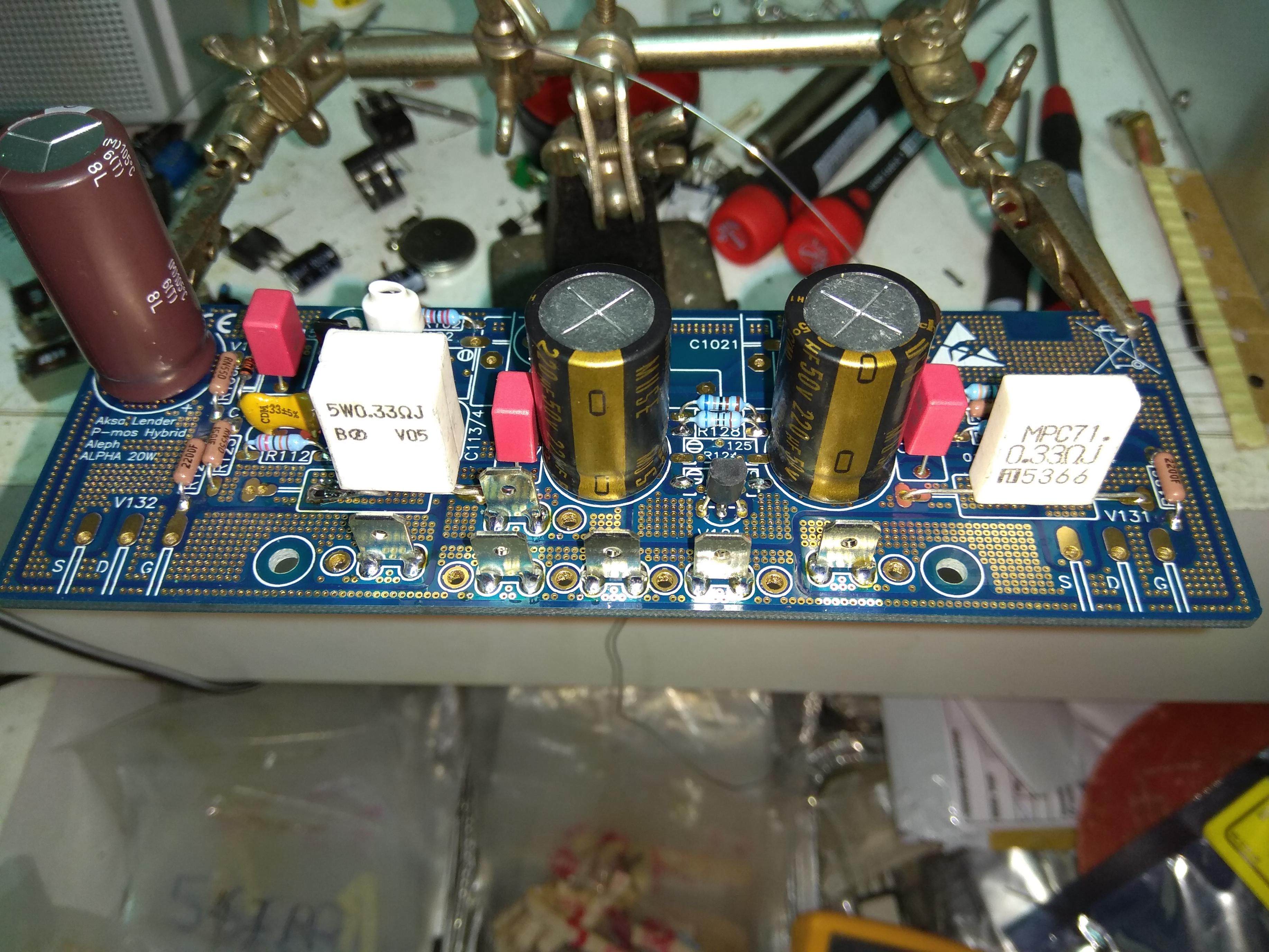

How critical is the 0.12ohm resistor?
Is it ok to use 0.1ohm for R132?
R132 needs to be about 1/2 of R131 (0.33R). So 0.1 is a bit off. Do you have two 0.22R or two 0.33R is even better for a perfect 2:1 ratio.
Yes 0,22 & 0,33 are available.
So R131=0,33R
R132=0.33R//0.33R=0,16R.
The pots are optional, just install the resistors and no pots. This amp doesn’t need any pots as it is adjustment free. Set R105 pot at 1050R or use 1k and 47R in series - again, no pot needed on this amp. You should look in the GB thread for more build tips as almost all of these questions have been answered there.

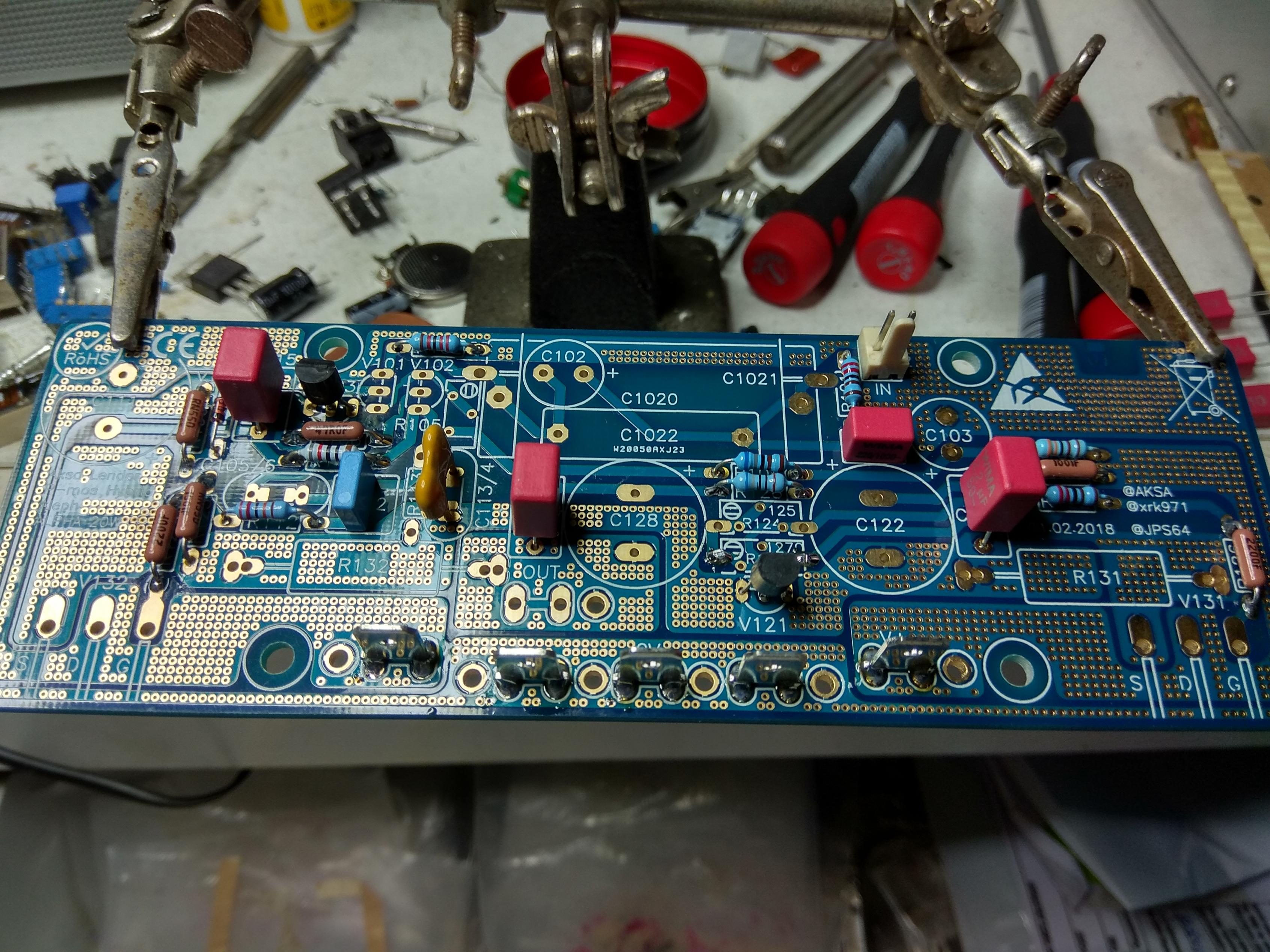

Thanks xrk, i have troubles posting photos...

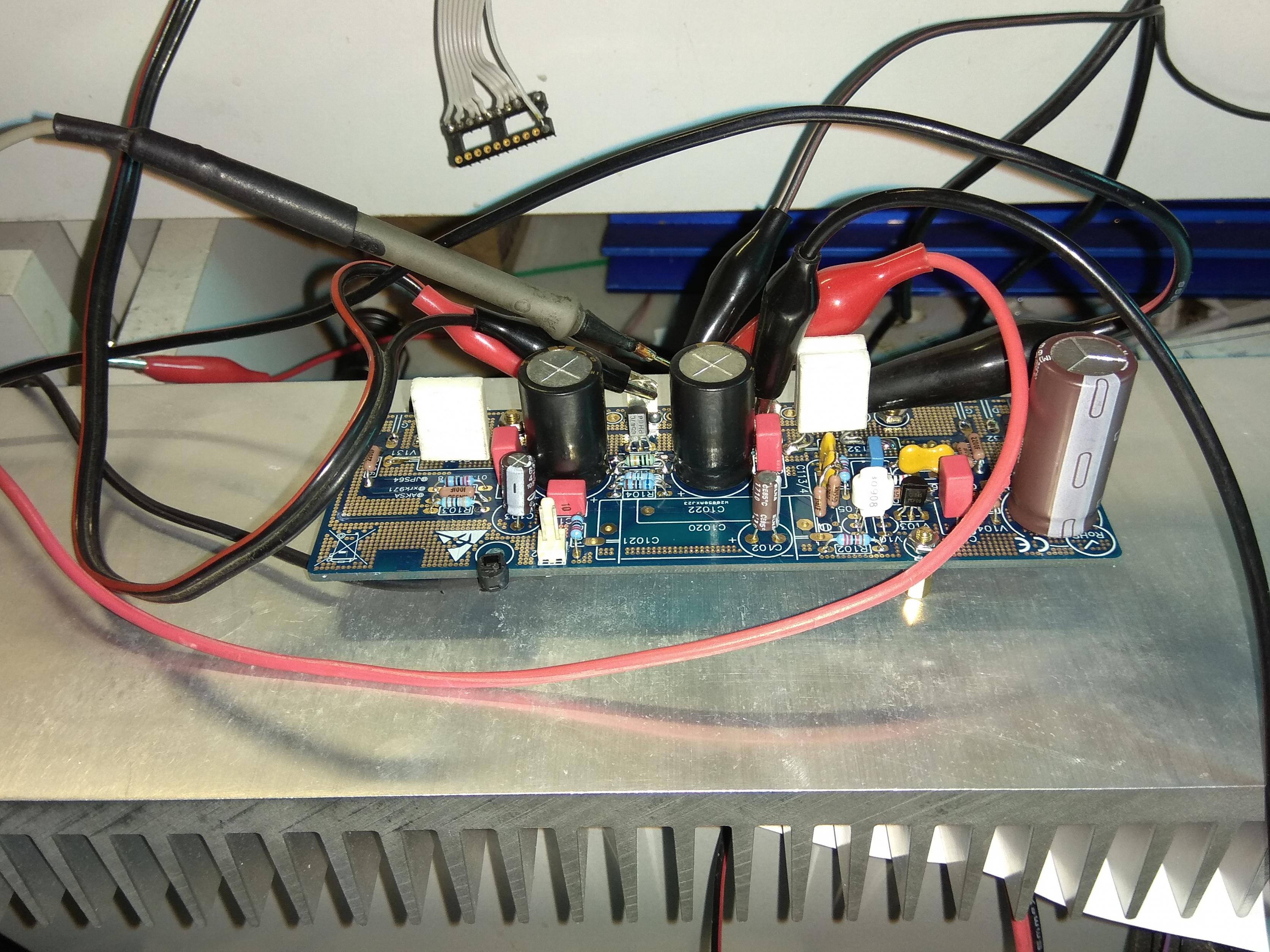

Close to the end!

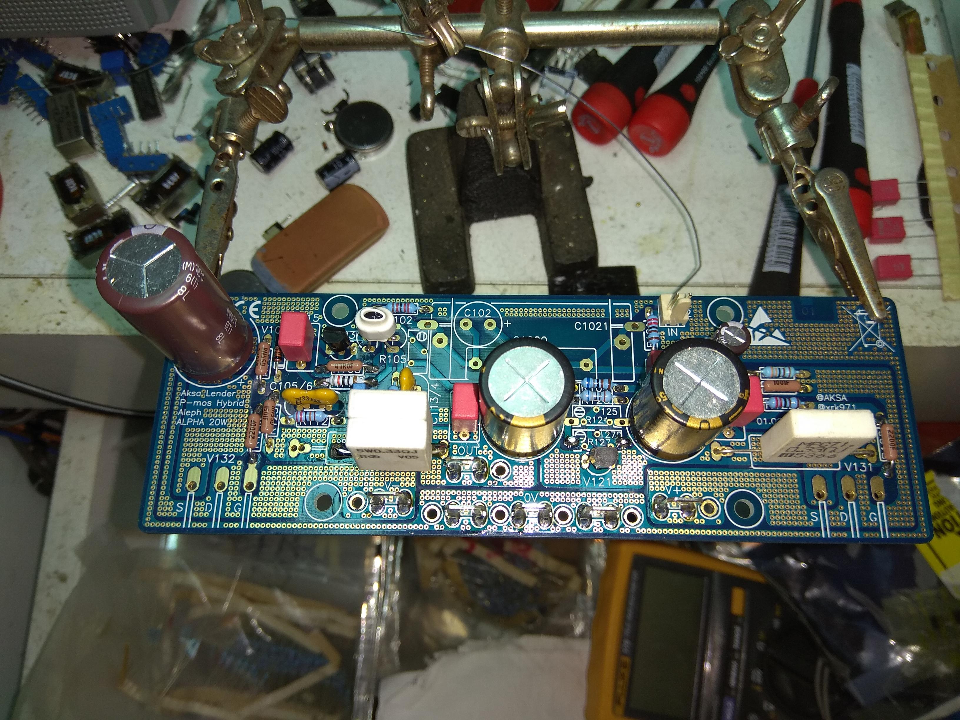

thimios,
Good to see you are close to completion with populating the PCBs. 🙂
Look forward to your listening impressions.
Looking good Thimios. I assume you have a +/-24v PSU and Class A heatsink all ready to go?
Good luck with power up!
Usually goes well for this amp without a hitch. Monitor the bias current at switch on and turn off PSU if you get more than 2amps bias or >0.7v across R131 0.33R resistor.

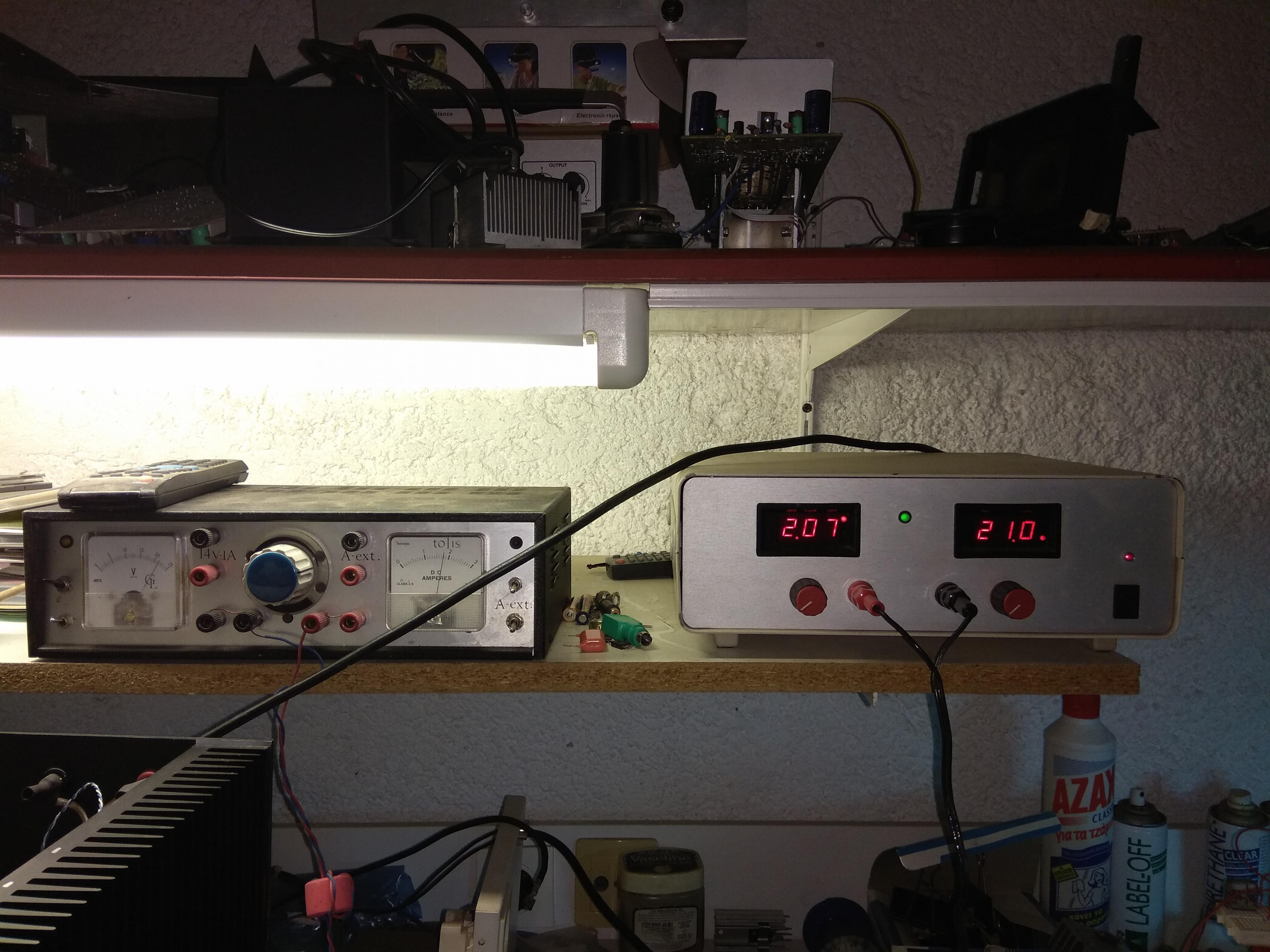

Thanks guys but this is tested already!
Two variable bench power supplies used at first start up.
+/-21v , 1.8A idle current.
It is singing nice!
I have listen only for a few minutes as i feel very tired.
It is singing nice!
