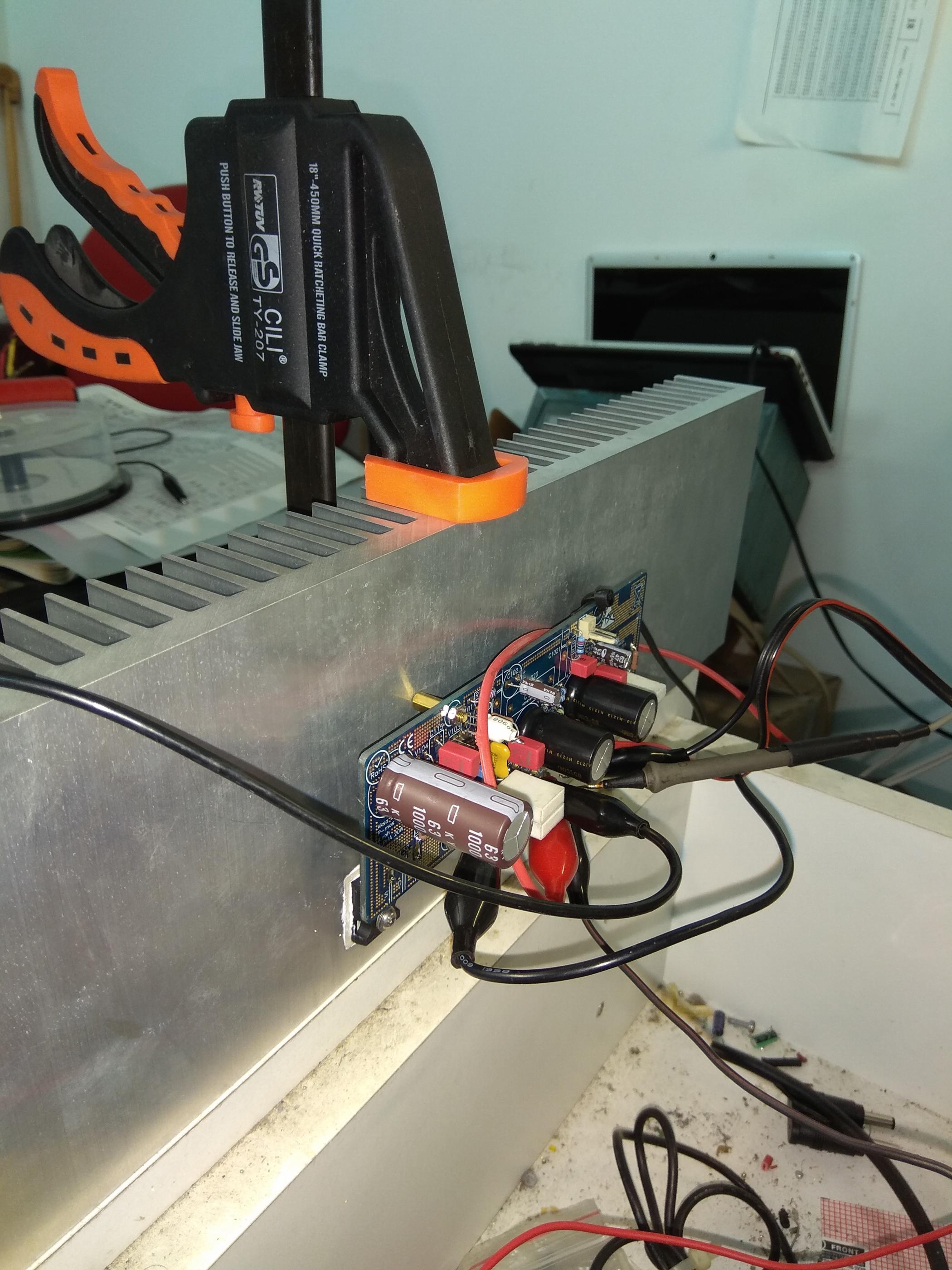

Second chanel when first chanel sing but hot heatsink temperature is 57 celcius(room temperature =20 celcius.
Second chanel when first chanel sing but hot heatsink temperature is 57 celcius(room temperature =20 celcius.![]()
With those really huge heatsinks (they look like USA Heatsink ones from Jeff?) it is 57C? What is the bias current through the MOSFET? 57C is is about right if your sink is sized right on the edge. But should be similar to first channel.

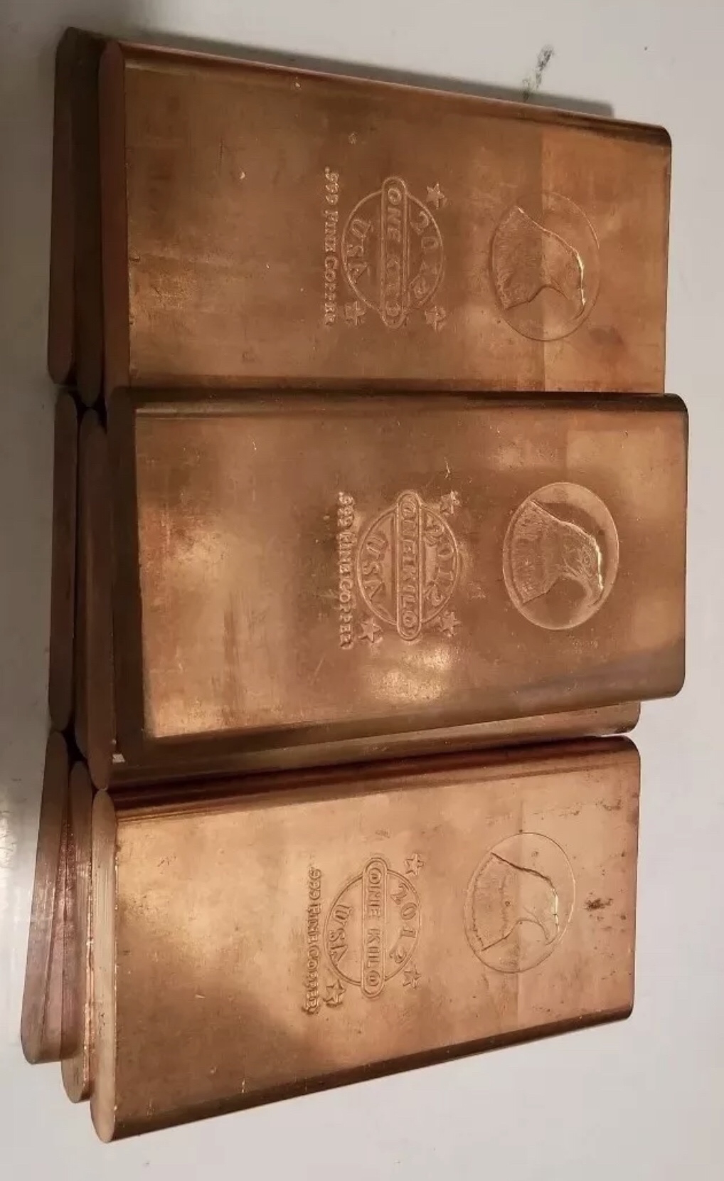

I’ve used these before with making a water block or a passive heat sink for some of my computer builds. When I used them as a passive cooler I never had to use a fan
They have one KG bars of pure copper and only cost $20 each.
Great idea. Do you a link>

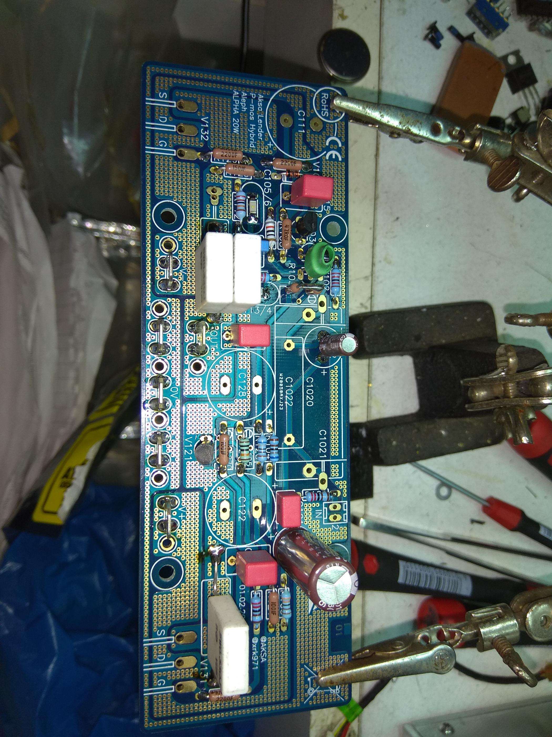

Tomorrow very likely I will start stuffing the Alpha PC boards.

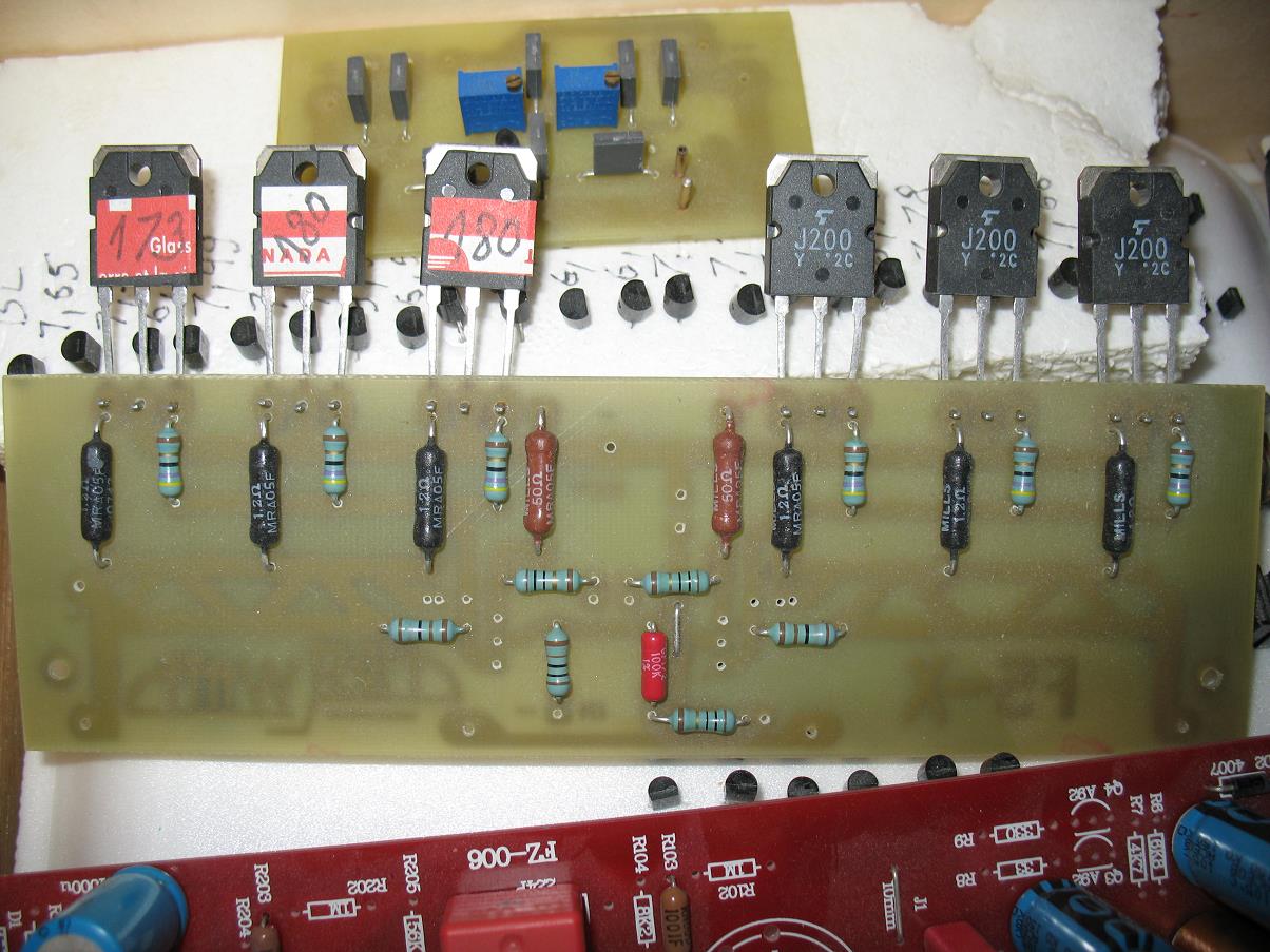

I just found 4 of this in my box while I was searching for some components, this was designed for F5 X and will be never finished so those audio Toshibas free for use.
I will have to contact Danny let see if he willing to run some simulation before I butcher up that old project.
If I blew up those mosfets I care less those already soldered...
